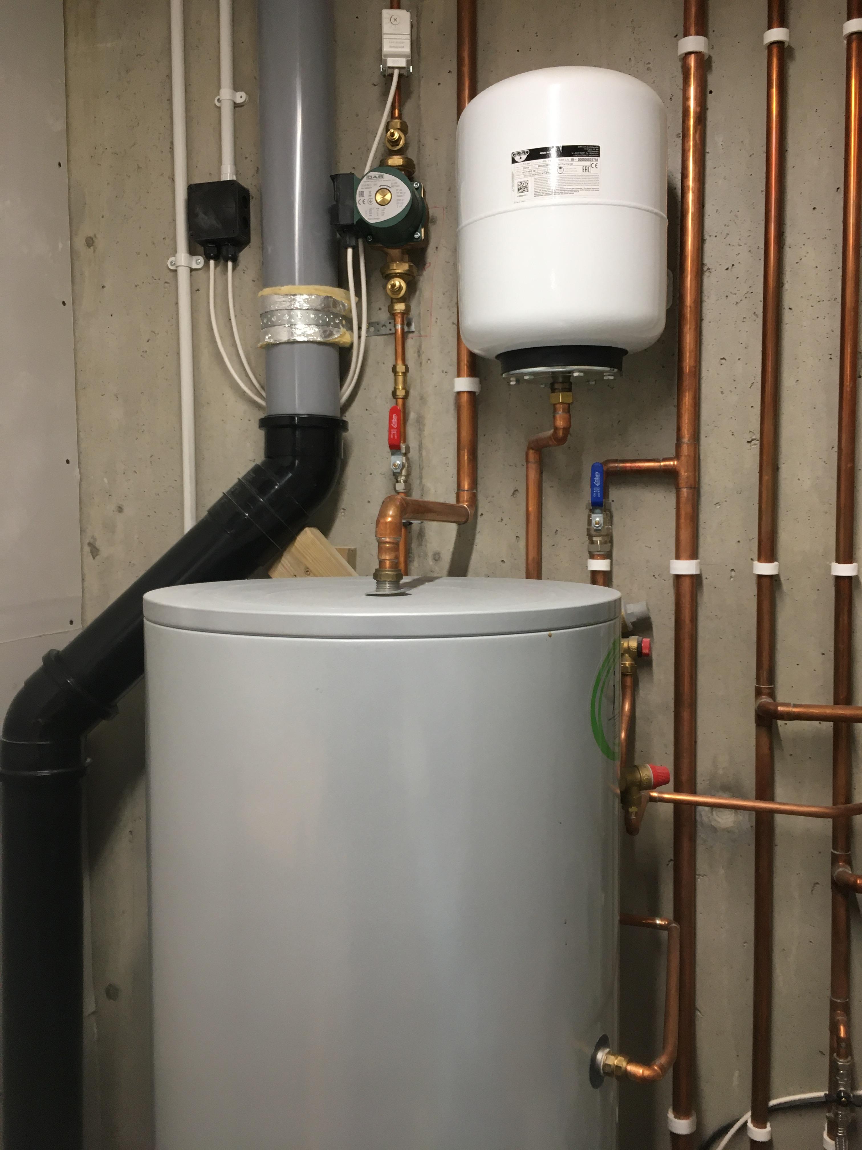

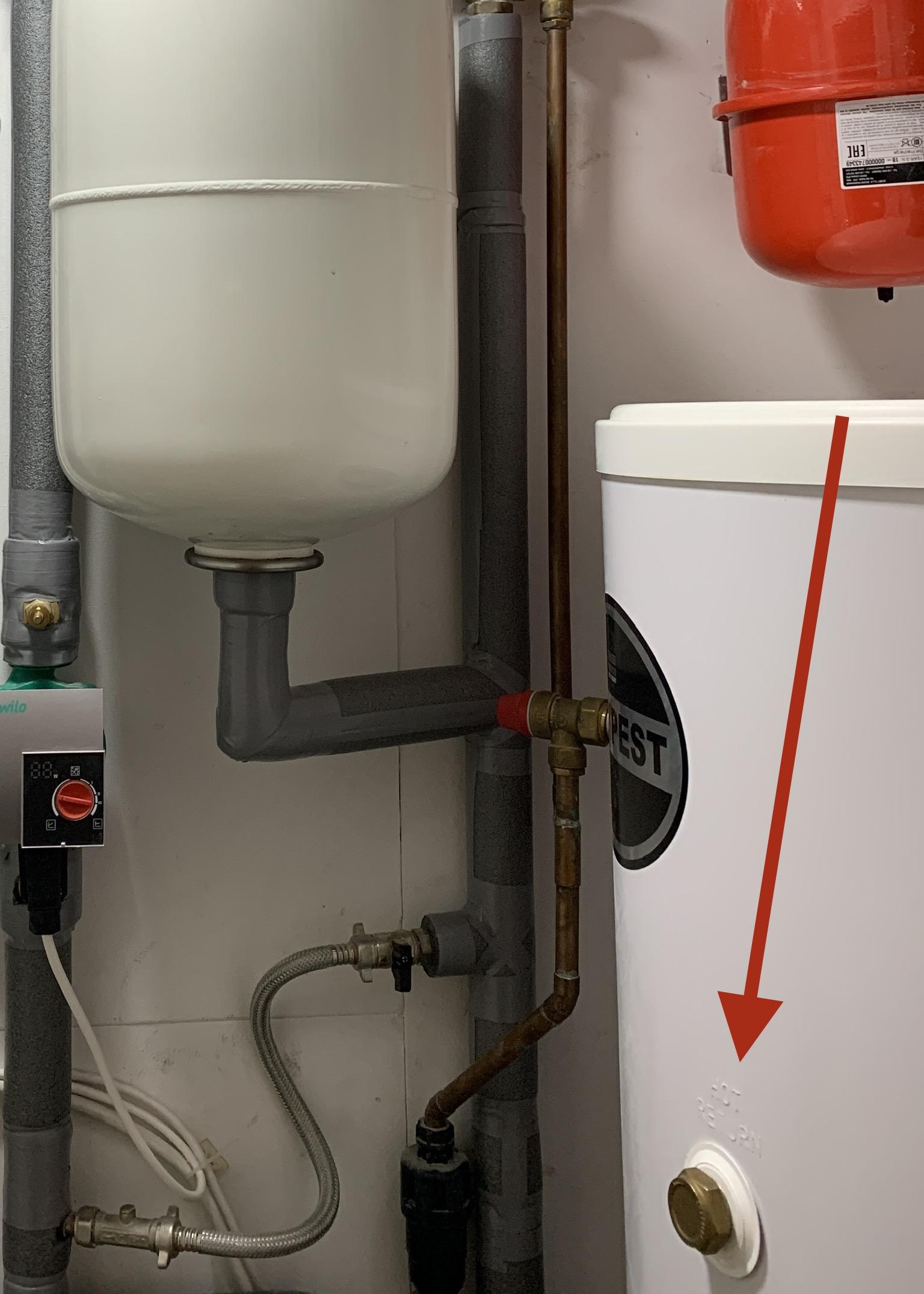

Pocster Posted November 23, 2019 Share Posted November 23, 2019 On 20/11/2019 at 08:50, Bitpipe said: Some here have gone for a manifold distribution approach (where there would be a lower bore return path for DHW to the tank from the manifold - this ensures the manifold is always hot and you then only have the leg to each room to consider. We have a radial system which tees off to each outlet as it passes but after the last room, the DHW pipe reduces to 15mm and returns to the DHW tank. Still can’t visualise how this is plumbed up . Link to comment Share on other sites More sharing options...
PeterW Posted November 23, 2019 Share Posted November 23, 2019 1 hour ago, pocster said: Still can’t visualise how this is plumbed up . Back to the hot return port on the tank - usually about 250mm down from the top 1 Link to comment Share on other sites More sharing options...
Pocster Posted November 23, 2019 Share Posted November 23, 2019 (edited) 11 minutes ago, PeterW said: Back to the hot return port on the tank - usually about 250mm down from the top I still don’t get how this works . if a pipe is full of cold water how is that ‘pumped’ out and replaced with hot ? Sorry if I’m being thick and unskilled ? Edited November 23, 2019 by pocster Link to comment Share on other sites More sharing options...
PeterW Posted November 23, 2019 Share Posted November 23, 2019 15 minutes ago, pocster said: I still don’t get how this works . if a pipe is full of cold water how is that ‘pumped’ out and replaced with hot ? Sorry if I’m being thick and unskilled ? Ok... so ... Hot comes off the top of the tank down an insulated 22mm pipe, and then is tee’d off to each tap as close as you can get. After the last tap spur, it drops to 15mm or even 10mm and then returns to the tank via either a bronze or polypropylene bodied pump (due to it being potable water). Hot return port is here on a Telford Heat Pump cylinder. This pump runs intermittently to draw a slug of hot water from the tank, and then return the cooler water to the tank. Essentially this whole circuit is just a pressurised extension of the tank. When a tap is opened then the water pressure takes over and taps operate as normal but the only “cold” water is the last leg from the circulating loop to the tap. 3 Link to comment Share on other sites More sharing options...
Pocster Posted November 23, 2019 Share Posted November 23, 2019 44 minutes ago, PeterW said: Ok... so ... Hot comes off the top of the tank down an insulated 22mm pipe, and then is tee’d off to each tap as close as you can get. After the last tap spur, it drops to 15mm or even 10mm and then returns to the tank via either a bronze or polypropylene bodied pump (due to it being potable water). Hot return port is here on a Telford Heat Pump cylinder. This pump runs intermittently to draw a slug of hot water from the tank, and then return the cooler water to the tank. Essentially this whole circuit is just a pressurised extension of the tank. When a tap is opened then the water pressure takes over and taps operate as normal but the only “cold” water is the last leg from the circulating loop to the tap. Really helpful @PeterW - nearer the time to implement this ill post photos to make sure I’m doing it right . But in essence it sounds quite simple ; appreciated. Link to comment Share on other sites More sharing options...
Bitpipe Posted November 23, 2019 Share Posted November 23, 2019 The usual way to trigger the pump is via a timer and pipe stat close to the return to the tank. ie during the timed period if the water starts to cool in the pipe the pump runs and keeps it hot. So there is some heat leakage but if all is well insulated then it won’t have a massive impact. 1 Link to comment Share on other sites More sharing options...

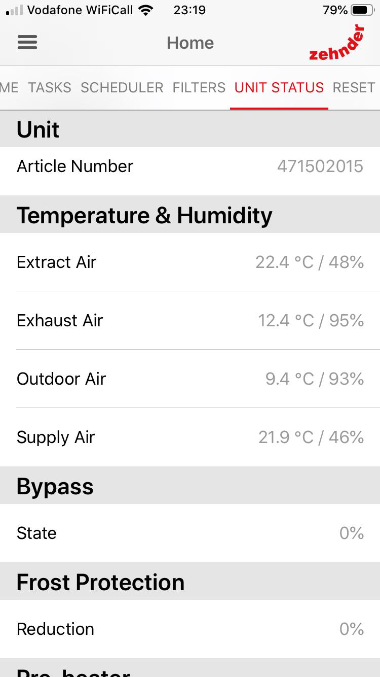

mvincentd Posted November 23, 2019 Share Posted November 23, 2019 (edited) On 19/11/2019 at 09:13, MikeGrahamT21 said: Perhaps a unit which connects to your phone rather than has a control panel may be a better option, but these are hard to come by at the minute. My Zender q350 does this, and i'm addicted to constantly checking the external/supply/extract/exhaust air temperatures with it. It's been really interesting as we've used no other heating so far, so to see how effective mvhr is (beyond expectations) at maintaining fresh but warm air. @pocsterhot return is pipe out of tank bottom right in pic, goes through red lever into brass pump, above that is (i think its called a thermal switch?) white box monitoring pipe temp....when pipe cools to a set temp it triggers pump (except its wired via a timer too so it'll only pump at set times). Edited November 23, 2019 by mvincentd add pics. 3 Link to comment Share on other sites More sharing options...
MikeGrahamT21 Posted November 28, 2019 Share Posted November 28, 2019 On 23/11/2019 at 23:17, mvincentd said: My Zender q350 does this, and i'm addicted to constantly checking the external/supply/extract/exhaust air temperatures with it. It's been really interesting as we've used no other heating so far, so to see how effective mvhr is (beyond expectations) at maintaining fresh but warm air. @pocsterhot return is pipe out of tank bottom right in pic, goes through red lever into brass pump, above that is (i think its called a thermal switch?) white box monitoring pipe temp....when pipe cools to a set temp it triggers pump (except its wired via a timer too so it'll only pump at set times). I'm sure you'll check it less once the novelty has worn off, i've been the same with heating controls and solar generation, but its dropped off more recently. Really interesting hearing people talking about how the MVHR helps greatly with holding temperatures, an effect i didn't realise would be so pronounced. I'm considering installing a unit here next year, or possibly year after depending what happens in the coming 6 months, though i'm not expecting such great efficiencies, as I'm far from airtight at the moment (Only 2 rooms and a hallway is truly airtight at present, another 5 larger rooms still need doing, though only one out of those is really poor for airtightness). Link to comment Share on other sites More sharing options...
