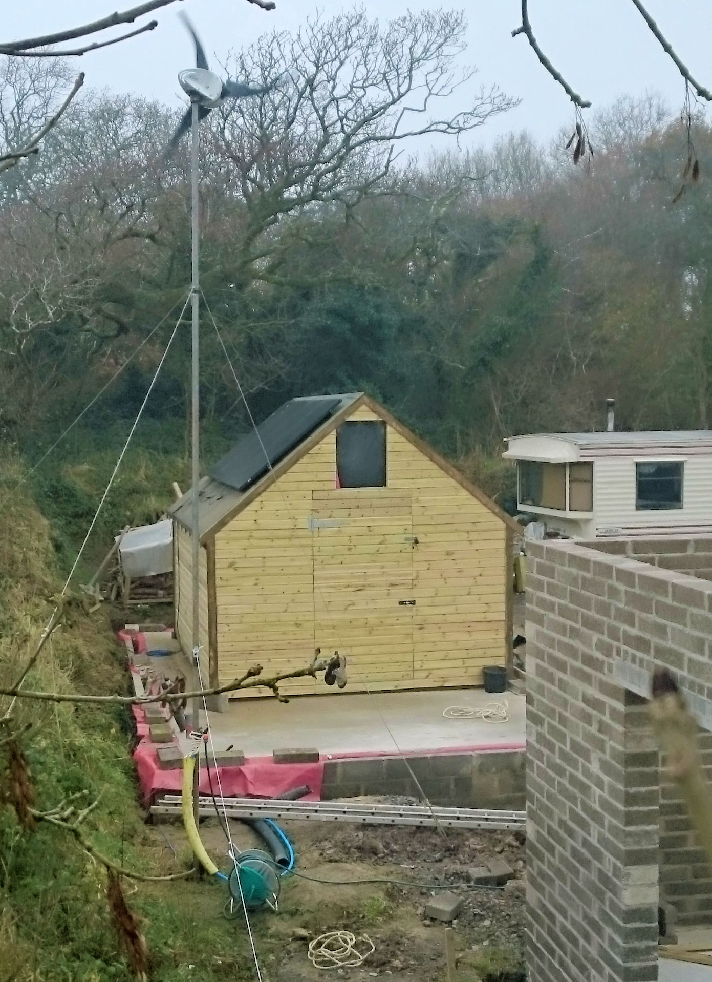

MarkH Posted December 6, 2016 Author Share Posted December 6, 2016 (edited) After all that talk about crappy off-the-shelf sheds and photos of people's projects I pretty much had to build my own. Here it is: Yeah, the window is off-center - measure twice... Edited December 6, 2016 by MarkH 1 Link to comment Share on other sites More sharing options...
Crofter Posted December 7, 2016 Share Posted December 7, 2016 Well done, that's looking pretty good! And a shed that size wouldn't have been cheap to buy. I would get some guttering up, stop splashback from marking the cladding. Link to comment Share on other sites More sharing options...
