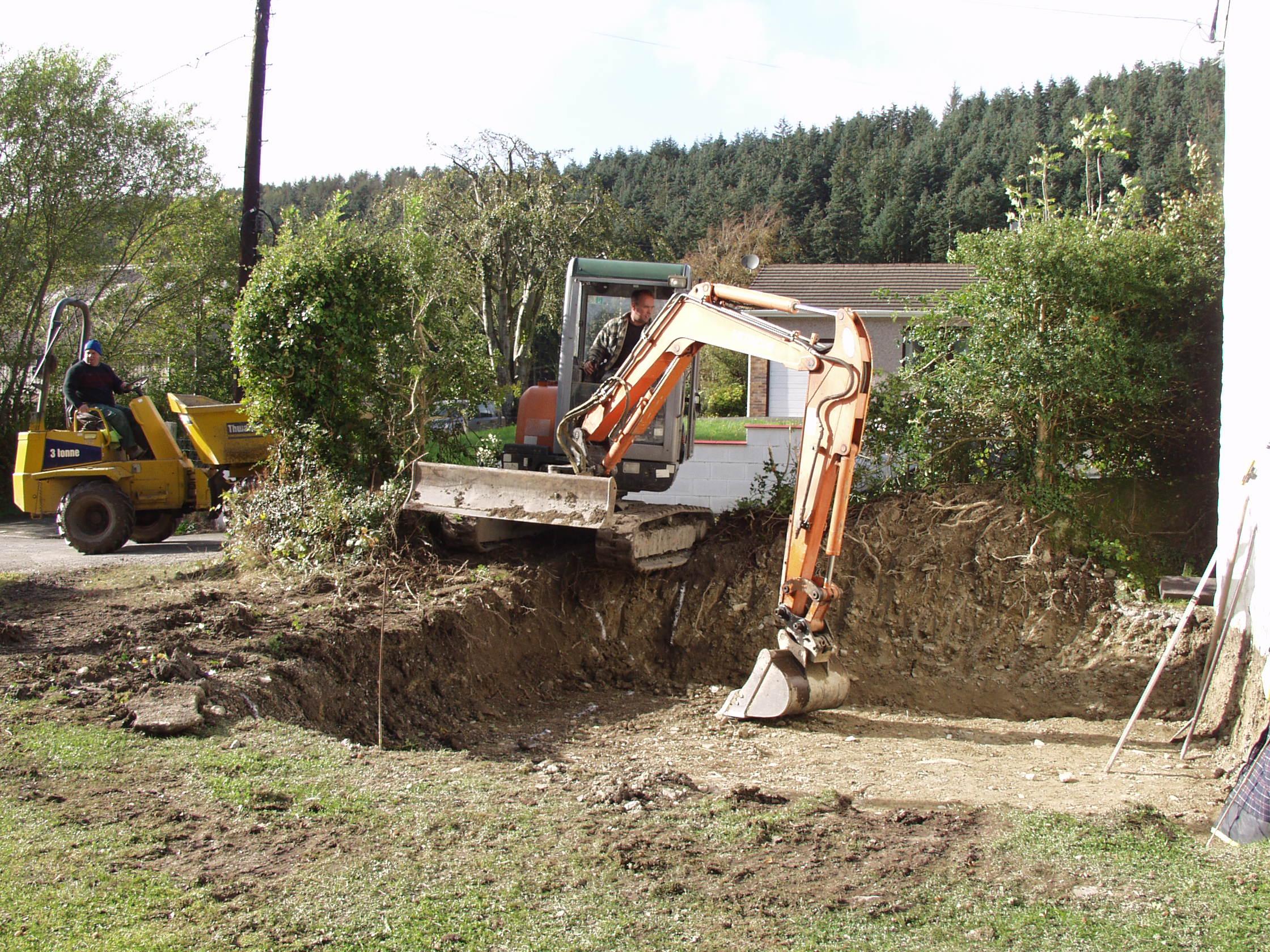

zoothorn Posted October 9, 2019 Author Posted October 9, 2019 @PeterW yes I'm taking build pics, they had to unceremoniously rip out some of my beech hedge y'day (where digger is) which upset me tbh.. but I guess needed to/ access to block & render etc. There's the digger & the forest in background, & behind dumper.. the fkr n'bors.
daiking Posted October 10, 2019 Posted October 10, 2019 16 hours ago, zoothorn said: @PeterW yes I'm taking build pics, they had to unceremoniously rip out some of my beech hedge y'day (where digger is) which upset me tbh.. but I guess needed to/ access to block & render etc. There's the digger & the forest in background, & behind dumper.. the fkr n'bors. no wonder they’re pissed with you ? I can only echo the be nice comments, it will drive them even madder.
