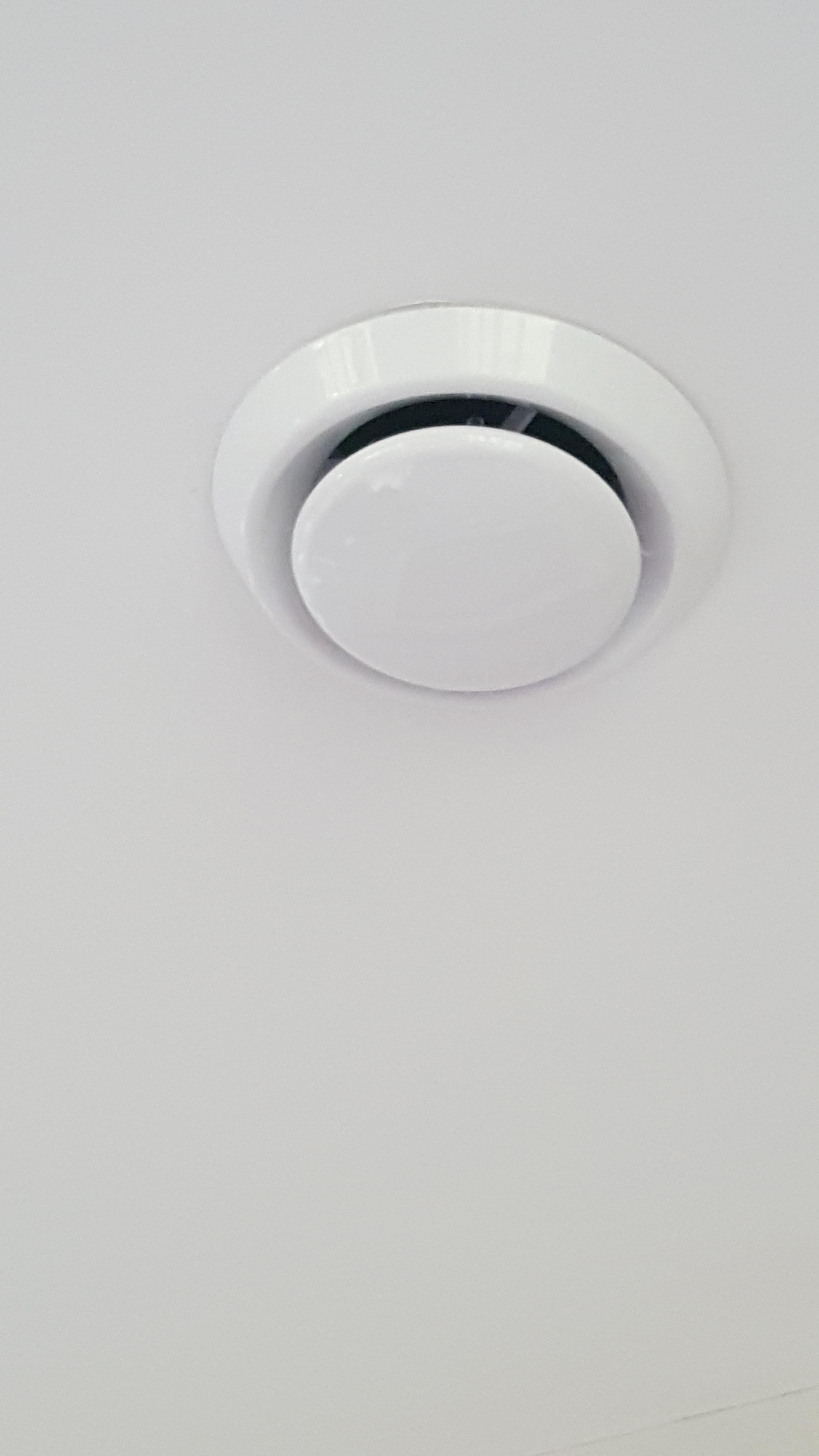

vivienz Posted September 30, 2019 Posted September 30, 2019 My MVHR vents are utilitarian at best, ugly at worst. Does anyone know of a source of less unattractive ones? For preference, I'm after something with a less shiny finish and more flush. Picture of the offending items attached. 1
Dreadnaught Posted September 30, 2019 Posted September 30, 2019 Perhaps this one, https://cvcdirect.myshopify.com/products/conus-airvalve-125mm-1, from Jeremy here: 1

vivienz Posted September 30, 2019 Author Posted September 30, 2019 On 30/09/2019 at 09:35, Declan52 said: Once you are in the house a while you don't even notice them on the ceiling. Expand Sorry, Declan, but we've been in for 7 weeks and I still hate them. I do agree with @epsilonGreedy that it's the protrusion that troubles me, along with the shine against my flat matt white ceilings. The link that posted from an earlier thread looks promising. @AnonymousBosch I didn't say I wanted pretty, just less ugly. I'm a realist with things like this and have learned to manage my expectations. 1
vivienz Posted September 30, 2019 Author Posted September 30, 2019 On 30/09/2019 at 10:06, Onoff said: Paint them matt? Expand I did consider that but they are still nowhere near flush. I've got my eye on the concave ones, which is what I should have had in the first place but got what I was given.

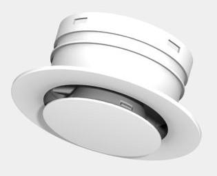

Jeremy Harris Posted September 30, 2019 Posted September 30, 2019 The CVC ones we have are pretty discreet, probably the closest to a flush terminal as it's realistically possible to get and still have radial airflow. I've just measured how far ours project from the ceiling and the surround is about 6mm thick and them the centre bit is another 12mm down from that, so about 18mm projection in total. These are non-adjustable, though, so the flow adjustment has to be done either with restrictors or valves elsewhere in the system. We used the HB+ ducting system and fitted their flow restrictors inside the distribution manifolds.

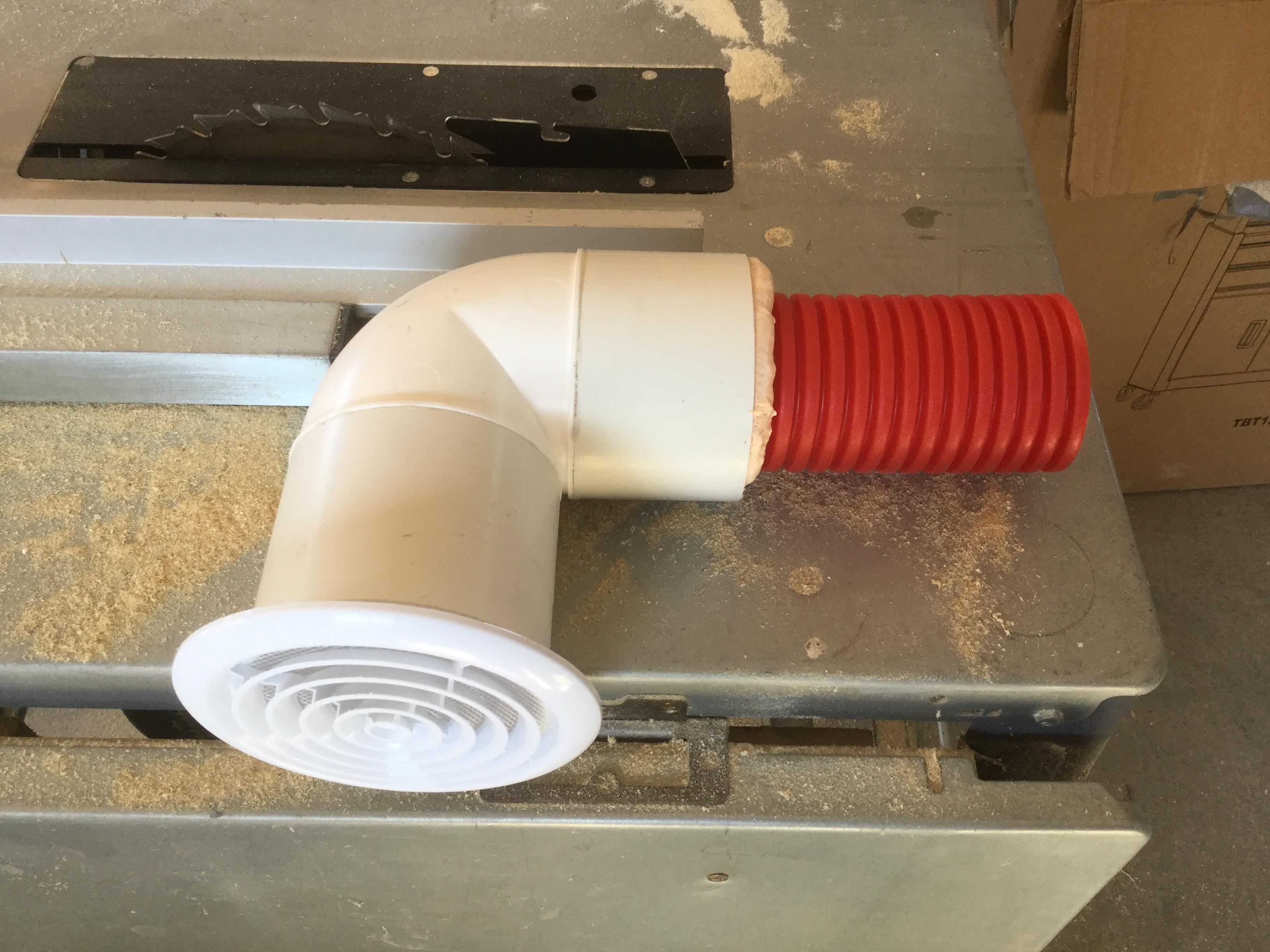

joe90 Posted September 30, 2019 Posted September 30, 2019 (edited) I made my own out of bits and like @JSHarris mine are not adjustable (previous threads talk about air noise from restrictions at the terminal). I can’t remember where I got the bits but they were dead cheap. (Note to self, get the MVHR balanced) ? Edited September 30, 2019 by joe90

Barney12 Posted September 30, 2019 Posted September 30, 2019 Why not paint them to match your ceiling? Abrade lightly with 400g wet and dry and then coat with a mat acrylic in a colour and sheen that matches.
