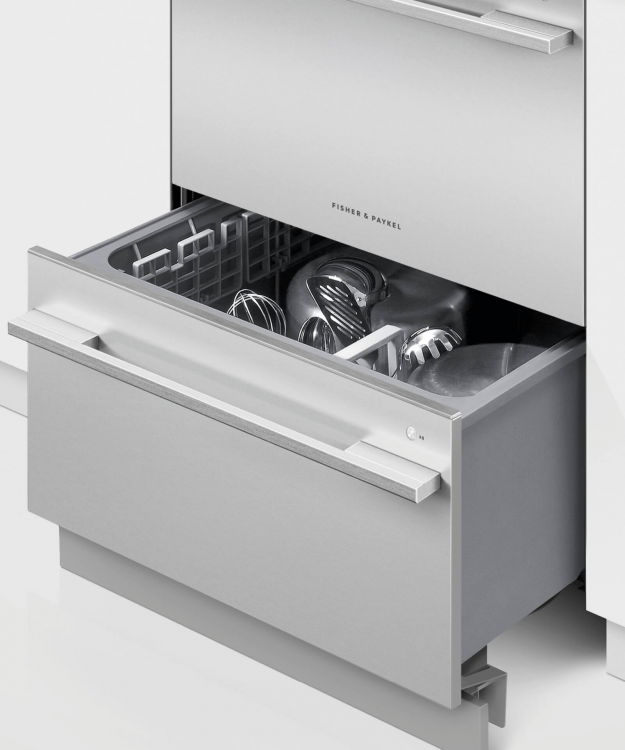

oldkettle Posted September 22, 2019 Posted September 22, 2019 Does anybody have a dishwasher installed in an elevated position? My sister has one and it seems a great idea, the only problem is it will inevitably be some way away from the sink, and the second dishwasher would be even further.
Sue B Posted September 22, 2019 Posted September 22, 2019 I am definitely going for 2 dishwashers if we ever get planning permission through on this place! Loving the idea of a raised dishwasher to save all that bending but worry about the appliances above it in that picture - steam would be a concern to me.
Dreadnaught Posted September 22, 2019 Posted September 22, 2019 (edited) 27 minutes ago, oldkettle said: Does anybody have a dishwasher installed in an elevated position? Good idea for full-sized one. In a previous flat, I had a mini counter-top dishwasher on the draining board next to the sink. Worked really well. Talking of which, how about a counter-top dishwasher for pans instead of two full-sized dishwashwers? Perhaps located in a utility room or built-in somewhere? (By the way, I picked up that counter-top dishwasher for peanuts on eBay.) Edited September 22, 2019 by Dreadnaught
