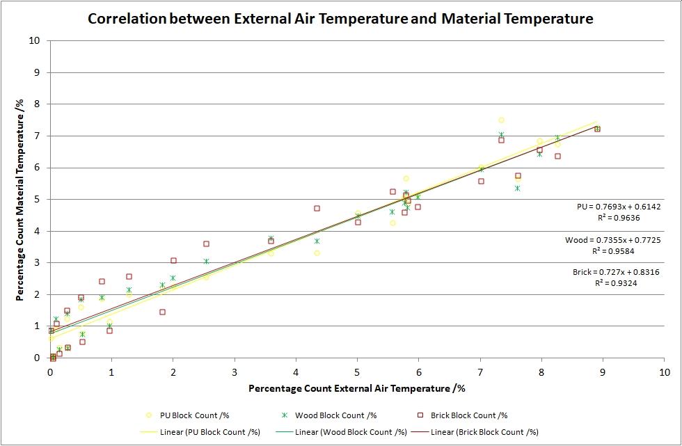

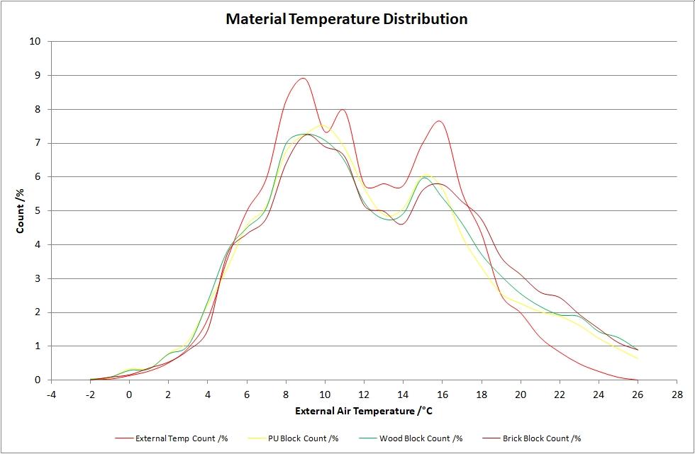

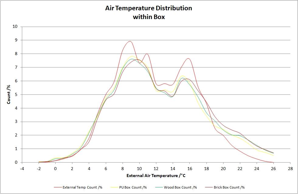

SteamyTea Posted September 7, 2019 Share Posted September 7, 2019 49 minutes ago, Sensus said: that's wrong, not the glazed area. So do you think that is what really happens. If you had a fixed structure size, and a fixed window area, with the only thing changing is the mass of the building, then temperatures would be significantly different for varying weather conditions and climate regimes? Link to comment Share on other sites More sharing options...
SteamyTea Posted September 7, 2019 Share Posted September 7, 2019 OK So I have wasted 3 years at university studying this, plus ten years thinking about it, and the last 2 years testing it. Can you show me the significant difference in these two charts. Link to comment Share on other sites More sharing options...
