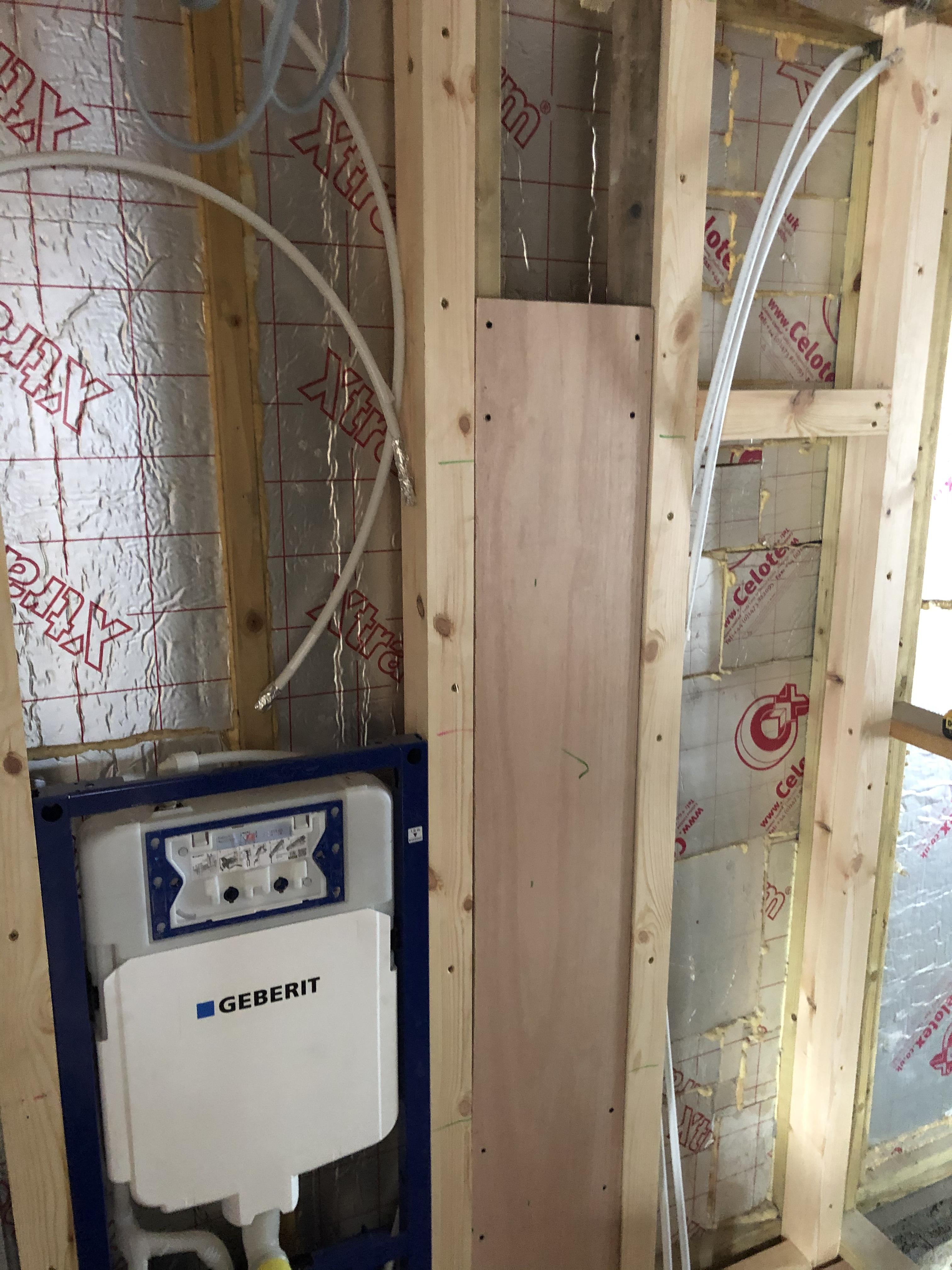

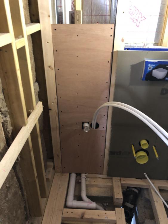

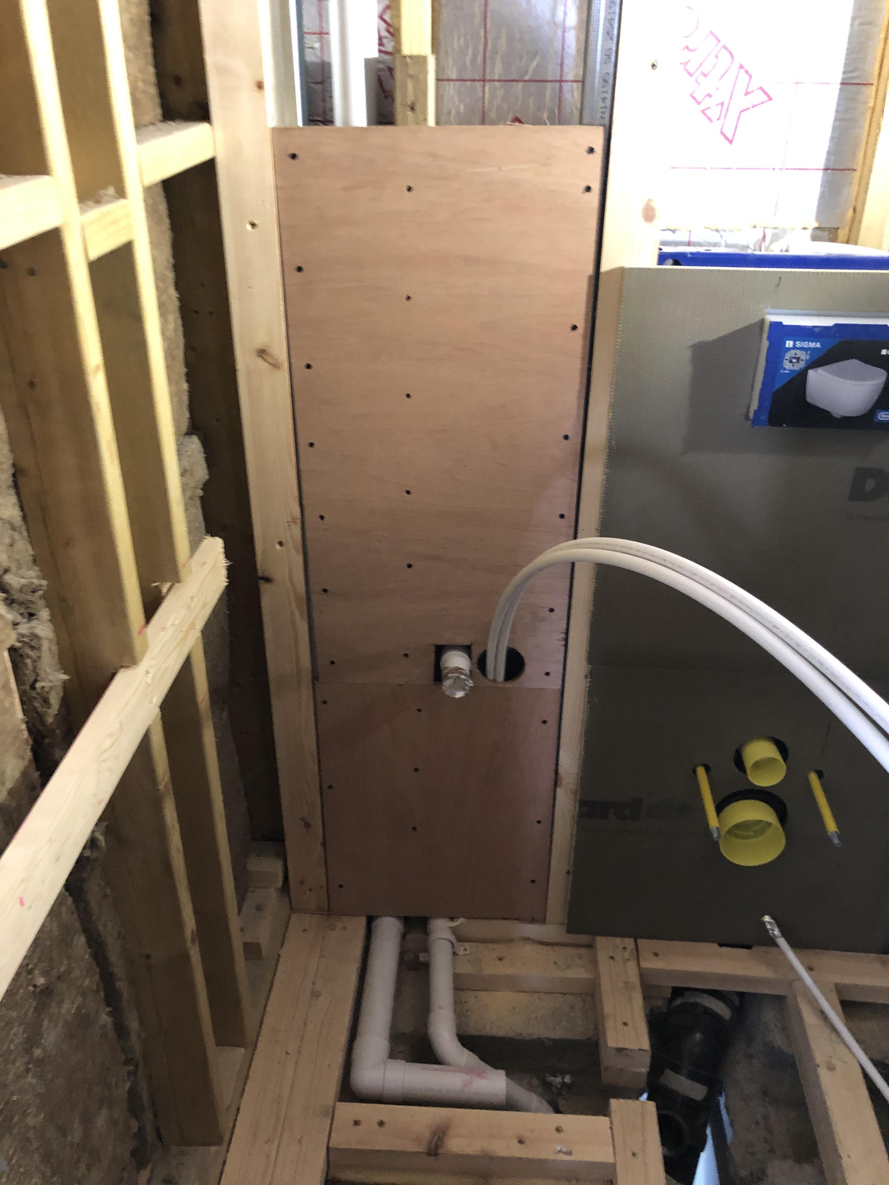

Pocster Posted April 6, 2020 Author Posted April 6, 2020 Worried, I inserted a strip of marine ply where the shower door will fix to . Should of done something on the other side similar . But that’s got delta board all over it - best remove all and do it right.

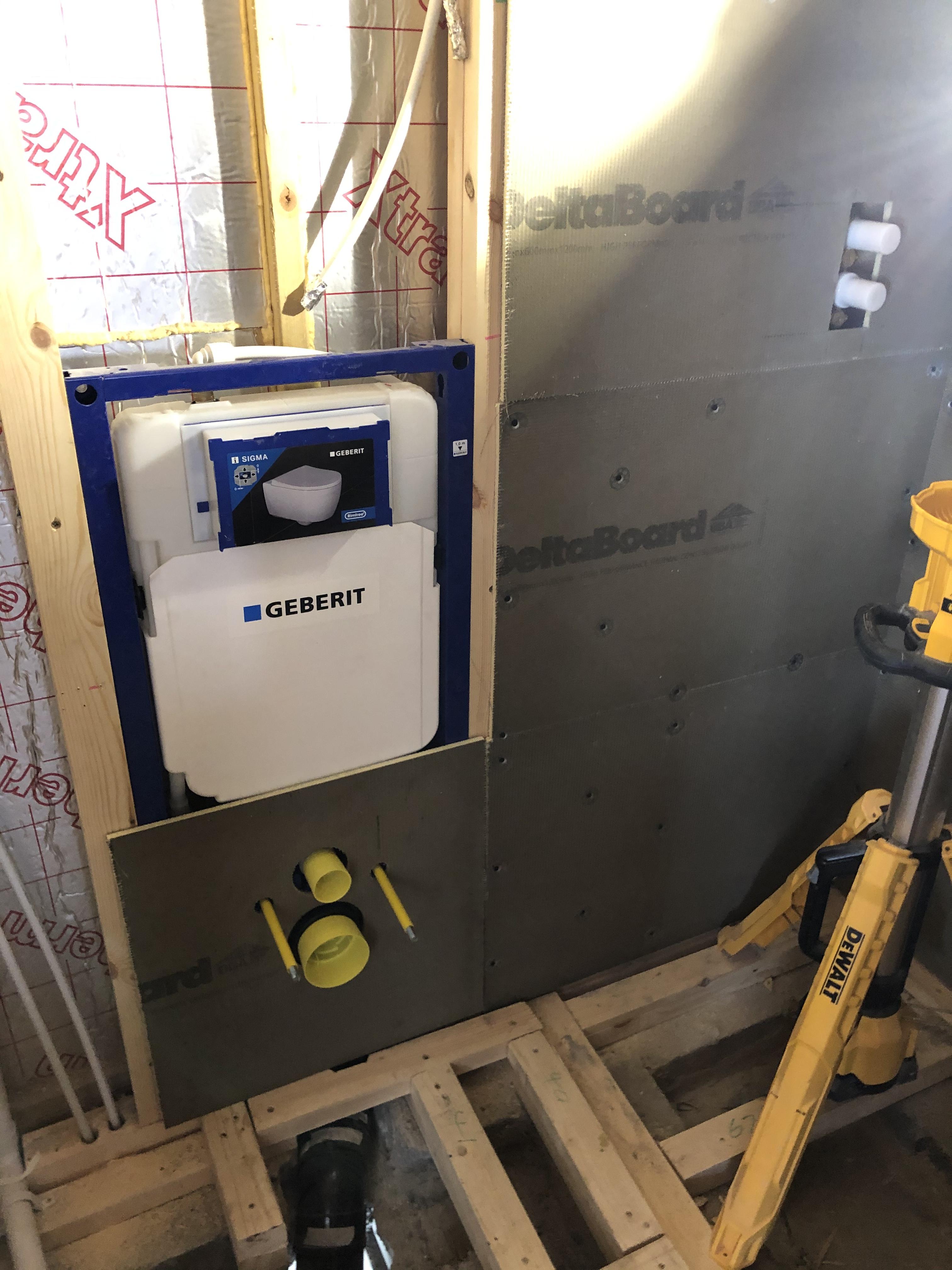

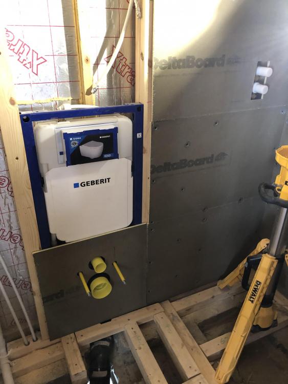

Pocster Posted April 8, 2020 Author Posted April 8, 2020 Neater than @Onoff ‘s effort . Will screw and glue toilet delta board

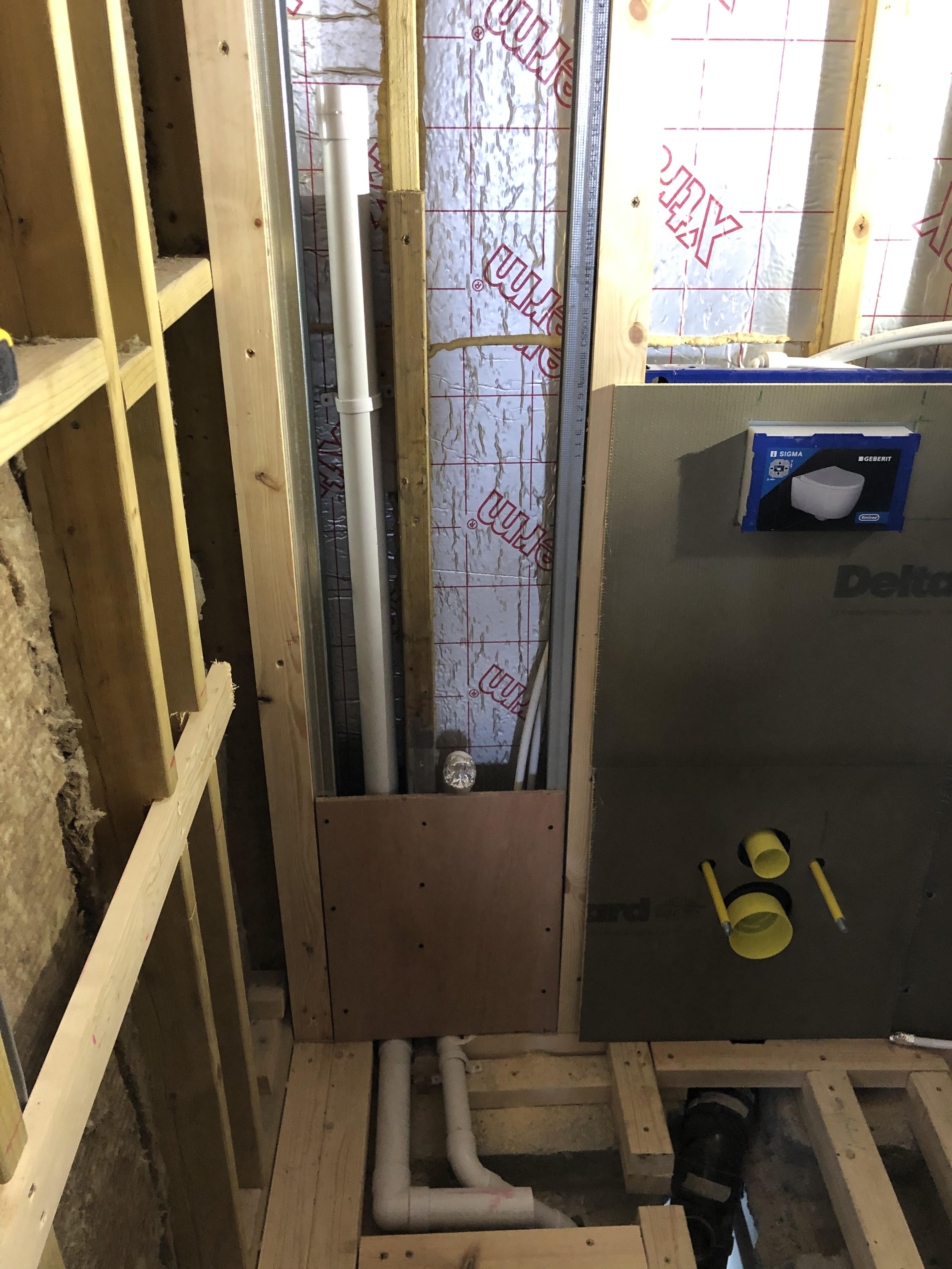

Pocster Posted April 8, 2020 Author Posted April 8, 2020 Timber shortages . Found some but delivery not until next week . Not nice but a combo of steel and marine ply ( both which I have )
Pocster Posted April 8, 2020 Author Posted April 8, 2020 Not sure what to do with feeds for taps . Guess that will do and ultimately fit to taps with flexi pipe . Think I might shorten them a bit , almost had my eye out a few times .

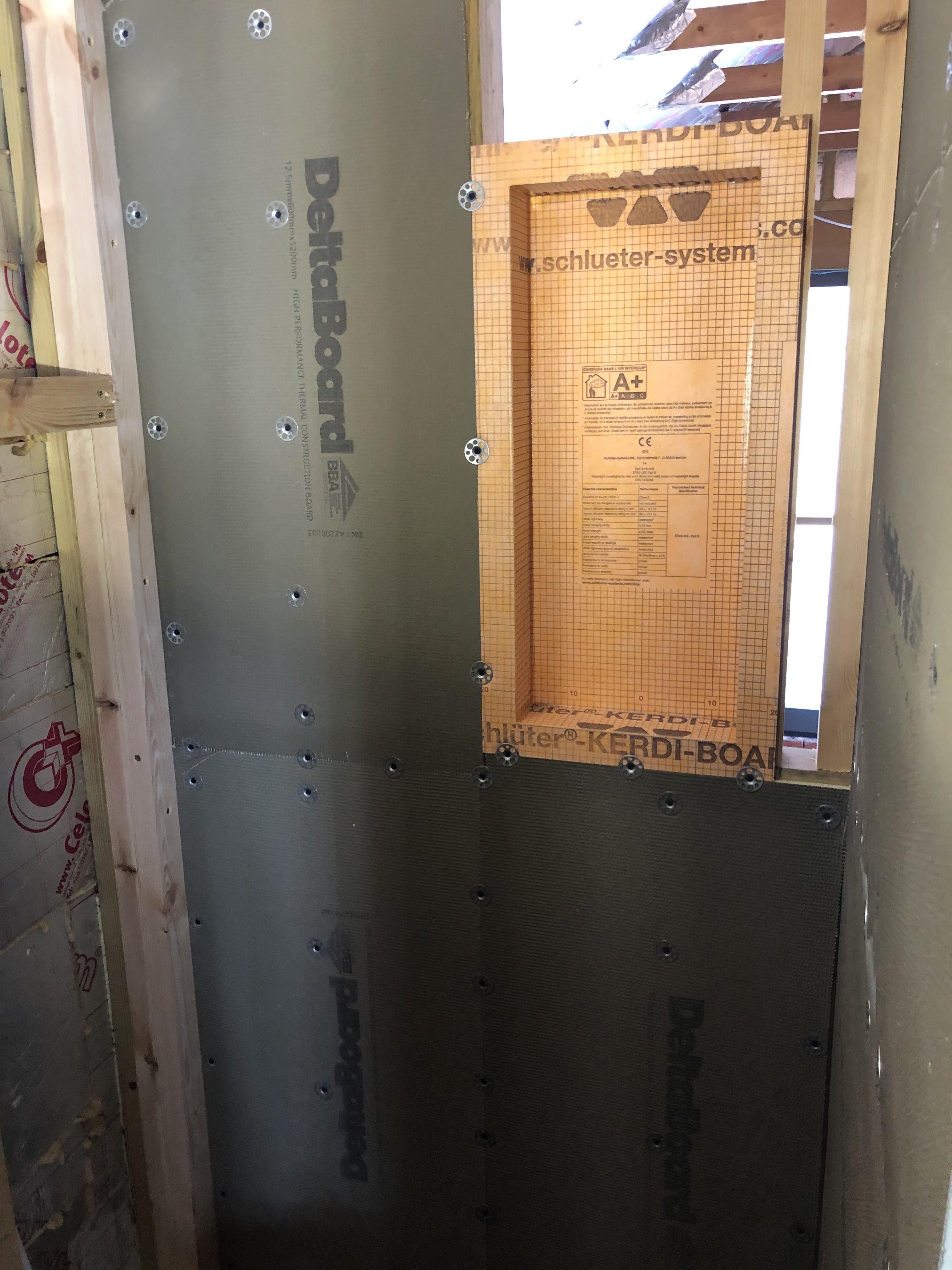

Oz07 Posted April 8, 2020 Posted April 8, 2020 What you pay for delta board. Used hardibacker on mine horrible to work with
Pocster Posted April 8, 2020 Author Posted April 8, 2020 On 08/04/2020 at 15:31, Oz07 said: What you pay for delta board. Used hardibacker on mine horrible to work with Expand Have your check Delta easy to work with
Onoff Posted April 8, 2020 Posted April 8, 2020 On 08/04/2020 at 12:42, pocster said: Neater than @Onoff ‘s effort . Will screw and glue toilet delta board Expand I see all this not going out and stuffing your face is taking it's toll! 1

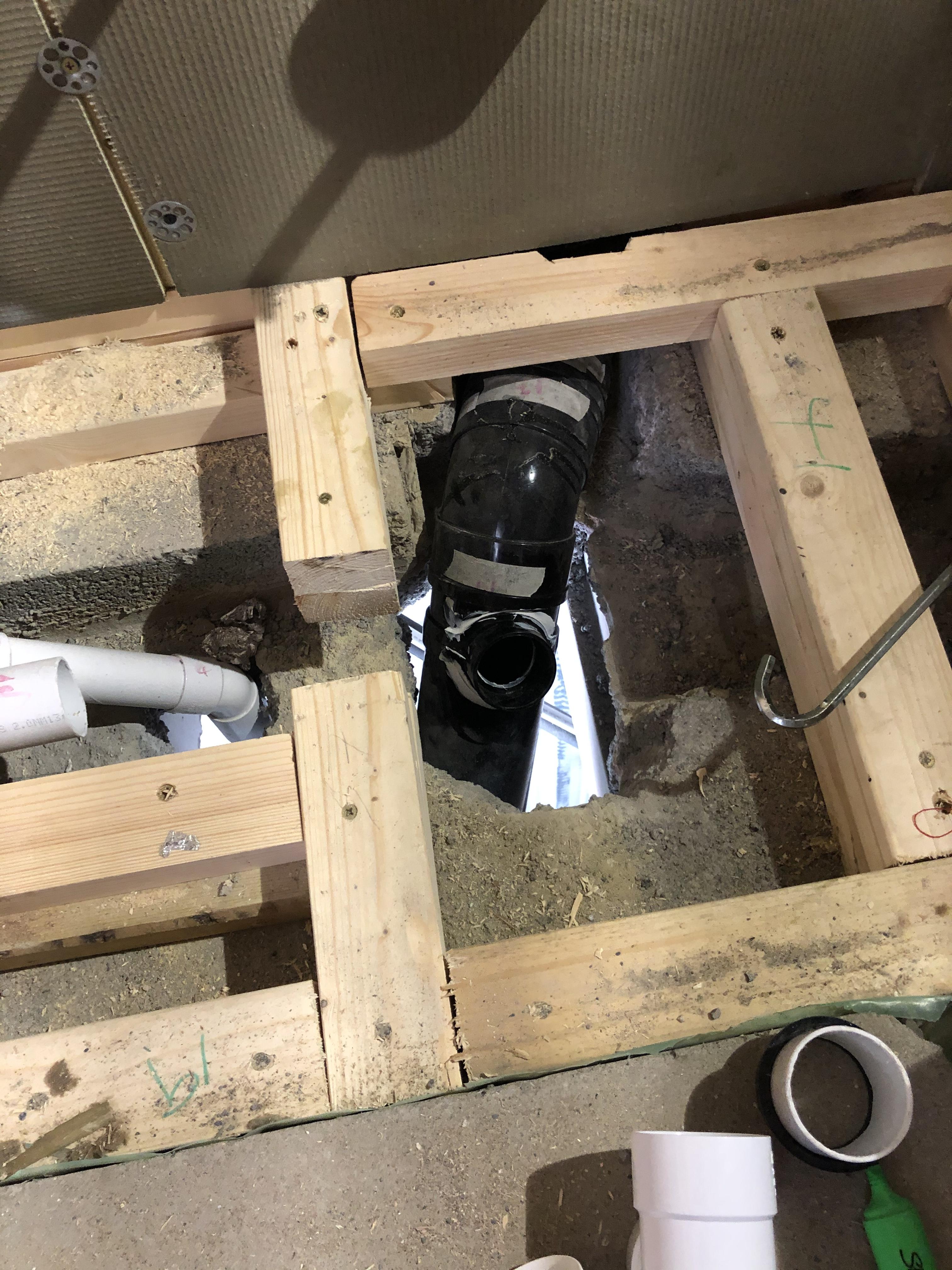

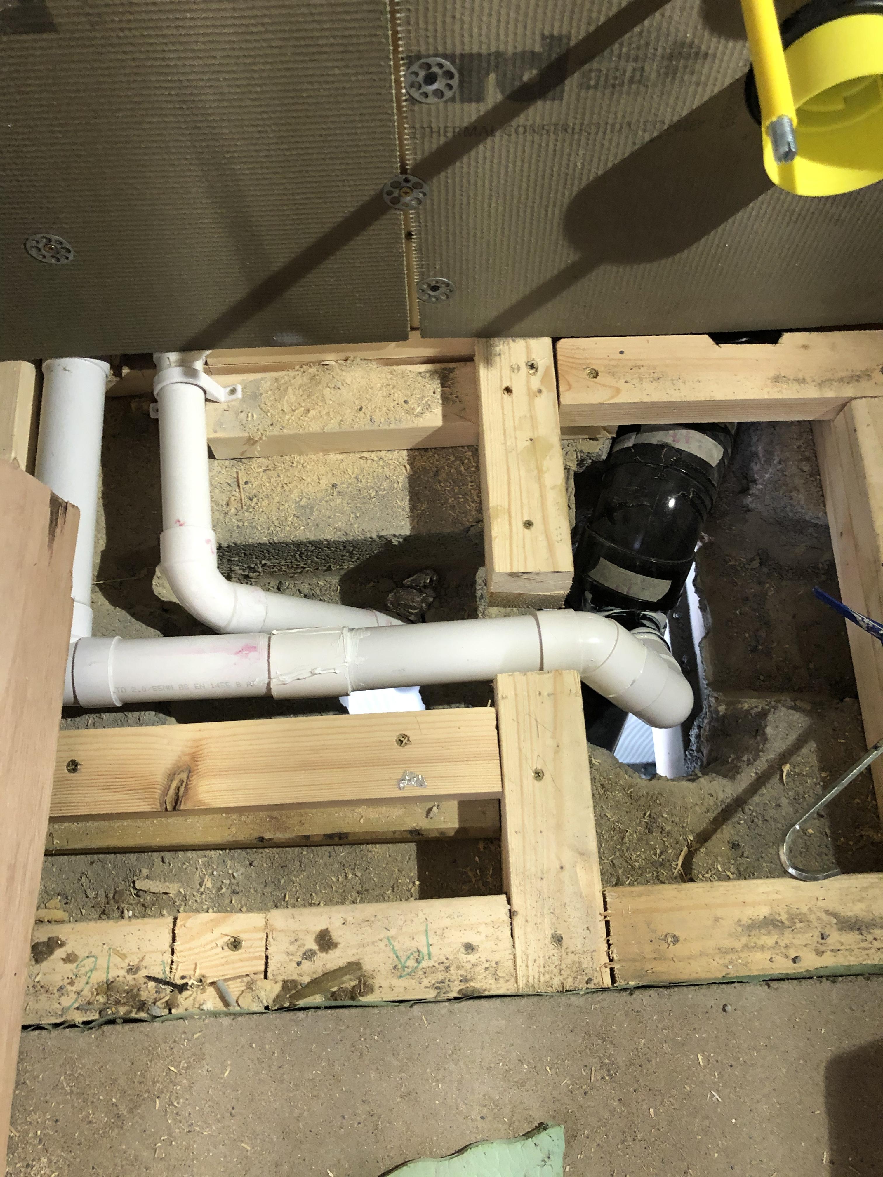

Pocster Posted April 9, 2020 Author Posted April 9, 2020 Decided to finally connect the AAV pipework . Wasn’t brave enough ( stupid enough ) to use floplast , so tiger seal to give me time . Couldn’t get the coupler in so cut it and tiger sealed it in . 1
Onoff Posted April 9, 2020 Posted April 9, 2020 On 09/04/2020 at 11:21, pocster said: Wasn’t stupid enough Expand Don't underestimate yourself mate! 1
Onoff Posted April 9, 2020 Posted April 9, 2020 I hope you're going to vacuum under there before boarding over! ? 1
Pocster Posted April 9, 2020 Author Posted April 9, 2020 On 09/04/2020 at 18:02, Onoff said: I hope you're going to vacuum under there before boarding over! ? Expand Nope ! I always leave a mess !

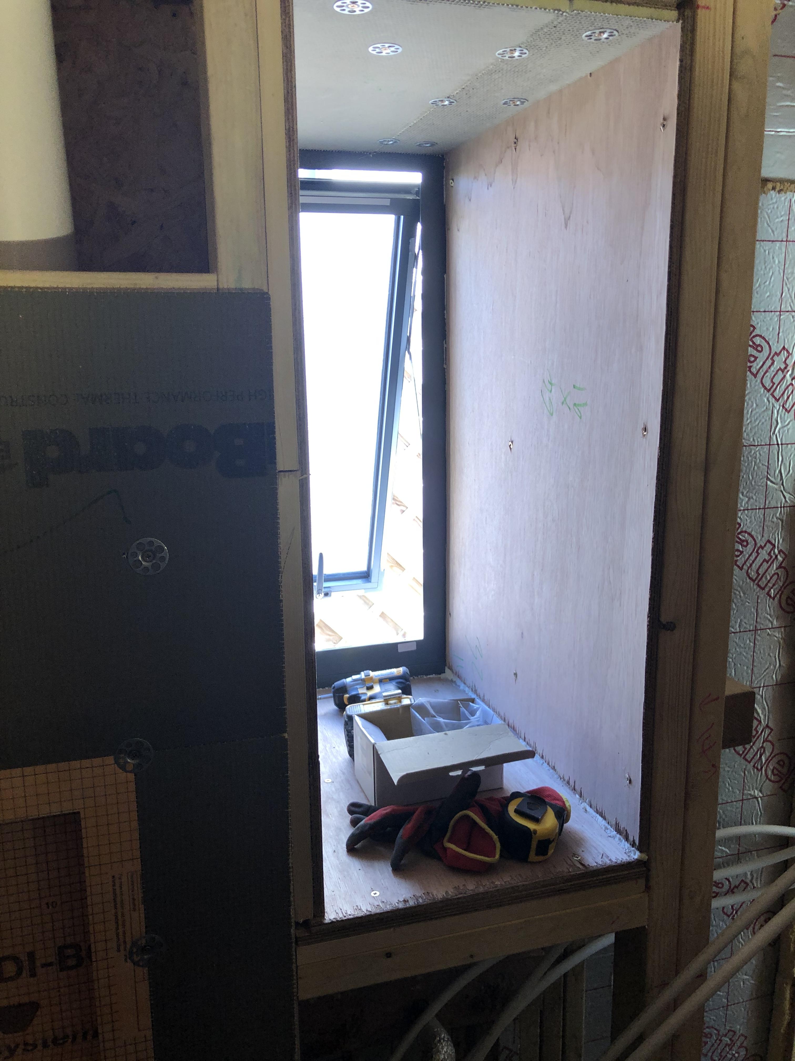

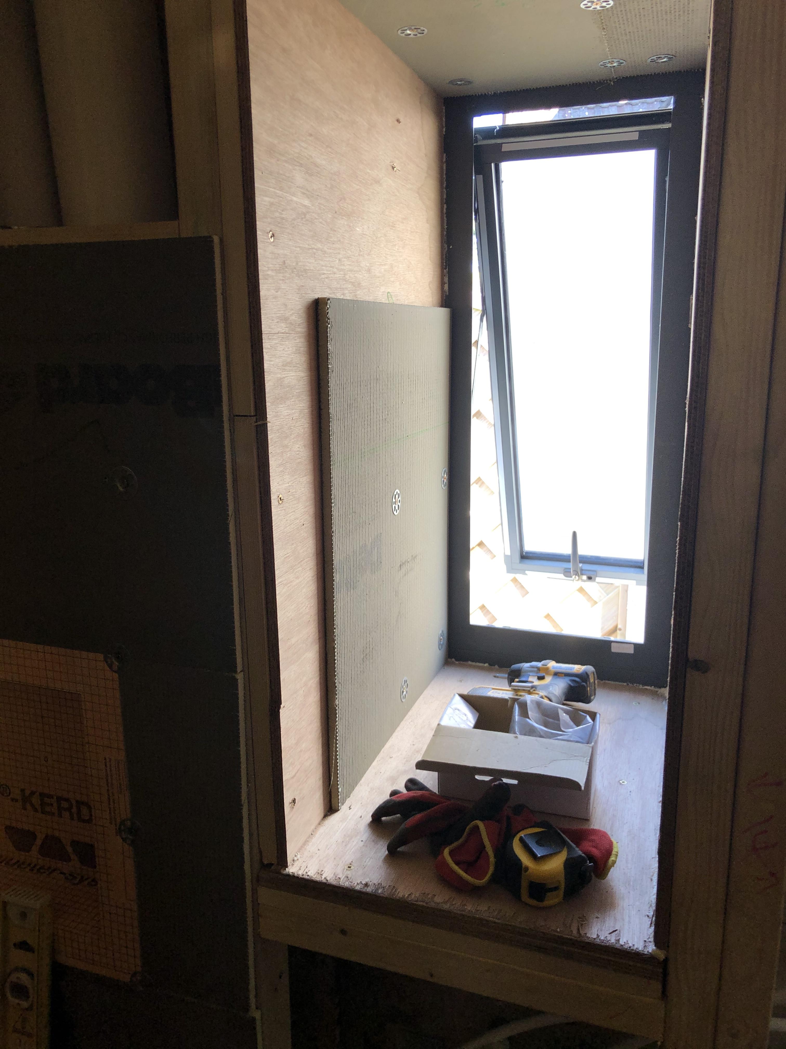

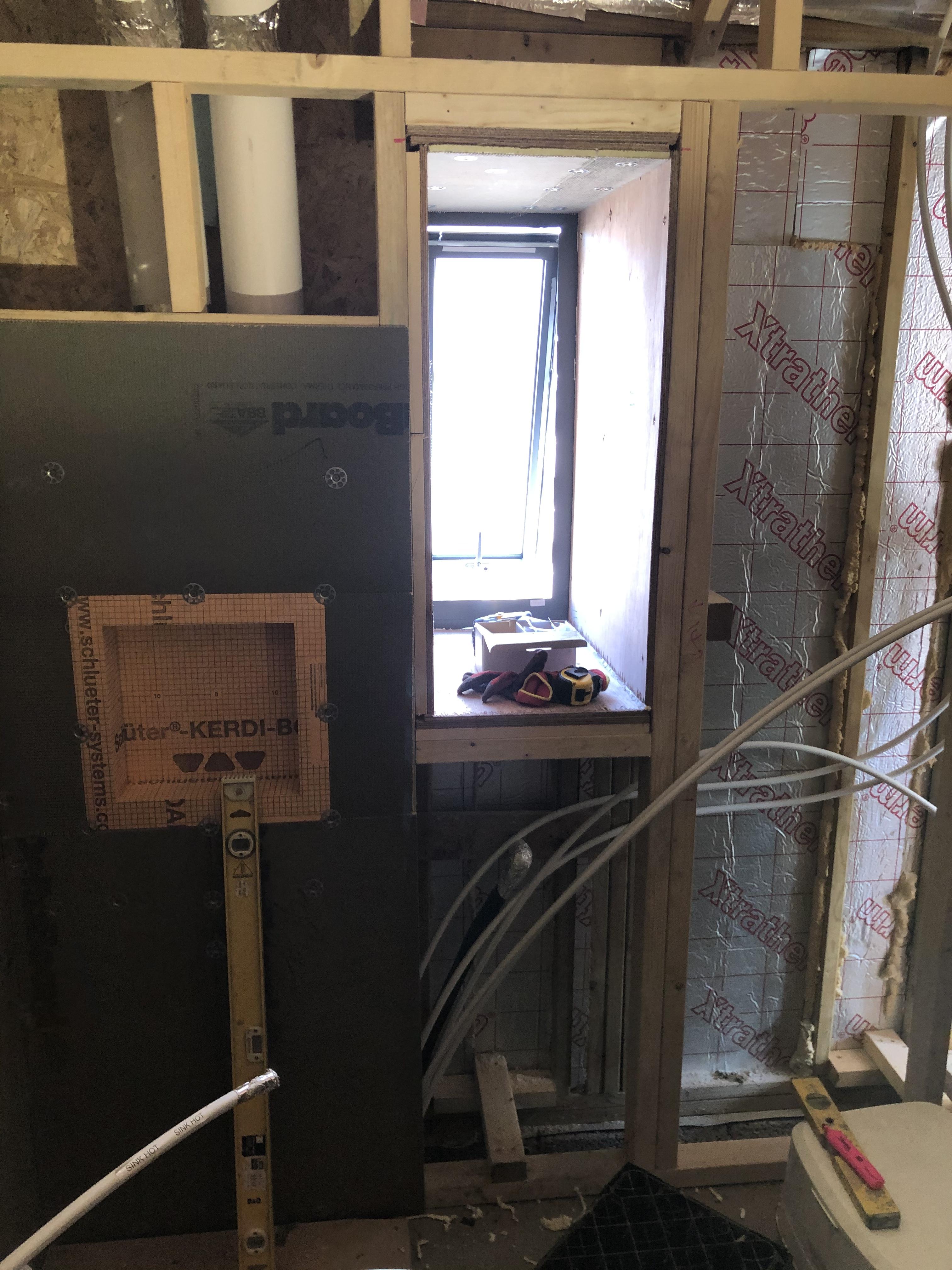

Pocster Posted April 20, 2020 Author Posted April 20, 2020 Whilst everyone continues their obsession with the corona virus thread I decided to get on with marine ply and delta board around the window / bath end .
Mr Punter Posted April 20, 2020 Posted April 20, 2020 On 20/04/2020 at 11:46, Oz07 said: How deep is that reveal?! Expand Need arms like Mr Tickle to open and close the window. 1
Onoff Posted April 20, 2020 Posted April 20, 2020 On 20/04/2020 at 12:24, Mr Punter said: Need arms like Mr Tickle to open and close the window. Expand Master of the reach around already! 1 1
Pocster Posted April 20, 2020 Author Posted April 20, 2020 On 20/04/2020 at 11:46, Oz07 said: How deep is that reveal?! Expand Very very very deep ! 65cm Also bath goes straight in front on it - so you’ll have to stand in the bath to open the window . Not much I could do about that - a small compromise
Gone West Posted April 20, 2020 Posted April 20, 2020 On 20/04/2020 at 12:28, pocster said: so you’ll have to stand in the bath to open the window Expand Plenty of remote control window openers, to save having an accident. 1
ToughButterCup Posted April 20, 2020 Posted April 20, 2020 On 20/04/2020 at 12:28, pocster said: Very very very deep ! 65cm Expand Nowhere near deep enough to accomodate your collection of rubber duckies....... 1
Onoff Posted April 20, 2020 Posted April 20, 2020 On 20/04/2020 at 12:28, pocster said: Very very very deep ! 65cm Also bath goes straight in front on it - so you’ll have to stand in the bath to open the window . Not much I could do about that - a small compromise Expand You could reach that with a short pole.....sorted! 1
Pocster Posted April 20, 2020 Author Posted April 20, 2020 On 20/04/2020 at 16:30, Onoff said: You could reach that with a short pole.....sorted! Expand My poles really long as you know !
Pocster Posted April 20, 2020 Author Posted April 20, 2020 On 20/04/2020 at 15:48, PeterStarck said: Plenty of remote control window openers, to save having an accident. Expand Oh ! More automation !!! Any links ? . How do you convert a tilt handle ( horizontal to vertical) to unlock ?? Its sad to do that for such limited use - but you’ve tempted me now !!
Gone West Posted April 21, 2020 Posted April 21, 2020 On 20/04/2020 at 16:34, pocster said: Any links ? Expand These came up on a Google search. https://www.window-openers.com/rv-2900-battery-window-opener/ https://www.window-openers.com/ks3040-electric-window-opener/ 1

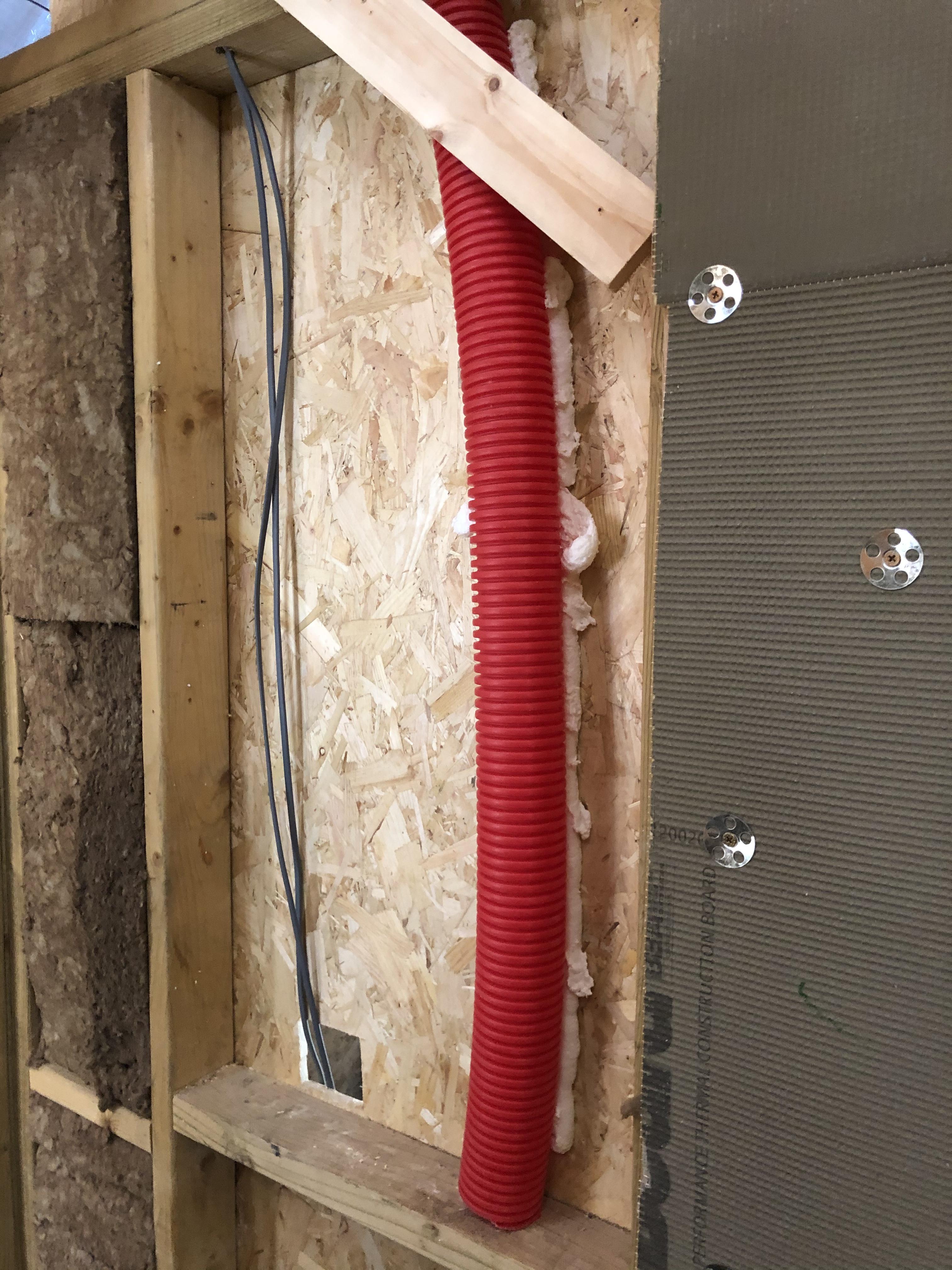

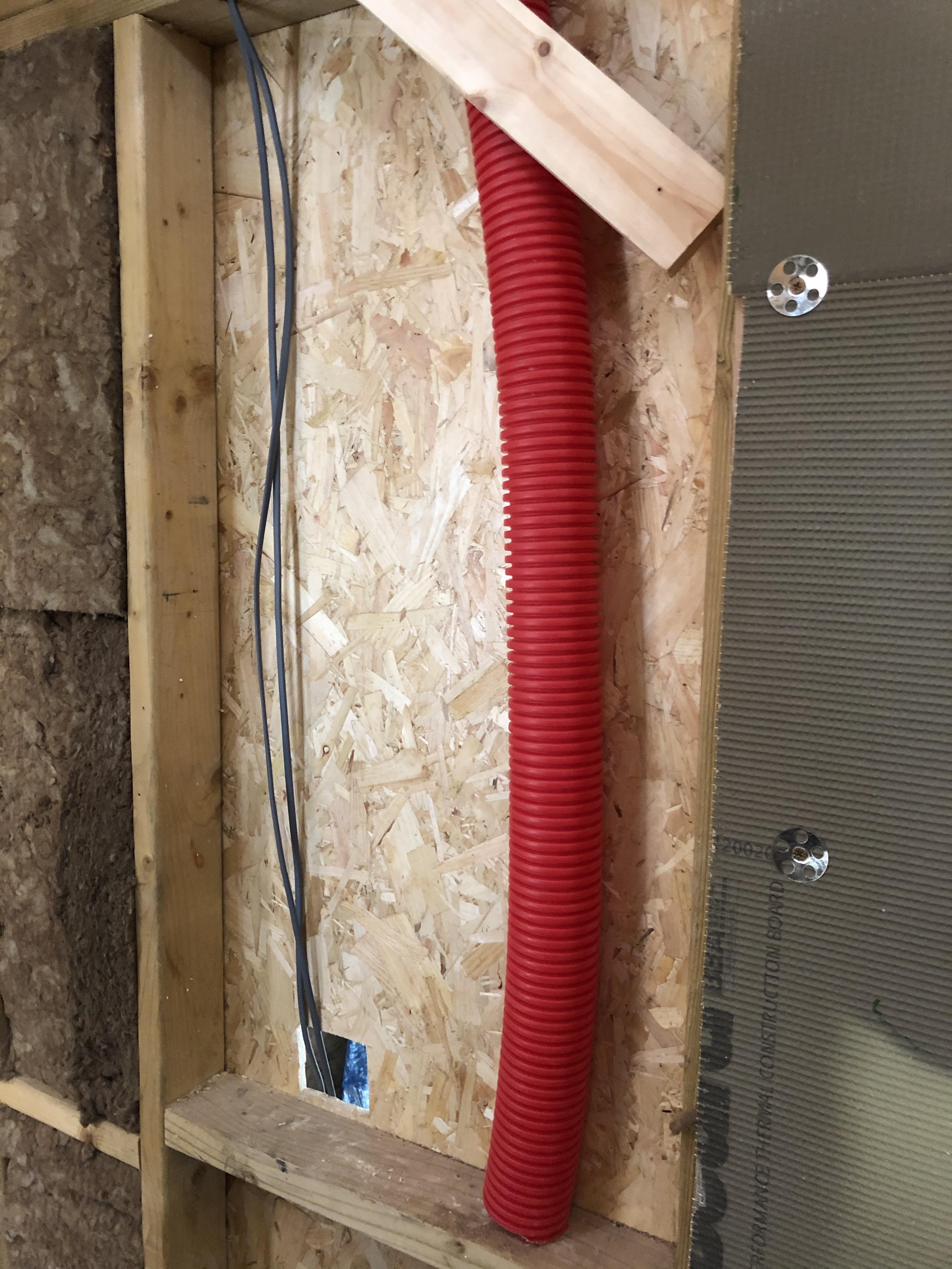

Pocster Posted April 21, 2020 Author Posted April 21, 2020 I know roughly where the bathroom heated towel radiator is going . So fed cable through . As sparky always seems worried about cabling in walls and being ‘insulated’ I.e restricted on heat dissipation - decided over the top trunking would keep him happy . Foamed it in . ( plus the red plastic pipe was spare )
