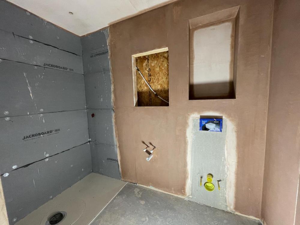

And so my thoughts move to @Onoff ‘s favourite subject - tiling .

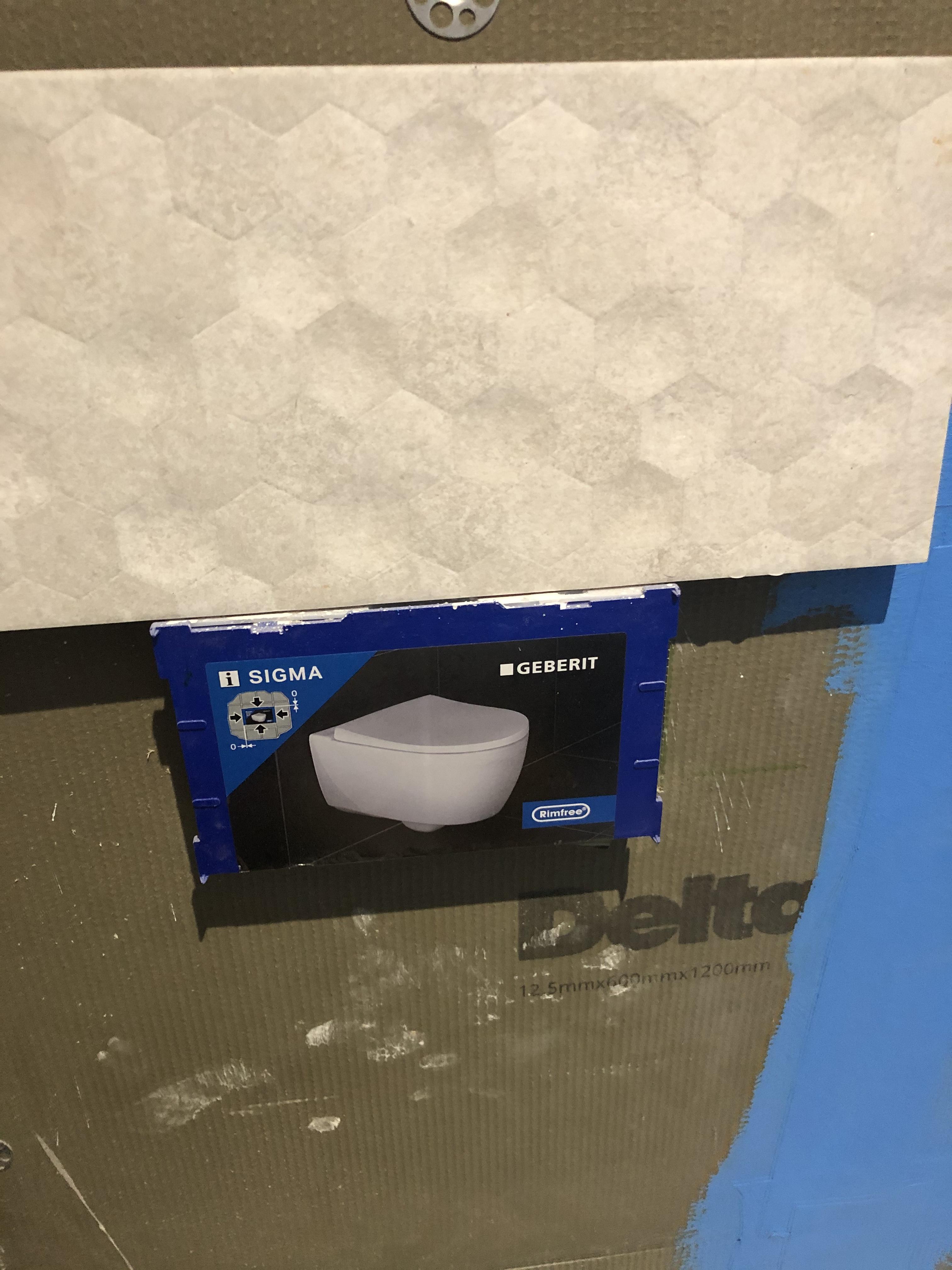

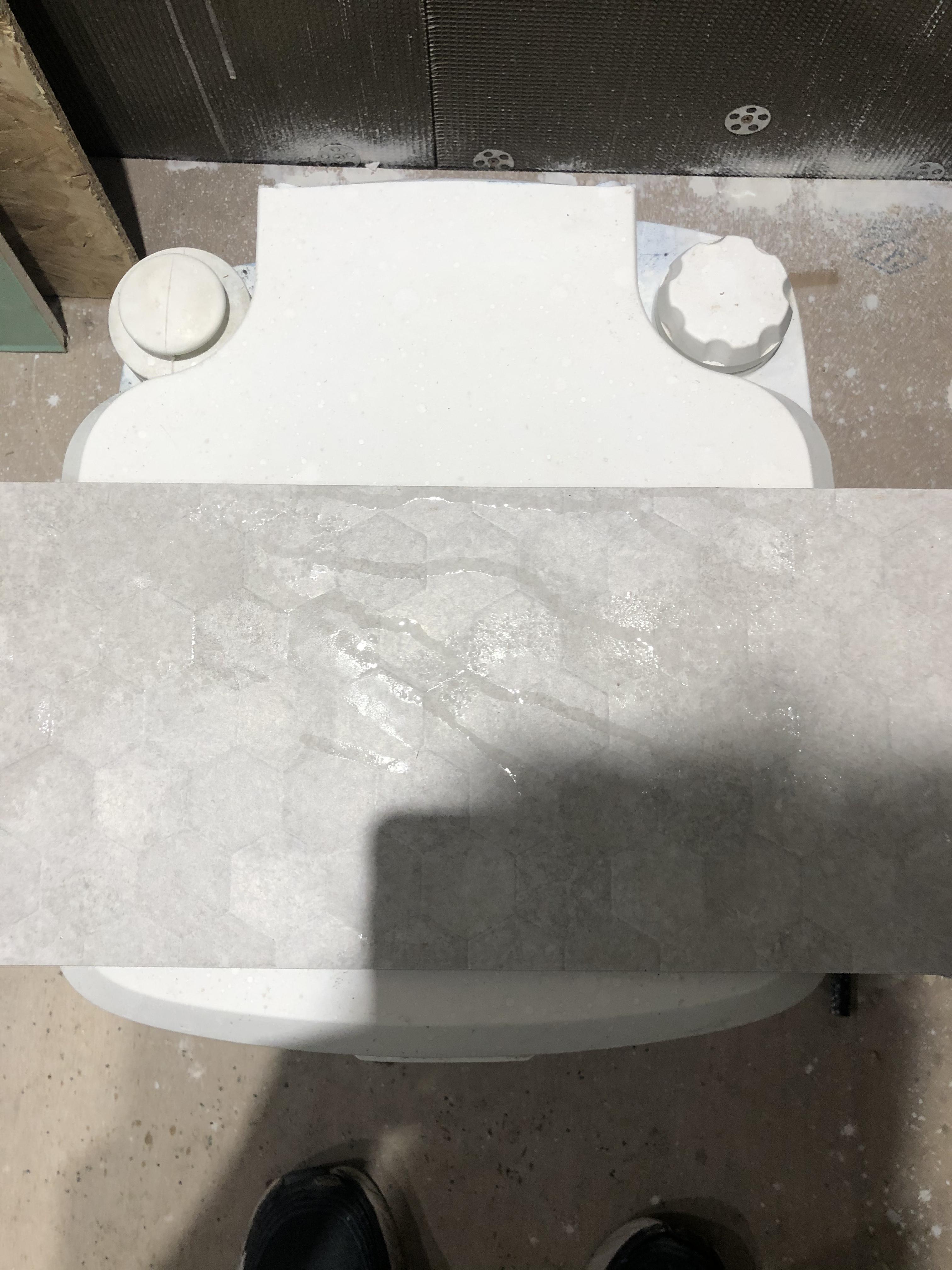

How do I line these horizontally ?
What I mean is do I avoid a grout line over the toilet flush ? Over the shower controls ?
Does it matter ? . What tiling ‘rules’ should I follow . Tiles are SWMBO choice ( obviously ) . Though I do like the subtle honey comb effect

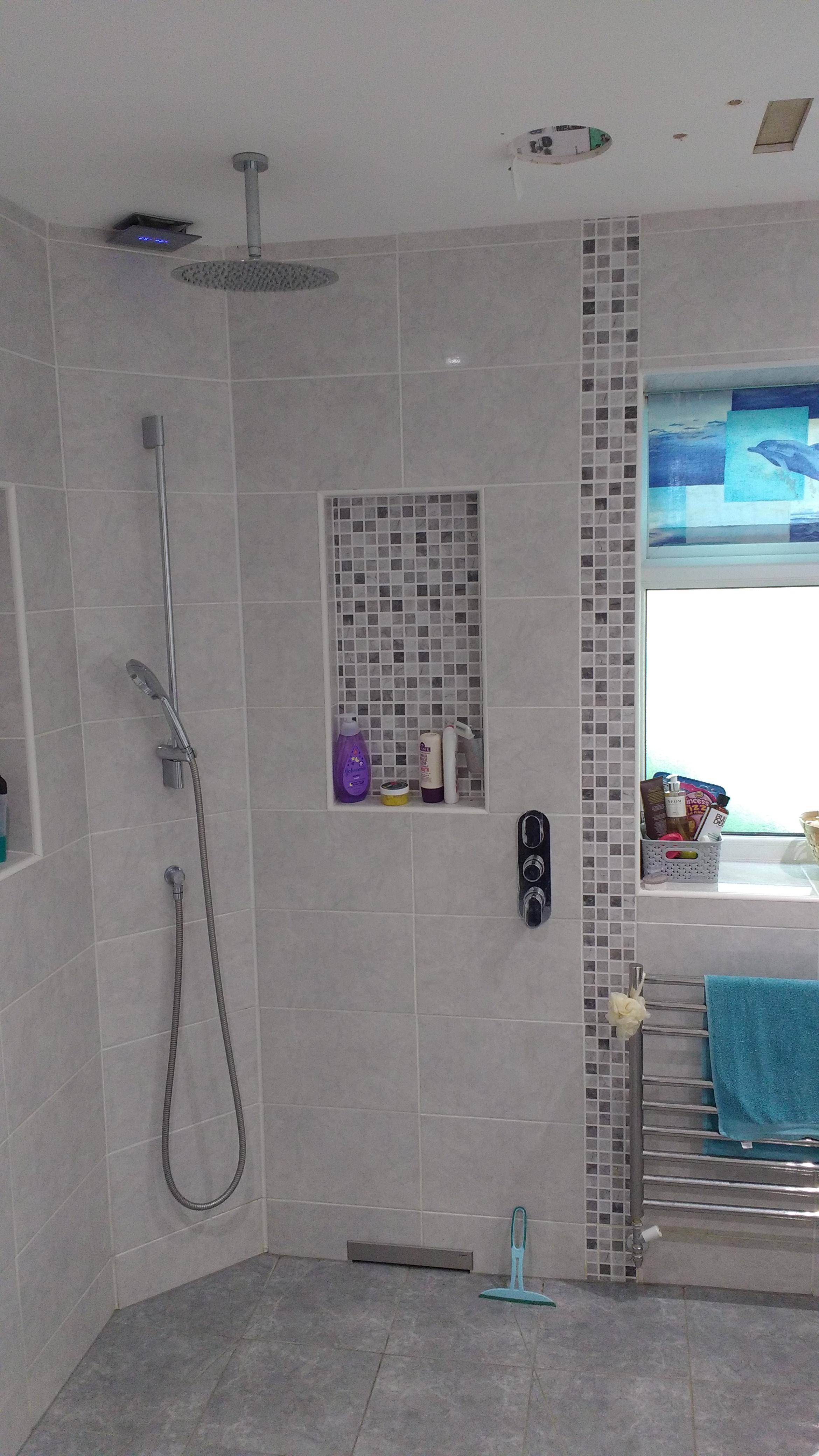

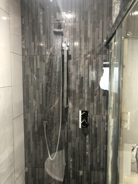

I should have moved everything up a bit to avoid the silly, time consuming rips at the ceiling.

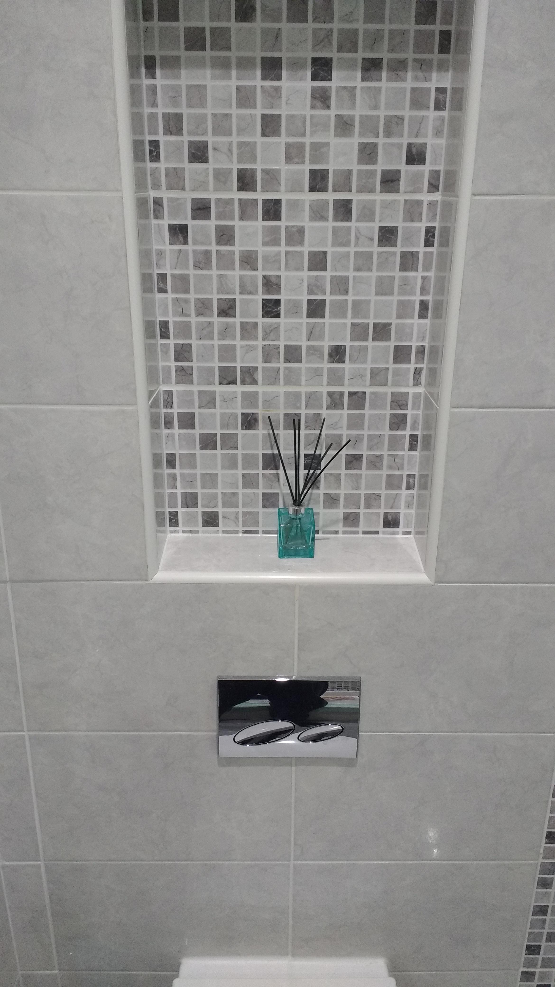

Jury's out for me on putting fittings in one tile. I did for the shower controls.
For the flush plate though I didn't. Dead easy to cut 4 squares out (though this 10mm off):
2 hours ago, Onoff said:
What NOT to do:
Yeah the rips I get . I have a sloping ceiling so if I do get rips i want them at the highest point of the ceiling not lowest where they are visible . Intend to tile first ‘round’ half a tile or so off the floor . I’m guessing though as toilet and shower on same wall I can’t get an arrangement that has a whole tile on both . I might need to ‘play’ and pick a compromise .

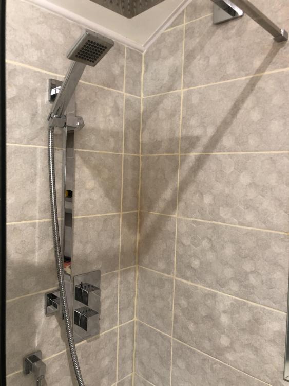

So ! On the walls do I stick adhesive all over and notch ? - back buttering the tiles ? . Seen videos where they just dot and dab ....
Wrong person to ask mate! ?
I seem to remember going OTT with adhesive, notching the wall in one direction then the tile in the other. I was squeezing more adhesive out from the joins than eventually held the tile to the wall!
The one thing I forgot was to back butter the tiles when I did the wet room corner. I just notched the floor.
(Mind I forgot to add fibres to the slab).

First round of ct1 around tray edges . Took a whole tube . Left each side so it drops . Then go over it again . Leave that now ready for Monday and ct1 with ‘ up stand ‘
Tres bien.
As for tike adhesive, just butter the wall, enough for 2 or 3 tiles ( maybe more once you pick it up ) and put x number of £2 coin sized blobs of adhesive on the back of the tile. This will give plenty of adhesion and allow you to use the same principal as used for laying the tray, eg pushing the tile in and squashing the blobs until each tile is minted lamb. Don’t butter too much wall at any one time as the adhesive has a much shorter working aka “open” time when spread thinly on the wall ;)
Beware to use a level, vertically, as you go up the wall, as this method will see you slowly coming out away from the wall as the courses rise. Keep that in check. Check course by course.
You need a bucket of clean water and a nice soft sponge + small paint brush to clean each grout line out when you get a bit of ‘ooze’ coming through. As you go, you’ll quickly get a gauge of what is too much / not enough and you’ll ooze less ( that sounds so wrong ).
Every 10 / 15 tiles laid, prise one back off and check how much % of contact you’re maintaining. 60-70% is ample, and panic yea not about gaps at the edges, just ram the grout in, when you get to that stage, and the corners will be just fine.
As far as cuts, where to start / stop etc, work it out so prominent features get the most sympathies cuts. @Onoff says he’d have raised the bottom cut higher to get rid of the rip at the ceiling. I think that would have been worse when you look what that would have done to the cut under the window ;);)

Tbh lowering the CEILING 40mm was the option I perhaps should have taken!
So many "ifs".....
Start on the wall you won't see when you first walk into the room maybe, do your "training" on that?

I could have maybe "hidden" a joint behind the towel rail and had a deeper tile below the window?
I find a lairy blind can help take the eye off of numerous cock ups...
