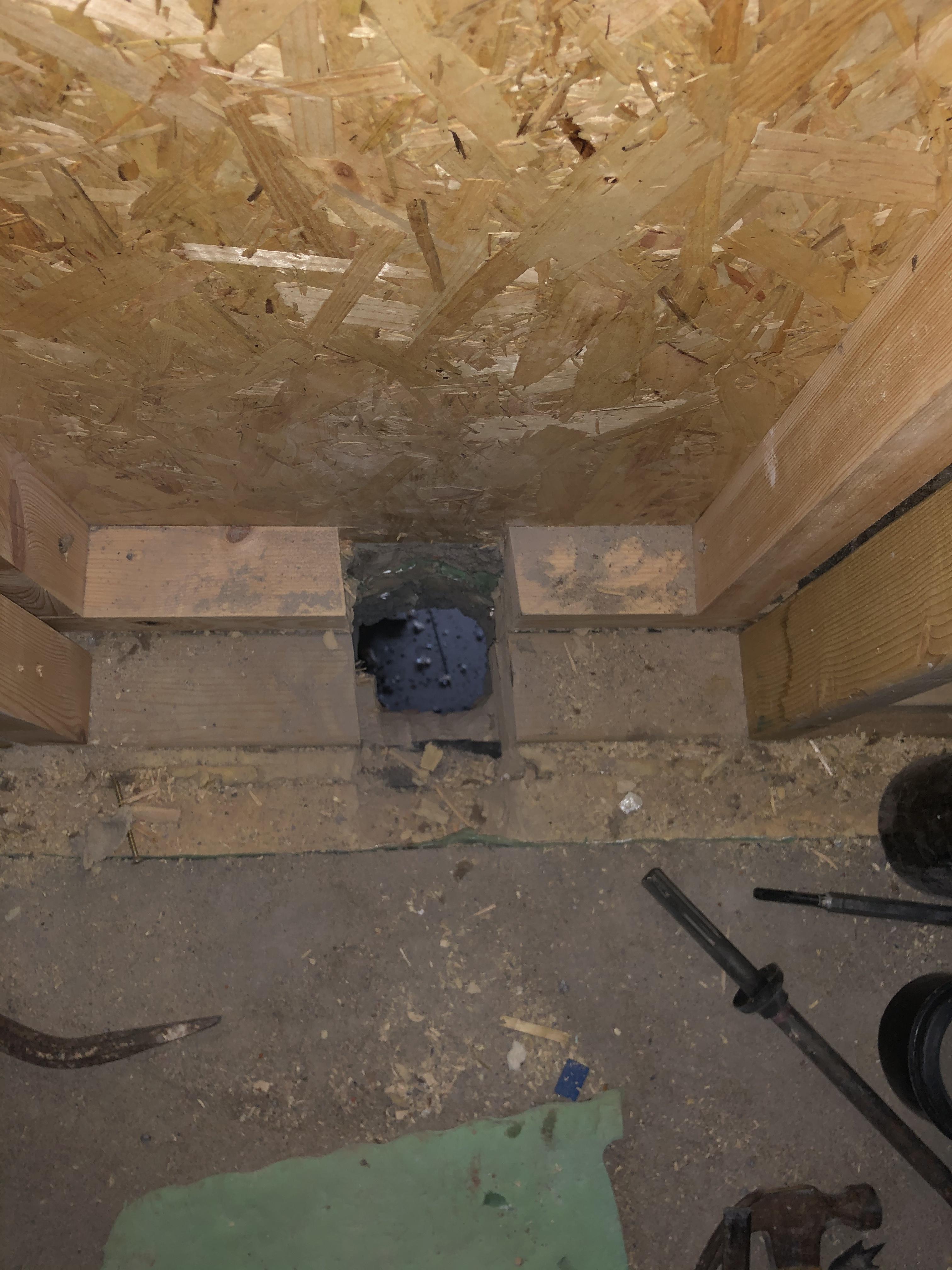

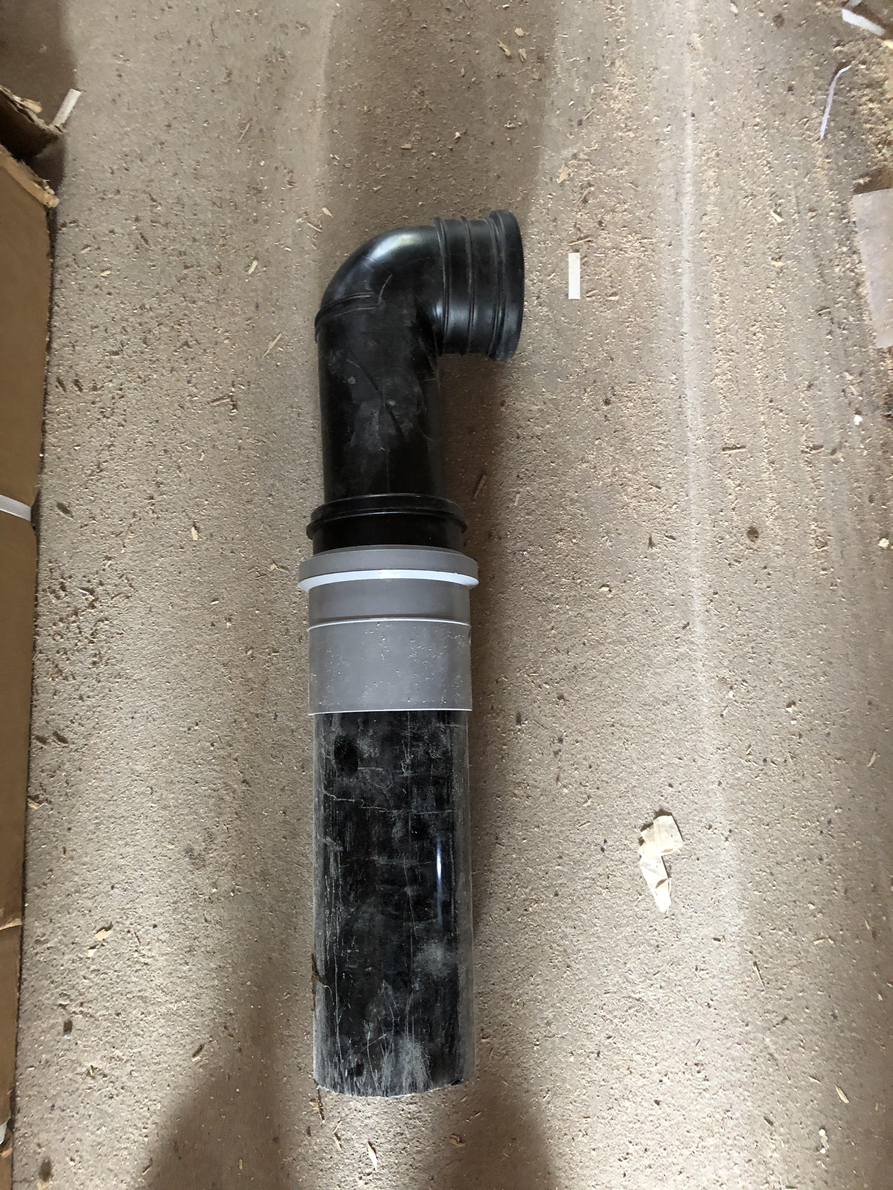

22 hours ago, pocster said:
Hmmm, sounds like a problem for another day. I'll email Geberit - they do seem to do weld stuff - so hopefully they have a magic coupler that takes push fit to weld.
I'll report back with what they say ; assuming they reply....
Geberit didn’t even send a “we acknowledge your email “ response ; so I called them .
Waste of time - kept saying I need a horizontal extender ( 366.887.16.1) which I don’t . He asked me to explain what I was trying to achieve . As soon as I went outside “geberit world “ he said it wasn’t possible to mix push fit with solvent . I asked him if he had a horizontal drainage pipe in his ceiling would he want geberit push fit or welded ? ?
After 5 seconds of silence ( and not promoting a geberit product to me ) he said welded .
I guess I was stupid expecting a geberit salesman / technical to be a ‘real world ‘ plumber .
Anyway ! I needed a solution so reluctantly and with difficulty can just squeeze a 110m through ...

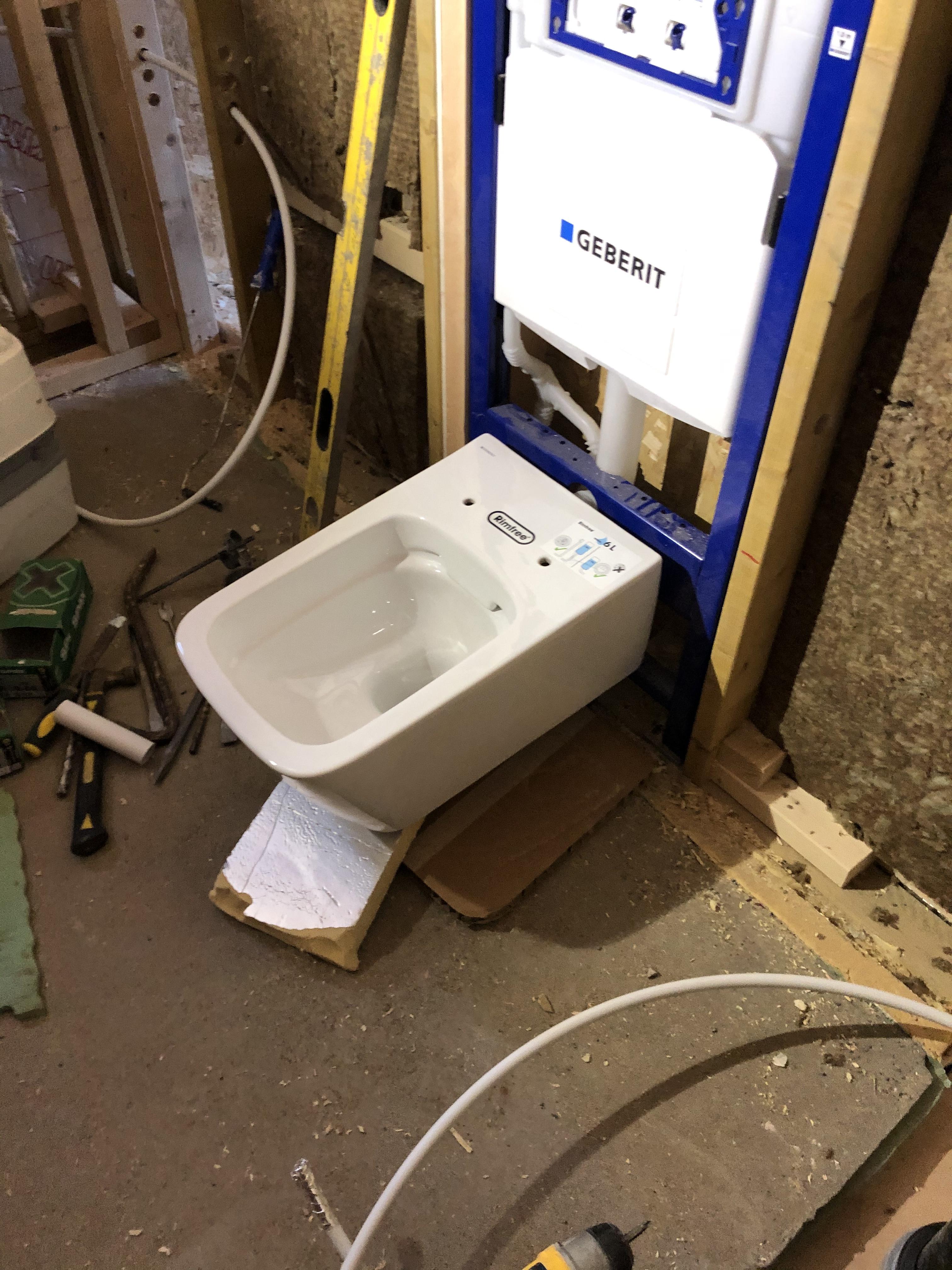

Now ! The next dilemma !

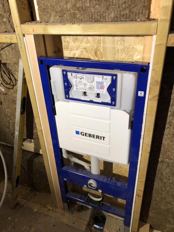

What height should a toilet be from the floor ( finished floor to top of pan ) . Wall hung ones always look lower too me - assume that’s an optical illusion though ...
Page 20 of my mega thread. The man he say 425mm from FFL to top of seat as in bit your bum is in contact with.
I went a tad higher here in keeping with some other people on here who came back in my thread. We're all pretty tall in this house anyway:
IMG-20190528-WA0004

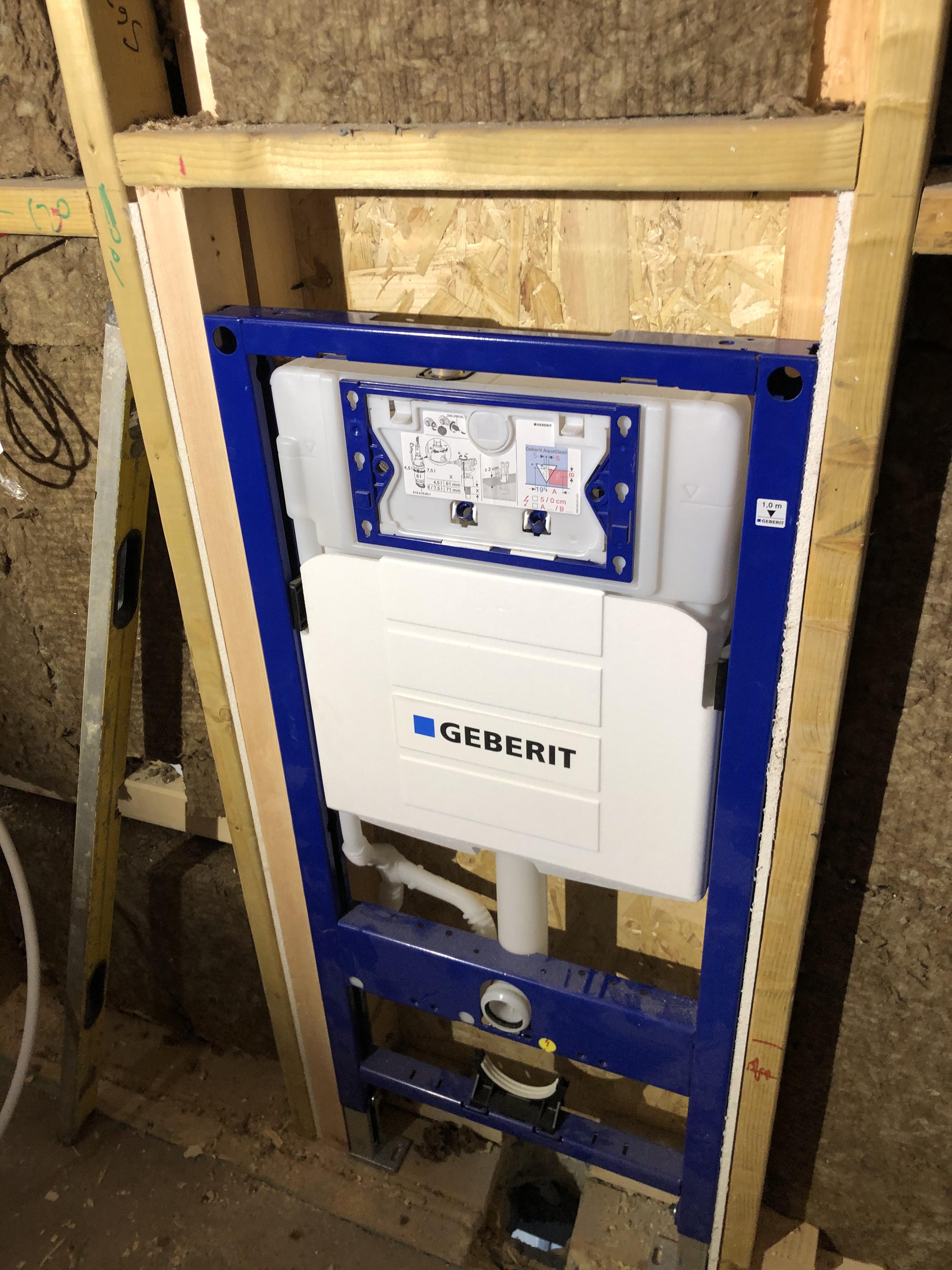

A dry ‘let’s give it a try ‘ fix .
The pan hangs just off those 2 bolts with the yellow covers ; that’s it ?
Initial ‘guess’ at height is far too low .

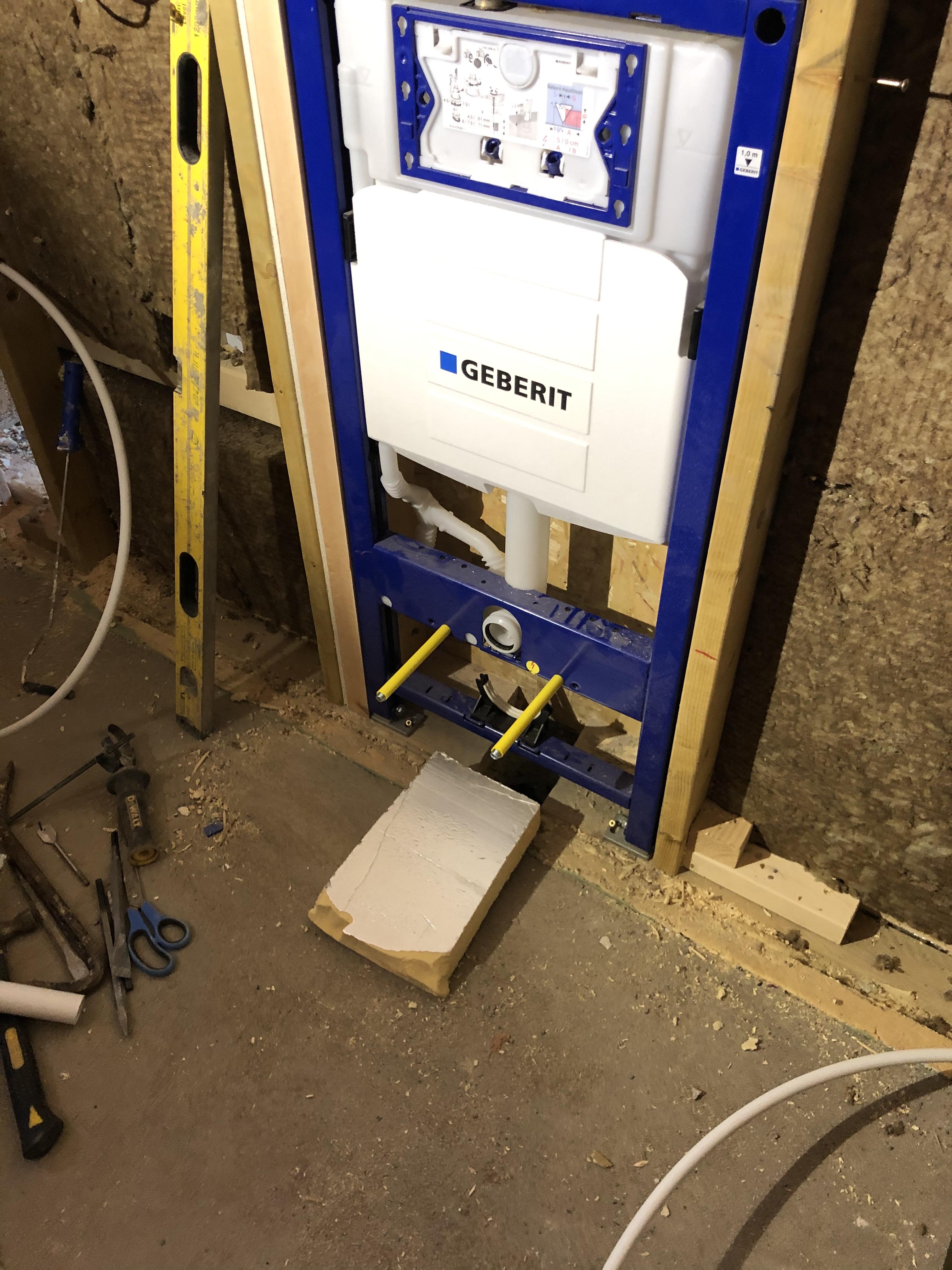

Also I see geberit give multiple ways to fix the frame . Think I’ll use every possible fixing for peace of mind
First stupid question .
I see the legs are extendable but can’t be locked in place ????!!???
Edited by pocster
Ok - stiff as hell screw return in legs . Tapping it to correct height .
Padded out with render board either side .
So tight probably doesn’t need any fixings ?
Hmmmm

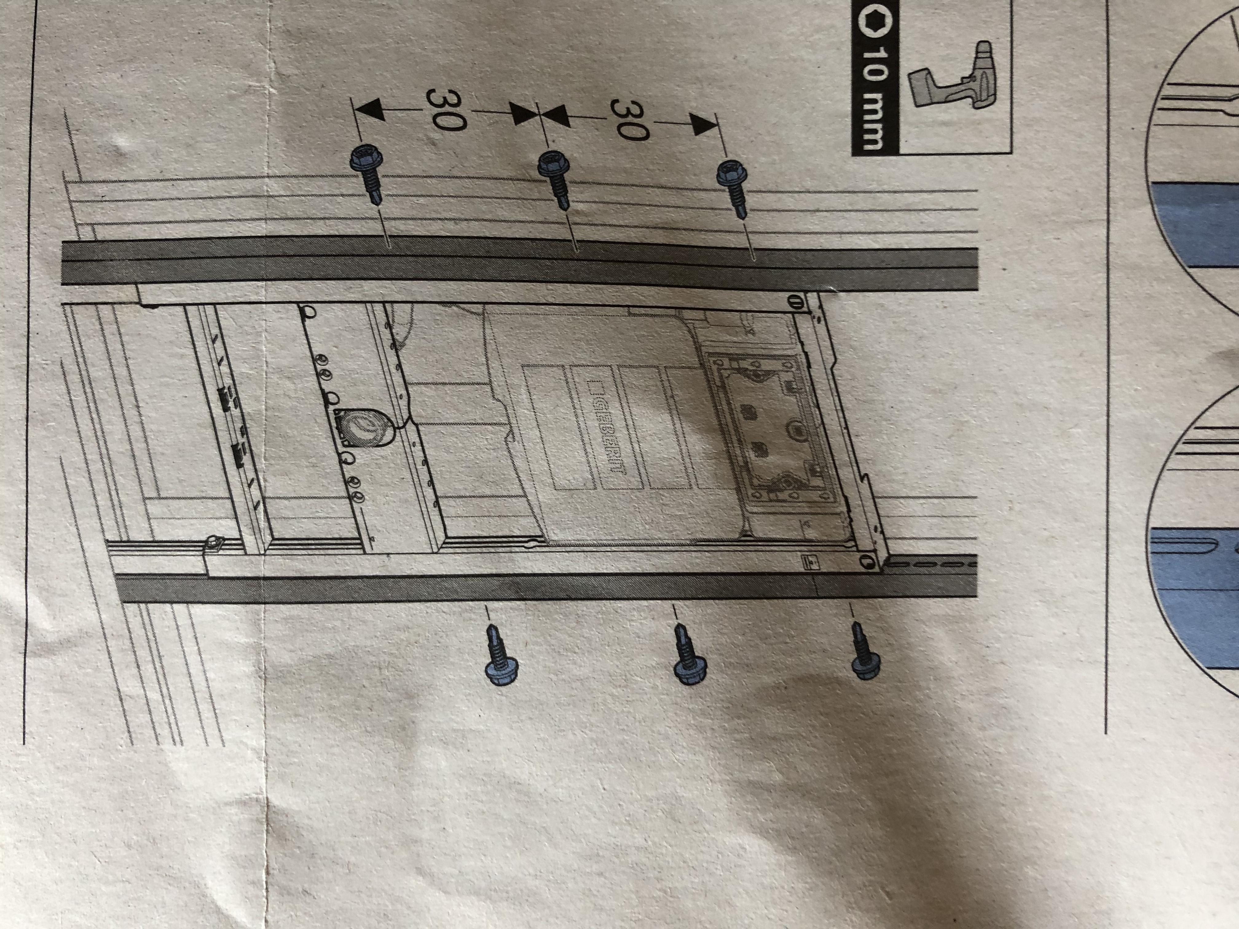

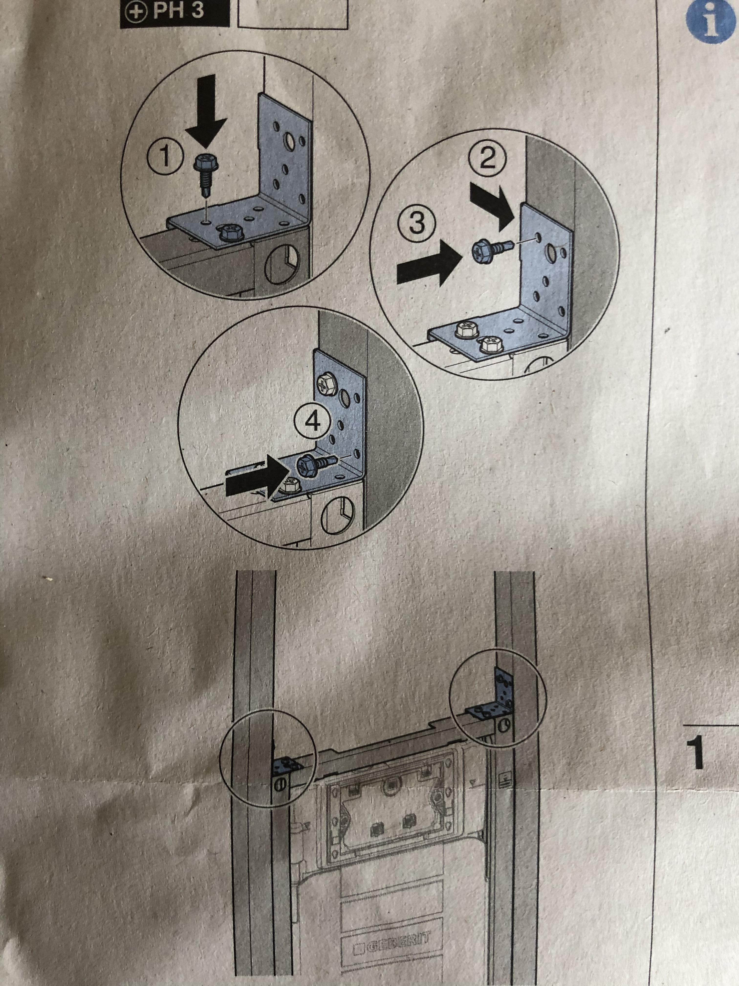

They seem to suggest fixing the feet and just the brackets at the top ! . I’d like a bit more than that !

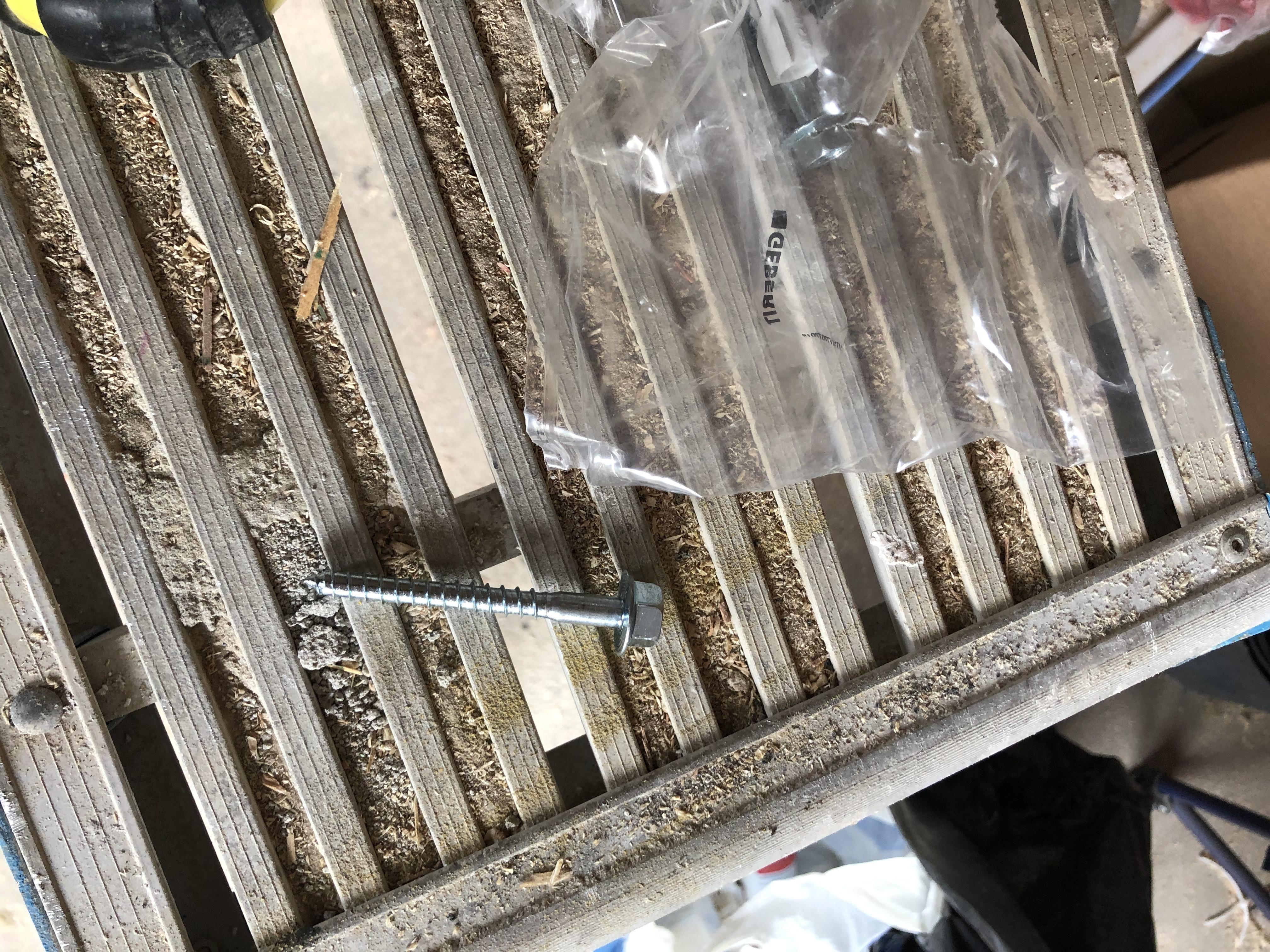

Show this in the destructions but don’t supply any bolts . I’d like to bolt it to the timbers either side . M10 ??
The wall fixings for block work seem the right thickness and length
Assume a visit to the builders merchants to get a similar size bolt , nut and washers will do the job

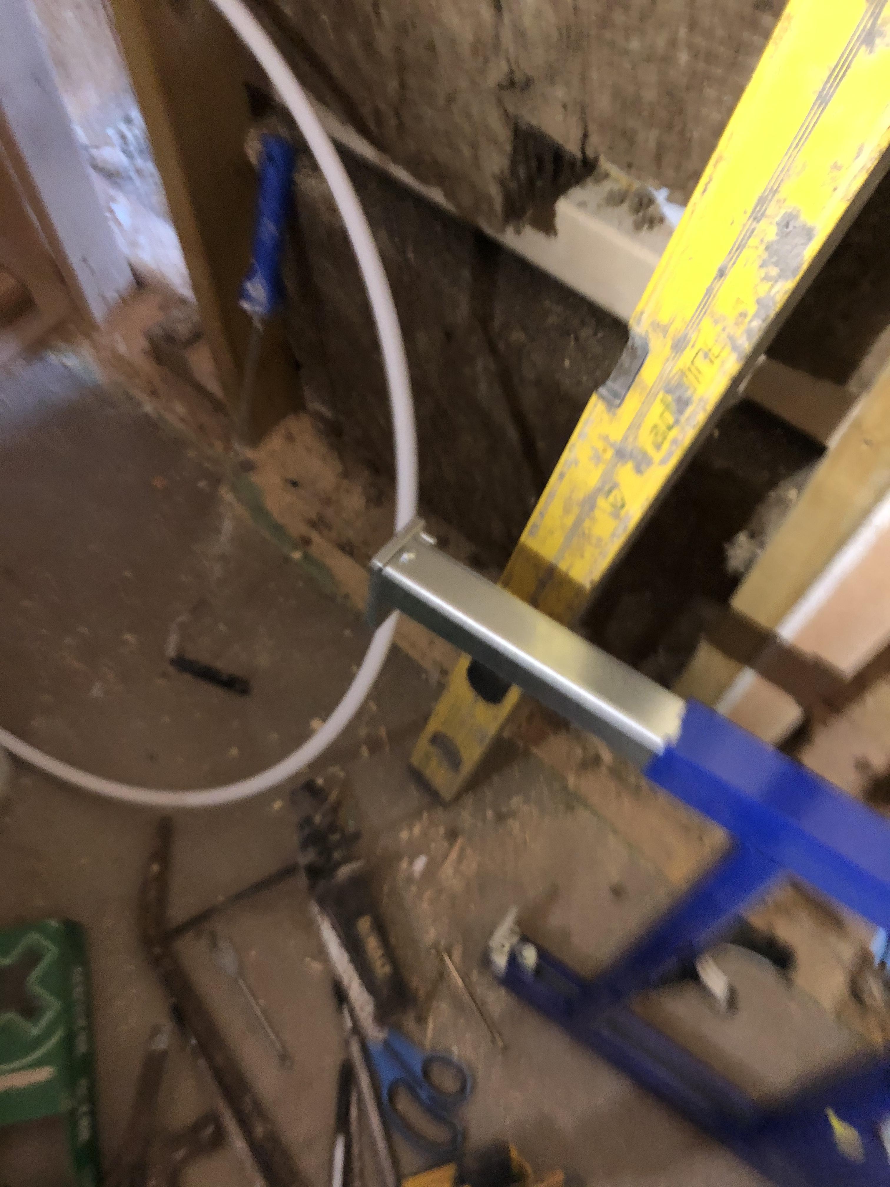

Undo tighten the legs with a 13mm socket or spanner.
I put coach screws in the side of the frame:

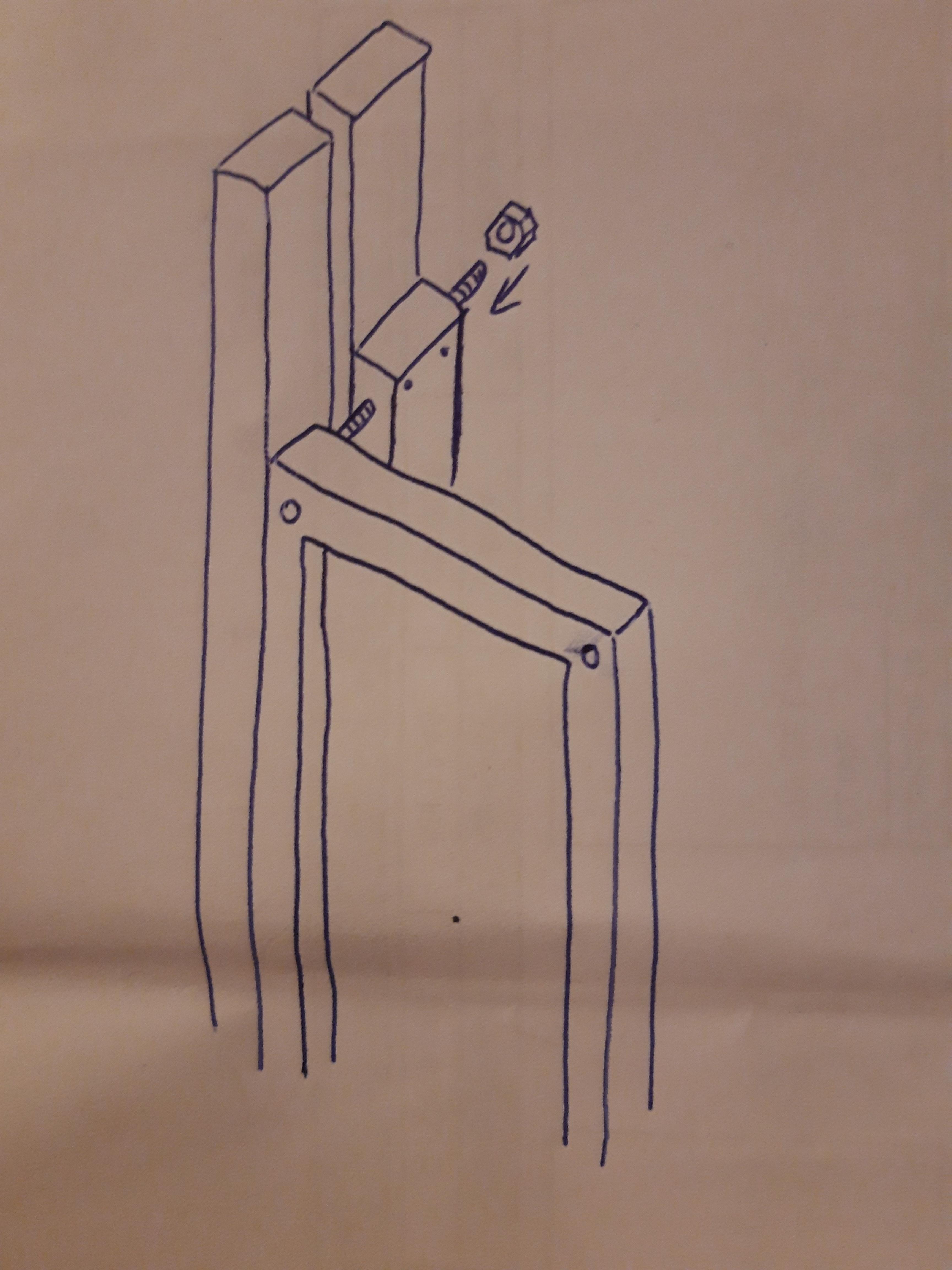

You could glue & screw some timber blocks to the uprights and use studding. Might need to counter bore the blocks with a flat wood bit to take the nuts. Double nut it too  so it doesn't come undone.
As for the pan security...once tiled put it on the wall with clear CT1 backing up the fixings and leave for 36hrs.

Funnily enough went to the builders merchants and bought bolts and nuts to fix as you did but from ‘outside’ into the frame . Not sure why I thought that would be better . Anyway whilst outside builders merchants I was then sick over their driveway ? - ( not joking ) - I must have caught something............. Have a headache now ..........
