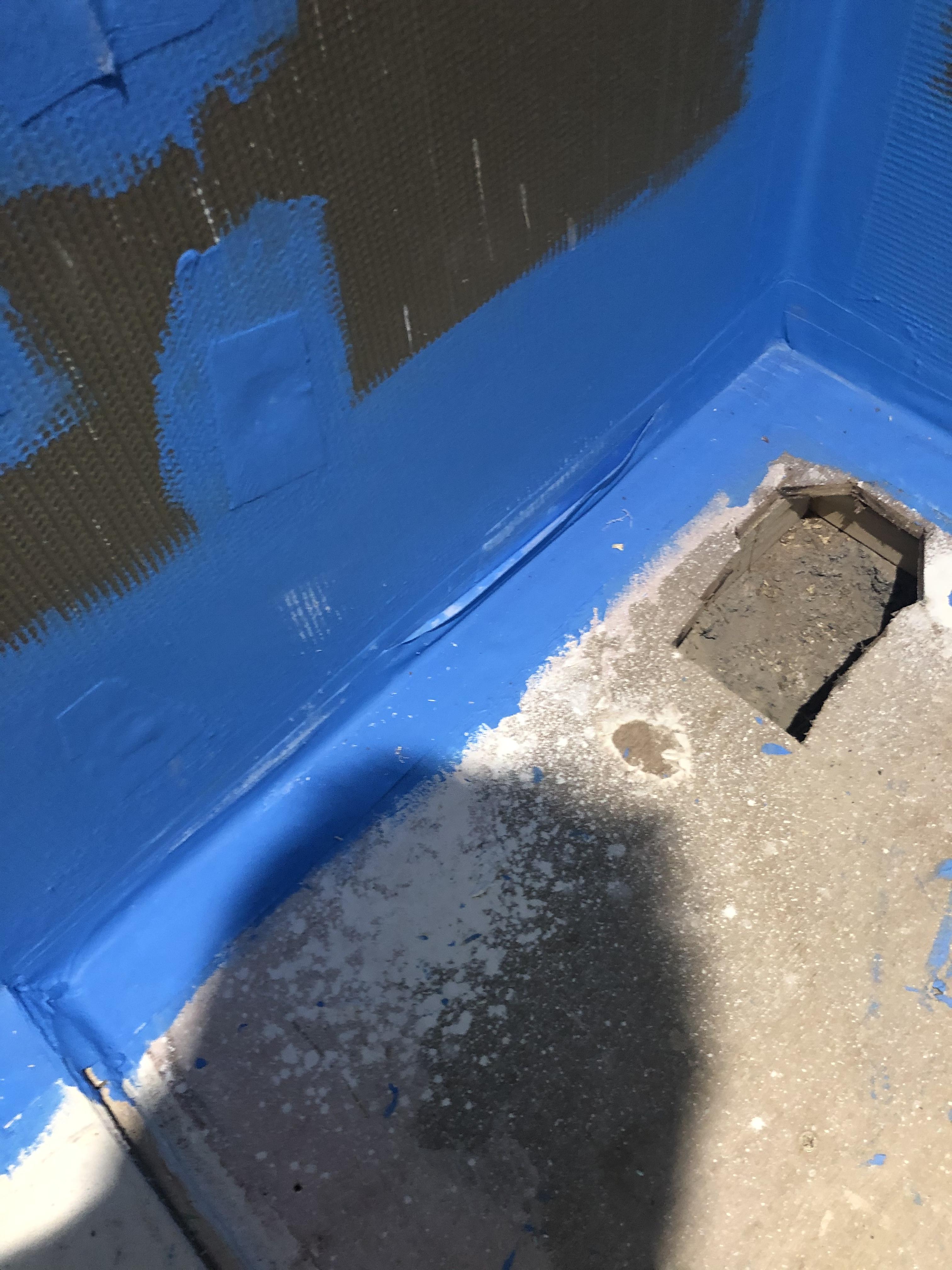

24 minutes ago, pocster said:
Ok ( I think )
The first bit 300mm blue tanking . Do you mean 300mm under the tray then up the wall how much ?
Or do you mean 300mm from under the tray right up the walls to the ceiling all in blue ??
Read it again ! I think you mean 300mm ply base up the wall yes ? I.e shower base then up 300mm blue
Rest of it I got ! ??
I needed 2 pints and 3 reads of that.....

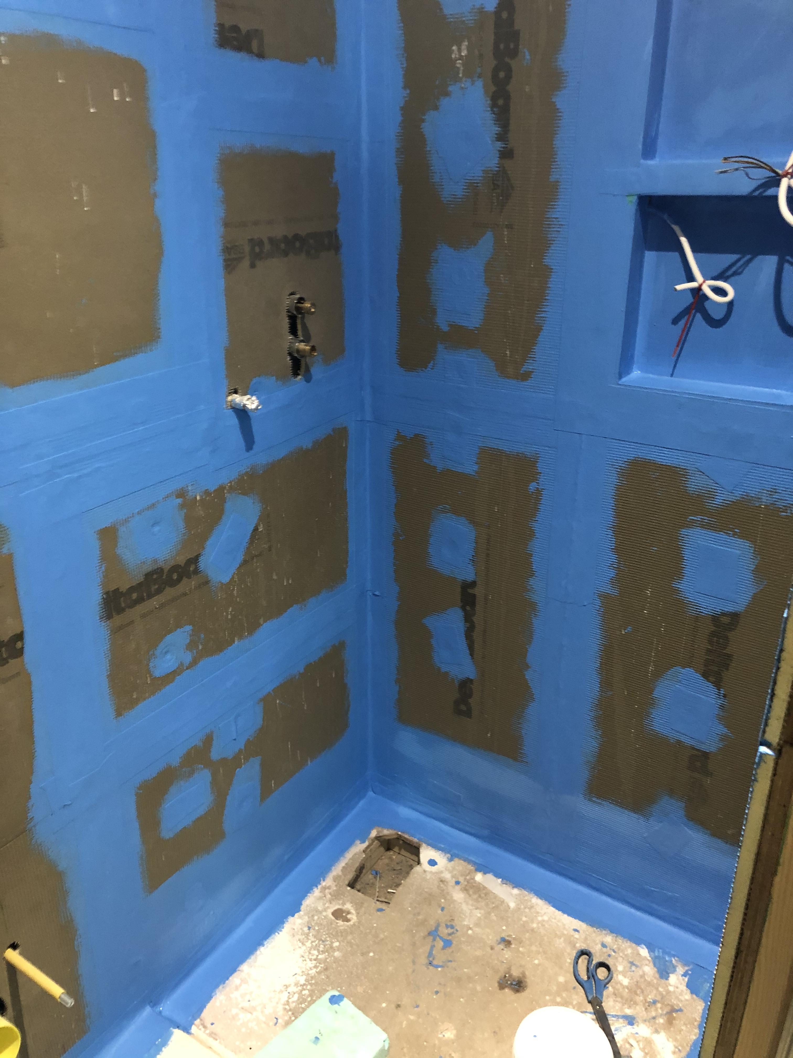

OK. No tanking under the tray. Tanking is on vertical walls only. Tank from where the wall hits the floor to 300mm above that junction. So basically a 300mm tanking skirting board.
There. Now go do, and post the pics in the morning.
5 minutes ago, pocster said:
Nope no mention
This is the Aquaseal kit I used and one of the videos I watched. Paid particular attention to the taping and overlapping thereof. I used x2 7.5m2 kits.
All done
bed the tray tomorrow ?
My nuts are big , my skills are little
Think I’ll just bed the tray with adhesive today . Do all the ct1 another day . One mistake a day is enough ...

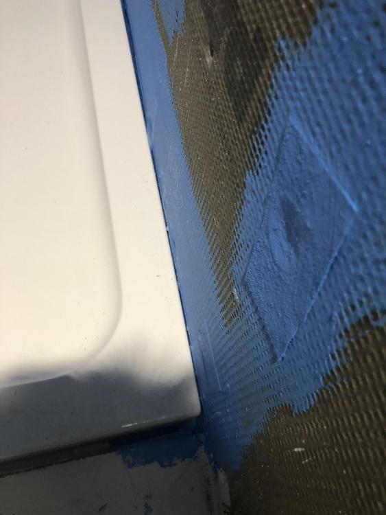

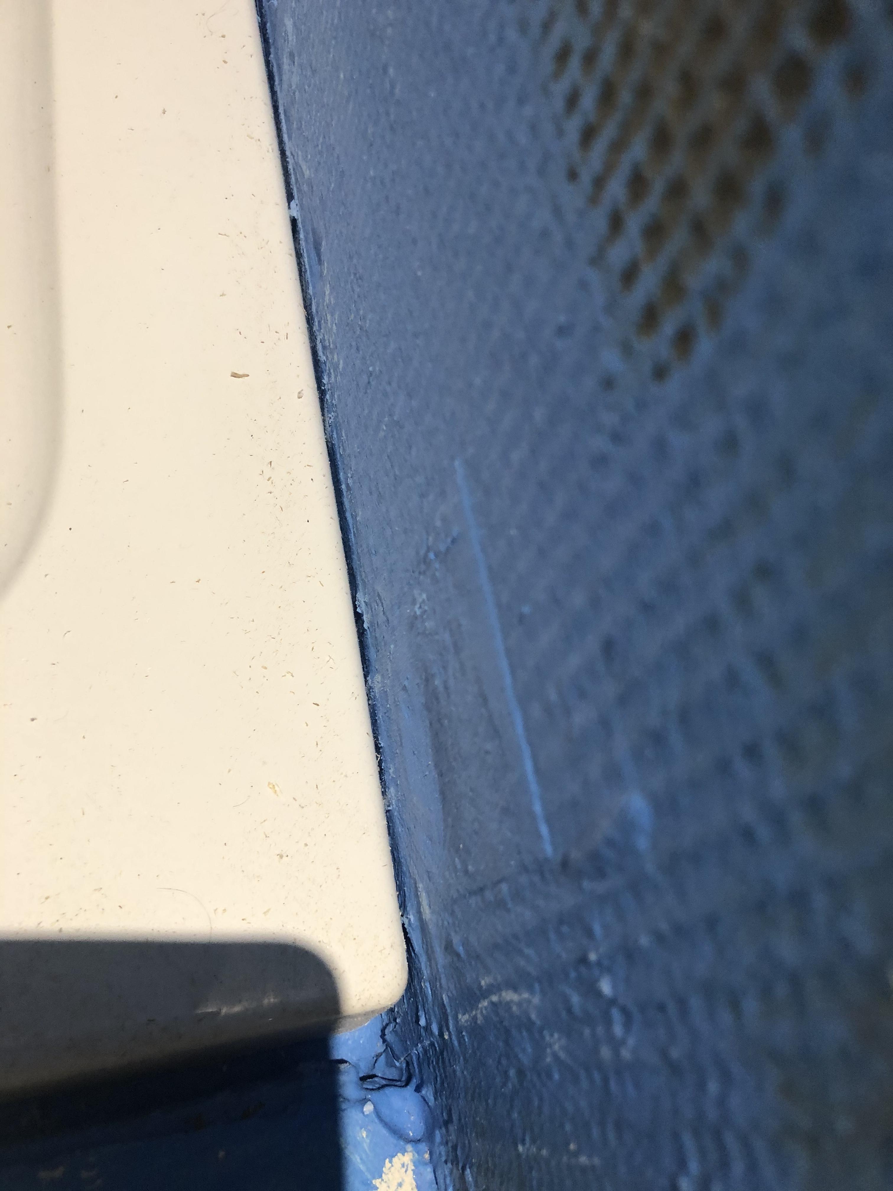

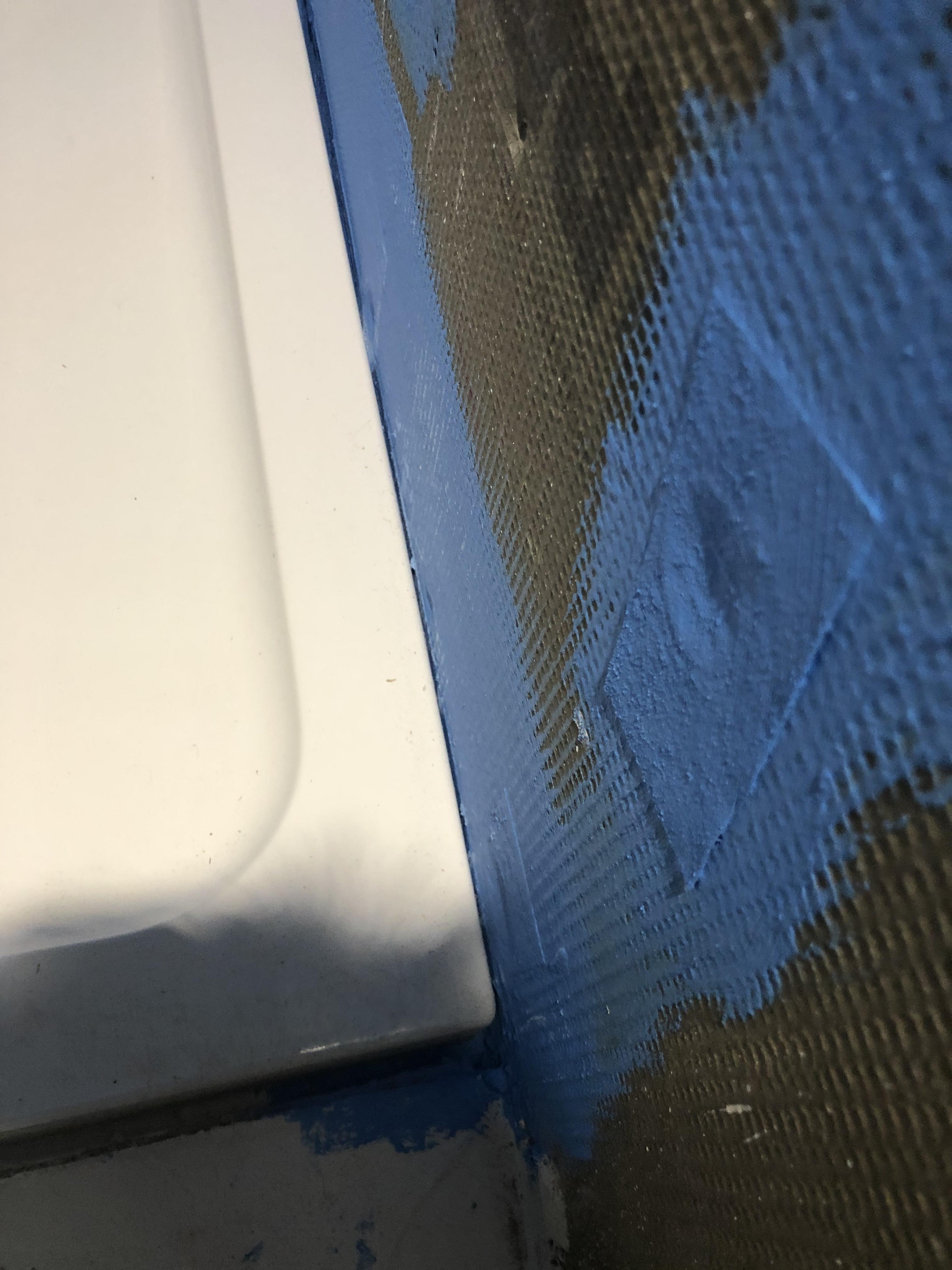

Test dry run . So tight taking tanking strip off the wall . As this is below the tray and obsolete will cut out
So tight
Story of your life eh? ?
Can you zing a bit off the 2 sides of the slab where it's recessed with a diamond blade?
Even taking cellophane off tray still Uber tight . Note to self - don’t make it so tight !
Zero movement left and right

Tried one of @Nickfromwales tips suggest of hammering the ct1 applying nozzle .

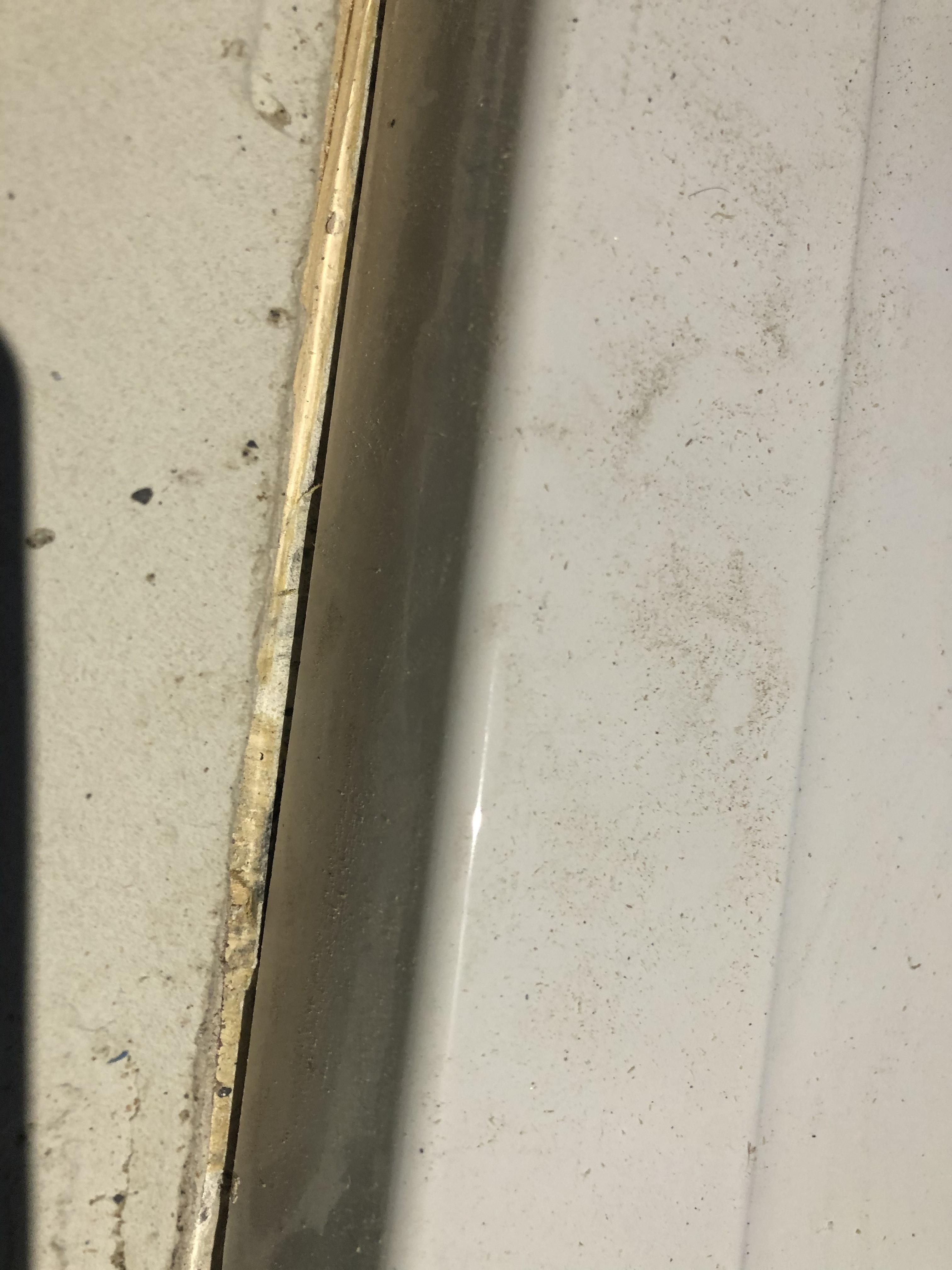

The tray at the moment won’t go down on the ply - about 5mm above it . Assume that’s not issue as I can easily gain 5mm with the adhesive. As the tray is can get tons of ct1 around the edge later - just one Uber Uber tight edge
Edited by pocster
Guessing the issue must be my mis placed tanking strip on wall to floor junction - below tray level . Will rip that out

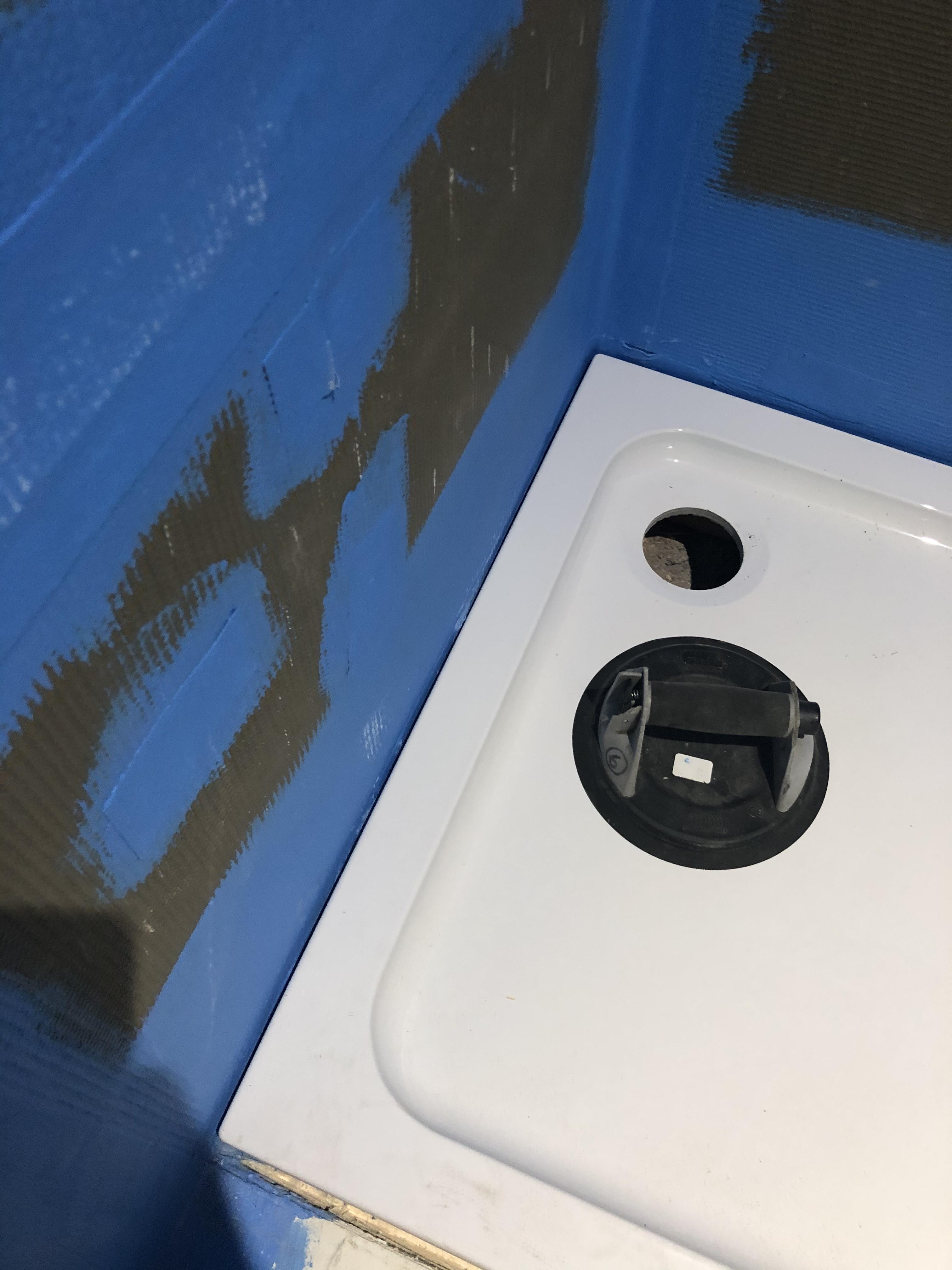

Right ! Better fit . Sat on ply now . Gap at that tight end better a bit . Can force the nozzle in there !
Used my glazing sucker to help move ( why do I have one of those ? ? )

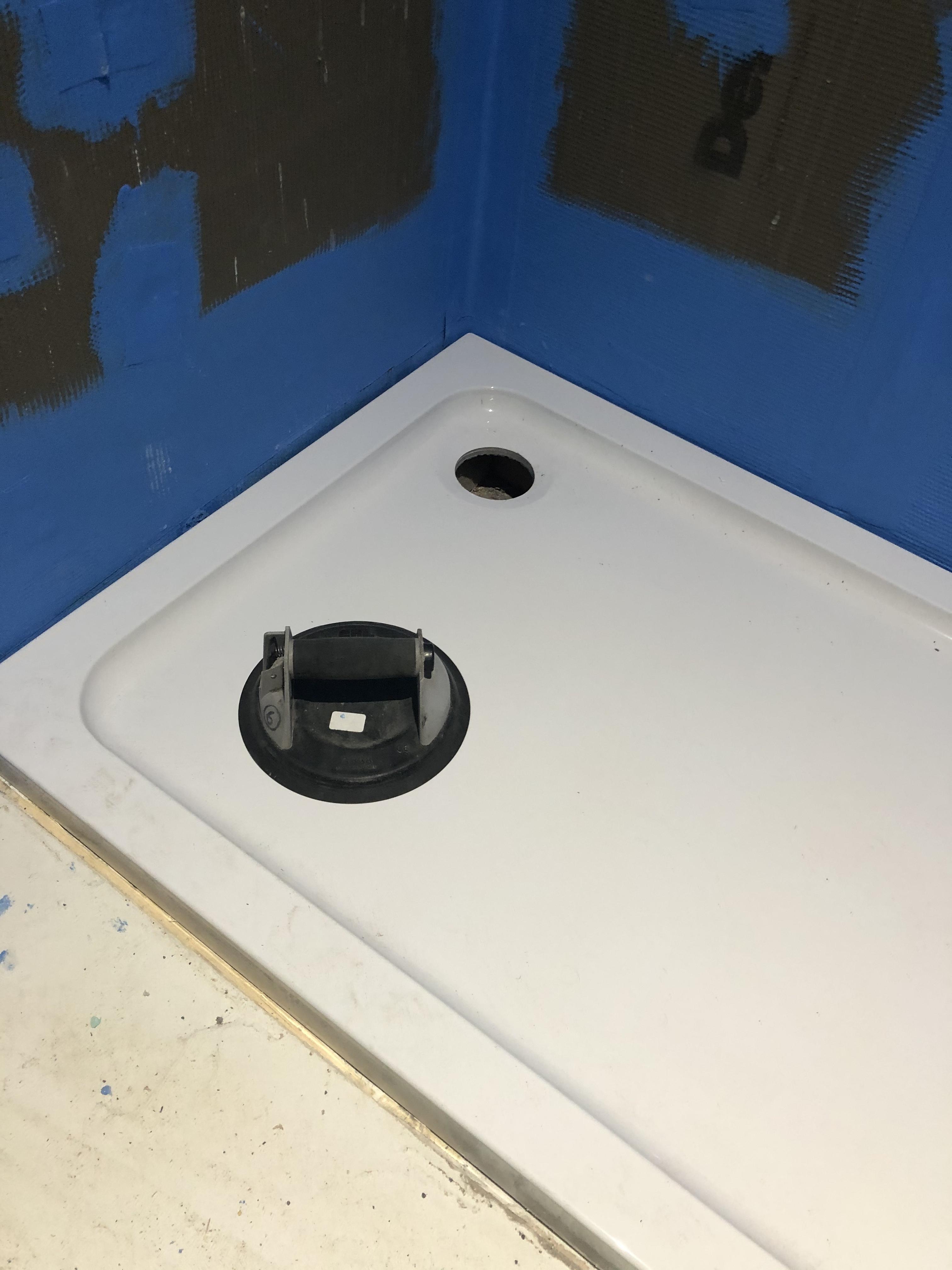

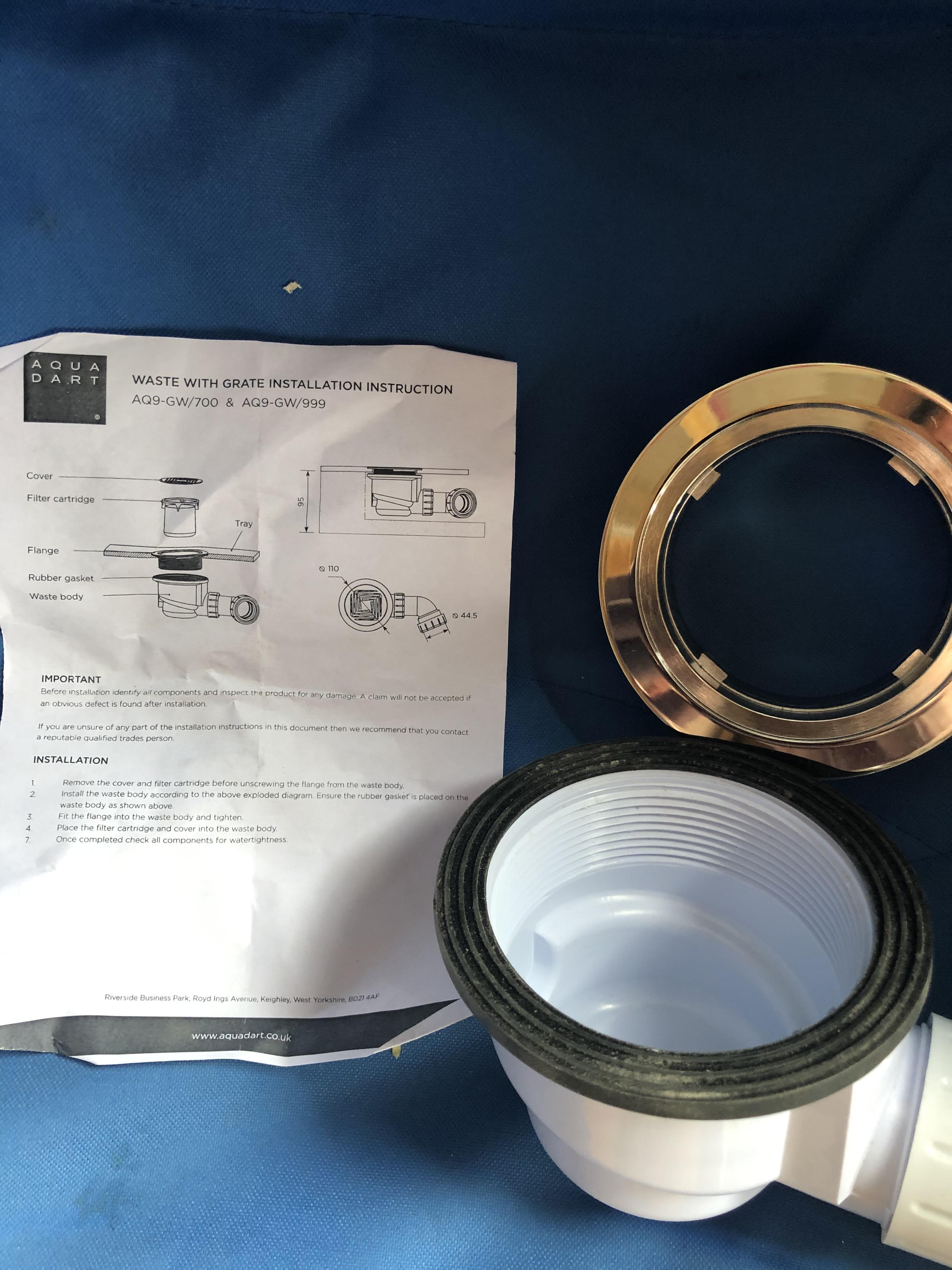

Stupid question number 10000
The rubber gasket appears to sit nicely on the waste ( ribbed ) .
But does the gasket go under the tray or ontop ?
im guessing on top ...
Edited by pocster
@Nickfromwales will be along shortly. My money is underneath with the flange bedded down on white Sikaflex and a smear on the gasket.
Mine too . I’ll fit that once tray is in

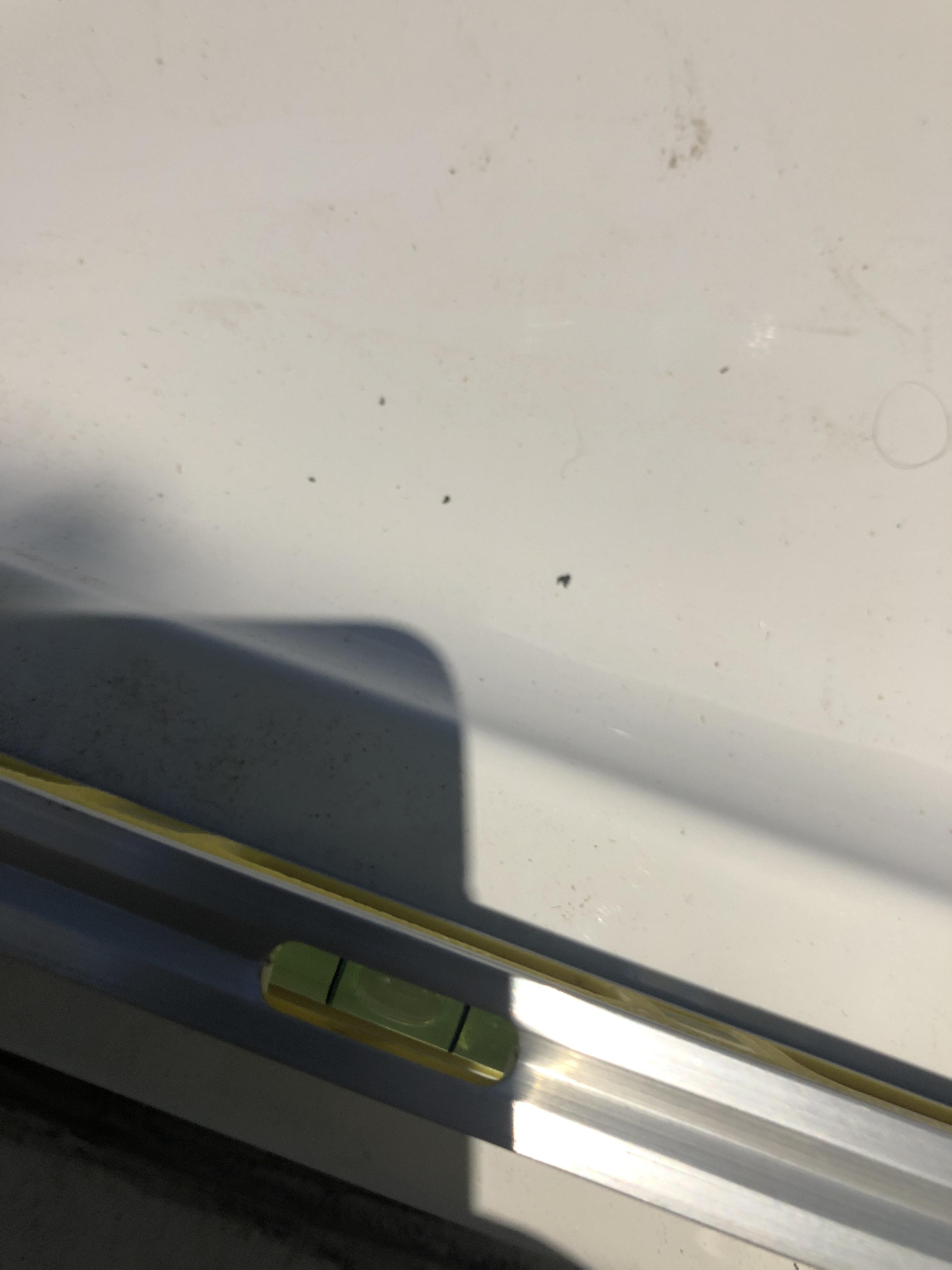

Done . Blobbed tile adhesive as Nick said . Gone down to the ply so I think good coverage . Also scrubbed the underside of the tray as advised before laying . One (expletive deleted) up though . As I’m slightly further from the rear wall a small section of marine ply is just on the edge of the trap . I can feel it with my fingers . Awkward but I’ll have to cut that out from underneath somehow . Problem for next week .

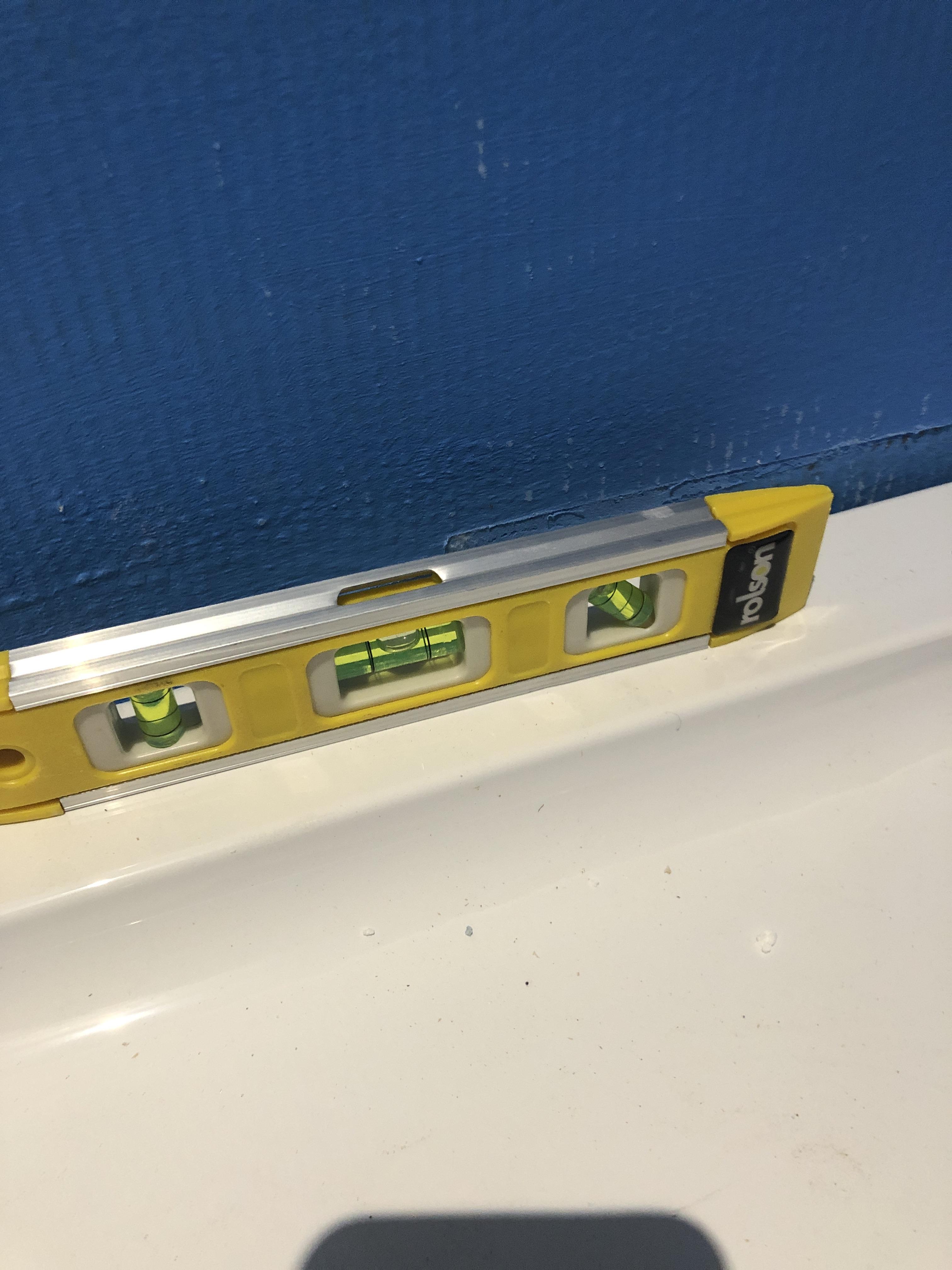

Just to prove its level ...

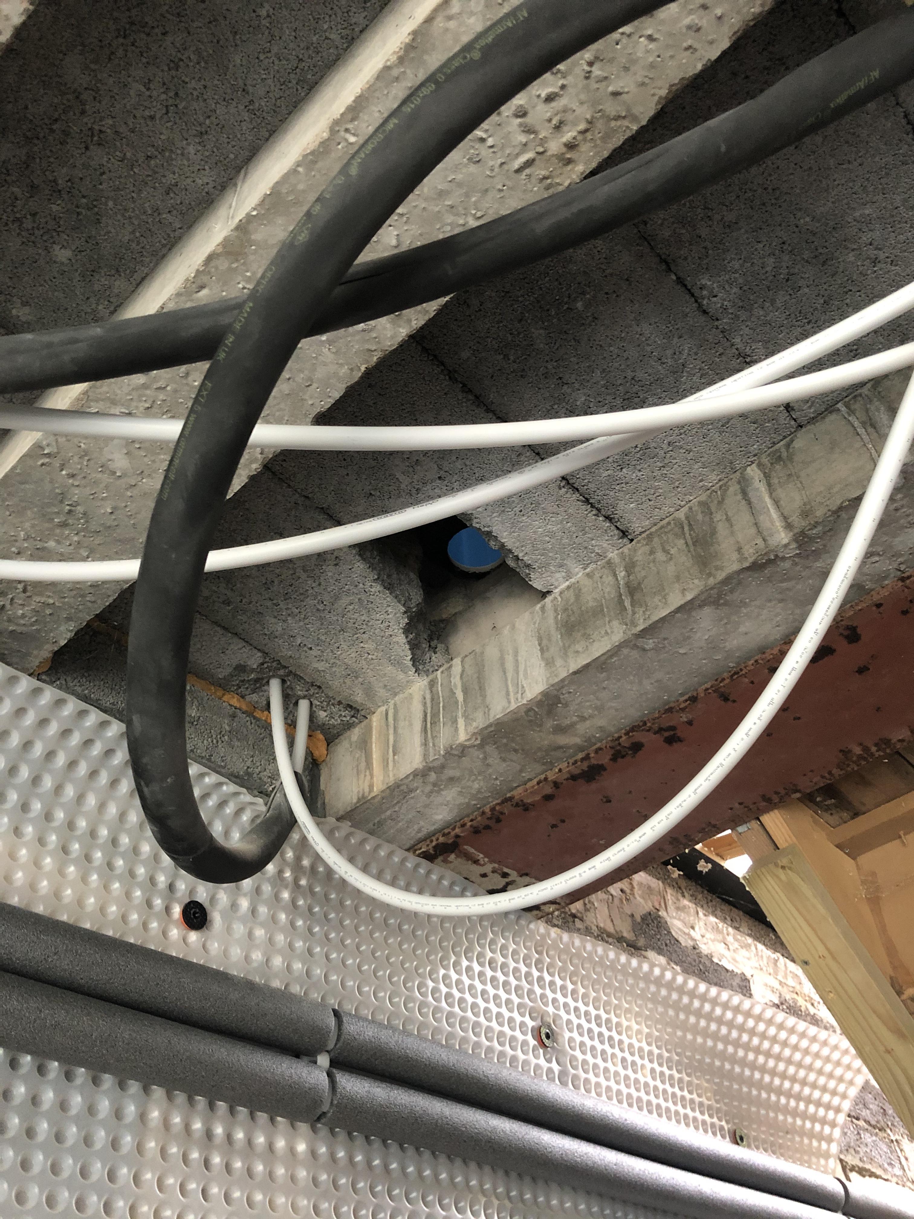

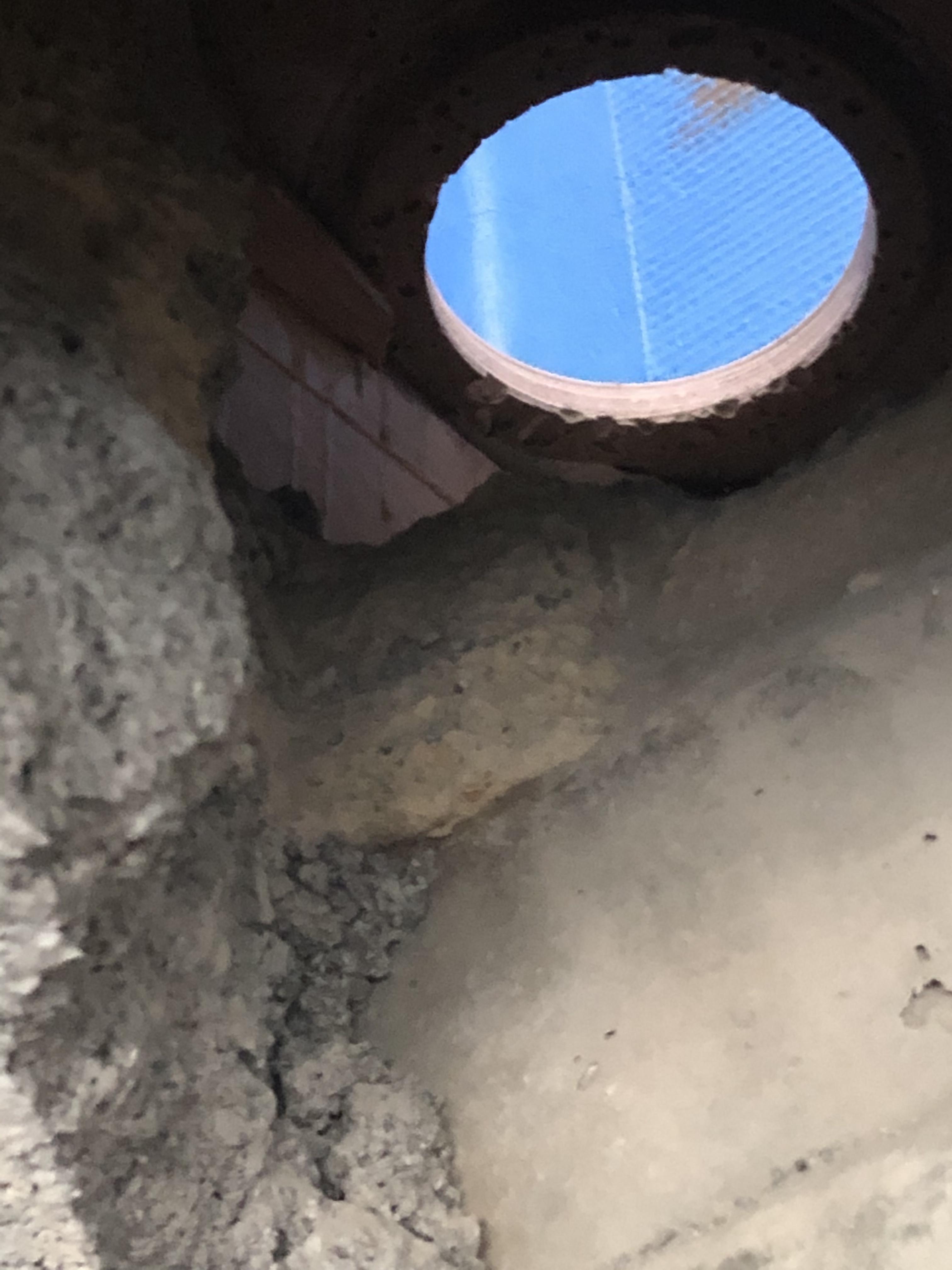

Looking up under . The trap is a bit tricky to fit . Will break more of that block out . Also can just about access with a multi tool and cut that corner of ply sticking out . Trap might clear it anyway ...
