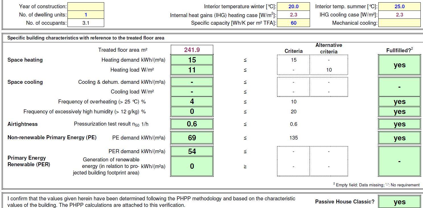

Had previously convinced myself on the mains gas boiler route, but the inescapable truth is that it is a 100% fossile fueled combustion device...
As we're building passive, head demand is quite small (PHPP attached) and I'm only putting three UFH loops - just wet rooms on the three floors.
So our primary demand will be DHW. I've read briefly about ASHPs with COPs tailored to hot water production.
Any suggestions and thought prices for supply? Only quote I've got was a Nilan compact P close to £10k.
I've previously been dismissive and a little ignorant of the tech... Please educate me!
I may be misunderstanding this - are you saying that the rest of the floorspace (apart from your wetrooms) will have no UFH? How are you going to heat the house? Your PHPP shows you still need the ability to input 2.7kW of heat (11W/m2 x 242m2).
And do check your assumptions about primary demand being DHW. That may well be the case in warmer months, but in winter your primary demand may be space heating. The problem with average values is you miss the reality.
I would keep it simple and get an ASHP for both DHW and space heating (with UFH - helps with floor cooling too). Minimise your capital spend as your fuel costs are going to be relatively small, so a small saving on a relatively small cost is easily swallowed up by excessive capital (read complex) installation.
2.7kw is tiny is it not? That's a couple electric heaters. We've a total of 4 bathrooms, wardrobe room and a plant/laundry room that would have ufh. . Other half is also (despite objections) insisting on a wood burning stove!
I'm sorely tempted to make the house "ASHP ready" (UFH loops) and just rely on E7 and solar for hot water and the stove and a couple storage heaters for heating for the first year. A gas boiler installation will be at least £2500 and an ASHP will be double. Heard so many stories from people with passive houses installing heating systems and never using them. We're on a tight budget and £5k saving is significant.
Our total space heating requirement is a little over 2KW when +20 inside and -10 outside.
Heating bill for last winter £234 for heating via a 5KW ASHP and UFH only downstairs.  If I had done that just with an electric fire, the cost would have been more like £750 so the ASHP is saving us £500 per year in heating bills. Considering it cost less than £1000 I would say it is well worth it.
Yes, but not abnormally so for a PH standard build, and you still need to provide heat input else your room temperature will drop. As long as you have allowed for that you should be fine. Ufh in bathrooms will not redistribute the heat to the rest of the house in any meaningful way.
2.7kW X 24hrs is over 60kWh, costing £9 per day of direct electric heating. Yes this is on a cold day and will be less on average during the heating periods, but are you also heating water with electric direct?
You have 2 options, direct electric heating or gas boiler / ASHP. Low capital + high running costs vs. high capital + low running costs. If direct electric you can save money by omitting the ufh and fitting electric emitters or heating element in mvhr.
You have to do the maths, I'm afraid, and decide based on your priority.
