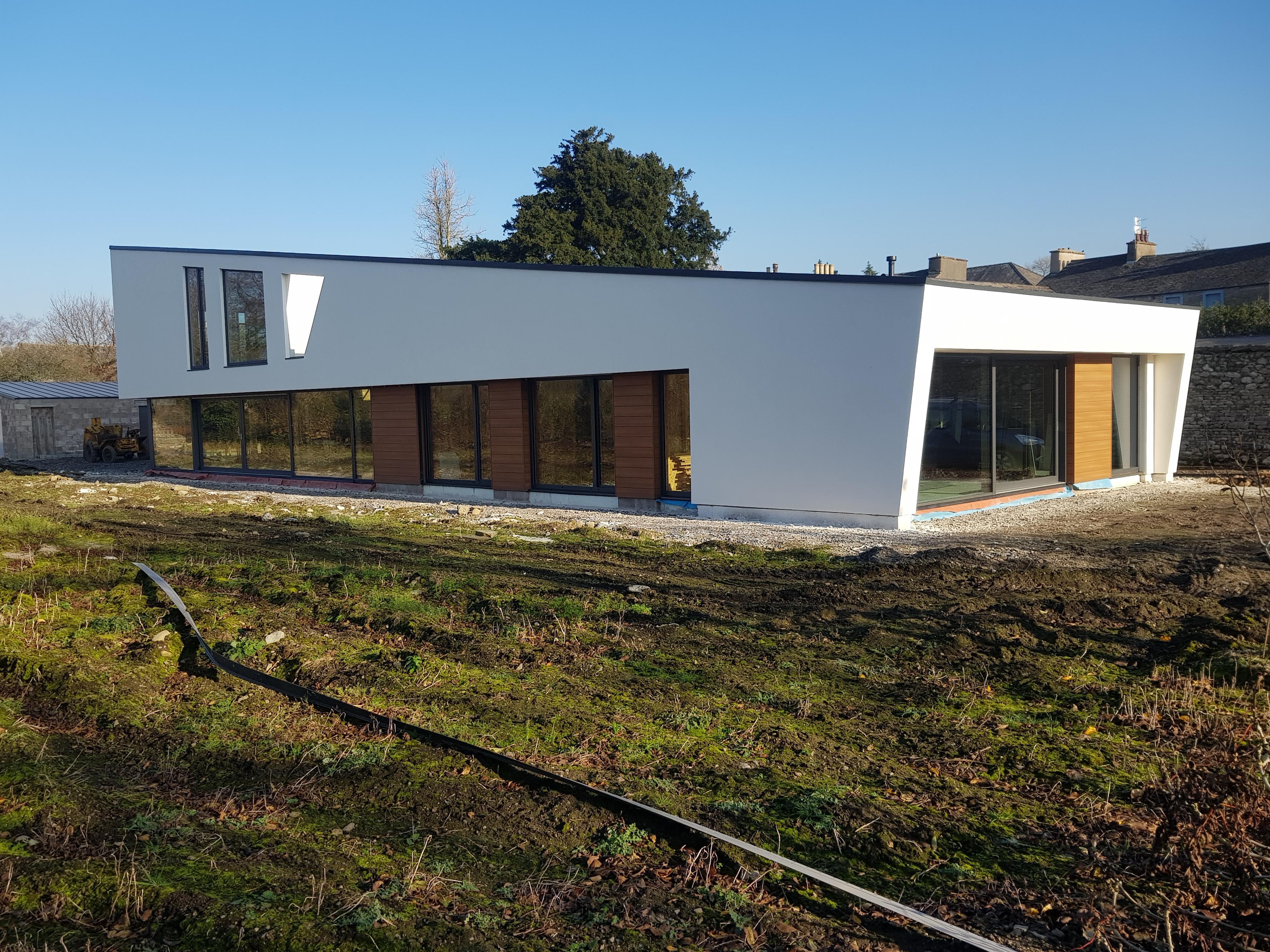

Pete Posted July 25, 2019 Posted July 25, 2019 11 hours ago, Moonshine said: Planning factors have come into play, that mean it may be advantageous to build a contemporary house, rather that a more traditional style. I am not a massive fan of contemporary houses and too many of them look like a white cube, with a bit of wooden cladding stuck on to break up the white. Anyone got any views on what features add to make a contemporary house stand out, rather than just another white washed cube. I suppose bit will be easier to build ? I quite like our big white cuboid or cheese wedge! 5

jack Posted July 25, 2019 Posted July 25, 2019 1 hour ago, Pete said: I quite like our big white cuboid or cheese wedge! Love it! The angles make all the difference imo. 1 1
Onoff Posted July 25, 2019 Posted July 25, 2019 8 hours ago, Pete said: I quite like our big white cuboid or cheese wedge! Are you by the beach?
Pete Posted July 25, 2019 Posted July 25, 2019 1 hour ago, Onoff said: Are you by the beach? About 4/5 miles from the top of Morecambe bay
Onoff Posted July 25, 2019 Posted July 25, 2019 59 minutes ago, Pete said: About 4/5 miles from the top of Morecambe bay OK. It looked as though it should be ocean side to me. Guessing that wasn't in keeping with the local architecture? Passed on its own architectural merit was it?
Pete Posted July 26, 2019 Posted July 26, 2019 In no way does it match the local architecture and it is designed that way to be hidden behind the large Yew tree you can see behind it. The Conservation Officer (K__B) was a real pain and a bit of a bully to be honest but when the head of Planning in saw it at a meeting with architects to inform them what type of houses he would like to see being built he passed this one on the spot so I think we where fortunate. There is only a field opposite the glass wall in the photo and the other three sides are 12ft high walls as it used to be an orchard so most of the people in the village do not know of its existence. 1
Moonshine Posted July 30, 2019 Author Posted July 30, 2019 On 25/07/2019 at 09:35, jack said: Love it! The angles make all the difference imo. Agree on that, and makes for a very nice design. @Pete please tell me there is a roof terrace at first floor, obscured to the neighbours due to the side walls.
