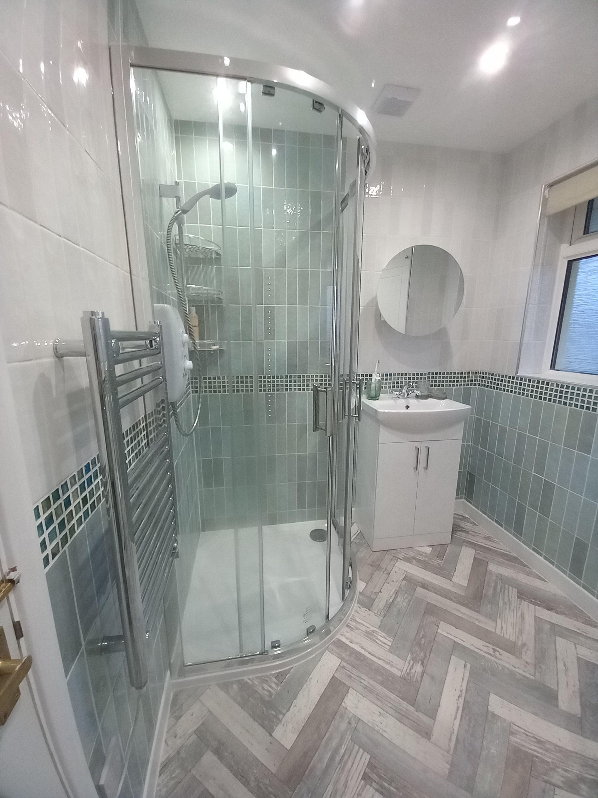

Hi @Nickfromwales Interesting... I have replaced my work 12 years later for 2 clients. One was where I had sealed a bath to the wall before tiling down to the edge of the bath and then sealing the tile to the bath, and the other the same but on a shower tray. Neither would come off without a LOT of effort, however I use Dow 785. Having removed 20 or 30 shower trays over the years I found that when they were stuck to the wall, it was the wall that fails first (usually unsealed plasterboard or unsealed plaster). Secondly some trays on timber floors settle so I like to make a good depth of seal. I will have to look up CT1 ! M

Further... Leave the the SBR to dry out. No need to do the underside of the tray with sealant. Its all about stopping the moisture from being sucked into the timber causing the adhesive to shrink... I use spacers in the corners on a dry run and work out how deep I need to be where to make the tray level. Then after sealing but before coating the floor I re fit the spacers. Then when coating the floor I use timbers or straight edges to scrape the coat of adhesive on the floor to the required level before removing the spacers. then notch the adhesive to the underside of the shower tray. If the spacers are where I can remove them later, I leave them in to help. I still sit the tray down and lift it up again to ensure an even bonding. Sometimes the trays are not flat and as long as there is a fall to the drain hole I ensure the shower tray edge that the shower enclosure sits on is always level which sometimes mean the wall sides are not so level. If your not going to put the trap in until later make sure the area is free of adhesive ( most of my shower trays are fitted on to the floor, not raised so has to be done at the same time. Here's a shower room I did last month. Hope this helps M
+1 To be honest I never use the flexible tile adhesive but I do always use the tile adhesive for shower areas. I run the waste pipe and trap to the correct level for the trap base to be level with the underside of the tray before starting. I always seal the floor area before using adhesive on it. (PVA or wood glue watered down or Acrylic primer). This helps to stop the adhesive from drying out too quickly. I use a big notched trowel and trowel the mix on the floor 1 way, trowel on the underside of the tray the other. Lay the tray gently down and lift it up again to see if there's any places where the crossing adhesive doesn't touch. Adjust the adhesive as required to make the bond uniform. The final push is when I check the tray is level, silicone both sides of the rubber ring between the trap base and insert, silicone the underside of the part of the trap to be screwed in from above, and fit all these together and tighten, and clean off all the mess I have created. Checking the tray stays level I usually place some tubs in the tray or a couple of boxes of tiles Once set - usually one to two days I silicone between the edges of the shower tray and the walls squeezing the silicone so it is not proud of the top of the tray before tiling. (If installing a quadrant shower tray the same as above.) Once the adhesive has gone off, with the silicone, in your case, to 3 walls/sides. It isn't going anywhere. Especially after being tiled in and sealed again with the shower door in as well. Good luck M
