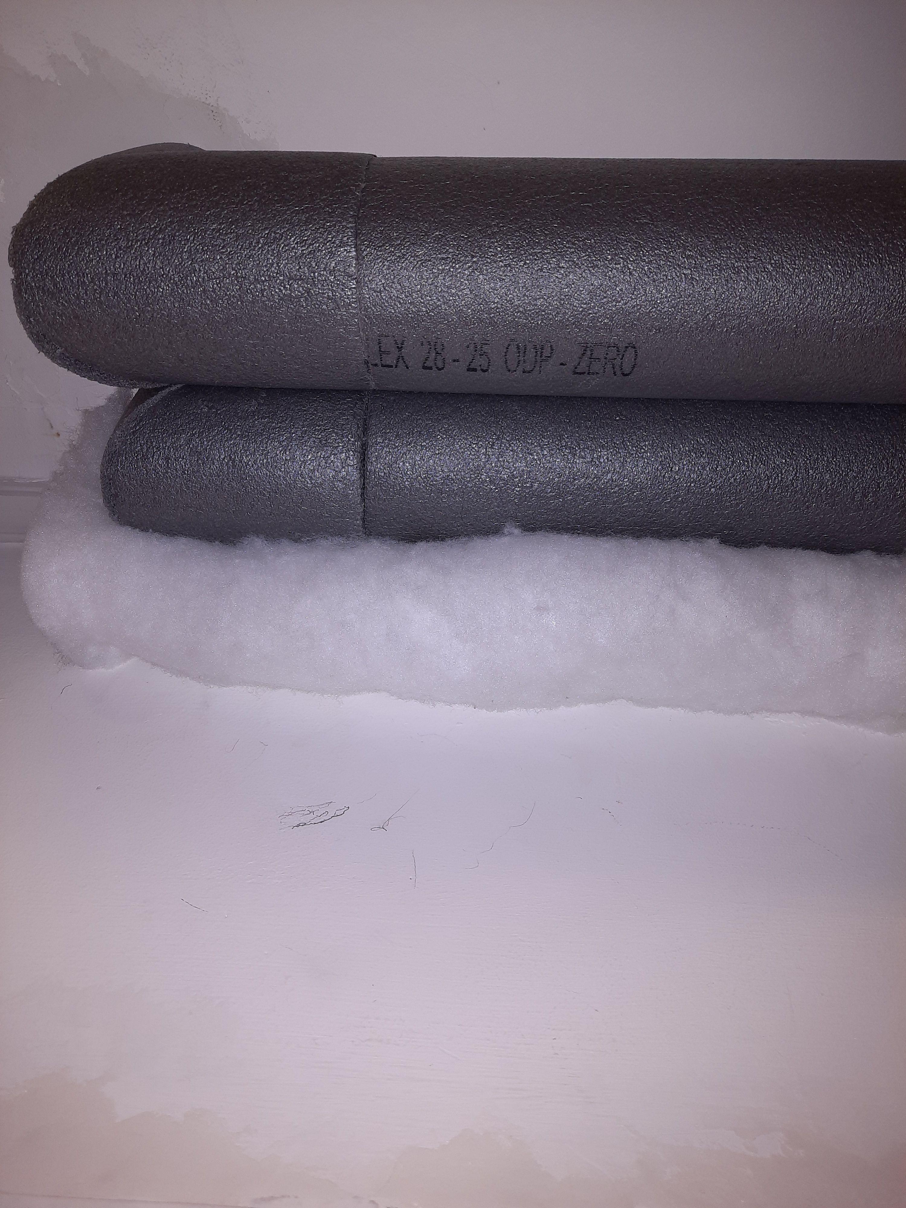

  2. Inside 25mm walled Climaflex pipe insulation for 28mm pipes. View looking up to the ceiling: Outside the same wrapped in supersoft insulation and sealed with EDPM
  3. Your figures suggest that more heat is lost from the water travelling from the ASHP to the manifolds (unless they blend the flow and return) than from the UFH and returning to the ASHP. I insulated our ASHP flow and return pipes, which are outside the building thermal envelope, to within an inch of their lives and I would recommend everyone do the same. I also insulated the same pipes heavily all the way to the tanks and would recommend do that as well.
