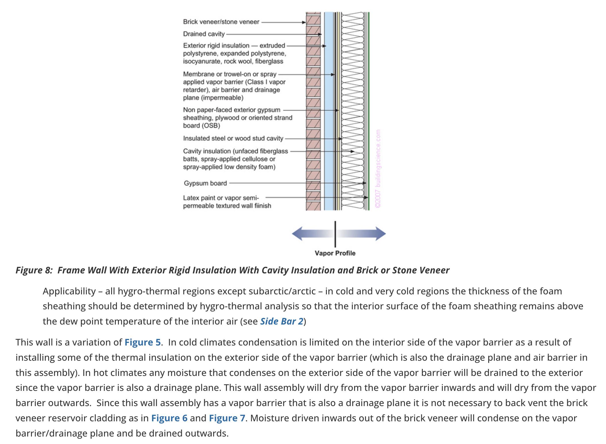

  8. Still needs an airtight layer. That internal insulation layer is just to sell you more kingspan.ftom insulation perspective is better outside but practically they can't do that without turning the house into Weetabix due to non breathable nature of the insulation so are forced to put it inside and tape the living daylights out of it
  9. He's never built or measured jack shite if he's recommending attempting to fill a cavity with rigid foam boards. I wouldn't trust a word he says elsewhere either. Building masonry? Have space on the plot? 300 mm cavity full fill with mineral wool and be done with. Straightforward to build. Idiot proof on site. GSHp is a waste of time. Insulate. Add large ducts. Ultra quiet MVHR with the option to cool. Underfloor heat and hot water wylinder charged by air source heat pump.
  10. AIRTIGHT layer can be anywhere in the buildup VAPOUR RETARDER should be on the warm side (e.g. the floor) https://buildingscience.com/documents/insights/bsi-001-the-perfect-wall What is your plan for the build? Treat the garage as you would the outside world. Seconded on going to town on insulation.

  21. Air barrier - stops bulk movement of air through a structure (important) Vapour retarder/barrier - slows/stops movement of moisture through a structure (less important) Science: https://buildingscience.com/documents/digests/bsd-106-understanding-vapor-barriers SIPs on their own are problematic because: - You have a symmetrical wall/roof (vapour retarders in the form of OSB on BOTH sides) - That vapour retarder is made of weetabix (can't do moisture) - You have leaks in the wall/roof (making joints airtight is difficult/impossible) They don't fail so much at ground level (where cold air is sucked through the wall, heated as it goes through the insulation layer, and dries out in the process) They do fail at the ridgeline (where warm moist air exits and dumps the excess moisture into the SIP assembly) They really fail if the cladding/roof covering isn't well ventilated (and that excess moisture stays in the outer layer of weetabix) I would suggest this variation: stick an airtight vapour barrier (can be polythene) on the OUTSIDE of a skinny SIP then go over the top of that with insulation. The air/vapour barrier on the OUTSIDE is easier to apply well (less likely to be compromise than one inside the house with service penetrations etc) and keeps the SIP dry until it's insulated, roofed, and cladded.
