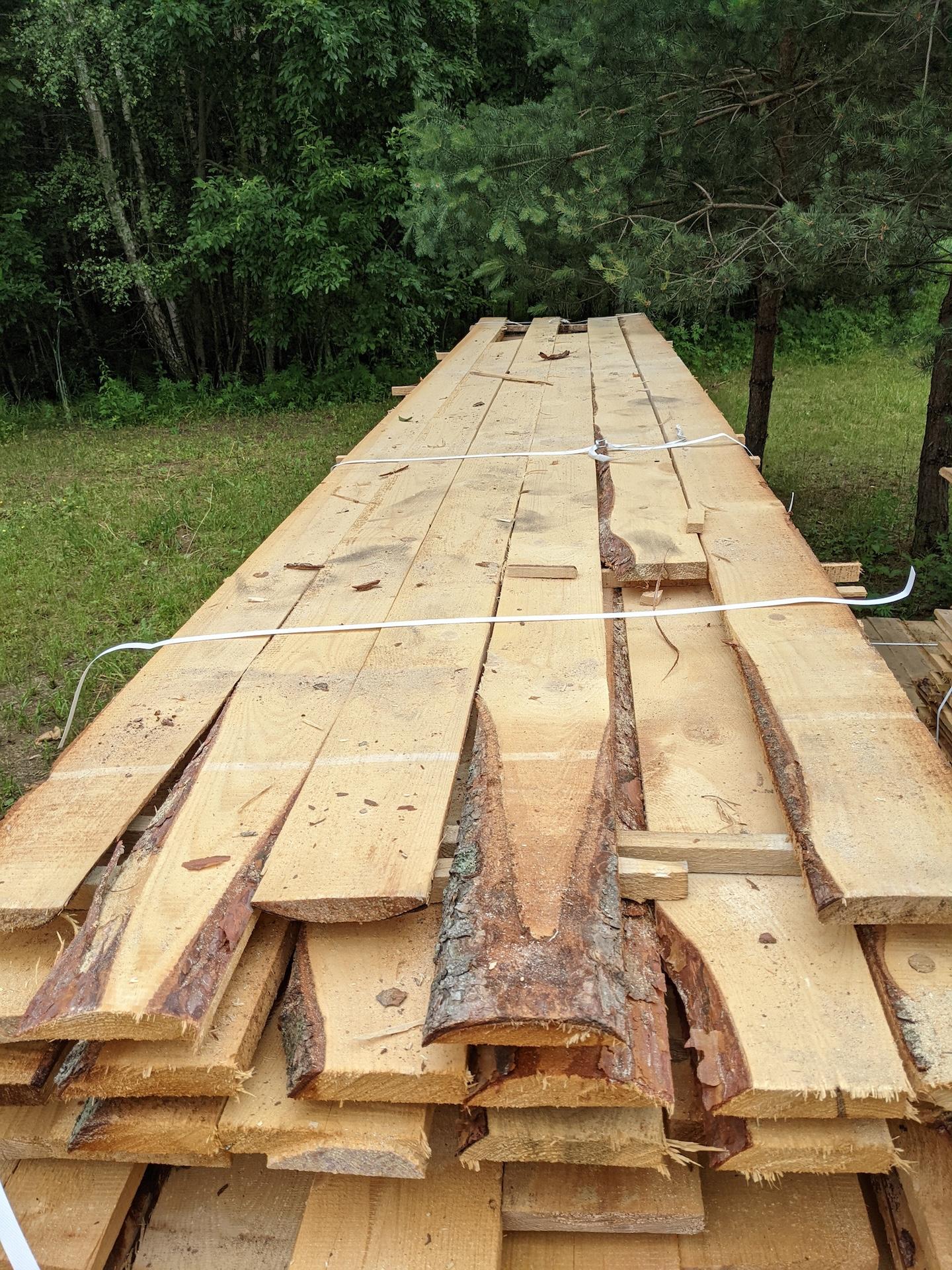

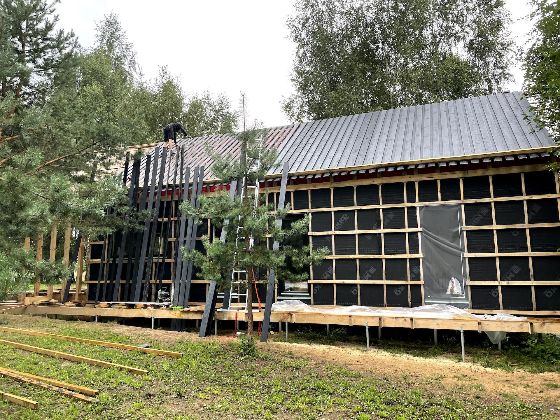

  1. I'll let my wife know 😉 Rough cut pine / spruce. Graded. Grooved. Primed. Painted. Never again. Use Ruukki roof or full-PV roof and pre-painted pre-machined thermowood boards intended for cladding and save your sanity. 😉

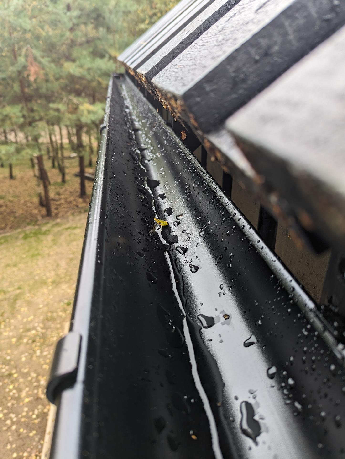

  4. FYI - yes you can see it at 4 mm / metre, no you don't hate it, and no it isn't enough to ensure that the gutters are dry after rain but it's probably enough to ensure that there's not enough standing water for mosquitos: Next up...getting the heating running!

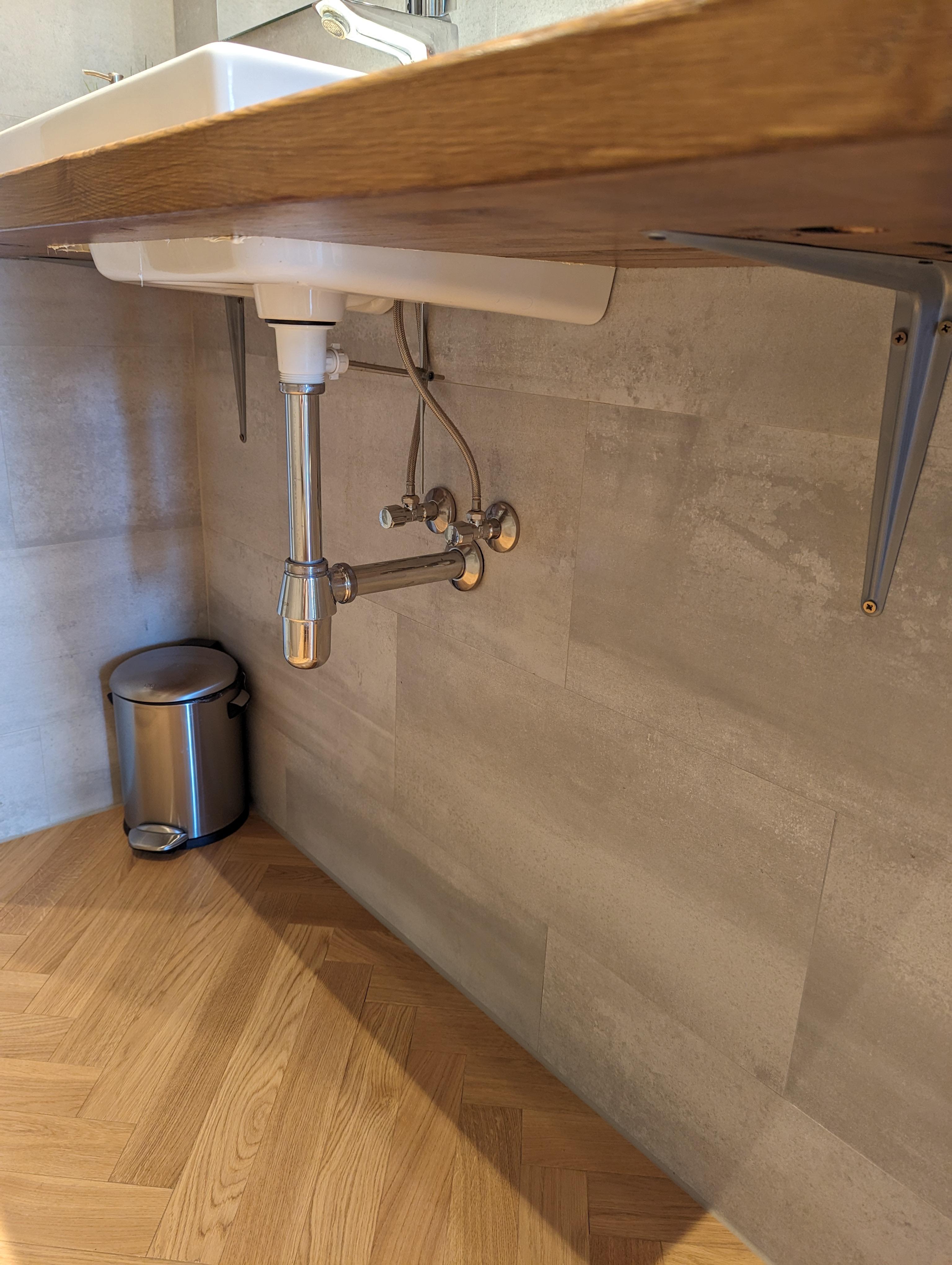

  10. That looks like a 1/2" male tap > 10 mm soft copper connection (probably comes with a thread for a 3/8" tap connector, a flat faceish coupling, and a special adapter to take 10 mm copper pipe) for a bog. You also get them for 1/2">1'2", 1/2">3/4", or indeed dual outlet for a kitchen basin and dishwasher simultaneously. Usually start with a 1/2" elbow: https://online.depo-diy.lt/product/24002 Into a 10 mm compression or 3/8" thread: https://online.depo-diy.lt/product/25638 1/2" thread: https://online.depo-diy.lt/product/25639 3/4" thread: https://online.depo-diy.lt/product/25640 Or combo units for doing a dishwasher and a kitchen sink: https://online.depo-diy.lt/product/25630 https://www.senukai.lt/p/ventilis-schell-kampinis-skalbimo-masinai-3-8-colio-isorinis-sriegis-1-2-colio-isorinis-sriegis-10-mm-suverziamas/302d?mtd=search&pos=regular&src=searchnode It may be easier to use a shower fitting even for a basin etc: https://www.ebay.co.uk/itm/322273391778 And a couple of hep2o adapters: https://www.screwfix.com/p/hep2o-plastic-push-fit-adapting-male-coupler-15mm-x-1-2-/5970f As that gives you more meat to screw to the wall. At the expense of more joints. If anybody wants a 1/2" to 3/8" BLACK valve I have one on my desk that's yours for a donation to the forum. Pocketed and Ryanaired for a friend only to find he wanted 1/2" to 1/2" doh! https://online.depo-diy.lt/product/360380
  11. Copper out the wall is still naff to plaster around/look at if you're then going to a tap of some kind. How about wall plate elbows? https://wavin.com/en-sg/product/f0bb1231-b2fc-4949-8c8d-bd4a6615a933 Run hep to that. Screw in a plastic dummy. Plaster. Unscrew plastic dummy. Screw in either an ISO valve then the tap hose or a hose with a 1/2" male end; through a rosette to hide the plaster edges. As above is how they do this by default over here; looks neat to my eye and is easier to plaster over / around than flexible pipe at a jaunty angle too. If working in a 45 mm battened service cavity you take a lump of 25 mm decking board, use that to span two upright studs, and screw the wall plate elbow to that. The threaded bit then sticks into a hole in the plasterboard a convenient amount. If working in metal stud partitions you again whack a wooden noggin across two studs and screw your wall elbow to that; thickens of noggin to suit metal stud width. If chasing into a masonry wall...resin fix / glue is your friend whilst jaunty angled screws into wallplugs into dust sets. If doing a shower it can be easier/cheaper to buy one of those 2x 1/2" female-female-brass fittings-onna- wallplate thingamies and screw two 1/2" male to help adapters into it.
  12. It's MLCP - pipe will be standard dimensions Why not use MCLP pipe and MLCP compression fittings instead though? The same pipe can take mlcp press fittings: https://online.depo-diy.lt/products/8445 Or mlcp compression fittings: https://online.depo-diy.lt/products/8446 Piece of pish to work with. Far more DIYer resilient than copper compressions IMO.

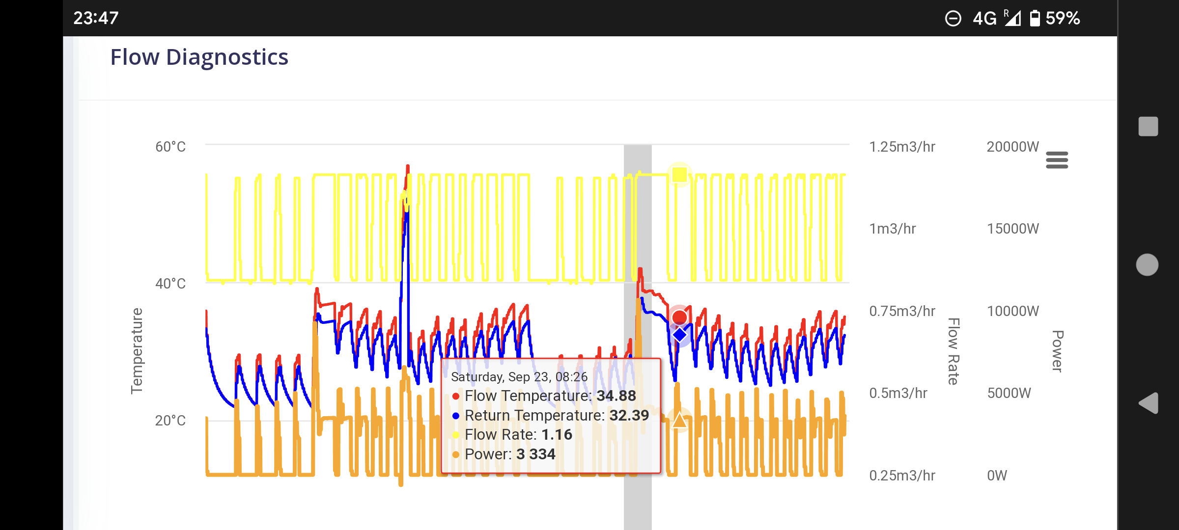

  13. In heating session that house runs all rads open downstairs; TRVs as temperature limiters upstairs. Currently half of downstairs is not connected. (renovation) Not efficient for the heat pump, and there's a sensible limit on how low you can go, but when just a bit of the house is calling you can indeed serve just that. Type 22s sized for 45C at design condition. Direct. No volumiser. Work out the minimum heat pump output at say 12C and 35 degC flow. Work out your (partial) system output at 35 degC flow. Work out your (partial) system volume. Calculate the "run time" to raise the flow temp say 3degC. If that's more than 30 mins it's ok to run a zone that small. If shorter thats not ideal.
  14. The circulation pump will throttle back if the compressor isn't running. (i.e. it circulates thr water to sense the flow/return temperatures) Example: (this is a 7 kW unit running with a fraction the complement of radiators in operation as only north end of house needs top-up heat) When summer arrives / you don't need any heat due to outside air temperature it stops entirely. When the compressor is running you need an absolute minimum of 9L/minute to take the heat away fast enough for it to be happy. This are your minimum "open zone" flowrate. The nominal / design flowrate is 20L/minute. When heating season actually begins in earnest it sits there running most of the time. evohome you can probably bin. Else use it as a glorified TRV for the "additional zone" bit leave them main part of the house under full control of the heat pump IMO.

  21. That's garden shed size... I would timber frame something that small to avoid the loss of space whilst retaining some insulation. You can still use render board on the outside and render it for visuals/fire. You can still put tiles on the roof. 45*95 studs would work at that size. So walls 15 mm plasterboard, air barrier/vapour retarder, 95 mm wood with mineral wool insulation between, roofing membrane to shed water, 25 mm roofing battens to create a drainage plane, say 25 mm render board and render and allowance for wobbles. Gives 160 mm total for similar insulation value (95 mm of insulation) 145*95 studs would be toasty. Or probably better stick with 95*45 studs but put a 50 mm layer of foil backed and seam taped PIR/PUR on the inside. Ridge beam and cathedral roof to give impression of space? Windows?
