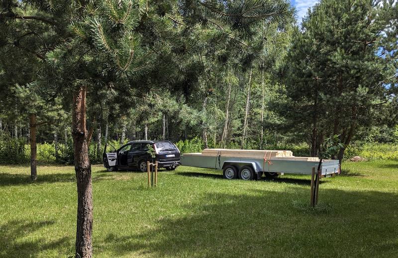

Family sized estate car with towbar, roof bars, and rented trailers IMO. Pay the delivery on bulk materials by truck Rent a trailer for the medium stuff that you want the option to load slowly "I want THIS board and THAT board and NOT THAT board etc" Keep a sheet of 22 mm OSB and the roof bars for "fudge, I need another sheet of plasterboard" or a giant roll of pipe / cable etc 3 metre long oddments (pipe, curtain pole, etc) go straight in the car along with "white goods" sized things (cylinders, heat pumps, air conditioners, bathtubs etc) If it's boxed / bagged and liftable goes in the car If it's shovellable and dry then stuff t that can also go in the car if you're not in the slightest bit precious about it? 1.6 TDCI Focus Estate for us (the 90 bhp version) with a 2cm lift kit on it. Costs £0.20 to buy. Does 1000 km on a tank of diesel whilst running around. Takes 3m pipes inside it with ease. Open the tailgate and you have a cleanish seat with a cover to have a cuppa in the rain. Not banned from the tip like vans. Not subject to speed limits like vans. Doesn't get broken into every 5 minutes. Doesn't whinge too much when I rent my favourite 6 metre twin axle trailer form the place next to the sawmill. Needs to be dry day with bit of a run up to get that up the grass hill though! If the site is a wet mess a van will be worthless to you IMO (gets stuck) - you'll get further in small front wheel drive car with decent ground clearance; small 4x4 car; or a real 4x4. -
