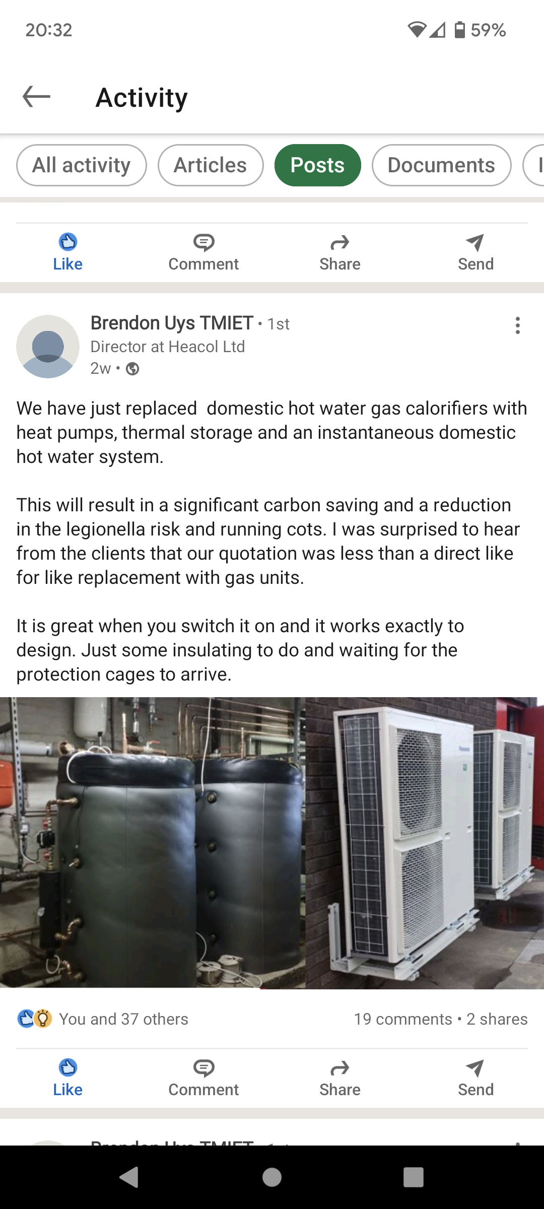

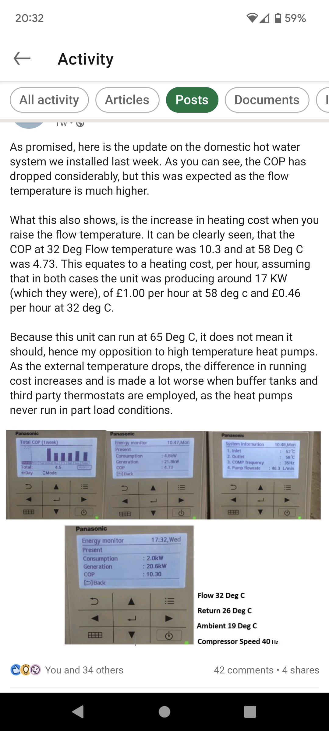

Why do you say that the COP for hot water is lower @Iceverge? You're lifting from incoming at 10-20C up to 45C. (or should be) The COP lifting from 10-20 will be stonking. The COP from 35-45 less so. The energy weighted COP should be well over 3 though - unless there's a stuffup with how it's implemented. This chap knows what he's doing for example. Summertime COP averaging out at 4.7 for ASHPs doing pure hot water preparation. (Initial COP reheating from cold (19 external 32 delivery to tank) was just north of 10. Big coils or loading via plate heat exchanger in "fully stirred reactor" heating mode (heat up the whole tank gradually) not "fully plug flow" heating mode. (what mixergy tanks do and how phase change units like sunamp behave) Discharge should always be plug flow. Delta capital for dedicated all in one heat pump tank vs unvented tank is probably <£1k. Obviously doesn't apply if replacing what you already have. -
