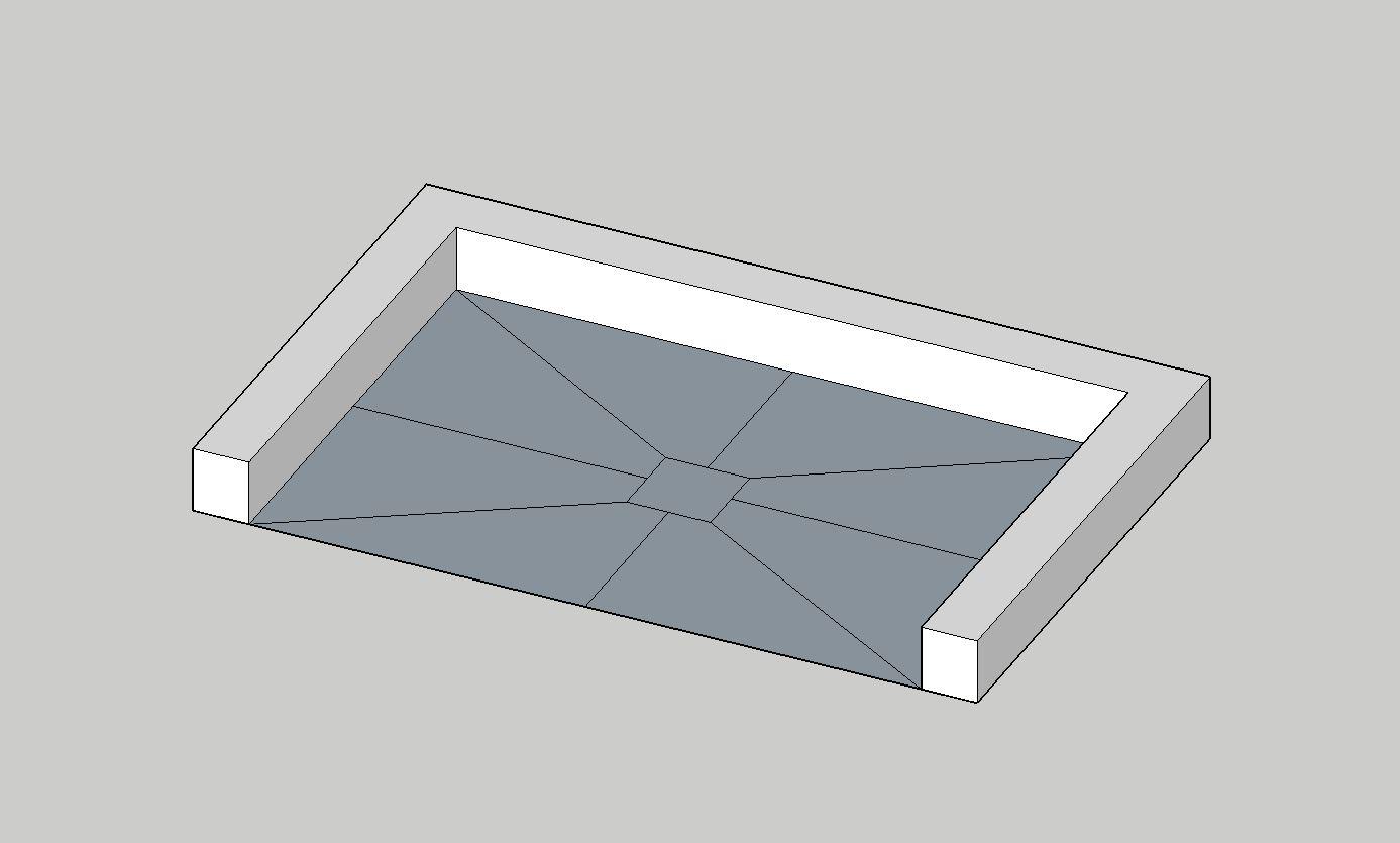

Nice. Im going for the 'union jack' with a central drain. Probably just use some roofing batten for the 4 rails

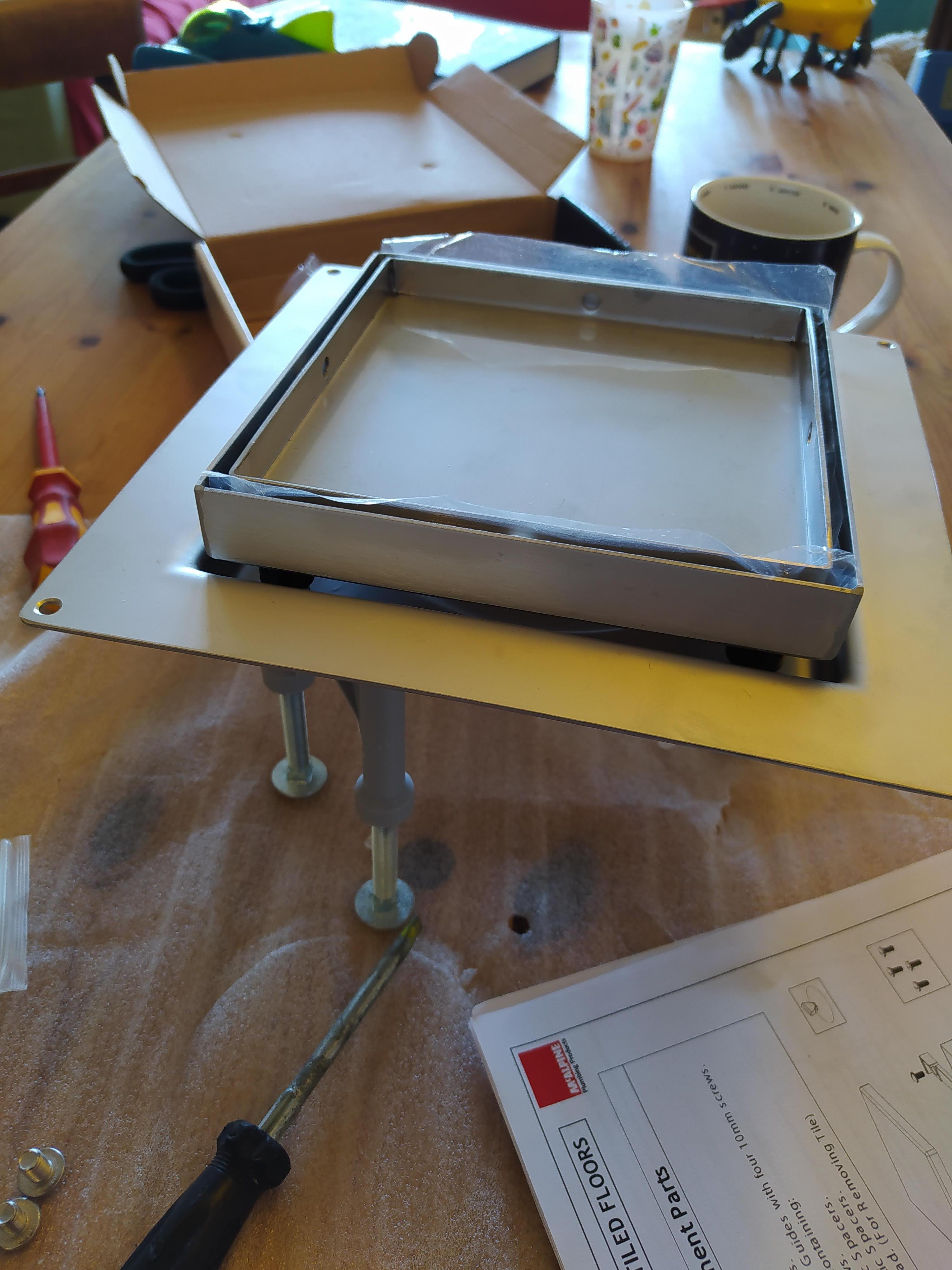

I've ditched the freebie linear drain for the McAlpine. Only £105 and that's without the trap. It does what I expected the freebie to do which is allow water under the tiles to find its way out. Thinking about the tanking and decoupling now. Is a product that does both at the same worth look? Like TileSure Or should I be treating this as two separate jobs? This is for a ground floor screed. I braved the eternal bath/boxing in thread a la @Onoff. Page 75 the floor tiles just appear without even a mention of decoupling?!

Ground floor shower tray - concrete slab headache.
willbish replied to SuperJohnG's topic in Waste & Sewerage
Wet room as per @Russell griffiths certainly seems easier Or buy the tray and trap this week Or bring the soil pipe up in the centre of where the tray will be (tray wont have hole in the centre) then before concrete pour make a box out of OSB to create a void in the concrete 100mm deep surrounding waste pipe and reaching to one corner of tray. -
