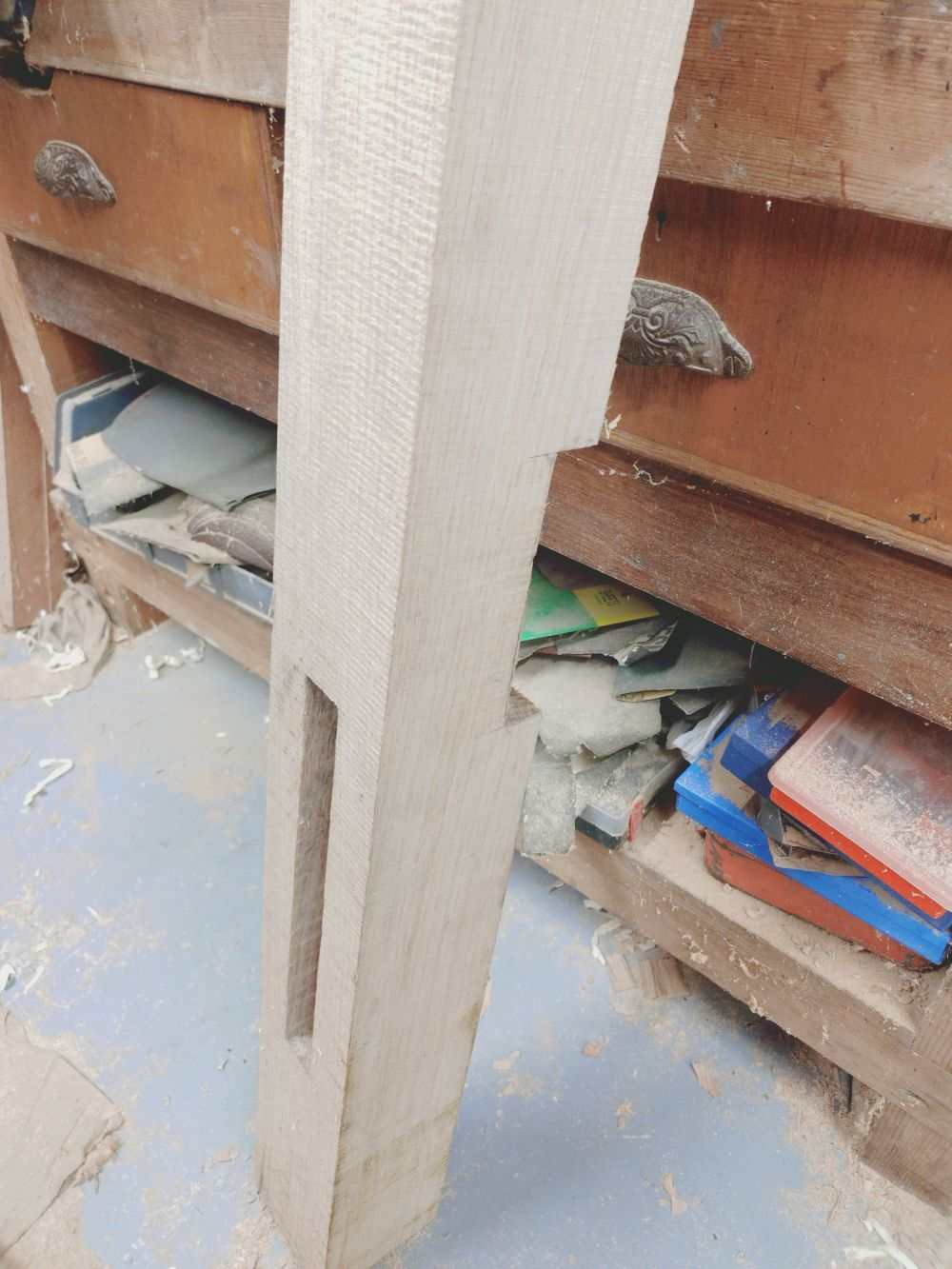

  • Location

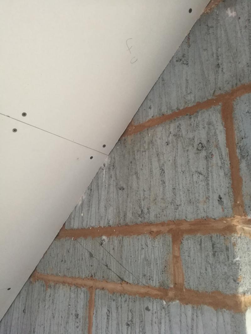

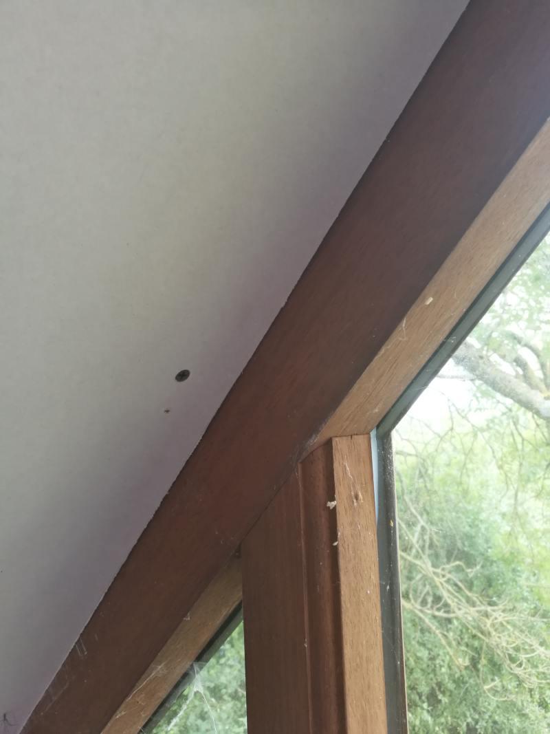

AlanUK's Achievements
Member
Member (3/5)

  1. I think it'll be hard to assemble (giving me limited time to actually put the parts of a complex and large assembly together), and make it impossible to disassemble should I want to, without causing major damage to the wood.
  2. I like the idea of staying reasonably traditional, but might perhaps use some sort of bolt too, as suggested in a later post, and avoid the glue. You say it looks dry, and it does in the pic, but it's very very fresh - the wood was very damp when chiselling out the mortice, and it attacked my tools - I couldn't believe how much rust it caused in a day on my bullnose plane.
  3. Yes, I have some 20mm dowels. I was thinking of using 4, but maybe that's over the top. There aren't too many forces acting on it. The main one will be the stringer, pushing the bottom in, but it's not a huge force. And I guess if it does start to get wobbly I can always add a SS rod at a later date.
  4. Yes, something like that - it would hide the metalwork anyway, And it seems like a stronger solution than using oak dowels and glue.
  5. A large screw is possible I guess. I was intending to sink the nuts and washers into an enlarged hole, and cover with a dowel, so they wouldn't be visible.
