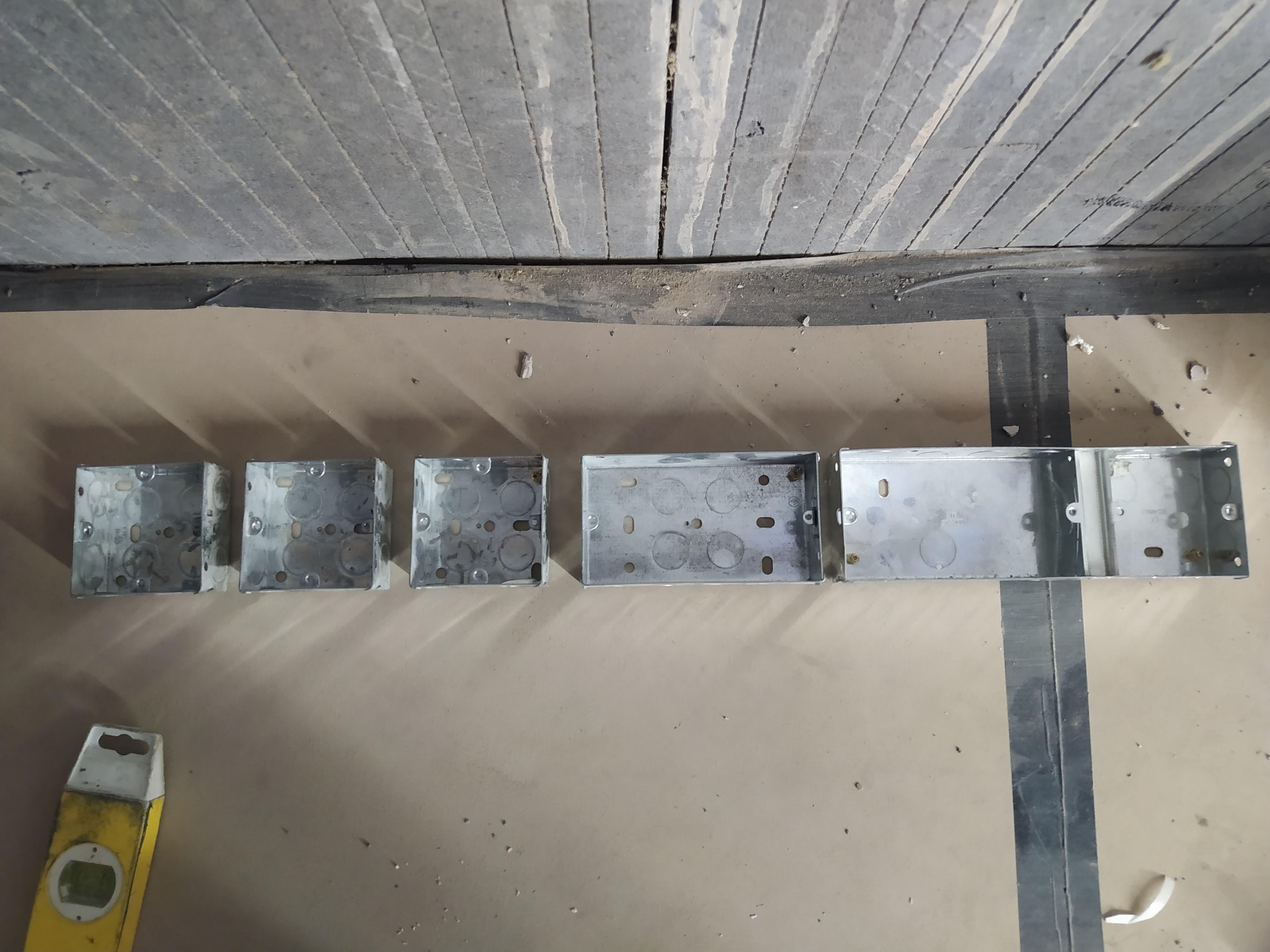

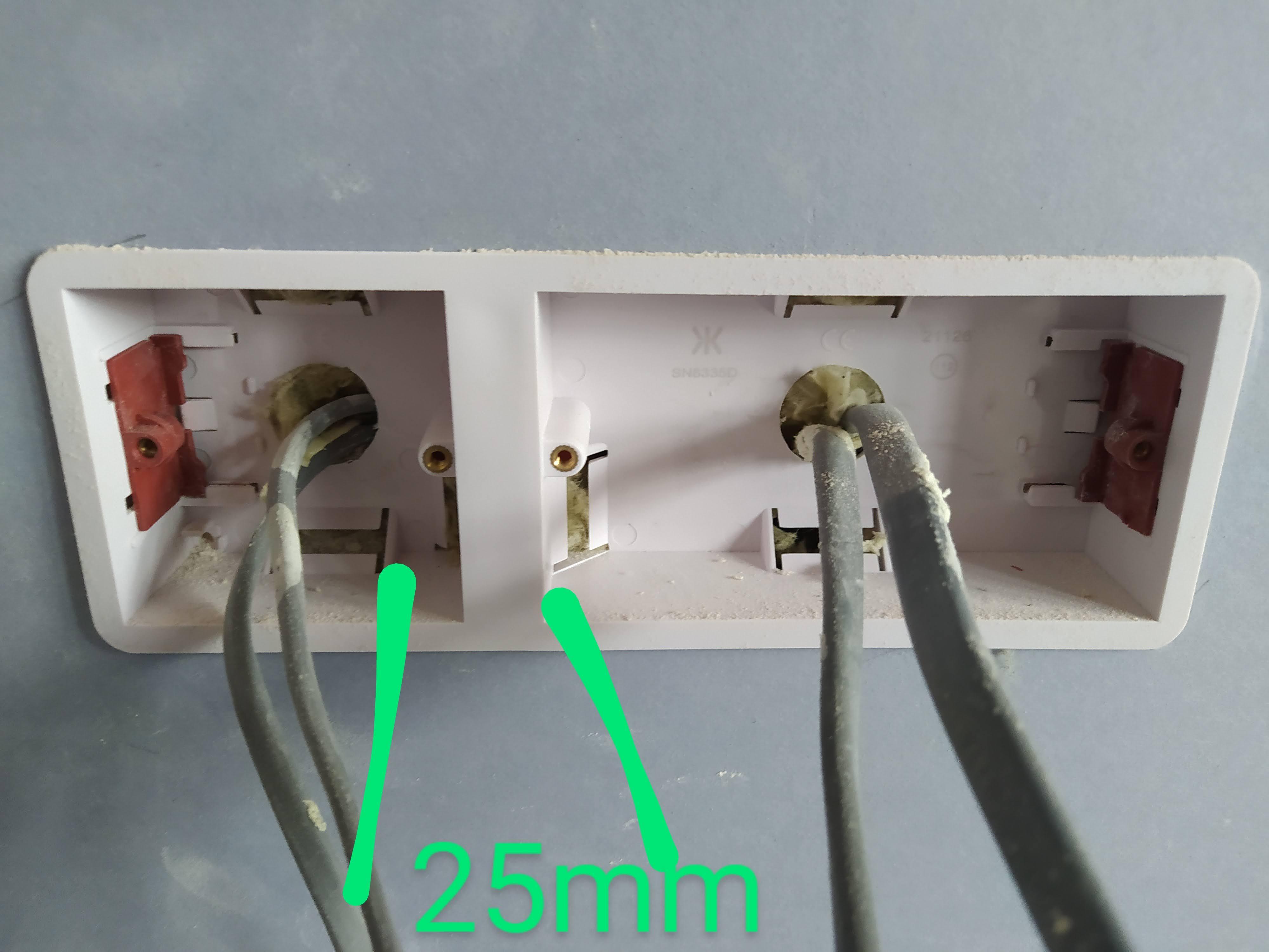

Is there a standard distance between screw holes for adjacent backboxes? Picture to illustrate, this triple has 25mm between centre of the screw holes. A metal equivalent has nearer 27mm. Is there a standard? Does it depend on what faceplates you chose? I have a long run of backboxes in the study and it would be nice to get them all snug next to each other.
