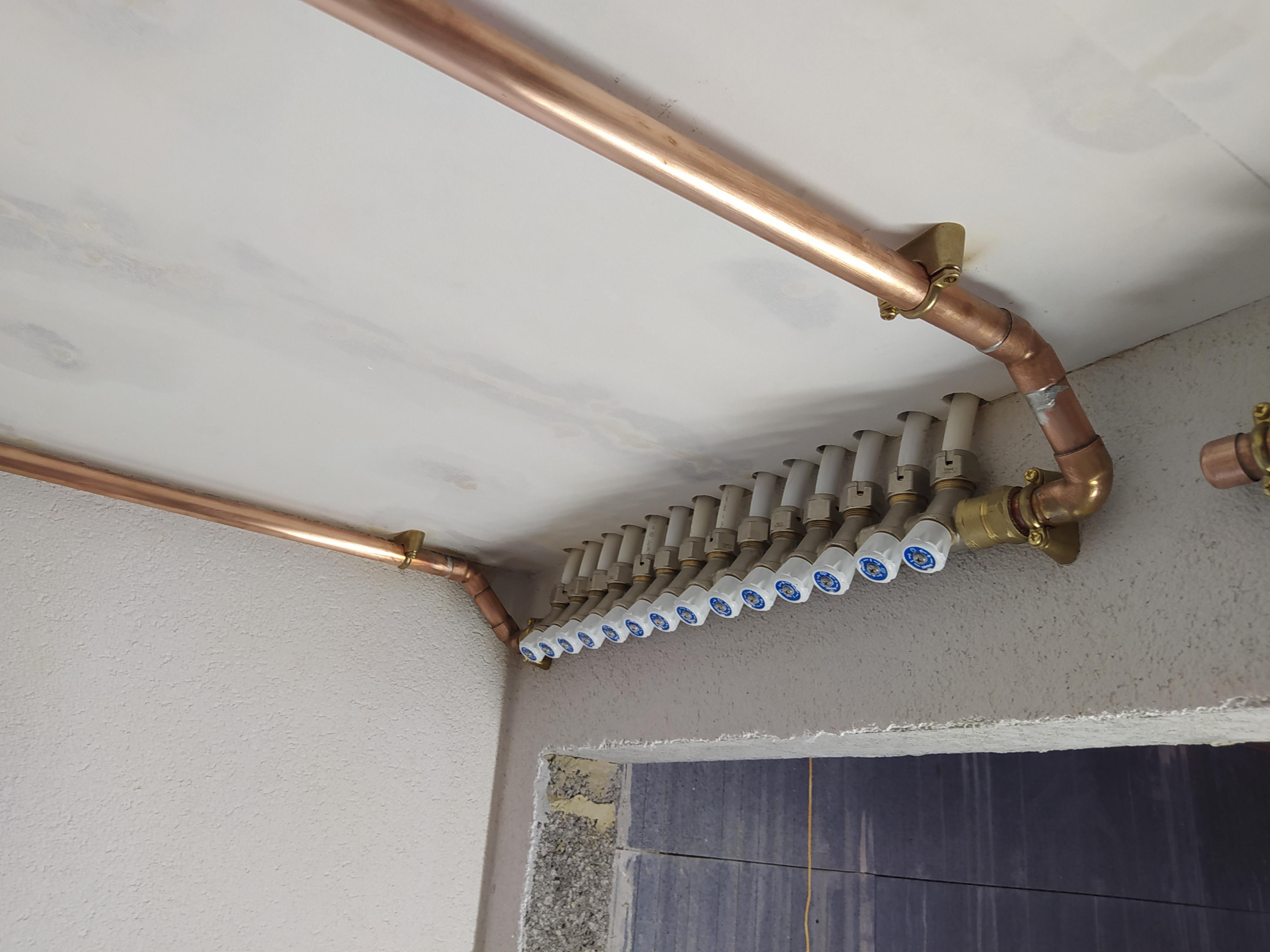

The manifolds are Emmetti and the fittings I used were Rifeng. The fittings are more expensive than Hep and you'll need a spanner! But as its only one fitting per outlet pipe and a couple for shower heads, the savings weren't lost.
Well I've done my domestic hot and cold in 16mm, all used from left over Pex-al-Pex from the UFH. The price of Hep2o pipe I found to be significant. Emmetti manifolds take the 16mm pipe and the MLCP fittings are easy to use & so far 100% reliable.

I did mine this week using the power of gravity. Took a while mind! Longer than any jobbing plumbing would have tolerated. I just rigged a funnel about 1.5m above the manifold and every time I walked past just topped it up. Assuming you have a monoblock ASHP without a buffer as no other reason for glycol in the mix?
