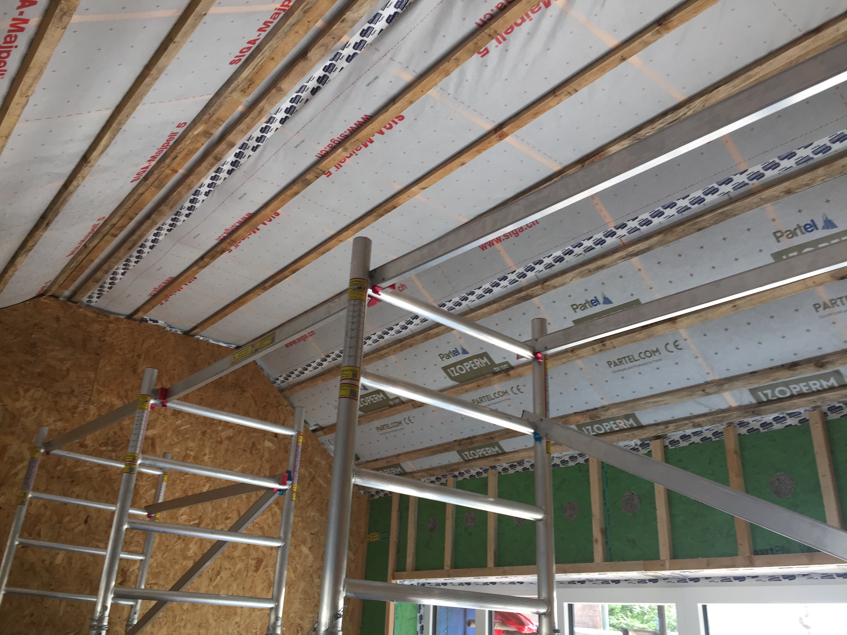

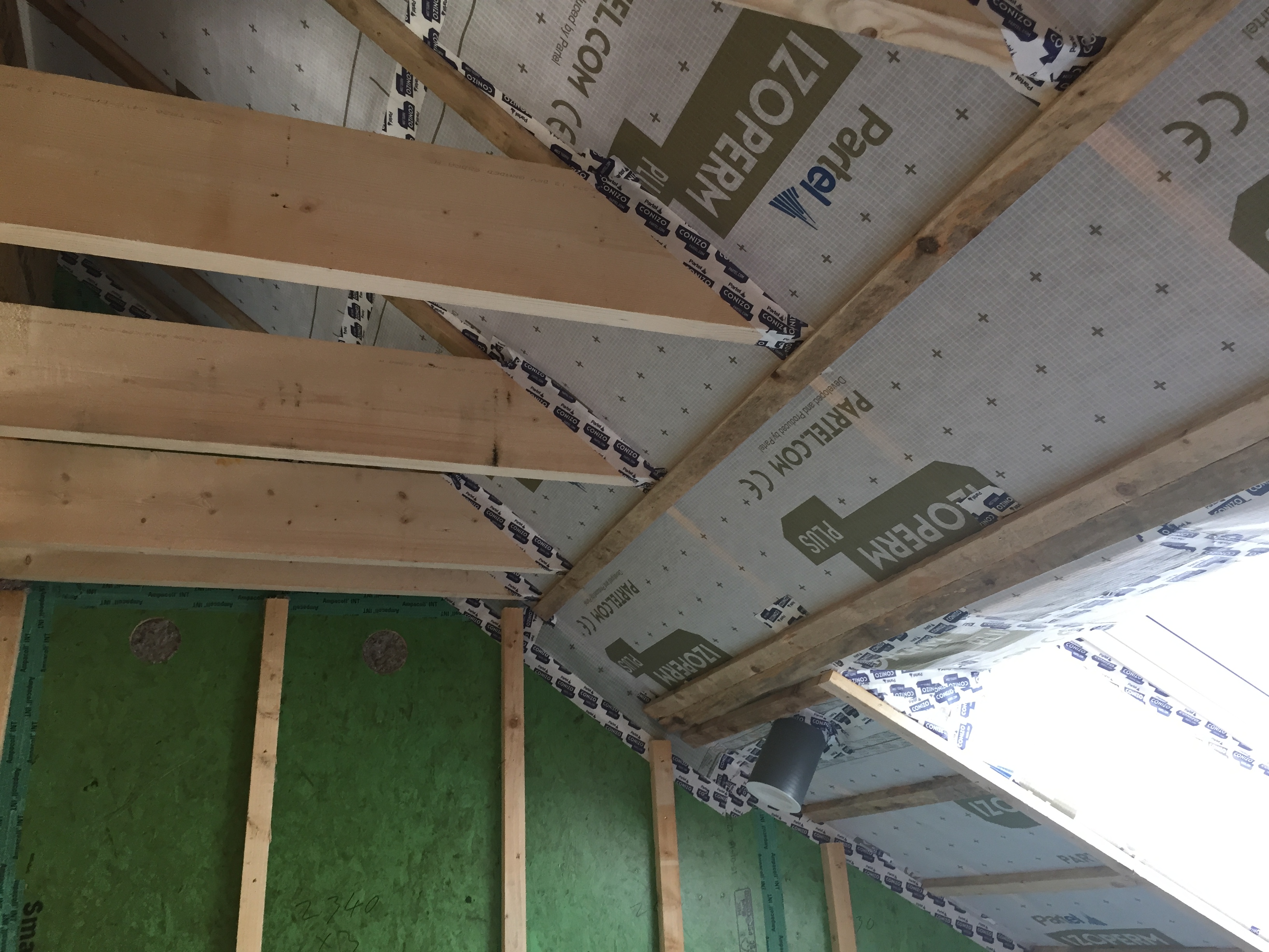

Hi All I'm pondering how I get my cable runs (lighting and power) from 1st floor to ground floor. Particularity the lighting runs which are in large part on vaulted areas. In a "normal" house you have the ability to run your cables clipped down the roof trusses but with a fully insulated frame thats a no go. Plus the counter battens make it trickier still. As we are running radial circuits for lighting and power I've got a fair few runs to get to the ground floor. I'm thinking I'm going to have to come down the walls at strategic points but how does that work with safe zones? I'd be interested to know what others have done? A few pics in illustration:
