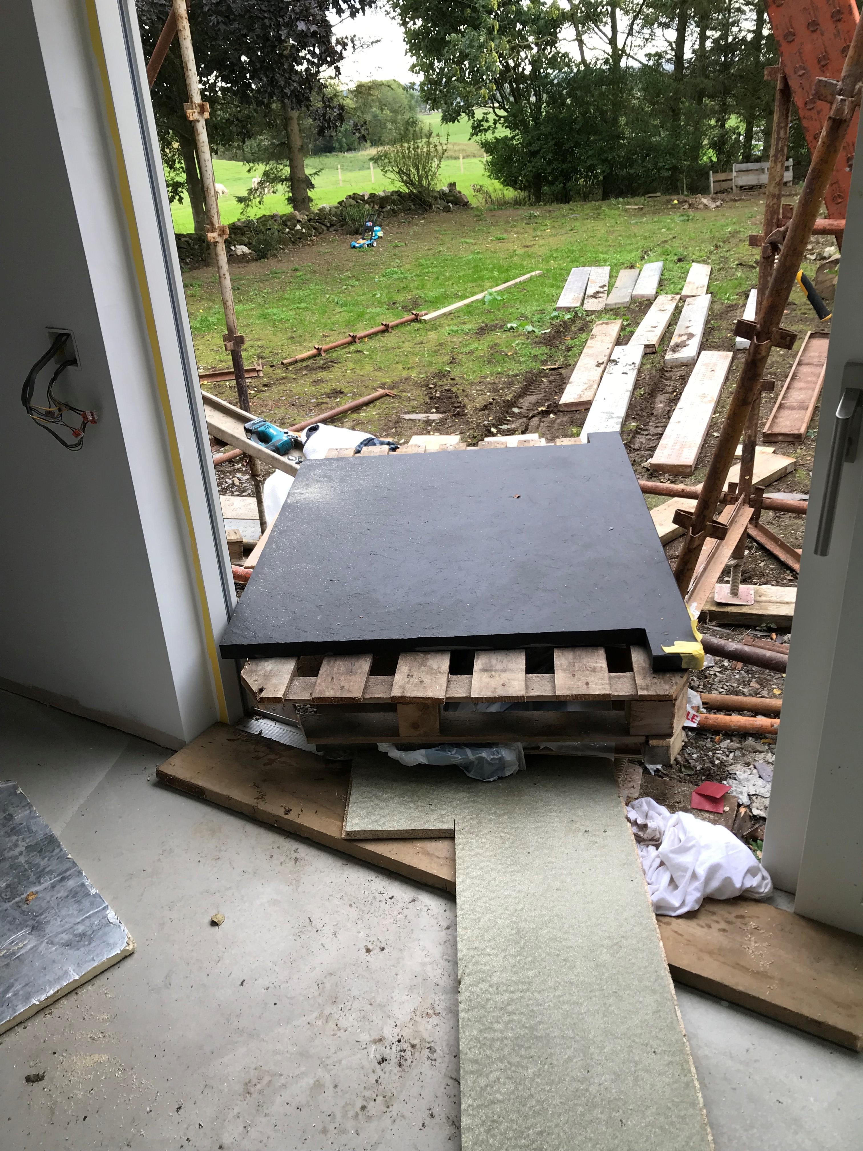

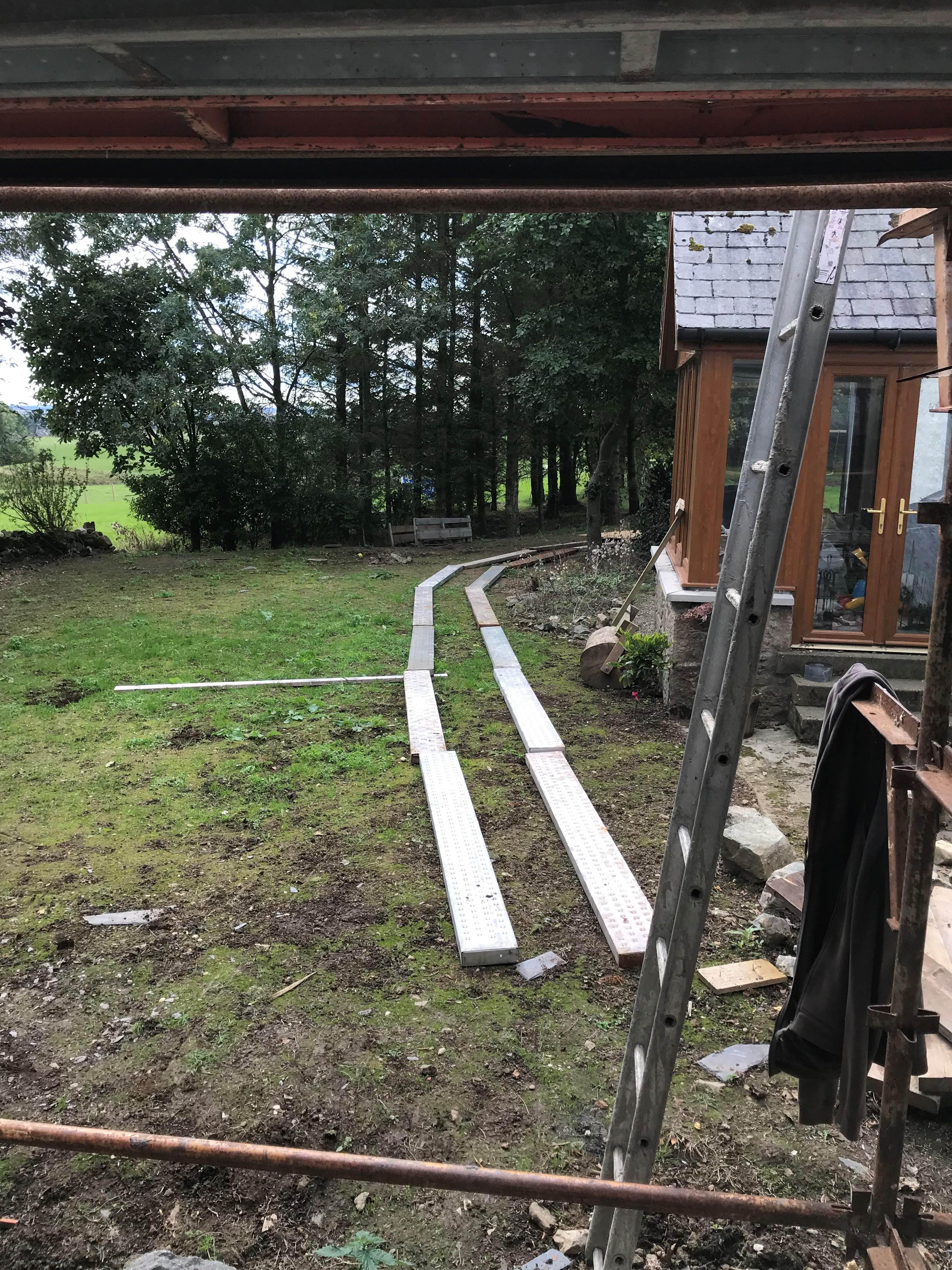

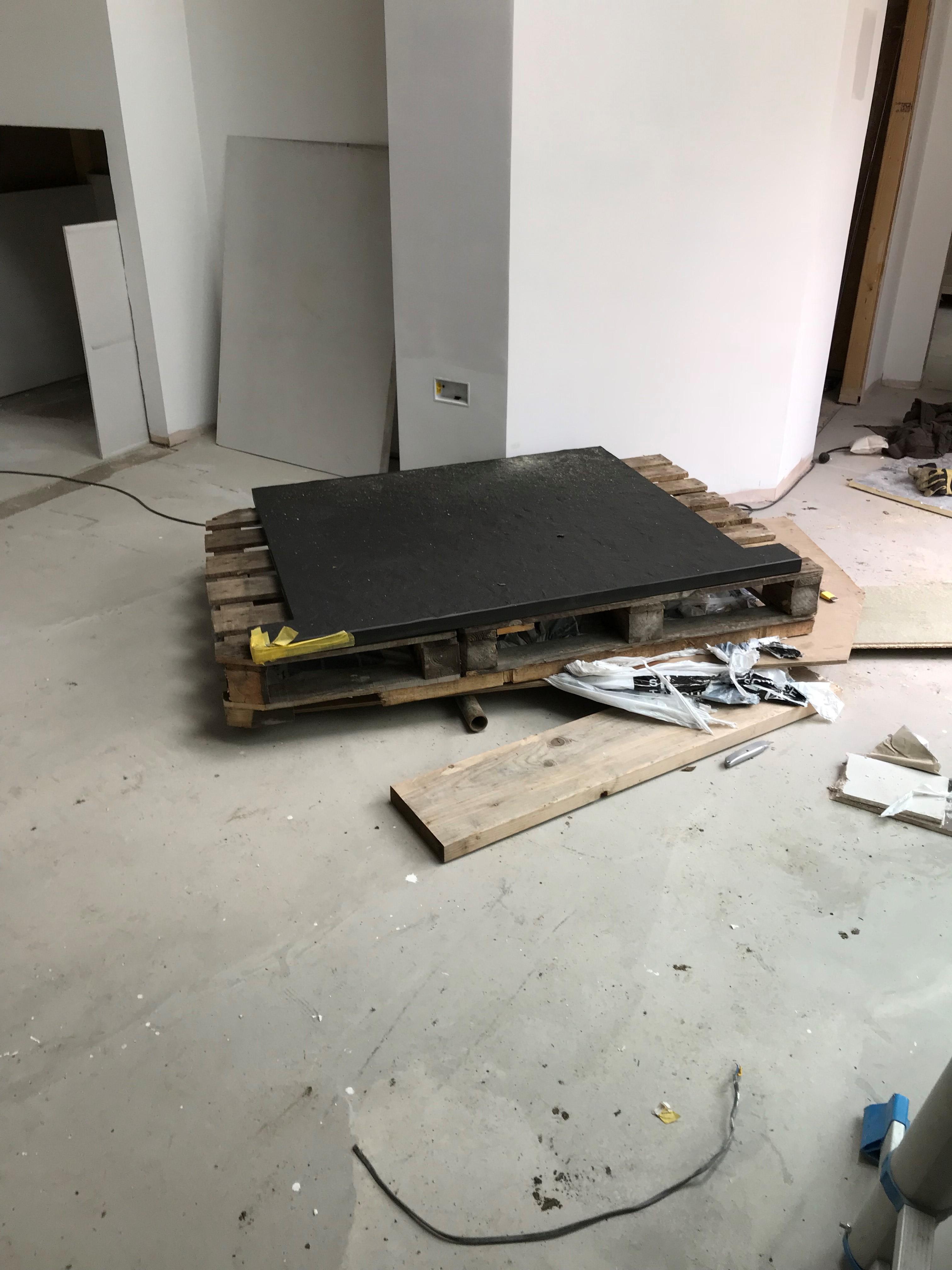

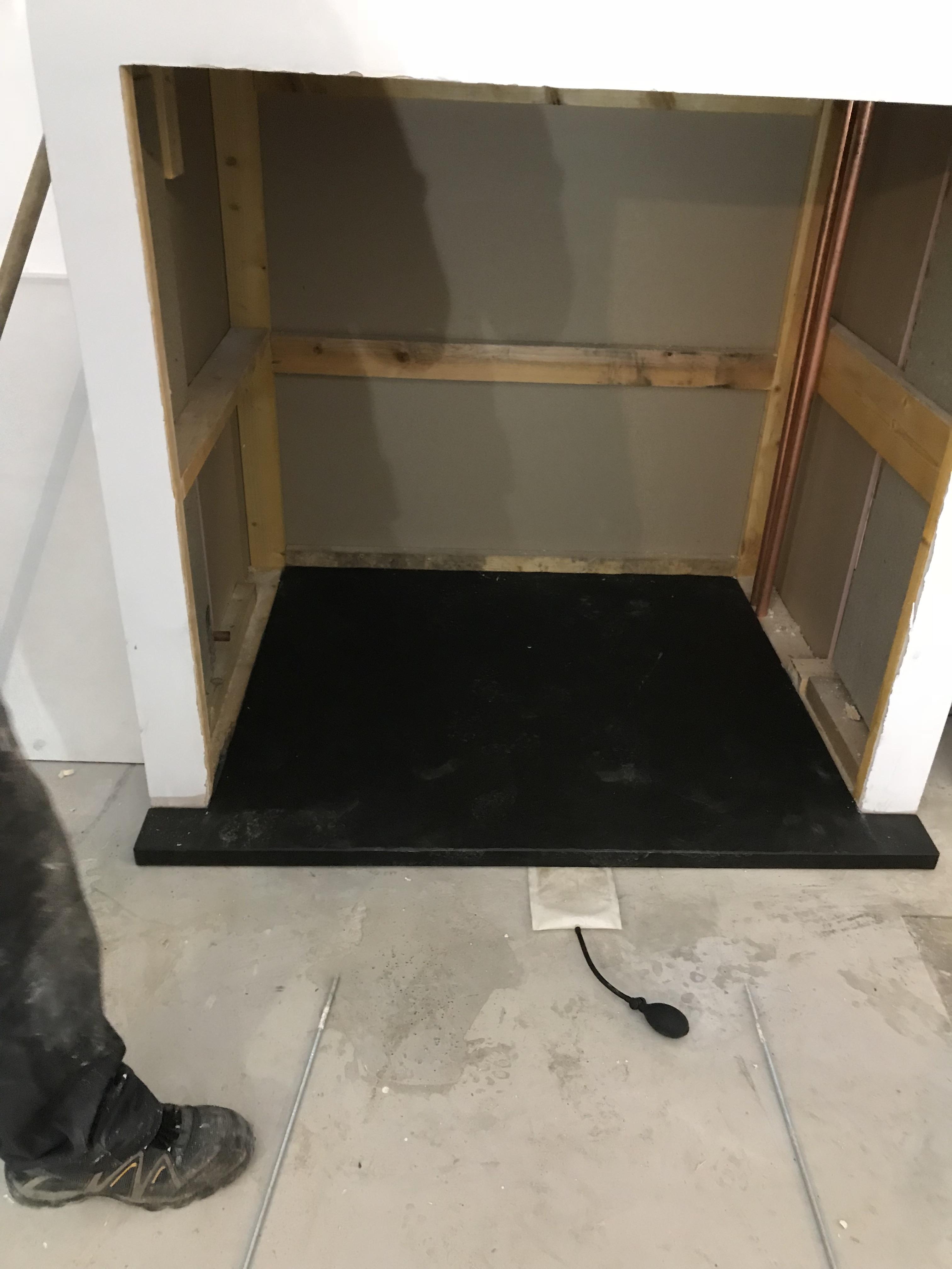

well its in the house at least I built a train track out of scaffolding board, forlifted the pallet onto some plywood topped rollers and roller it over to the scaffolding. Made a forklift track to the scaffolding then lifed up onto scaffolding which I'd prepped with another track into house trimmed the pallet with a jigsaw to maneuver into house with 4mm clearance either side through patio doors Scary times but its in at least going to self level the hearth area tonight so its dead flat, so I can just lay it on. -

come great ideas do we reckon I need any form of mortar bed underneath, given its so heavy could I just silicon round the edges? -

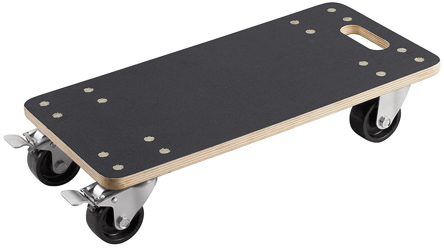

So I have a problem my lovely Caithness slate hearth has arrived, cut to fit the opening for my massive woodburner to sit on. I may have underestimated the weight of said hearth, as its over 500kg Now the problem is how to transfer from field to fireplace opening. I have a plan that gets me so far. Forklift round to patio doors. Which brings its own problems as I'll have to lay supports over the mud to drive the forklift over so it doesn't sink. Anyway, I can ' gently' lower the hearth onto a furniture dolly that looks like attached picture, and I can roll the hearth to site. However, how I get it off the dolly and lowered onto a mortar bed (well sand/cement mix) within the fireplace opening, I do not know. any bright ideas?
