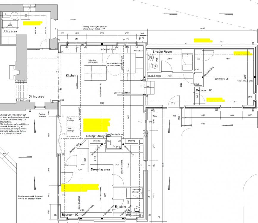

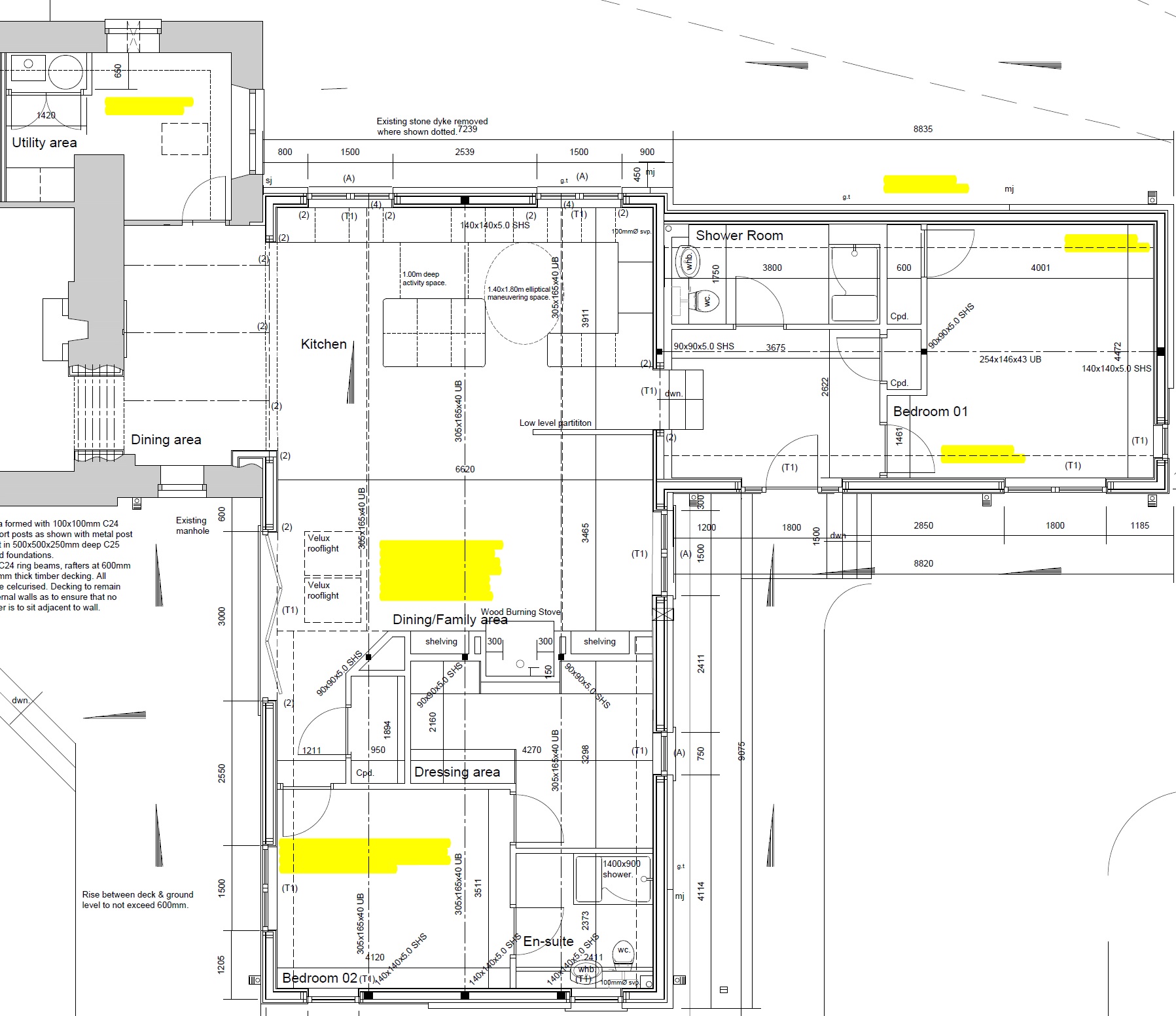

Hi there, I've been posting sporadically as my thoughts move from one topic to another. I've had such a fantastic response so thank you. Next up is heating. I'm struggling to get a hold of any local plumbers who know anything/are willing to come and discuss/ quote on ufh design, uvc or thermal stores. I've attached a picture of my extension, I've tried to remove as many layers of detail (so its easier to read) as I can which is why there is some weird colouring etc. its all on one level currently the plan is simplistic. UVC and Oil Boiler in the utility room top left connected to radiators in the old house, and ufh in the new house. It was going to be in screed UFH, but based on some research and discussion with you guys yesterday I've asked to change this to in slab pipework. my next area of concern is. 1. location of UFH Manifold and length of runs. - Looking at the heating during the planning stage it was simple UFH manifold in utility room connected to boiler, no probs. however when I look at the length or runs when I am trying to figure out layout, locating the manifold in there will mean there are some excessively long runs. could anyone recommend a better location for the manifold? can it be at a distance from the Boiler - ie located in the middle somewhere? 2. Should I be looking at a thermal store in place of an UVC. can I Heat my UFH and radiators and DHW separately from this, would it be a more efficient store to a UVC? I keep seeing snippets on 'short cycling' which is putting the fear into me. as I try and get someone local to discuss with, any pointers would be much appreciated cheers Scott

Hi there, I've a 125m2 extension being erected next year with a pretty basic floor slab planned. Floor covering 65mm Screed UFH Pipwork 150mm PIR insulation 100mm c35 concrete with mesh Whilst looking at the overall prices of each piece of work there's a couple of questions that have come up would it beneficial to change the floor structure to incorporate circa 250mm of eps insulation under the concrete slab, instead of the 150mm pir above slab. And whilst I am at it, possible to incorporate the Under floor heating pipework into the slab, as opposed to having the pipework in a screed on top of the slab? The reason for looking at this is to save time and money. The 250mm of eps insulation has similar u value to 150mm pir, whilst being cheaper - circa 1k at the moment, but there is another price increase on pir due in February. If I incorporated the pipework into the slab, I could save circa 4k for the screed work post panel installation, but it would also mean I could crack on with the studwork immediately after the kit erection as opposed to laying pipework and ordering in self levelling screed. any thoughts/drawbacks?
