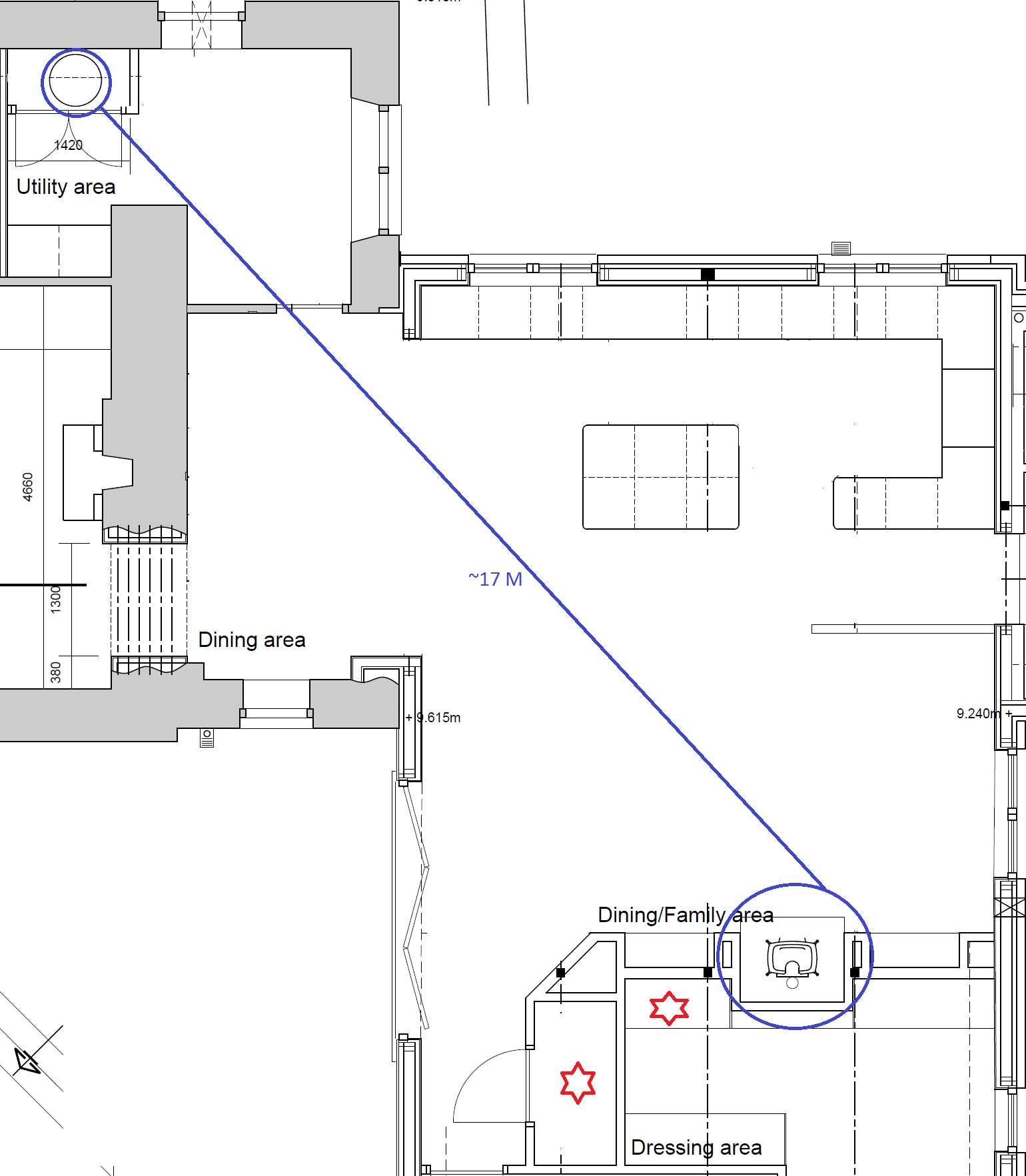

Thanks for answering 1. so post extension there will be one upstairs shower room and one downstairs bathroom to the left of the cylinder in the picture approx. 5 meters away two down stairs shower rooms to the right approximately 25m away 2. Space up stairs is very limited. typical Scottish two up two down (originially) so there's no loft and pitched ceilings, looking at the size of header tanks I could possibly accommodate in the upstairs shower room, definitely no room upstairs for a thermal store. 3. Woodburner is the focal point of the room. Its a single storey vaulted ceiling type affair so hopefully won't overpower us. we have one in the old part of the house already. 4. I do have a virtually unlimited wood source, with a large stockpile, family in the forestry and a small wood (mine) at the end of our plot but I don't want to be tied to it as my only heat source. I'd rather have oil and ideally the option to heat via wood, though I can accept this may not be possible. Given the height ceilings (circa5-6 meters) I did wonder if it was possible to fit the thermal store/cylinder in the cupboard in the living room with a header above (that's the stars on the picture) not the end of the world if its not possible, but it would have been great to use the wood.- 15 replies

ok, so another question If I could have a header tank above the cylinder, but the cylinder still on the ground floor could the distance between the woodburner and cylinder be overcome, would it be feasible to heat from a woodburner?- 15 replies

Hi there, I'm not sure which forum to post this in, so I've taken a best guess I'll be starting large extension build next year which will involved installing a new external Oil Boiler connected to a hot water cylinder on the ground floor. unvented I believe, as there is nowhere to put a header tank? in the upstairs of the old house. The old part of the house is over two floors and will remain heated by radiators. the new extension will be underfloor heating. part of the extension is a large (to me) open plan area with a woodburner in it. now that I'm firming up the build, I'm wondering if there is any way to connect a woodburner to a cylinder, on the same floor level? Attached is a diagram of the current layout, there is hot water cylinder in a utlility room roughly 17m from the woodburner. the utility room is a single storey extension. I believe the proposed cylinder is unvented, which I guess it would need a pump to heat the radiators upstairs in the old part of the house. has anyone successfully been able to connect a woodburner/boiler stove on the same floor? .I have my doubts, but its worth a shot as I have access to an almost unlimited supply of firewood, I'd love to heat the radiators via woodburner as much as possible. I'm just in the process of engaging a builder, and would like to be able to speak to his plumber with some degree of understanding. any pointers, much appreciated.
- 15 replies
