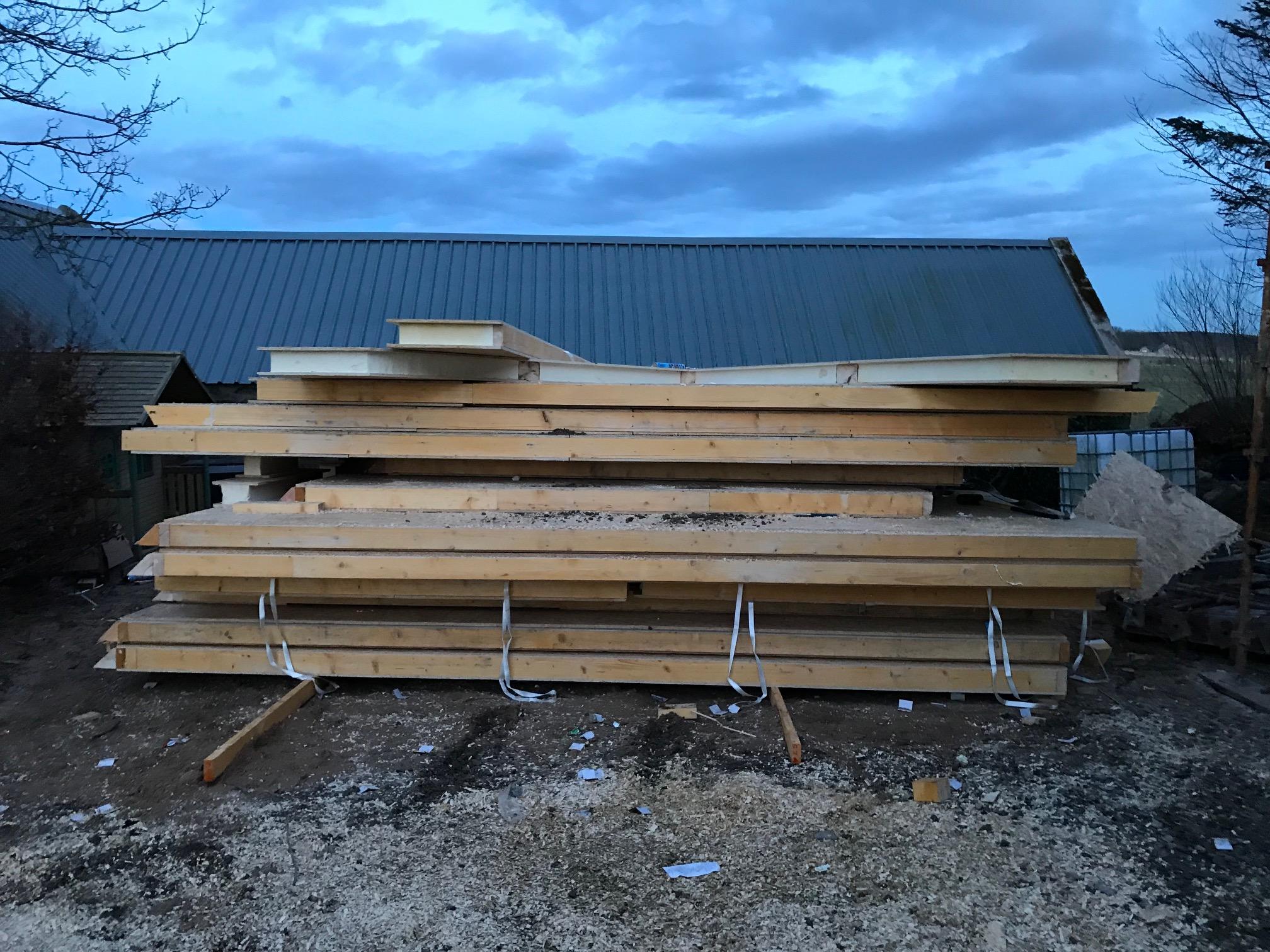

I have built a single storey 135m2 extension built using Kingspan Tek Sips It's allowed me to have 4m vaulted ceiling, and loftspace above that's warm and sealed, some interesting angles too It was purchased through THCL, who subcontract the work of erection of the kit out The team of 4 that arrived were incredibly diligent and hardworking, and specialised in this work, so the erection of if went pretty smoothly panels that were delivered onsite were perfect and did not need tweaking, which cannot be said for some of the supporting timber that was supplied wrongly The erection were not happy with the slab that was laid in terms of flatness, and 1 part being slightly askew, but worked around it no problems battening out for plasterboard etc Its nice and toasty happy to answer any specific questions -

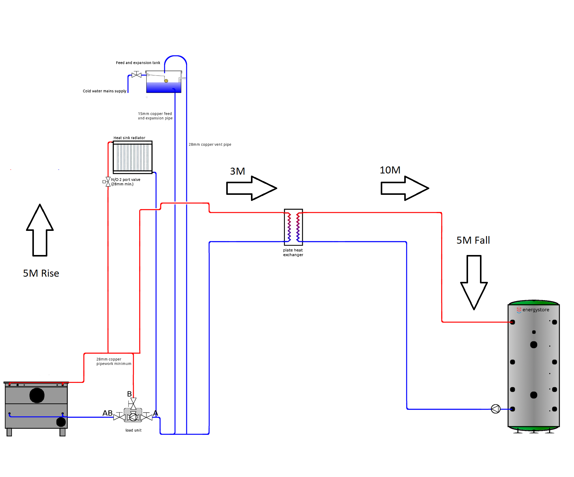

well my issue with the panels, all in one solutions is they seemed to be priced to try and take the hassle away the heat Genie comes in at over £700 + some extraneous items, as does the nrg link from ireland the laddomat set up above can be achieved for circa £500, but with a little hassle. I'm currently looking at how to power the pump in the event of power failure, even if just for an hour to allow fire to die down.
Apologies for asking another layout question- theres lots on here but I'm not sure mine will work over distances involved The situation at the moment is that I have self built a large single storey extension (with 4m high ceilings in living space and a loft) (135m2) attached to an old 135m2 farmhouse. within the old farmhouse, on the ground floor I have a 500 lt pressurised/sealed thermal store, complete with appropriately sized expansion vessel. This is powered by a 30kw oil boiler and heats the house through conventional radiators. In the extension I have an underfloor heating manifold connected to the thermal store which provides ufh throughout. I have a new boiler stove- an Arada Stratford 25HE Ecoboiler Wood Burning Multi Fuel Boiler Stove, which requires an open vented system, and as such I was thinking of a load valve or loadunit/plate exchanger etc. I am yet to purchase anything that would go between woodburner and thermal store I have plumbed in and insulated 28mm flow and return pipes from the thermal store to the woodburner, which is roughly 20m away on the same level, but the pipes route up and through the ceilings. I have plumbed in an overflow pipe from loft above thermal store down and out through wall I have access to mains cold water in loft above woodburner I would have ample room in the loft above the woodburner to install any equipment I would appreciate advice on whether a laddomatt type install would work (picture attached) also would a load unit/load vale be able to be placed in loft 4m above WBS - level with plate heat exchanger 4 m or does it have to be level with WBS The stove outputs 22.5kw to water - I've not bought, nor sized heatsink radiator, but I've plenty room to put multiple rads I was planning a pipestat or flue pipe stat to kick off the pump in load unit please ignore the fact both ports are linked on back of WBS that's just from a graphic I stole

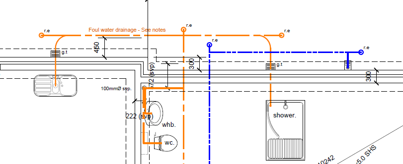

Hi no problem with patio unfortunately I already have rodding eyes,, traps etc, so inspection chambers would add cost - possible I could go ahead and buy them though not sure on the 222, I think that might be wall width as its where two structures meet nothing in the notes of any interest in terms of 'foul drainage; -

I had two mins, so here is an excerpt from plans (you can see gulley trap noted at sinks) you can see rodding access then you have my mspaint rough an ready drawing -
