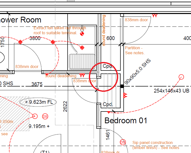

So, I've not previously mentioned that one of my underfloor heating loops leaked. I turned on the underfloor heating for the first time circa a month ago, and after a few hours a wet patch appeared in the concrete slab ( It happened the second time too.), roughly where I've circled in the picture. no problem I thought, I know why there would be a leak there. despite trying my hardest not to kink a pipe, I kinked a pipe running the last loop to the manifold, I didn't have time to strip it all off and re do the whole 100m loop, so I took a shortcut, rather than routing through the door way, I had just enough pipe it I nipped it under the built in wardrobe wall in a straight line. the panel company had been well warned where not to nail, but I guessed someone forgot and stuck a nail in it (and then removed it) anyway fast forward to last night, as I trekked home from work with a $6000 Thermal imaging camera to have a look and see if I could spot where the leak originates/exactly where the pipe is I had great fun looking at all the loops and happy to see all 10 loops working , warming the floor and house to an uncomfortable level (I set it as high as I could). Great fun as I wait for leak to reappear, unfortunately the leak has not reappeared. no wet patch, not even moist- left overnight, and still nothing. I'm not sure what to do, where to go form here. The concrete had been down for months before test, and the wet patch was very very localized, so I cant see it being moisture/condensation. It was sopping wet? I surely cant take the risk and floor over it, as it will inevitably leak. any suggestions?

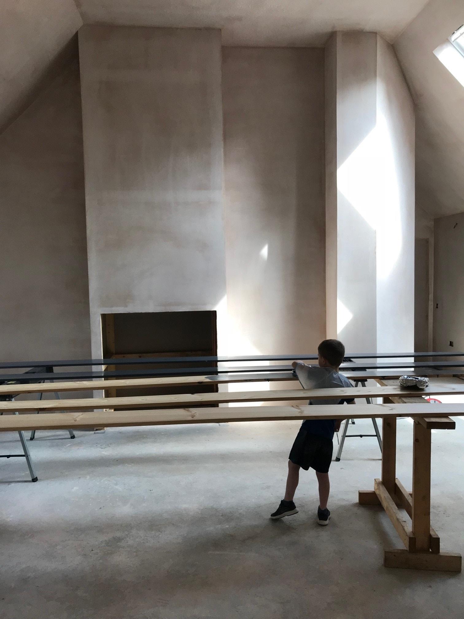

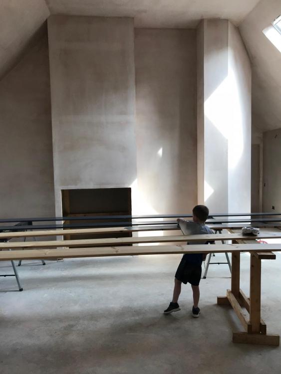

its less exciting that it seems the alcoves to the left and right of fireplace will be filled with shelving, essentially making it a normal wall, behind the boxing on the right is a massive storage cupboard with ufh manifold and consumer unit and pretty much enough space to house a nuclear missle silo, The reason it is angled is there are large sliding patio doors to the right (under the velux) and the angle allows more light, more space etc to and from living area. there you go, told you it was not exciting.
Here's some inspiration from my current state, looks lovely even without paint on it (please no one point out any flaws)

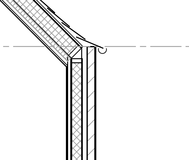

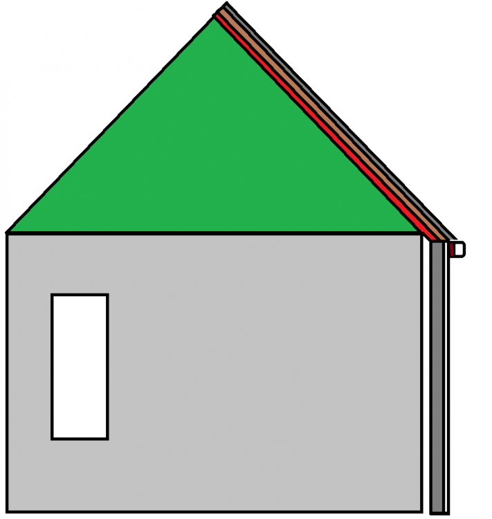

Jeremy/ mr punter, I'm not understanding, any chance of a drawing? -

theres no overhang of roof panels at all. -

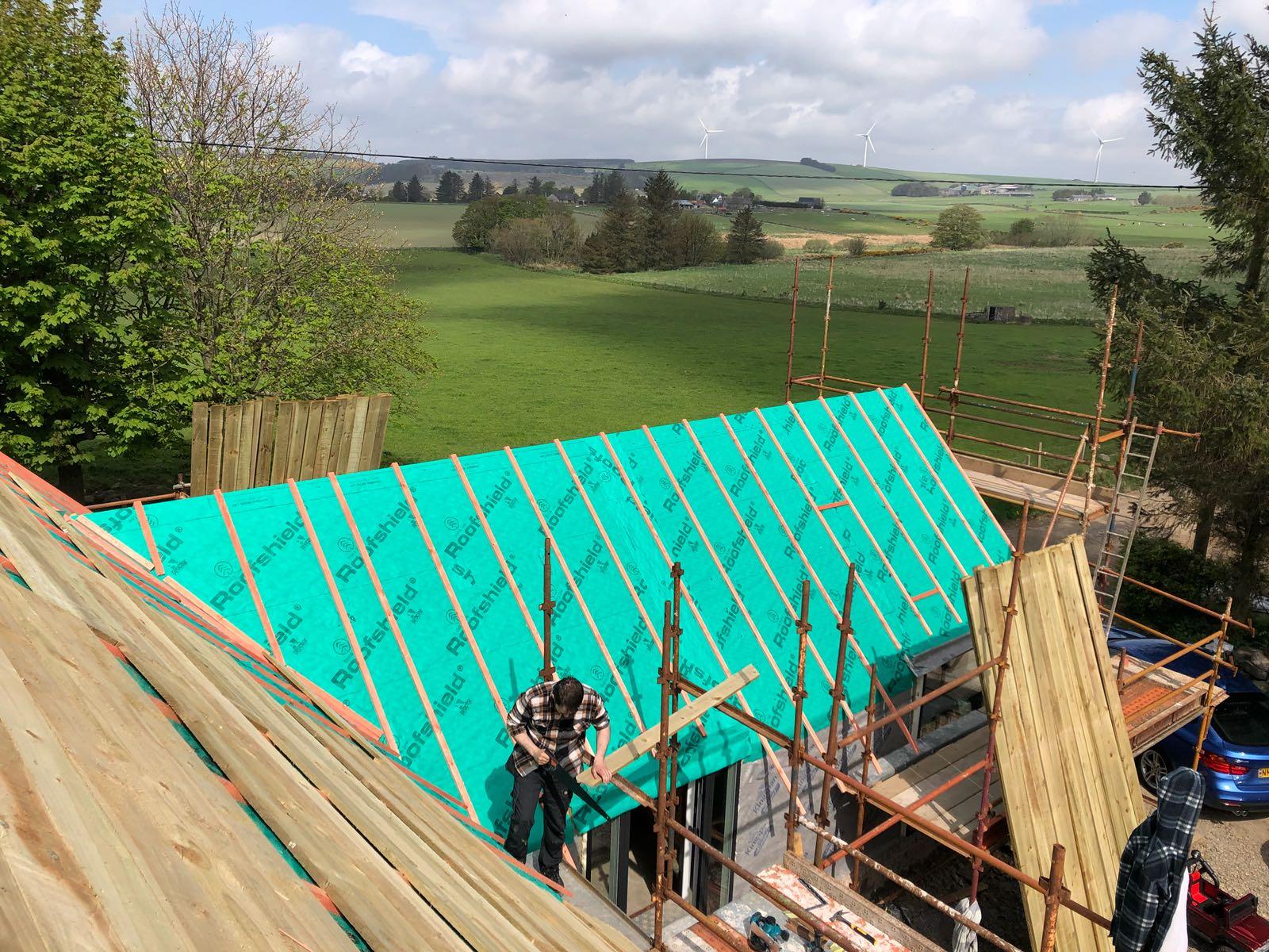

only photo I've got that kinda shows it battens put on before sarking. (the green roof) sarking on (the wooden roof) another membrane to go over sarking. -

there are no rafter ends, its sips panels, so its very much shaped like the green/light grey -
So I'm a bit stuck I have my house kit up, blockwork guy says blockwork goes on after roof to allow for settlement. roof guy says how can you start the slates without the fascia in place? I'd rather start slating asap as scaffolding is in place and blockwork isn't being done for another month. I hate boxy fascias and overhangs etc so I'm aiming to just have a very simple timber fascia (painted 2x6) to pin the gutter to, or ideally no fascia at all and blockwork all the way up. the current house is shown below in a simple graphic. the roof is as per the green. I have battened it out (the red) and attached sarking board (brown), with a 250mm overhang. The reason for overhang is the 50mm gap and 100mm blockwork to go up, render and along with any timber and the overhand of slate to gutter. I've screwed on the last sarking board so I can take it off and cut to size or extend if needs be. So how to I start the slating. just start with an imaginary overhang. or do I attach something to the building that allows a temporary fascia/gutter to be put in place? Am I making any sense? Scott

so, the SIPS panels company threw up the panels and wrapped the house in nilvent on walls and daltex roofshield on Roof I didn't expect membrane to be put on at all so when questions the manager said Yes membrane is on, but you'll have to batten at 600 centres to leave a ventilation gap, then sarking board on top. I've put a second layer of membrane on the sarking (or I will once finished) as the roofshield has plenty holes it in where the lifting straps etc for the roof panels were cut off.
its Scottish roofing practice to nail slates direct to sarking board.
Roof Panel Makeup from top to bottom. Slates Membrane Sarking Battens Fabric SIPS Panel

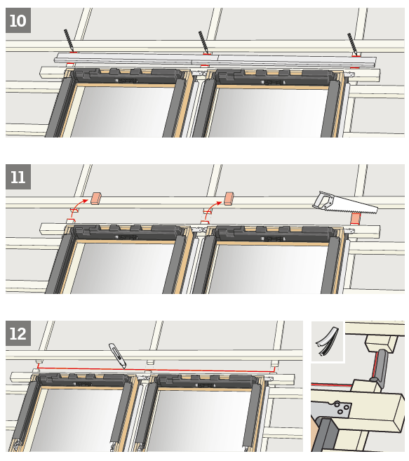

Morning another stupid question I'm looking to install two velux windows onto a roof with 22mm sarking boards over 25mm battens. the velux windows have a gutter at the top, run at a slope. The instructions show the cutting out of batten/counterbatten so there is none, with the gutter sitting directly on roof screwed into rafters. My roof makeup is sips panel, 25mm batten at 600 centres and then 150mm wide sarking boards. so without being up there and trying it out I'm struggling to see what to do here. do I put the gutter just on top of the sarking board, which means its higher up the window than shown below, do I remove the sarking board/part of it to attached to the batten below which would be at the same depth on the window as picture below, or removed sarking board and batten and have it at a lower depth.? confused. help appreciated.
