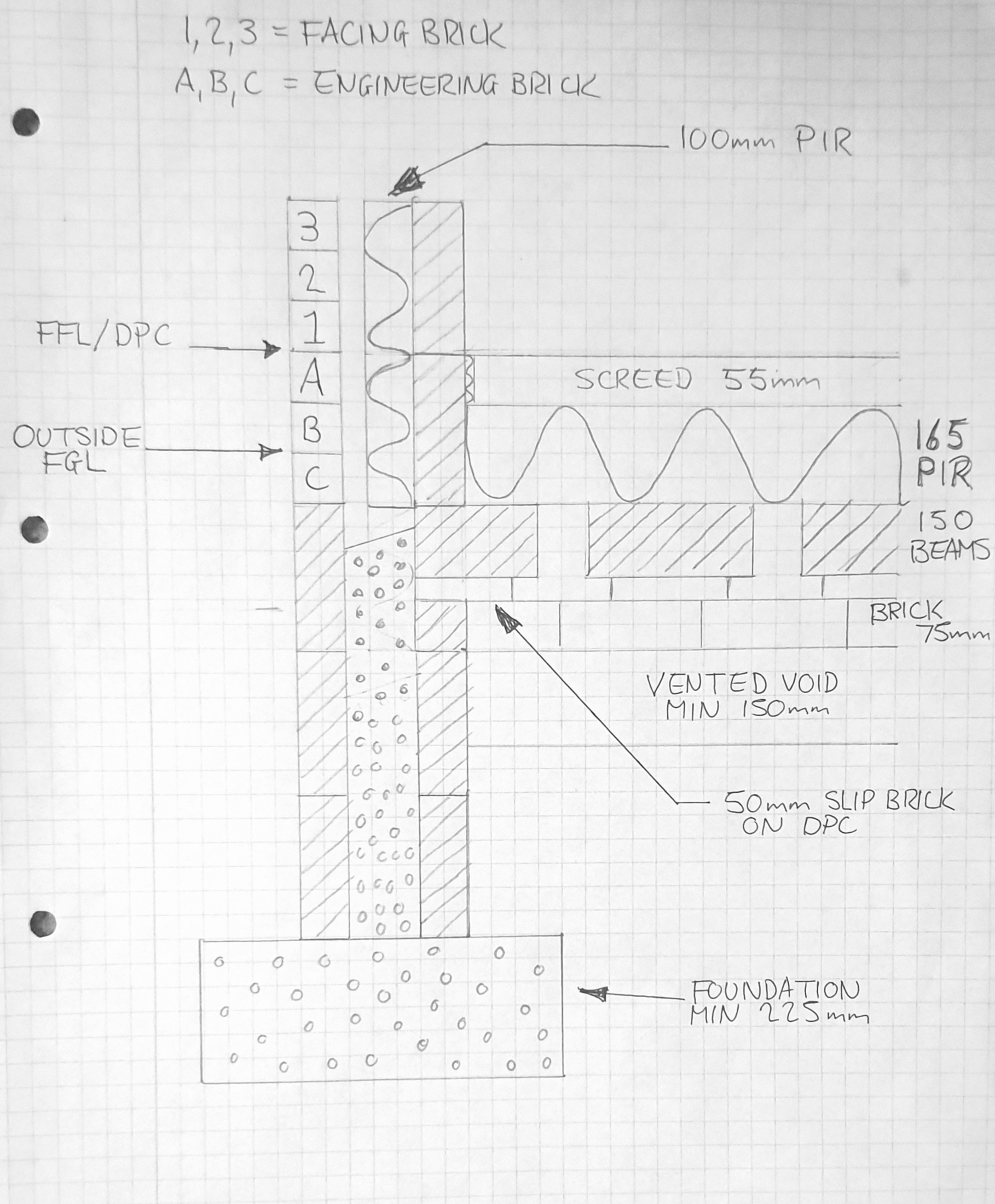

@Dave JonesThanks Dave, whats the difference with the marmox blocks and a celcon/aircrete/thermalite block for the first course? I was going to run a course of them round before I build my inner walls with normal block on top. The marmox looks very expensive. I had a look at EPS and I'd need 240mm to equate to 160/165mm PIR. The saving was £700 but by the time I'v bought the extra course of bricks and paid the labour it just works out the same. -

@Canski *on quotes just delete the text unwanted and then tap enter twice at the ned of the sentence to split paragraphs* It's always good to hear from experience. It does sound a bit of a pain if the tolerances of the PIR are out. For the price you pay a tenner a sheet and £4500 quid later it should be machines to size. My joists are going on internal masonry hangers. Door and window reveals say they need a wall tie every 225mm so they'll need slit to. I won't be able to use a PC lintel over the external vent because it's all facing bricks otherwise I would. -

I was looking at the boards and imagine the tongue at the top and one side adds the small over size but just needs slit into by the wall tie to make the T&G meet tightly together rather than square edge that neatly slips between but then has all the problems of the gaps if incorrectly fitted or a bit of wind gets at them while building. There will be 100 PIR and 50mm cavity spare, 350mm in total so I think 275mm wall ties are the correct ones, need to check the drip loop in the middle is away from the 100mm board. Yes good point, I was thinking of this, I was planning on fitting the vents the same way, it will mean they probably can't be spaced equally from outside, it will just be a case of finding gaps between the beams that align with the brick bond outer wall and within the maximum recommended spacings. I was thinking to build the infill mix up to the top of the first brick on the inner leaf which would be just under the telescopic vent, then we'll have to infill before fitting the vents to the slip coarse. It depends on how high it needs filled to provide support. I'm sure I seen it needs to have a 150mm gap to the underside of the insulation which would work out well. (So lower than my last sketch) -

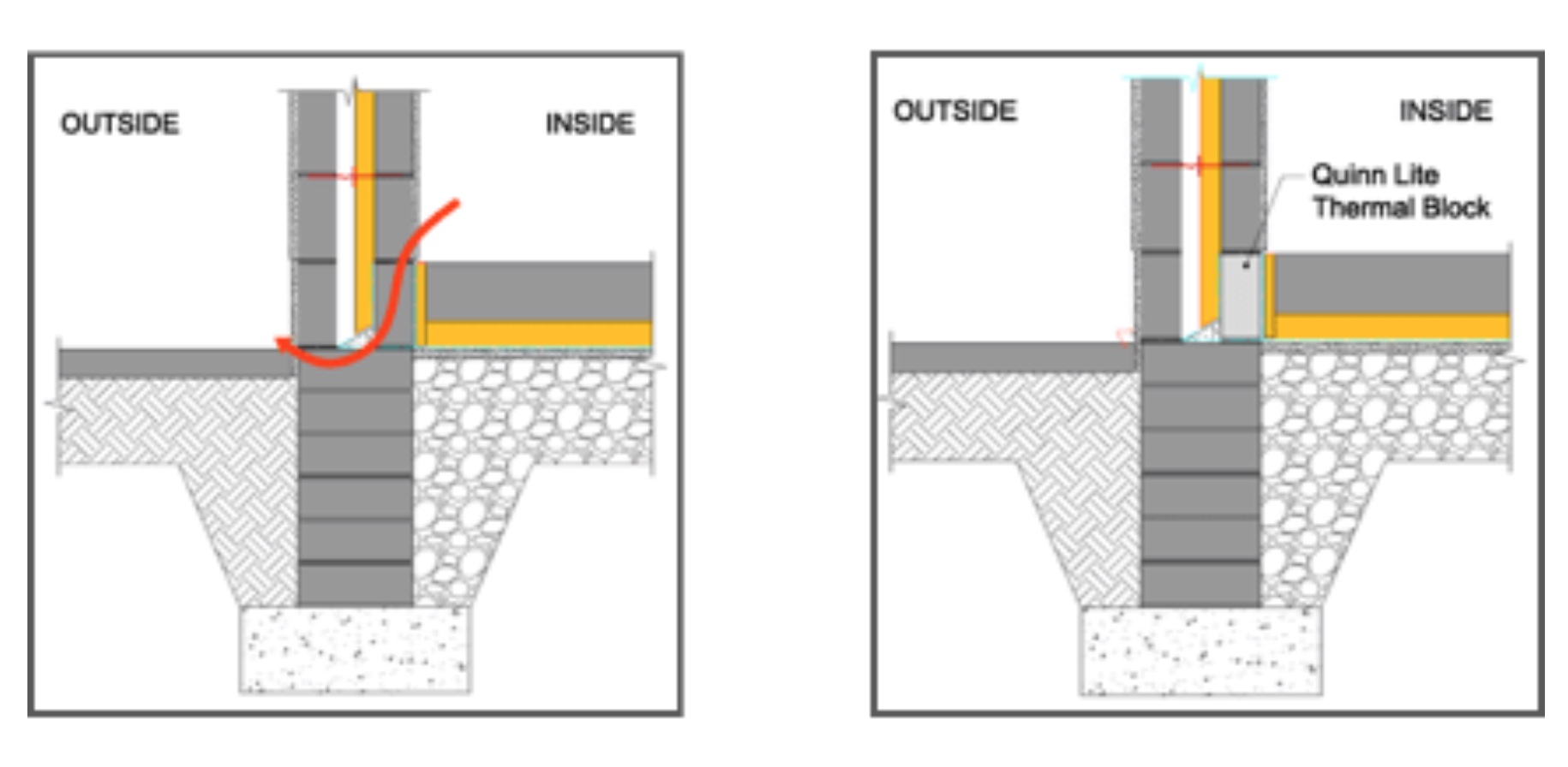

I think if the founds are decent the builders happy to use trench blocks for the first course, I've had a few mistakes with my plans so just trying to get the last part right. I'm not sure how much building control hold you to the plans for below DPC. They've already passed them, we are just changing to suspended beam for heave reasons. If taking the insulation down another block course was beneficial for cold bridging I would but if its so minimal I'd rather spend my time and money in other areas are all to a good standard. Thanks & I will be posting some progress up for others in the near future. -

Slight edit to the original post sketch. The height of the lean cavity infill can be lowered to suit. Builder doesn't like to run the first course in trench blocks, something to do with them not being as easy to cut and level up if the founds arent level. The first inner leaf block on top of the beam and block floor will be an aircrete type like my last post. My question is, I'd like to know if the cavity wall insulation is fine as it is or has to go down abother 225mm? I cant see any benefit to it being lower down. The screed has insulation under it, the vented void will always be cold air, the inner leaf has the insulated block on it. The way drawn works out well for pallets of xtratherm tongue and groove pallet orders, if i go deeper its into another £1500 pallet so I'd have to do the base coarse in stocked square edge or xps. -

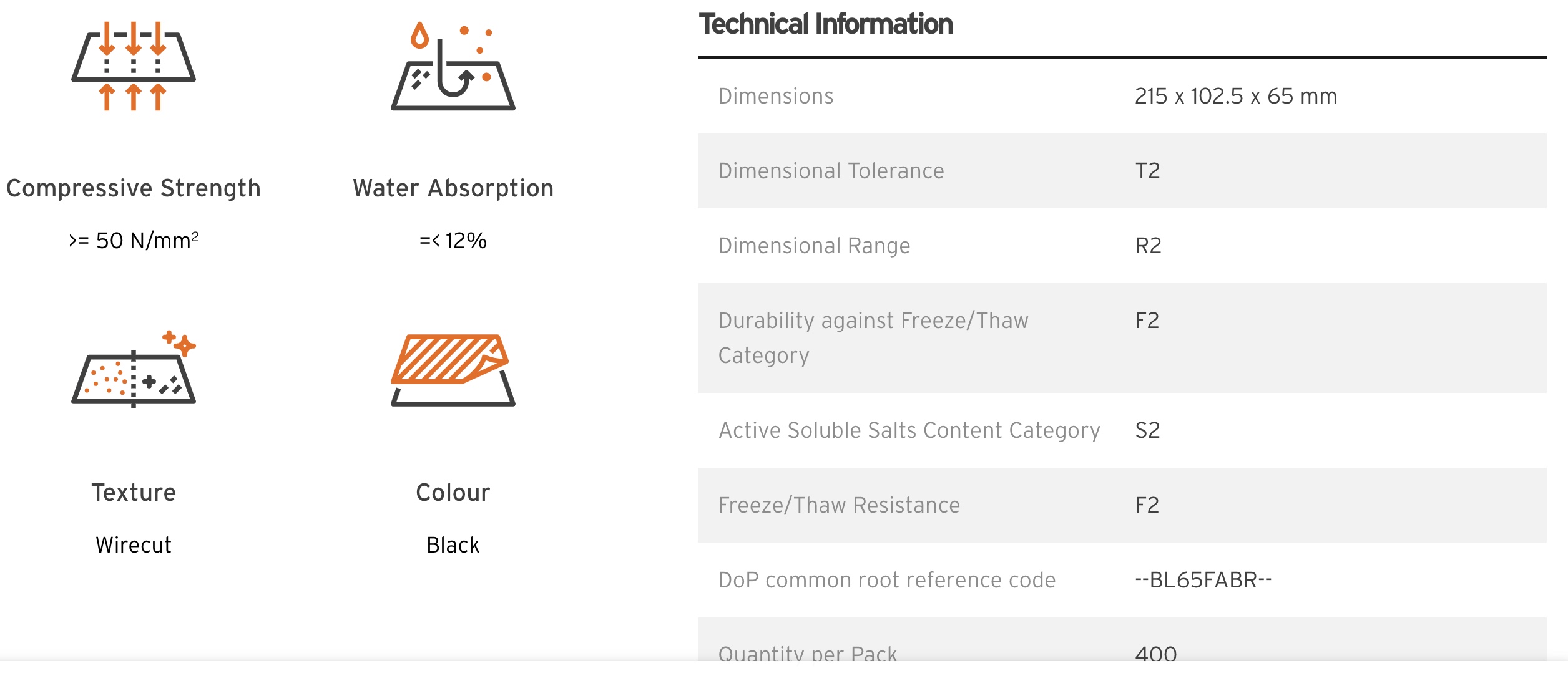

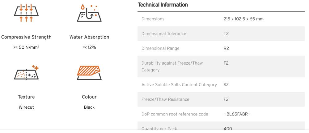

This is the only small problem, I asked the person who sources the bricks at competitive rates for our local merchants for a certain amount of engineering bricks like staff blues from a brand that is close to the amount i require, so I'm not buying packs and having hundreds spare and they came back with the the above brick saying as long as they're S2 F2 they're all suitable. I think I need around 900. The light grey brick I chose for the house is F2 S2 and 10% but I can tell it would be crap if used below DPC so I just wondered if theres more to it. A Staff blue you can tell just holding it. -
Could someone advise on the best type of brick to use below DPC on a house. I need to select a black brick for 3 courses below DPC, 1 course will be under the side path level and the other two courses will be above finish ground level. Some searches say 4.5% and others say 7.5% water absorption. I was recommended the following brick which is 12% absorption, and is F2 S2. My facing bricks above DPC are <10% and F2 S2.

I'm all for simplicity at this stage, not yet broke ground but too far to make any big changes. Building regs are passed we are just swapping over from slab to B&B on the plans for a spring start I hope. No one seems overly concerned about adding or taking away a course in height as long as it's all vented correctly & following the standard construction. When you refer to a course of aerated block, do you mean like this image attached, or one of the below DPC courses? -

I was just focusing on the block selection rather than the correct detail for floor insulation. I understand that but haven't worked with foundation blocks before. All the ones online seem to have strange sizes. I was hoping to just find some foundation blocks 440mm long x 215mm high in varying widths to suit my walls, 350mm, 300mm & whatever will go under the walls supporting 100mm beam ends that will only have single load bearing walls built above them. Most foundation blocks seem to be 3.6Kn not 7.2Kn and made from aerated material. Are these ok to use or problematic like the aerated blocks used above DPC which always have cracking issues? One of the builder I was looking to use still use the double dense block with infill method. Other than time, are there any cons to using this method nowadays? I just had a quick look, jablite 70 at 240mm would probably save me £700, the 160mm PIR was going to cost £1800. I''d need to raise the internal garage floor up by 75mm though to keep the heights correct between the house and garage step down. Jablite customer service staff were the least educated of any company I've ever dealt with in my life. Two women taking calls who said they have no training and no data at all on their own product. -

Would the telescopic vents install ok as per sketch where the T beams & slip bricks are set on a course of brick?
