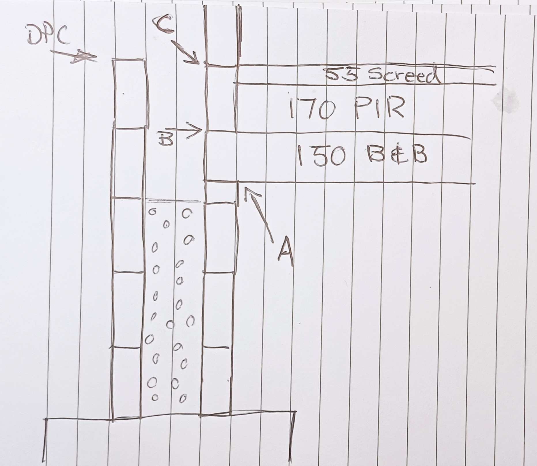

  1. Masonry build here. So to be clear, you're going from under the beams, then turn up vertically to protect the ends of the beams, then coming back in over the top of the first block thats laid onto the beam and block floor? Which on my sketch would be from A to C? 100 under the beam, 150 beam, 225 block, 100 back into the coursing, Total, 600 minimum. Where as I was wanting to wrap from A to B because my wall ties and insulation will start At B, so 400 wide roll.

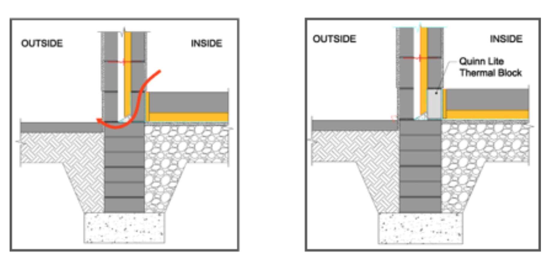

  2. Thanks, it was to check how the beam ends are protected from moisture ingress from the cavity. Some add plastic caps, or bitumen paint the ends, or dpc wrap as described, others just leave them exposed. The bottom of my insulation starts level with the top of the beams and a thermal block will be used for the first inner course to minimise thermal bridging. The original builder wanted to have a dpc wrap from A to B, said they always do it that way. I'm aware of the make up layers for the dpm and ufh, but not which way they under or or over lap the dpc skirt. The newspaper builder will know this, but for my understanding, I'd assume the dpc hangs vertically down the wall into the room, and the dpm comes across the floor then laps up the wall, over lapping the dpc and tape sealed between the two?
  3. I'm due to install my beam and block floor and my plans are generic rubbish, I'd like to know where the dpc should be placed. Ive attached a sketch of my build up.(insulation not added to sketch). A: this Will require dpc under the beam ends. Some builders place a wider dpc under the beams, like a 400mm wide and wrap the end of the beams exposed to the cavity, then bringing it back over the top of the infill blocks at B. Is this ok, or does it cause a slip plane since A & C are required. 😄 this will be the dpc skirt 300mm?

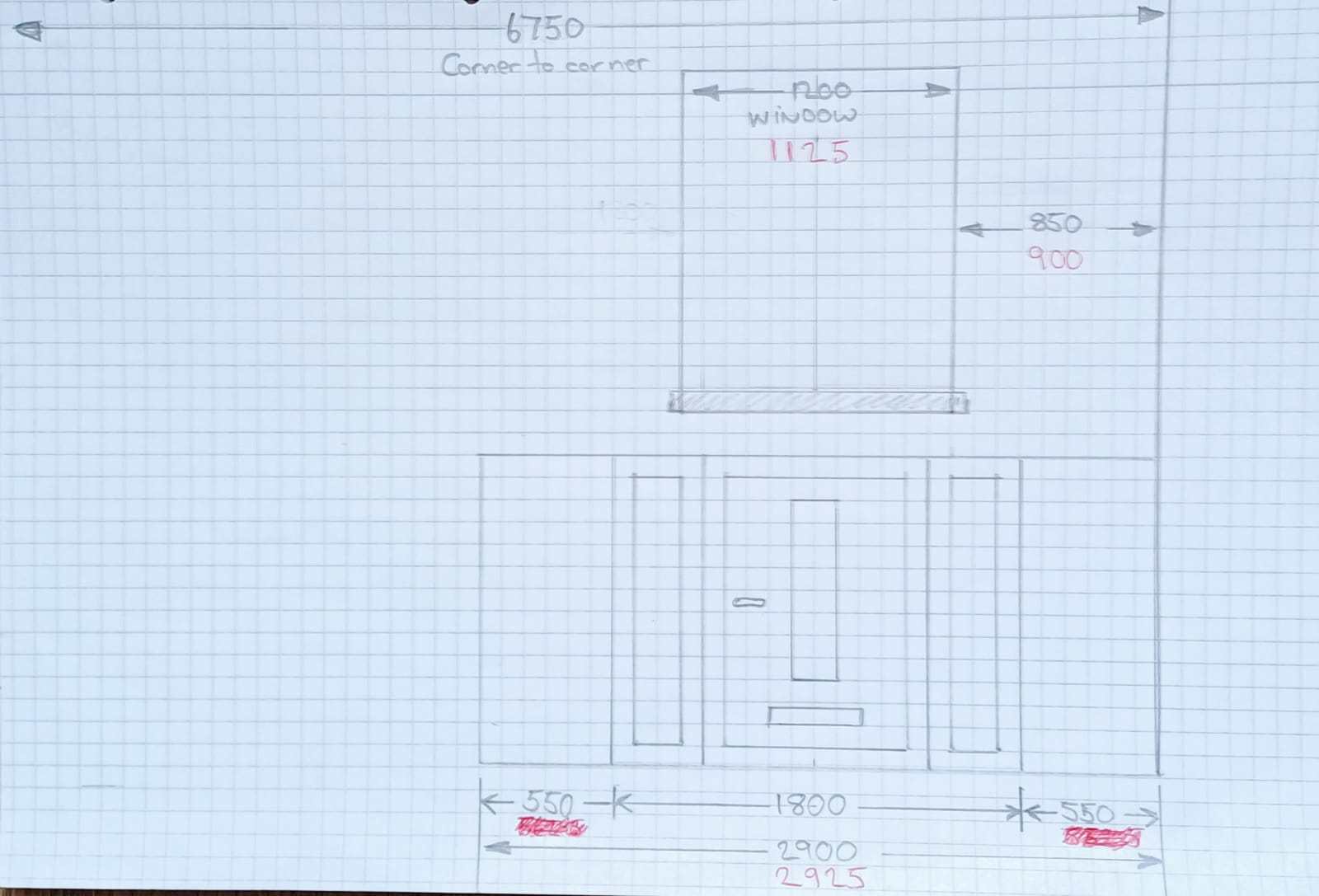

  9. I'll PM you the plans over then it makes more sense. The porch to house UPVC lockable door i wanted to be at least the same width 838mm as the internal doors so it's easy for moving furniture about. 1023 is the dimension I required because once you've deducted 140mm for each side of the frame, plus around 25mm for the door when it's open at 90 degrees, this brings you down to the similar sized opening of 850 ish.

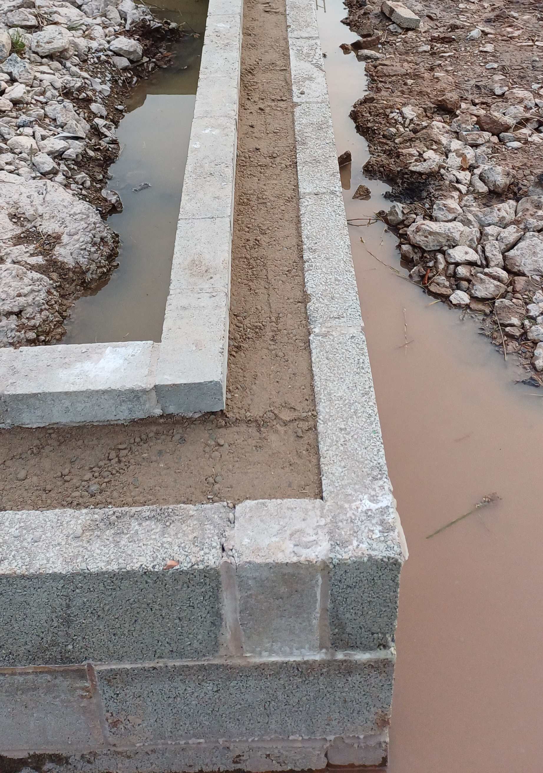

  10. I just noticed this post after I'd replied. The rests all out the ground by 3 courses so I'll check if the 6750 is exactly that, I'm just figuring out how to sort the 2900 to 2025 while i wait for a different builder, lucky i had a sanity check at this stage. For 3 course of block 1.9m long it could easily be took apart and changed. (No trench blocks, or infill) *edit - I think i understand why you've suggested 6740, thinking the right hand side to deduct the end perp for an external corner, but its an internal corner so another bricks there.
  11. @Canski thanks for the advice. There was a few things changed which i didnt like and when questioned it caused an argument, the porch sside was 1800 but they changed it to 1900, part of house was 12,600 but changed to 12,700 with no explanation. Just to clarify, what size is classed as half a brick is it 107 or 102? The header you mentioned is the brick end at 102.5? What width should a doorway to outside be for wheelchair access to match 838 internal doors. Frames are usually 70mm each side.
  12. I've read your comments, looked at the plans today with fresh eyes and found a way to simplify it or correct it if it can be classed as wrong. See attached sketch to get the idea. (Red pen is correction which works better) As mentioned, I designed the outside walls corner to corner to match brick sizes by full/half bricks and kept all of the openings between reveals to the same spacing. The person who done the regs plans changed some things that weren't required & said it's not worth changing back. The porch width should be 2925mm not 2900, this would allow the centred 1st floor window above it, to then sit symmetrical with the correct brick bond to each side of the window if the window width is reduced from 1200mm to 1125. It leaves 900mm for full and half cuts, rather than 850mm which would end up messy. @Dave Jones Yes I sometimes overthink things, but I believe this to be something important that should have been correct on the plans.

  16. I'm not a brickie so need some advice on the following. I've been looking to order some concrete or cast stone window sills for a self build with face brick exterior and come up against an issue due to it requiring exact sizes, +205mm if your selecting stooled sills. Theres a 3 week lead time plus delivery charge so I need to pre order them just before the build starts. All of the external walls are designed to metric sizes for full & half bricks using 215x102.5x65 bricks. I'd like to know whats the minimum sized brick cut you can have at the reveals if it doesn't match brick bond, or how else you go about it? For example, other windows are all metric distances apart from each other or from the corners. I have some openings 1800mm wide which are likely to be 1810mm when it comes to building to include the perps. Some of these can be tweaked a little to suit the bricks, but I have one 1st floor window that needs to be centred above an entrance below, and the size of the opening at 1200mm wide doesn't work for full/half brick cuts unless I start to reduce the window size by 100mm in width. It would be much nicer to get to this point, then measure and decide on site but as mentioned, these need to be ordered together or its expensive delivery. I was looking at stooled sills, but considering slip sills if it makes it easier so that I can measure up and install after the openings are built. I then have the option to have them between the reveals only, or order them a bit longer and manually cut out the horns to let them go past the reveals 50mm each side.
