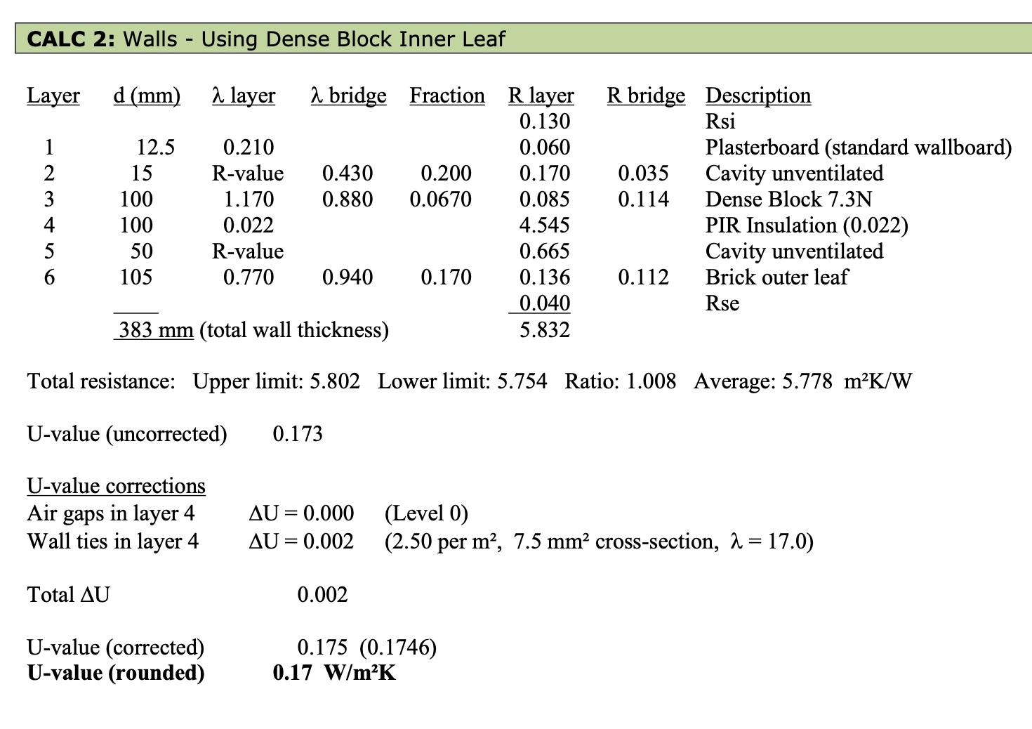

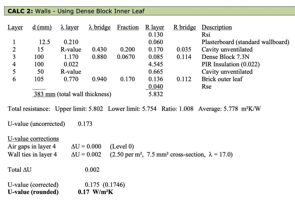

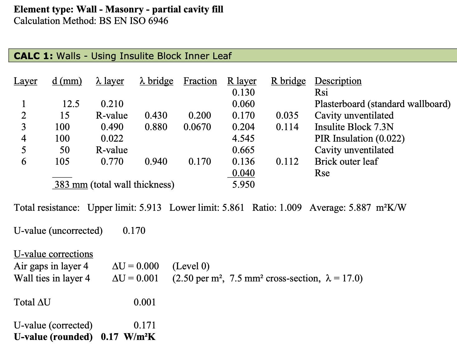

I still thought it would affect the end result because the insulite R layer says 0.204 and the dense is 0.085 so once totalled and then divided the answer couldn't be the same considering as a bare block one is twice as good as the other. Is my example ok to use? 12.5mm plasterboard R 0.060 + 15mm air gap R 0.170 + dense block R 0.085 + 15mm air gap R 0.170 + 12.5mm plasterboard R 0.060 = 0.545 Then U = 1/0.545 = 1.84W/m2K -

If i'm applying your methods correctly, looking at these two further examples attached & using the R values they've used, I'm getting 1.84W/m2K for plasterboard - air gap - dense block - air gap - plasterboard. And for the insulite it's 1.5W/m2K? I'm still baffled how both blocks equate to the same U value when combined with other materials. -

Thanks Temp for clearing this up. So to obtain U, I require the R value of the material? So on it's own, the insulite is is twice as good at preventing heat transfer compared to the dense? I'm not sure if this is of benefit for internal walls or not, I'm only losing heat to another room but the insulites sandwiching 100mm PIR are 0.01W/m2k better between my house and attached unheated garage if thats worth bothering about. Insulite are around 20p per block more expensive. I was going to use them for my inner leaf of the cavity wall until i found out they are just the same as dense when combined with the PIR. -
Can anyone help me with obtaining some material U values to input into the heat engineer software I've been using. I'm not smart enough to complete the calculations required when looking at the formulas 😚. I have attached two data sheets for the blocks I'm going to use. One for a dense block and one for an insulite block. Dense is showing as 1.17W/m2K and the insulite is 0.49W/m2K. I would like to know what the U value would be for each type of block if used on their own for internal ground floor load bearing partition walls with a 12.5mm plasterboard (0.210W/m2K) dabbed onto each side. Am I correct in thinking that as a bare block with no plasterboard, the U value for internal use would just be as per data sheet being 1.17 and 0.49? For a little info. for anyone else - A member of the brick company provided me with some personalised data & an explanation for each when used in a cavity wall situation with PIR and strangely they both equal the same U-value. With both blocks used in the below layout, a U-value of 0.17W/m2K was obtained. 12.5mm plasterboard (0.210W/m2K) - 15mm dab cavity - 100mm block - 100mm PIR (0.22W/m2K) - 50mm air gap - 100mm concrete brick - Total = 383mm Without the cavity air gap having the PIR sandwiched between the blocks made the insulite at 0.18W/m2K and using the dense block was 0.19W/m2K. DENSE Datasheet - WEB July 17.pdf INSULITE Datasheet - WEB July 17 2.pdf
