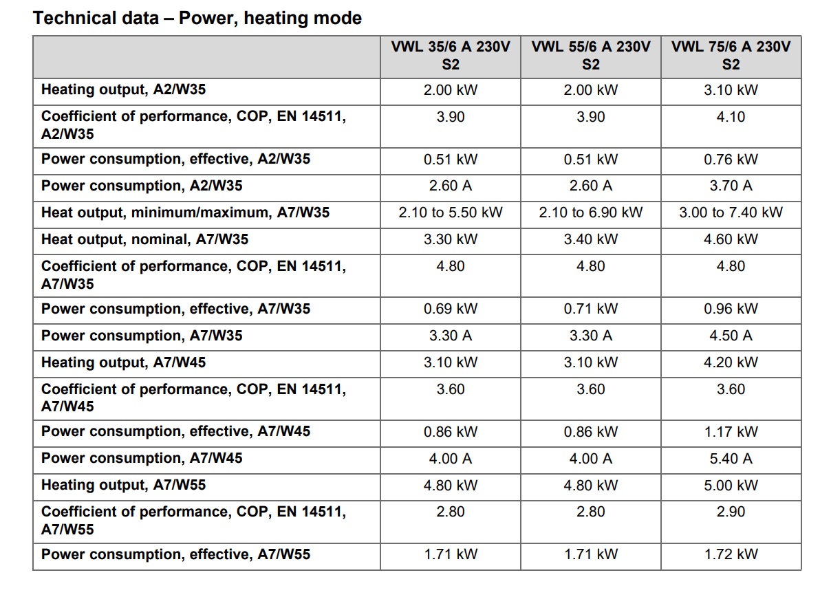

Less load. So if a gas boiler has a maximum output of 19Kw and a minimum of 1.9kw, you know that on a warmer day it will be running closer to 1.9Kw and on a cold day like minus 3, it will be running closer to 8Kw for an average house (Maybe higher pending the heat loss) So I wanted to know does an ASHP rated at 7kw run closer to 7kw when outside is freezing, but on warmer days like +10°C, then ASHP would only run at 3Kw. So drawing 3kw of energy when in use as opposed to 7Kw? I don't have one yet, I've been looking at a Vaillant arotherm plus 5 or 7Kw. @Dan FI've managed to get the arotherm performance date from them but it's not east to understand. If i'm looking at the right part, it says a 5Kw unit heat output min/max = 2.1Kw - 6.9Kw For a 7Kw unit its = 3Kw - 7.4Kw

Just reading over this old post, Is it better with ASHP's to have a unit larger than what required, I thought as long as the unit is more than the heat loss your covered if using priority DHW. Do larger units not have a higher minimum modulation so in the warmer months cycle more than a unit closer to the max heat loss? Why does a 7Kw rated heat pump run higher than 7kw when it's warmer outside and theres less load on it? I though the unit rating was their max output and anything warmer than the outside design temperature would mean they run at less Kw. Example: 7Kw unit with 6kw heat loss at -3c would be running almost full capacity, but at +10c, it might run at something like 2.5Kw and a much lower flow temperature if using weather comp. I must be misunderstanding it all.

Oops, I've posted the same post twice. @JohnMo Whats your house heat loss again, I remember it being low? My understanding is, no short cycling is best, a little bit isn't too big of an issue, but lots of it repeating all day is going to be a problem. I've heard heat pumps dont modulate as well as gas boilers but don't understand enough about them to know if they are affected as badly as gas or worse due to them needing to fire up and build pressure? I'm going to need to try to calculate the flow rate and volume of the system for an idea. I can get all of the pipe lengths for 90% accuracy i think and diameters, can size the radiators but not sure how you know the volume they hold. -

@Chablais All good feedback thanks. Mine will be 88m2 of UFH ground floor at 100 centres and 55mm screed and upstairs 125m2 8 radiators including the towel rail. Looking to fit 2 mixed units to control a curve for each floor. Heat loss is 6Kw without MVHR, around 4kw with, but need to fine tune this figure & update a few things. 100 fires sounds a lot, how long does the building retain the heat before it needs to fire up once its reached 21C with such a low heat loss? Have you tried lowering the curve, I thought the idea of weather comp was to have it on all the time but with a night set set back 3 degrees less. Do you think the heat loss is too low for the boiler then? I'm not sure if a heat pumps any better in these situations or equally as bad? My knowledge of ASHP's is very basic. What your outdoor design temp in Cumbria? -
Just looking at high efficiency low modulation gas boilers vs modern ASHP for a self build with around 4kw heat loss with MVHR installed running weather comp. Two in mind would be a Viessmann 200-W system boiler vs Vaillant Arotherm plus 7Kw. Before ASHP's became popular in the UK, how did we manage/reduce short cycling of gas boilers in low heat loss homes? A Viessmann will modulate down to 1900W. This means that the gas boiler will be at its minimum modulation & starting to short cycle for anything over 9°C outdoors while maintaining a 21°C indoor temperature. How big of an issue is short cycling really? Are ASHP's better at minimising short cycling issues or more suited than gas boilers? Taking away green credentials, ASHP doesn't save anything. Todays prices the heat pump is £125 per year cheaper to run for me, but the annual service is up to 2 to 3x more than a gas boiler. The unit costs more possibly even after a grant.
