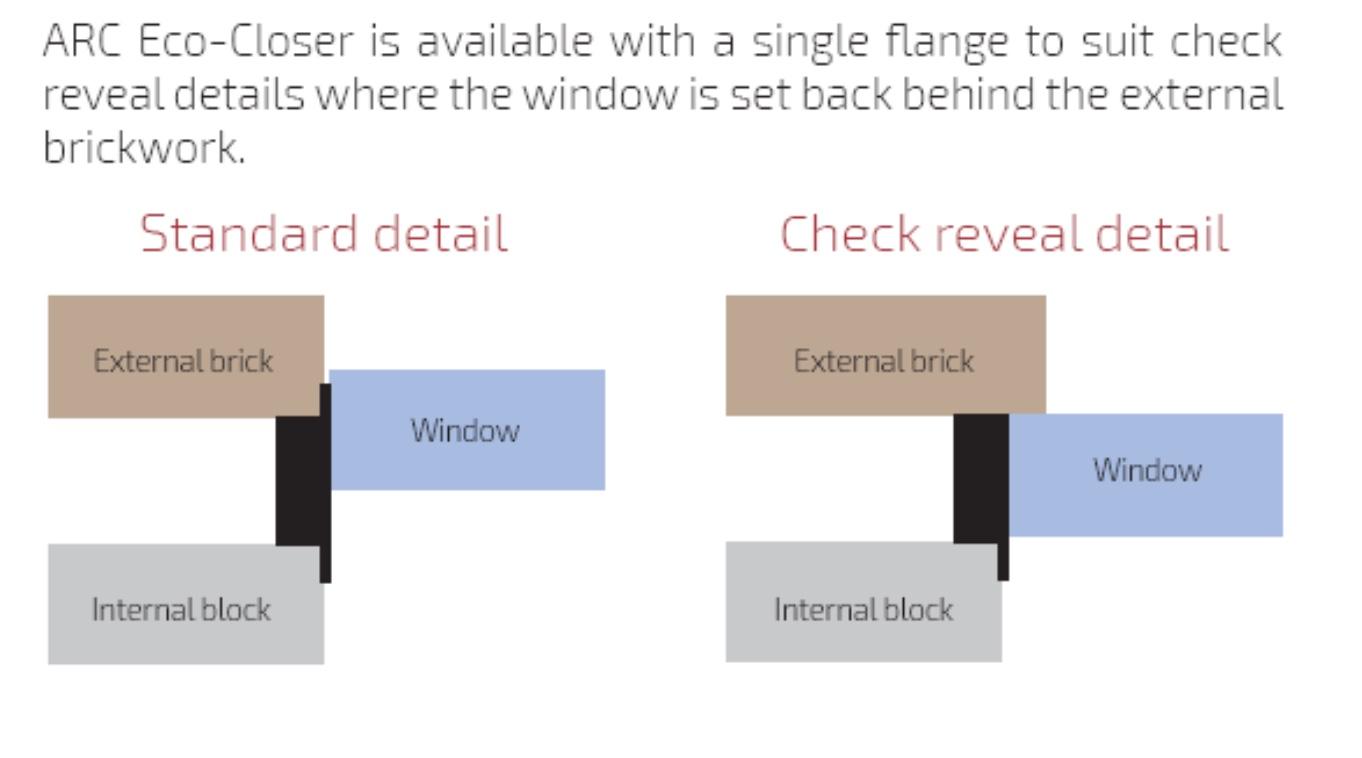

The regs say that building regulation part B requires you to have fire rated cavity closers. Is this something new as some of you have used your own methods, ie: PIR jammed between or premade plastic closers? -

I'll try & get a sample of some. I was just curious to how long it took to expand once took off the roll and applied to the window frame, and whether or not you apply before or after the fit. A youtube video shown it being fit afterwards but looked fiddly. Is the roll useless once opened? -

I see what you mean now after looking back, easier method with tapered reveals. Is that a standard window detail or something different (Looks like 2 squares)? I'd not heard of compreband expanding seal adhesive foam. I thought it was just the standard stick on foam strip. Whats the working time on the foam expanding? Did you fit it prior to fitting the frames or afterwards. I was thinking prior would make it too hard to fit air bags between frame and brick work when installing. I just meant my inner and outer skin will be the same width apart, square reveals not chamfered back like yours. the checked reveal shown here does look a good idea but i'm unsure what the frame bears down onto when not using a precast sill as it would just be hovering over the cavity. My UPVC frames were just going to rest partially on to the outer leaf. (No stone sills) I agree with you on this, but with B.C being involved and warranty inspections, I wouldn't get away with a 50mm angle, they even like DPC turned up ends or on the trays to prevent water run off to the sides. As you say, they will just collect all mortar and weep holes could be blocked from the inside. Even the best bricky can't prevent it dropped down the inner. -

Can you not just seal the board to the frame same as you would using the stop bead. What advantages does the stop bead offer if it's getting a bead of sealant anyway. -

@joe90Where did you mean to use the stop bead, the internal or external reveals and would you go both sides and the top? I'm guessing you mean the outside if your window straps fasten to the outer skin so as they'll of needed covered. I'm on the West coast lake district so we do get really battered in winter I've not seen anyone use anything other than timber frame or partial fill cavity @saveasteading i've looked at everything and can't see any noted difference other than radon usually being red or green. Both are 1200 gauge and 300mu. I'm also right on the edge of a red radon zone by map, but a report for some builds around mine the report said no radon present. Not sure how they've checked. Can't imagine any houses that already built checking. @dpmiller Seems like some still use recycled. https://www.plastics-express.co.uk/dpm-1200-gauge -

After a review of my plans and discussion with the person completing them, I wanted to check a couple of areas that I think will cause cold bridging. The construction is cavity wall, 100mm dense block inner leaf, 150mm partial fill cavity with 100mm PIR, and a mixture of face brick outer leaf and dense block with composite cladding screening. Weather zone is severe 4 for NW England so blown bead isn't an option. House will be parged, internal insulation and MVHR. 1. The architect has detailed for a a returning block on any opening reveals with a DPC separating the outer from the inner. Would this not be a huge cold bridging area, if so how do i get around it and where would the UPVC windows be positioned for a solid fixing? What are my best options to minimise cold bridging but to not over complicate the window fixing. I've seen someone suggest only a partial 75mm block/brick return of the 150mm cavity then use a push 75mm closer for the remaining part. This adds a thermal break and means the return blocks work out for 175 block & a standard brick above course. or just go full 150mm closer? 2. How do you extend the cavity wall insulation down to the bottom of the floor slab level when using a radon barrier which bridges the cavity. See image detail.
