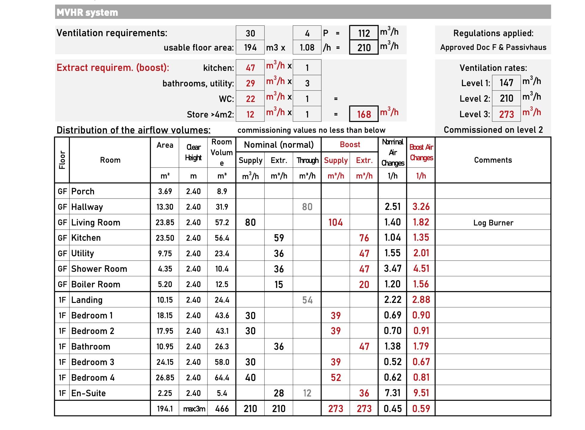

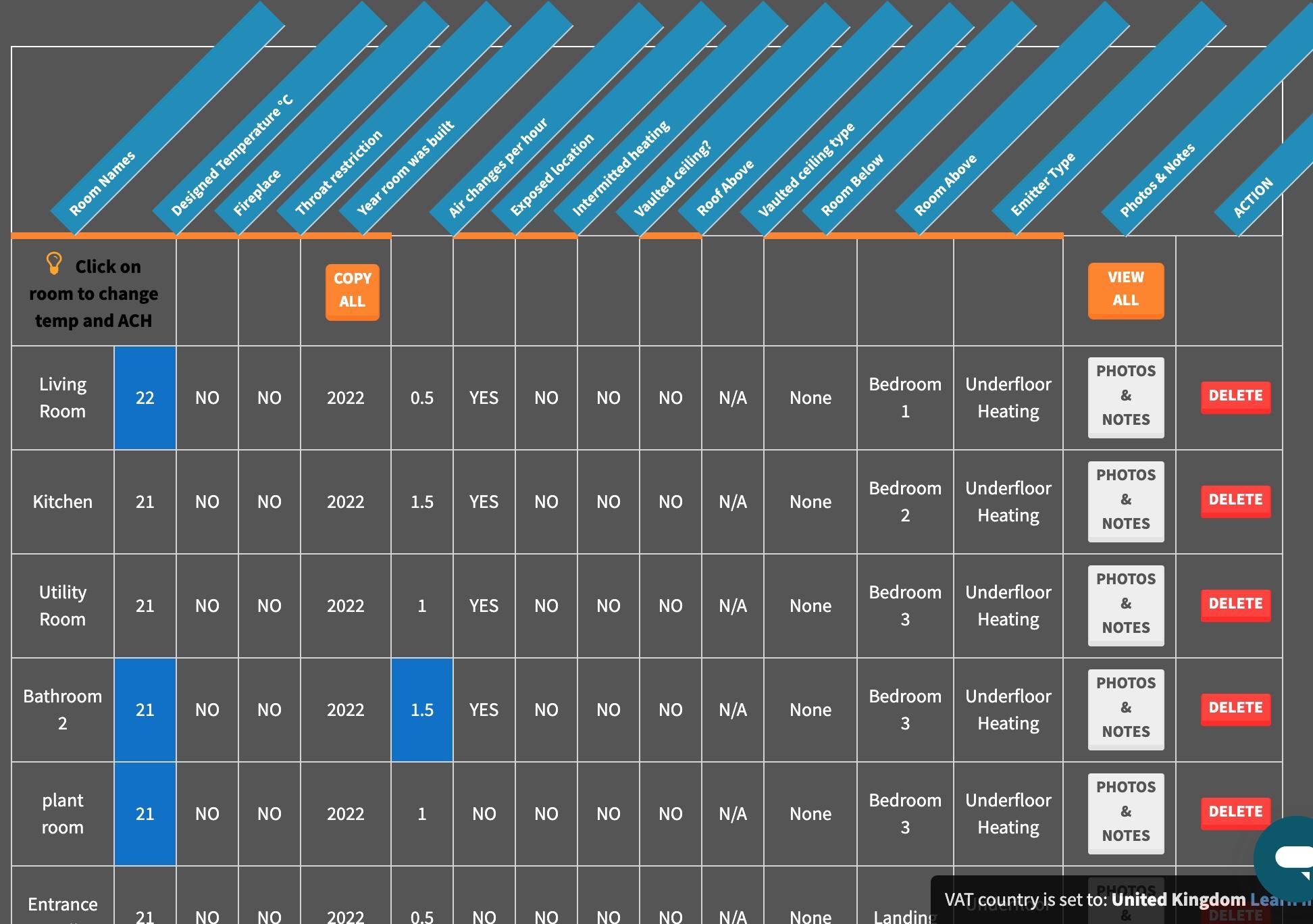

Thanks John, I think what has confused me was standard air changes for a none MVHR house vs a house with MVHR. Although airtight, I wasn't sure if having MVHR increases or decreases ACH. I was thinking it increases the ACH because theres a fan controlling it which will always be more than natural ventilation? As mentioned before, wondering if the heat loss software, although we may change the ACH for a house with MVHR, can the software detect how much heat isn't being recovered at this higher rate or is it just detecting a higher heat loss due to more ACH. I've just found this (See attached) in an online manual for the software. So I've now selected MVHR at the default setting and all of the ACH figures per room have reduced, Is this suggesting I change the figure to 90 if the figure was 90% efficient? It seems a bit dramatic. Without MVHR heat loss is 6.1kw With default MVHR at 50 the heat loss is 4.5kw With setting changed to 90 the heat loss would be 3.24. MVHR doesn't save that much energy so I must be doing something wrong.
It was 20 inside and the recovered heat was 19. Can't remember what they said the outdoor temperature was at the time. I do think 90% efficiency isn't uncommon though. Do these figures mean your MVHR at 0.3 ACH is running at twice the capacity expected or half as good? I've not looked researched anything to do with ACH & how it's all calculated at this point only design, functions and performance.
I've spoke to the MVHR company today & they've confirmed with some cheaper units it's not always possible to know exactly whats being recovered, but with the likes of the Zehnder units with sensor monitoring, they have plenty of data to show some properties they've installed at having recovered heat at 1°C less than the indoor temperature at 20c. Is this data on a website for set areas anywhere or is it your own data? Interested for my own, I'm sure it's 9°C local. Interesting figures, good to see. Theres no doubt MVHR is of benefit, it's just making sure my calculations will reflect this. I'll check out the sheet Johnmo refers to as a comparison. In layman's, is this something we should consider as a factor or is it minimal and not so noticeable?

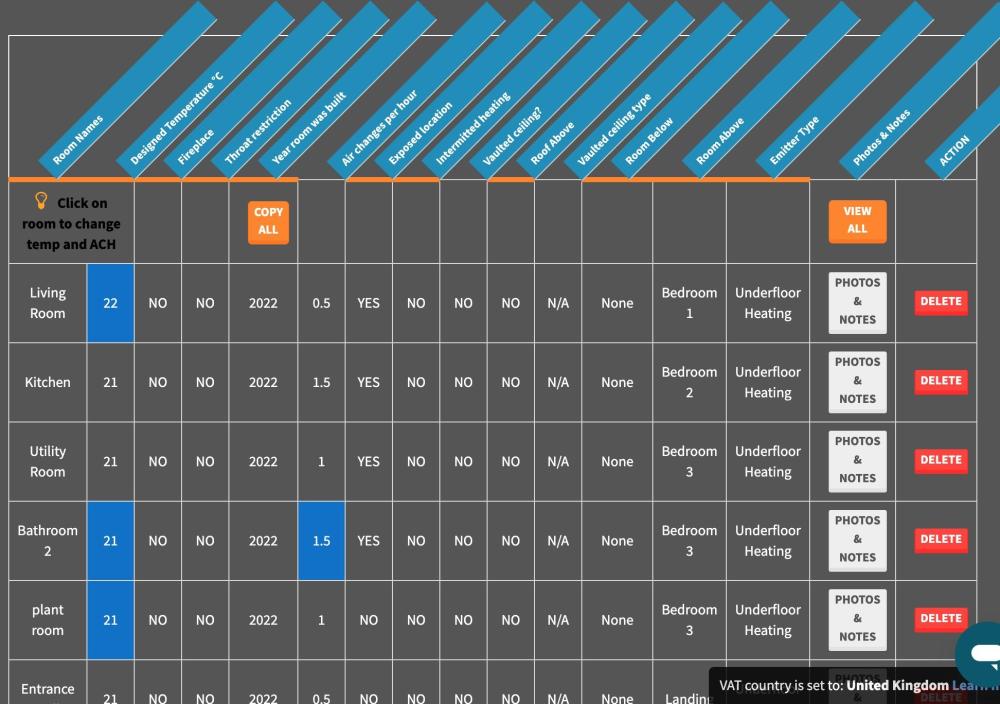

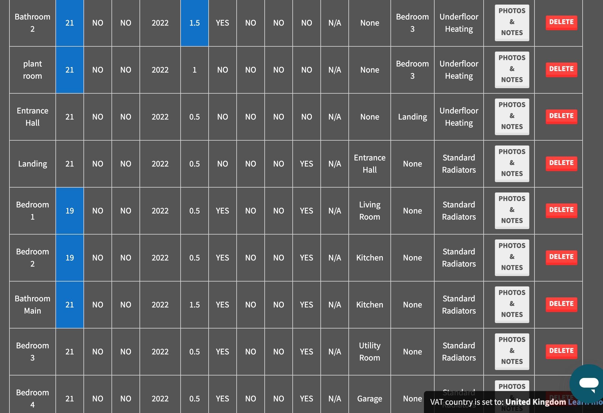

I will take a look at them John, always good to compare because sizing emitters can only be done once with UFH. I just imagined the sheet would require me doing a lot of long hand calculations with formulas which isn't my forte. Some experienced heat engineers I've been speaking to had said about using the heat eng. software as it was good, although they can do it via others means it would provide me with good results and use it themselves. I'm not sure if they have considered MVHR before though. My concern is how the software correlates with heat losses vs ach & heat recovery. I think I'm with Joe on this one to a degree (No pun intended). The chilled wind could act as a wicking effect at drawing the heat away from the dwelling, especially if wet mortar between face bricks, I may be wrong because the inner and outer skins are independent, but we do know that poorly fitted PIR in a cavity can have the same effect as a radiator in reverse. Air passes between the gaps from poor install and draws heat away from the inner cavity wall. Effectively no wind should be able to get in other than tiny weep hole vents but its possibly just from the difference of temperatures.

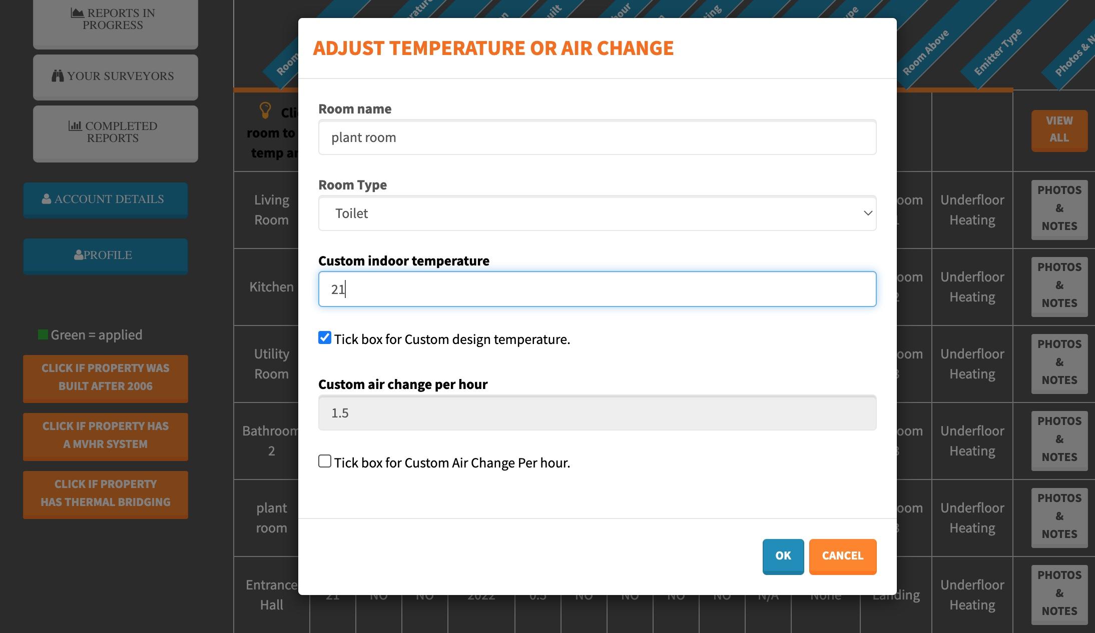

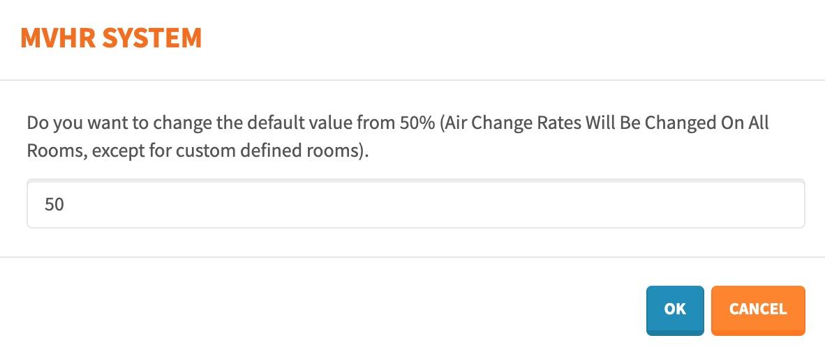

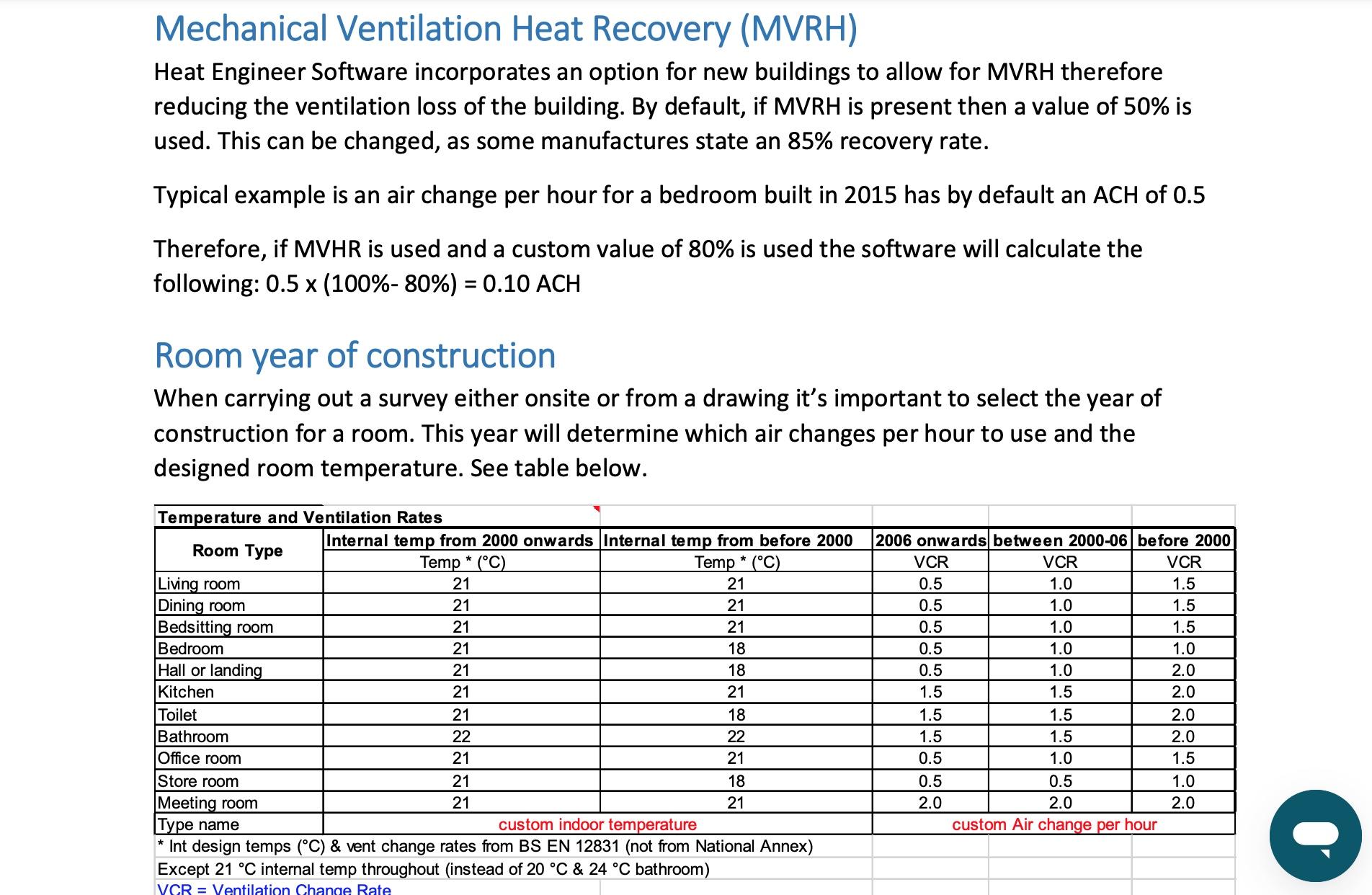

@joth This is my concern, that the software only detects a change of defaults resulting in more air exchanges per hour so it estimates that i require more heat than needed because it doesn't factor in the heat recovery percentage. I will look into this in more detail because a tutorial video i recall a mention of 50% default for MVHR but an option to increase the %. Is PHPP the passive house detailed calculation, do you have a passive house? I've included some attachments, the MVHR report is just one of the 3 companies who provided me with some details & a quote.
Of each room value? Why that figure? I'm hoping it will be answered at a later date once i pay for a detailed design with the MVHR company who can advise me what to add but MVHR won't know much about heat loss calculations or care so I need to make sure I can input the correct data to get my results accurate. As mentioned, a whole house of adding insulated plasterboard made very little difference but changing some parallel rooms lowest temperatures from 18°C to 20°C to match the 21°C design temperature shaved off 0.4kw total.
I think MVHR is a good idea, and I'm happy with the heat loss calculation although would like to improve it further. What I don't know how to do, is get the most accurate results from the heat loss software when installing MVHR as this could/will affect the air changes beyond their defaults. This can through the calculation out massively & I could end up under or over sizing my heat emitters which defeats the object. I'm aiming to get them as accurate as i can, so when fitted with weather comp the house is sized perfectly & feels good. Question is, what do i set the ach to in the software to reflect the MVHR install?
A good few replies from a late night post. I'll answer below. I believe MVHR to be good and having to have an air tightness test on new builds means MVHR or trickle vents, ones cheap, one isn't, but i hate trickle vents with a passion. So going down the MVHR route, I'm fitting a quality unit that can recover up to 94%. I have a good draft design that i will self install and have narrowed it down to two really good companies to complete the design, install & commission after speaking to a few of them. (Will select once overall quotes are in for all trades). So I've decided to make sure I apply a high level of air tightness & insulation detail myself after researching a lot on here & speaking to people. Heat engineer app followed by sending the report to the desk top version to fine tune everything. It will warm the incoming but would it not also be dumping some of the warm air outdoors continuously, 20°C extracted at 90% recovery would mean the supply air is 18°C? I sometime see quotes saying MVHR can lower your heating bills by 20%. In winter I probably wouldn't open my windows & never use trickle vents so it would be less than MVHR. I'd crack them open on catch in bedrooms for an hour or so in the morning or when cooking. It's probably not correct what i done, i was just trying it based on the attached screen shot, the heat loss software defaults all ACH to 0.5, 1.5 or 2 for various room types. Bad choice of words from me sorry, shouldn't have said standard. My calculations are now completed & showing as whole house loss of 6.11Kw based on all of my materials to be used with correct U-Values. This is 10% more than it would be because I've ticked the exposed area option being 125m elevated, 2 miles from the West coast in a windy area. What I'm surprised at, is by changing my 0.17W/m2K cavity wall insulation to a different U-Value to simulate how adding some internal insulated plasterboard at different thicknesses would improve things, it made hardly any difference at all and they cost 3x more than a standard plasterboard. Adding 37.5mm to the inner skin gives a value of 0.14W/m2K, adding 52.5mm gives a value of 0.13W/m2K. My 6.11Kw house heat loss only improves to 5.97kw and 5.92. It seems a waste of money adding the insulated board to the inner walls unless I've done something wrong?
