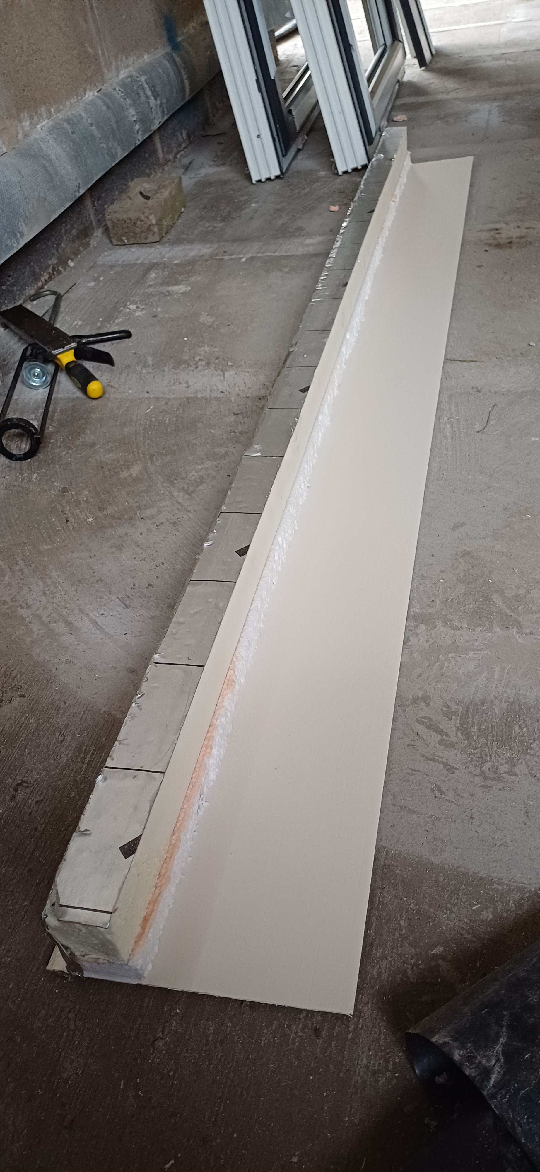

  10. If i was to do it again, I'd still modify the closer, but I'd keep the pir flush with the inner block reveal. I set my pir back by the thickness of the closer, 25mm so that the full 150mm closer wdth would fit in purely because i thought all of the eps was bonded to it, and it may be with other brands, but these aren't and the eps was a friction fit into the c shaped plasic at the end which goes against the outside wall. I'd keep the pir flush with the inner reveal but have a checked reveal set back 25mm then i could add a 37.5mm insulated plasterboard to the reveal without taking up window frame width. Maybe using plasterboard pu foam is better to adhere the board to the reveal but I've had no issues with dab before and agree your screeded finish will be better. Ill try a floor tile comb.

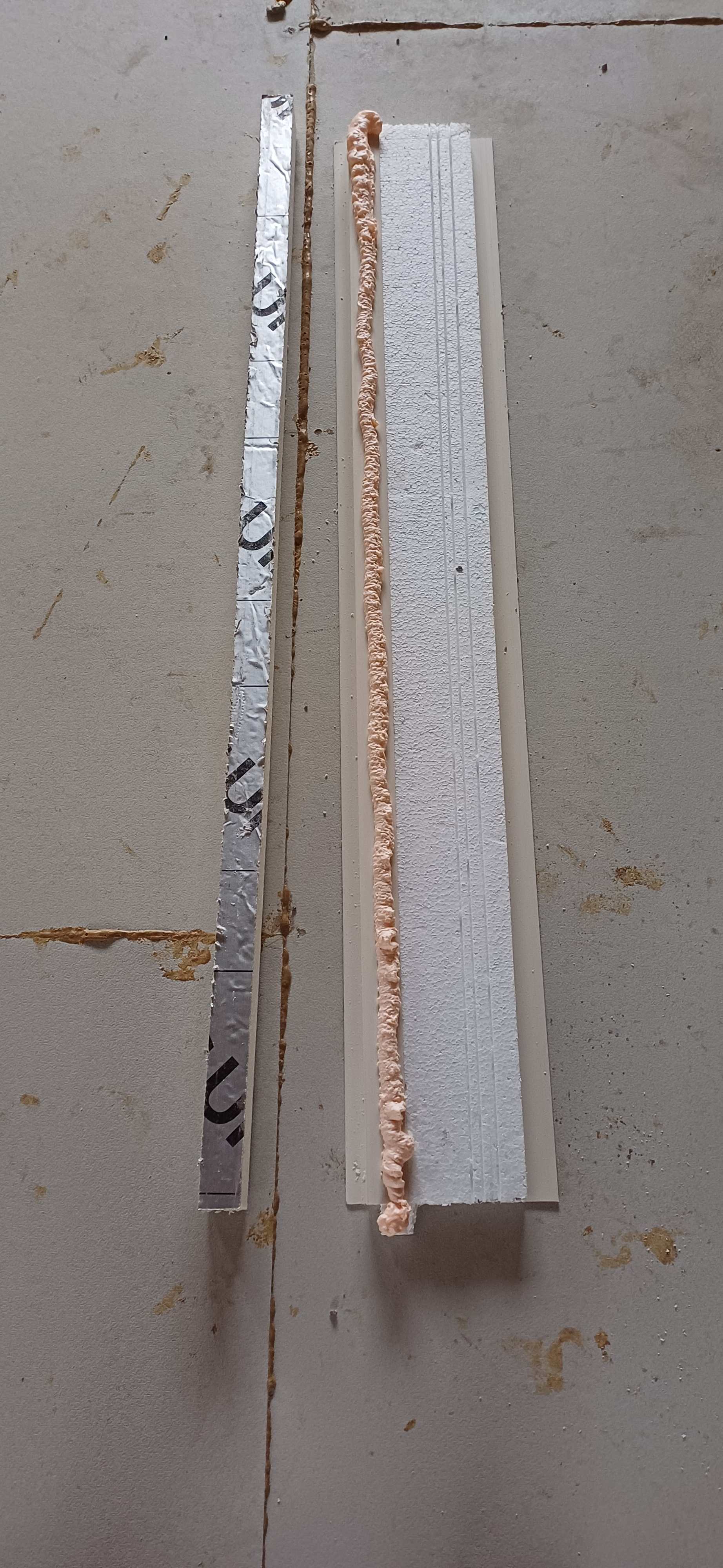

  11. Hi Mike, wet skimming the block walls and not dot and dabbing boards on would give a good air tight seal, but the reveals have been closed off with plastic cavity closers. They're pretty flimsy 2mm plastic which overlaps the inner and outer masonry and a 25mm thick piece of eps is attached to it which can be cut to suit the cavity width. Ive chose to modify the closers to be thicker by bonding pir and foil taping it, then setting my windows back 25mm to minimise cold bridging. The closers on their own offer very little insulation to the reveals being thin eps. I could have still improved these further, but you often learn things after its too late. If wet skimming walls you'd sill need something over the smooth plastic closers to skim onto. Some of the tapes claim to be skimmable. You need tape between the window to wall to maintain air tightness. Ceiling barrier to walls taped too.

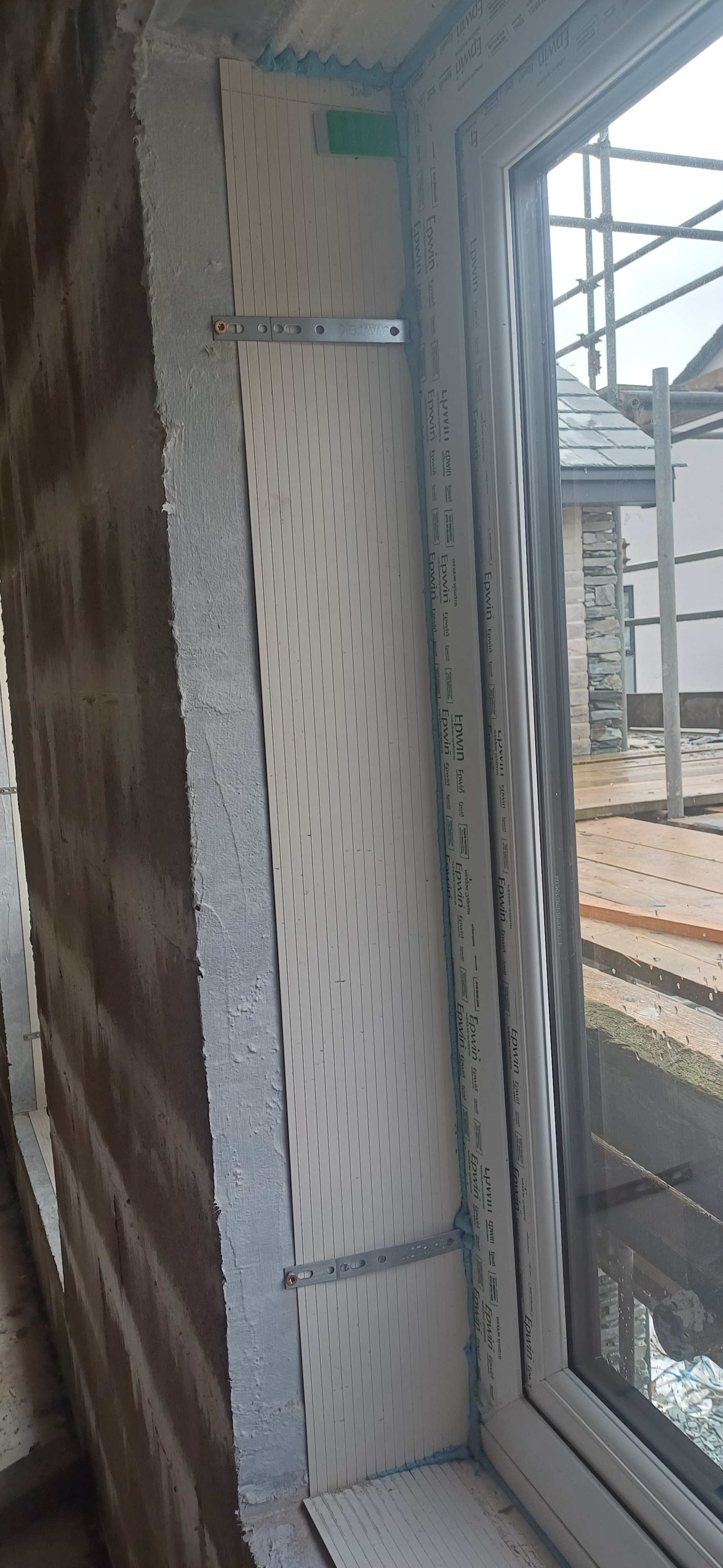

  13. Hi Nick, when you say multiple runs of 60mm tape, do you mean all 4 sides of the window in one continuous swoop, then another over lapping the tape each time until you reach the desired width?. Or do you go 360 on the inside window edge and then 360 on the closer outer edge nearest to the room side? First option wod use a lot of tape. I got the flexi adhesive parge coat on yesterday, just scraped it hard to the block and it went on nicely. Was the thank me later to this aimed at longevity or ease of spread compared to sand and cement? I'm considering doing the inner walls the same now with multifinish before i spray them with airtight membrane (dont think my shoulder will thank me later), Could be over kill but self builders often aim high. Do you have a preference for tape brands you use or they all much alike?
  14. @Nickfromwales I'll give the flexi adhesive a go this weekend, only needs to be a few mm thick then so should dry quick. Get all the closers cut ready, and fit them with a bit of hybrid polymer and if needed some twist nails. I was looking at some soudal tape 200mm, they do two types. One has a self adhesive window strip side, then a peel off butyl side on the masonry edge. The extra tape is the same, but then the full area between the two strips is also a peel off adhesive strip. Not ure if this will make it easier or harder to apply for a full 4 sided opening in one go. I need a decent upstairs ceiling membrane too. I was asvused to use ampatex db90 with siga fentrim 50/85 (£85 quid is steep) because its prefolded and saves tons of tkme. Do the full upstairs before the stud walls go up so its only the perimeter edge to tape up.

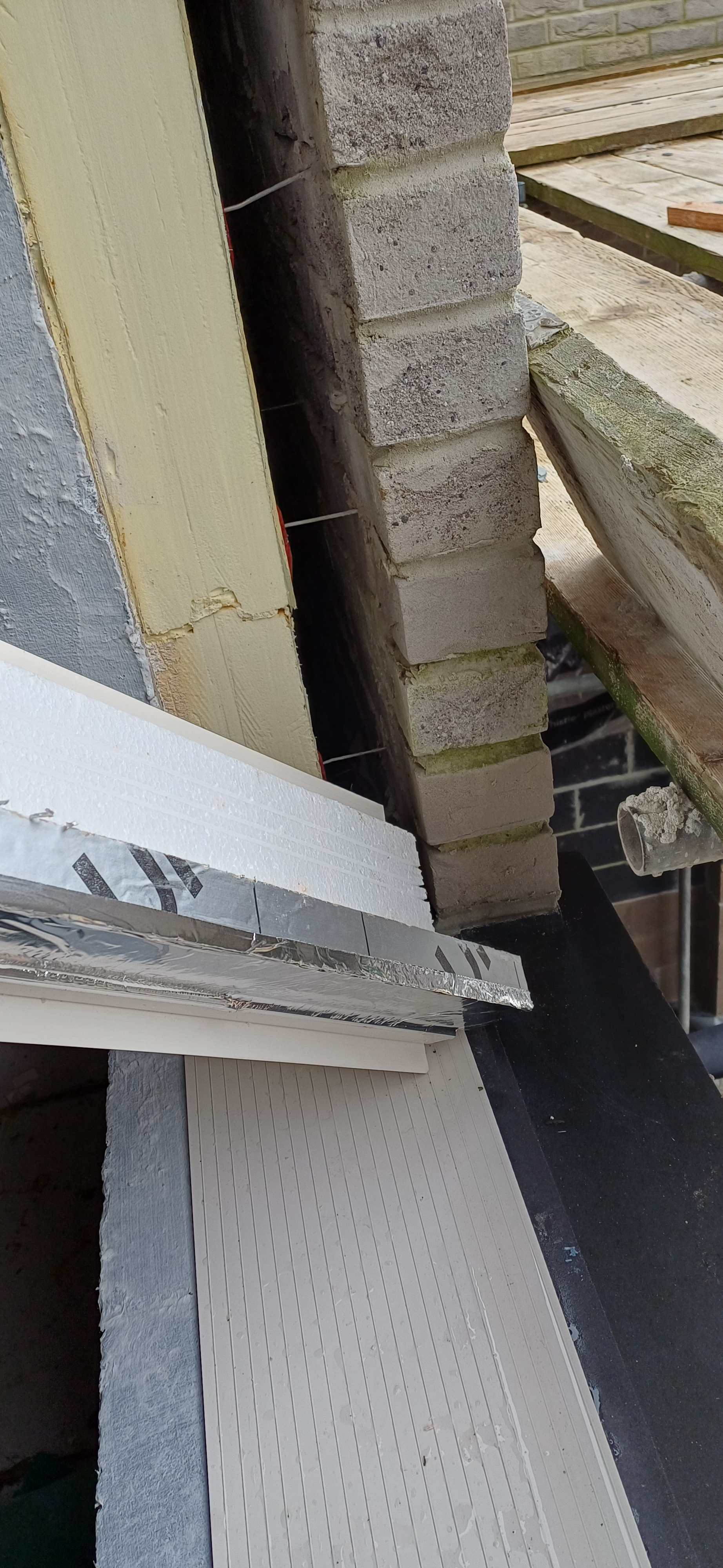

  18. Hi, I'll reply to you both. Correct me if theres a better order to do this before or after the windows are fitted next week. I was thinking i need to do some upfront work. See picture for my window reveal. Its 100mm dense block inner, 100mm pir set back by the depth of the plastic cavity closer 25mm. 50mm air gap, 100mm facing brick. I'm going to fit the cavity closers this weekend before the windows go in. Im modifying them and adding 50mm thick pir to make them 75mm total, the extra bit wont bridge the cavity, but will overlap the set back window frame. I'm using soundal soudatight brush on around the reveals, the rest of the walls will later be sprayed after chases are completed Cant get anyone to wet plaster so dot and dab boards. I planned to paint the reveals this weekend to seal up pores in the blocks, then add the cavity closers over lapping, then tape closers to blocks, then windows fitted with the straps drilled into the inner block work, and then touch up over the brackets and screws with tape or more membrane. That way any air tight tapes are adhering to painted blockwork and will adhere much better than to bae dusty blockwork. I thought if i fit closers, then windows in, then try to paint over it all and tape closers to blocks it will get messy. It sounds like i need to parge coat the reveals with sand a cement asap, then add soudal liquid membrane paint, then cavity closers, then windows fitted, then tape over? @Nickfromwales
  19. Which airtight tape is best for window reveal cavity closers to blockwork? I need to start buying air tight tape for various areas of the build, but first up, i need to order some asap to seal the plastic cavity closers to the internal block work reveals before the windows get fitted next week. I've just realised I'm going to need to tape one side of the closer before the frames go in. I'm having the frames set back into the cavity by 25mm, so window reveal fixing straps are being used, these will over lap the closer, meaning taping later wont make a decent seal. Siga fentrim was suggested for some areas but its very expensive. Just to add, all block work reveals are painted in airtight paint and closers will be modified to be thicker.

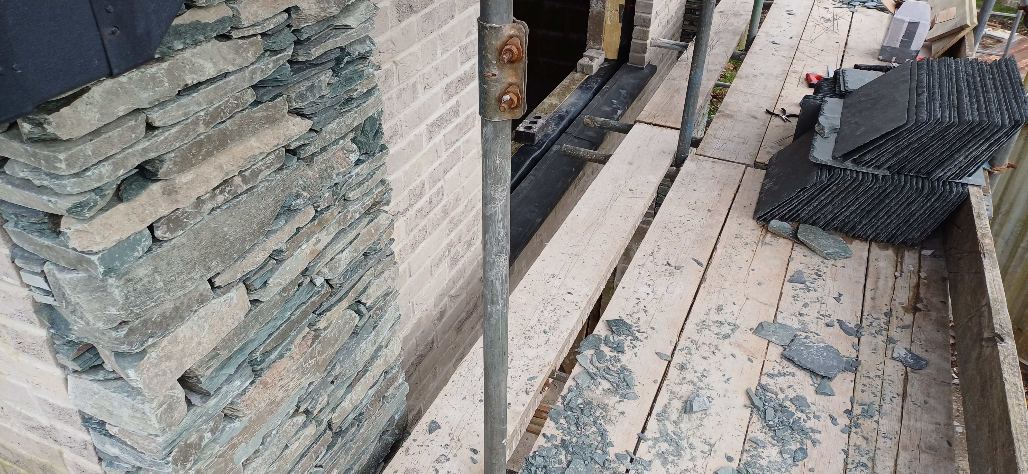

  22. I'm having a slate roof installed on a self build, 400 centres, and I want to know if copper clout nails should be used or aluminum? The slates are 250 x 500mm 7 to 9mm thick. 38mm clouts required and 30mm for the eaves course. Aluminum 3.35mm or the roofer says if using copper I could use 2.65mm. I want the roof to last 40 yrs+ Some online reading says aluminum may fail between 20 and 30 years is this true? We're 3 miles inland off the West coast, there's a few houses around but we do get a bit of wind in winter.
