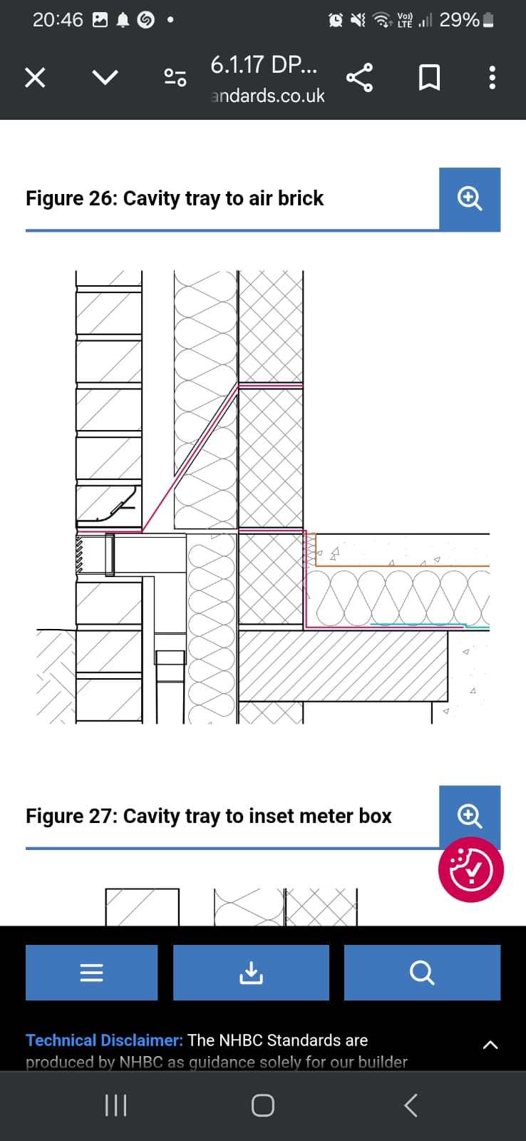

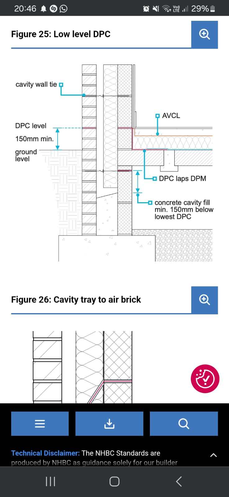

@Brickie So it is recommended that I include this stepped DPC around the house perimeter from the outer leaf DPC level (on top of telescopic vent) which is 150mm above ground level, to 225mm above inside finished floor level? The same as figure 26 NHBC image I attached on an earlier post? But rather than slice through the PIR at an angle, just pass it between the PIR joint. This would produce a steeper angle on the DPC roll than splicing through the PIR, but still direct wind driven rain back out through the weeps and prevent pooling in the bottom of the cavity? -

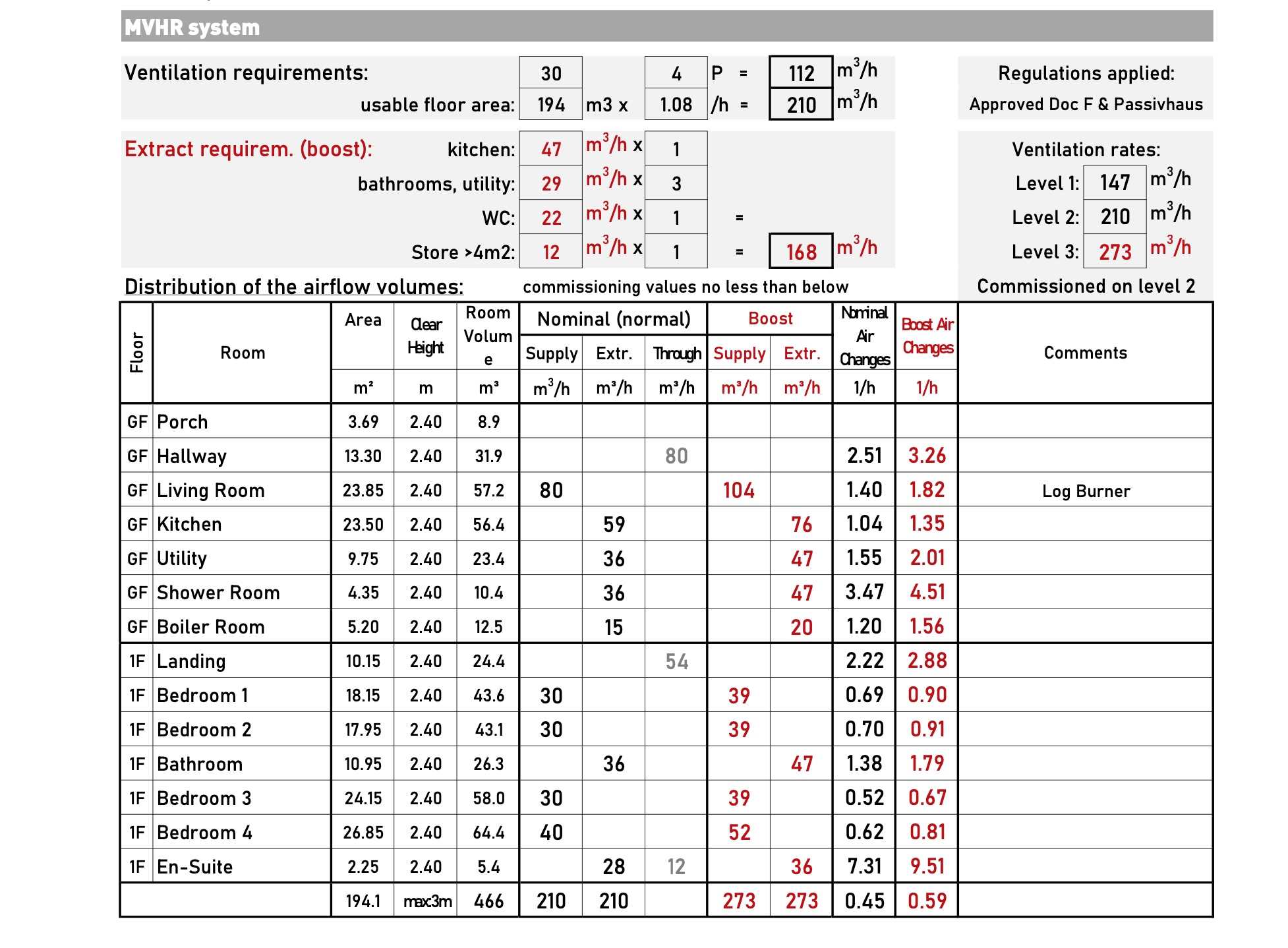

Out otf interest, wha construction was your build to achieve 1.5? I'm aware that the building airtightness and MVHR flow rates are separate things, and them flow rates also have to factor in around 90% of the ventilation will have the heat recovered from it. I've attached an MVHR pre design estimate from one company some time ago showing flow rates, it does have a mistake on it for at least one room. If it's so negligible, I'm happy to ignore that part. MVHR is excluded from the heat loss survey. But the airtightness of the building which won't be known until it's built and tested, will make a big difference in reducing the total heat loss if the correct ACH are input, rather than the softwares default ACH used which assumes the worst case air tightness result of 10. Sizing a heat pump should be based on an accurate heat loss survey otherwise you face short cycling issues in the shoulder months around 12 to 15C outdoors. The 5 KW heat pump can modulate down lower, Ive had mixed answers of 1.2 and 1.5Kw. 7Kw model is around 1.7Kw

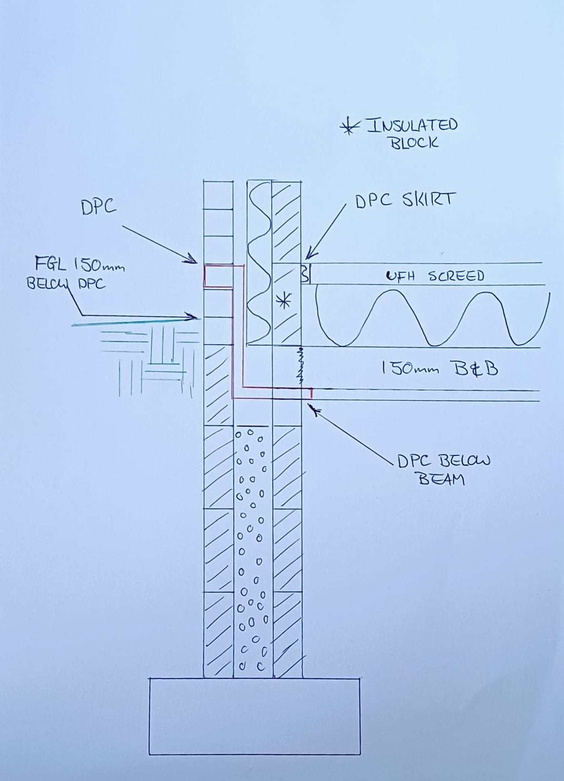

Are you running the 600 dpc the full perimeter, including where beams run parallel with the wall and the cut block end beds on to the slips? The photo looks like you do. I just can't see any overlap at the corners, it looks like one sheet which it can't be. I'm doing a similar detail to this and bringing the cavity insulation down to the top of the B&B where my ties will start so I wont be able to use the 600 dpc wrap. Does the lean infill need angled to the outside or optional?
