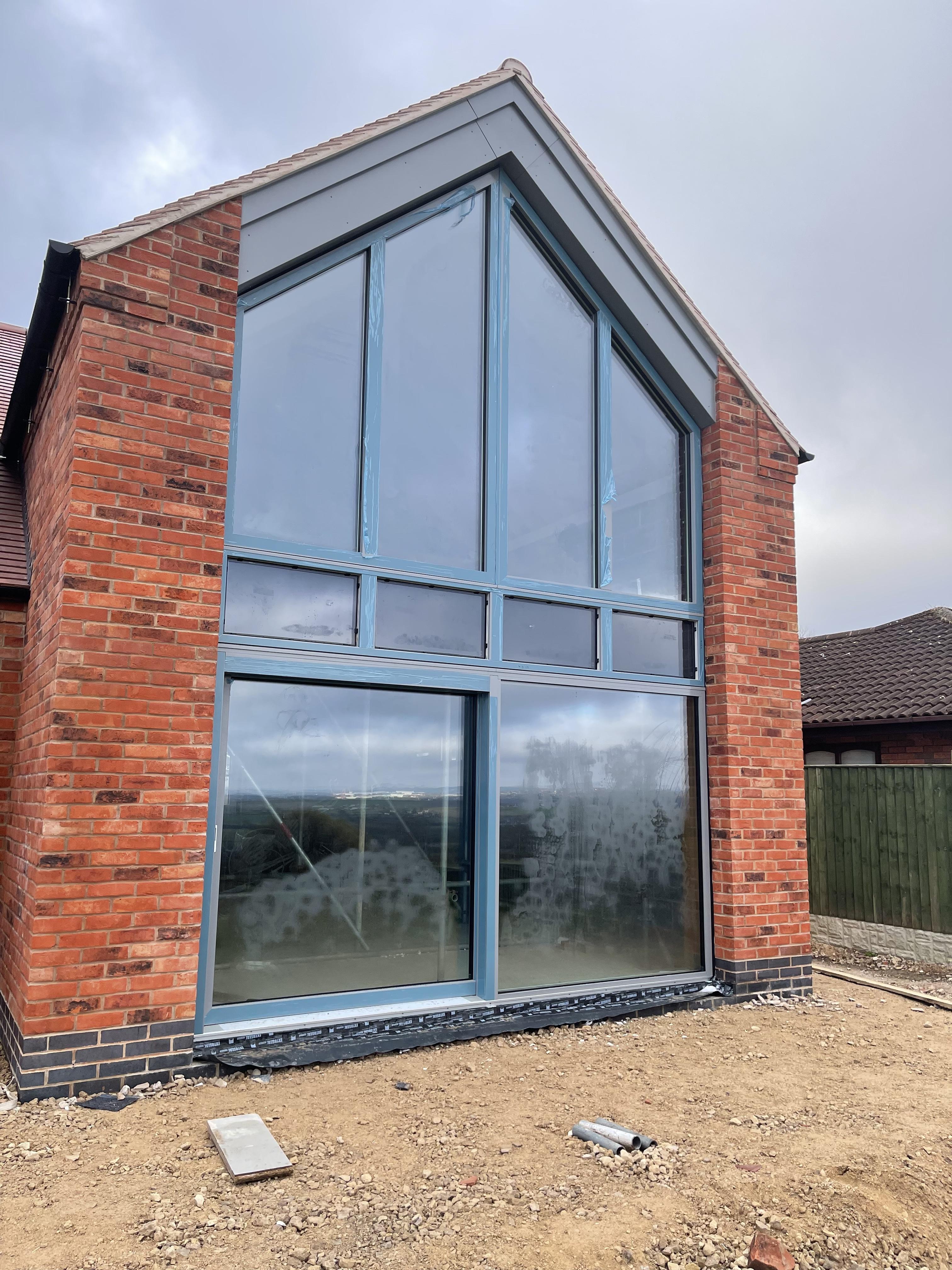

Go triple on them all and solar control on the triple where required, look at other systems if Nordan cannot do what you need. I know Heb Homes use Nordan all the time but there's others that can easily achieve what appears to be what you want.
The NTech sliding door sash weight limit is 135Kg, that's not that heavy to be honest. I'd pretty much agree with Heb Homes on the weight limit. A lot of systems struggle with weight and suppliers will come up with alternative design options compromising on the overall design. It's simply system limitations. I'd agree with Solar control, it's a lot of glass but I'd question their logic and difference on price. It also depends on whether Nordan / Heb are talking glass percentage difference or overall cost difference. I'd say Heb are talking overall, Nordan talking cost difference between double and triple (glass unit only).
