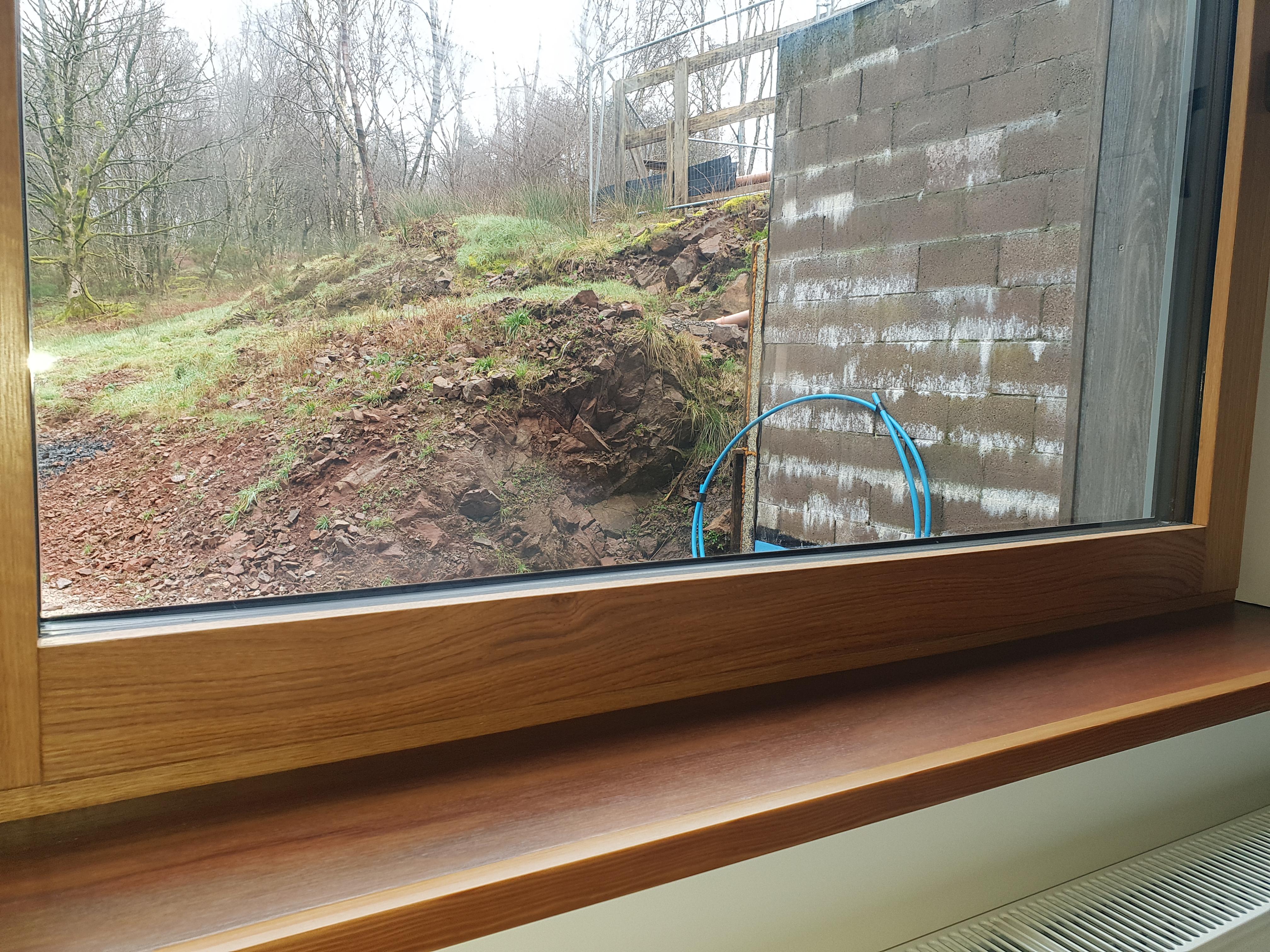

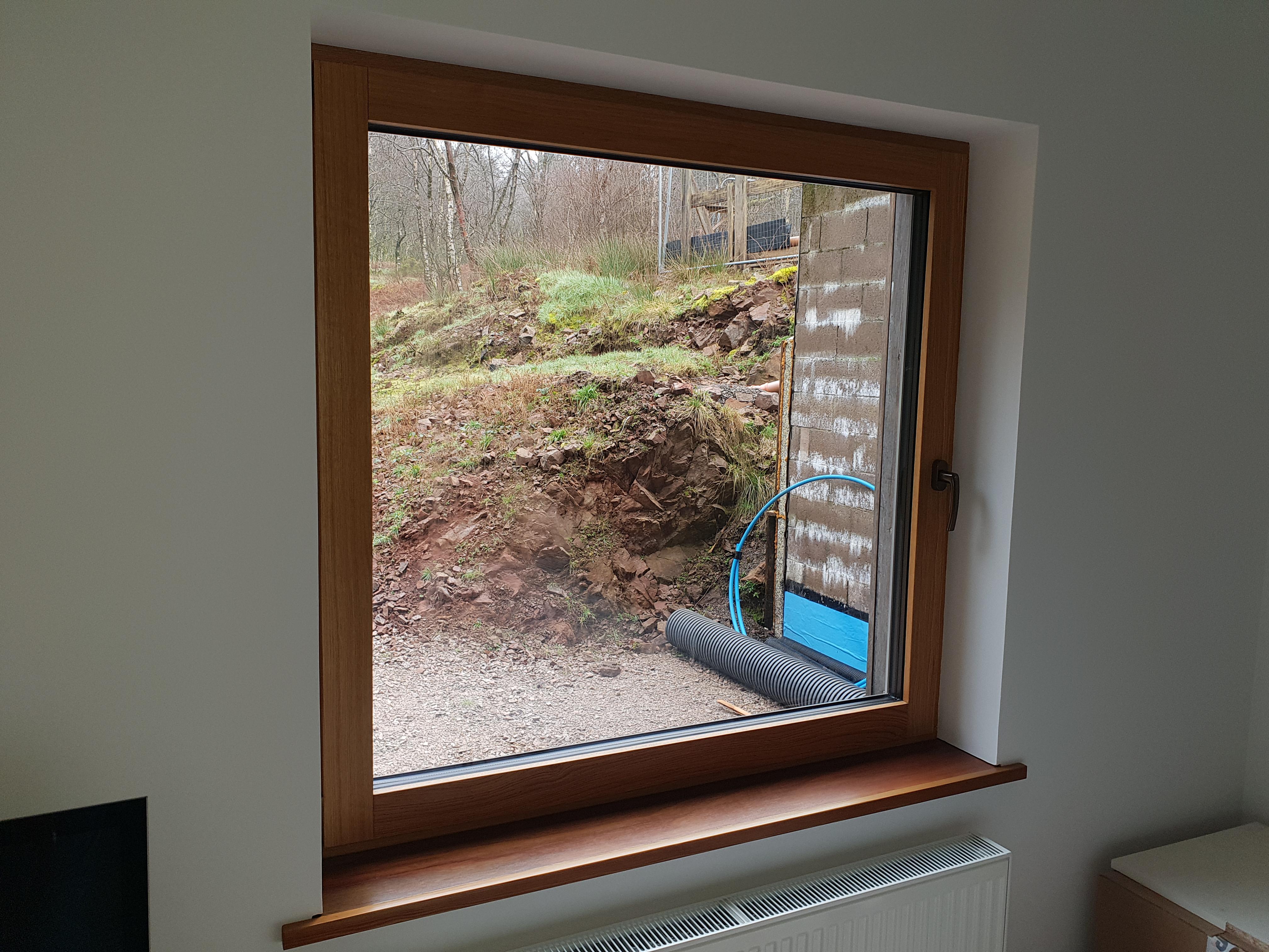

  7. Just knocked this up. Cut some left over plywood and biscuit jointed some ripped down left over larch cladding on the front edge. SWMBO approves so I can crack on. Treated with Osmo UV oil and a top coat of varnish. Next on the cards is DIY larch archatrave and skirting board as I over ordered about 40m2 of Siberian larch ?
