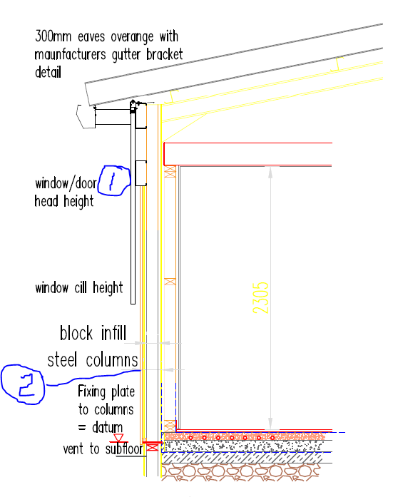

  10. Is (1) the vertical timber cladding and (2) the proposed "New box section double-skin insulated vertical cladding"? In the upper area, behind (1), is there any insulation planned between the "C" profile beams.

  14. Are you getting any help with the detailing of areas like this? Have you or they prepared any sections that help visualise the region. A Section at the eaves, through one of the steel columns and showing the proposed wall and roof build-up would help to ensure the issue is understood and perhaps how a fix can be developed. It may be that 40mm PIR will be sufficient to stop the steels, where they are "internal", dropping below the dew point, but a condensation risk analysis would be required to know for sure. There would still be a sizeable cold bridge though, even if there was little risk of condensation. There may be an issue though with the walls having composite panels outside of the wall build-up you propose. Quite rightly you are positioning a vapour barrier on the inside surface, I believe the effect of placing a further layer on the outside that is also vapour closed (composite insulated panel) will stop any moisture that does get into the wall from being able to get out, and therefore pose a mould risk. These are aspects of my build that I was not confident in making the correct decisions, so I got some help in.

  16. All my steel frame is outside the thermal envelope, with vapour barrier in place to stop warm moist air getting to a cold (sub 14°C Surface). Not at all, I'm sure they are purpose designed and built. If you have the same or similar insulated panels on the sides of a retail park/supermarket building then you have a continuous thermal envelope outside the steel frame and no cold bridging to outside air temp (just the cold bridge to ground). With conversions, planning are not always open to an increase in footprint to allow insulation around the outside of what was previously an agricultural building and had no such insulated panel outside of the steel frame. This was my issue: no opportunity to insulate the steel frame (on the sides) externally, so the condensation risk is not just a theory, it was very much real. The OP is only able to get minimal insulation around the outside of the columns, and the columns are outside of the main wall cavity that will carry the wall insulation.
  17. You may have missed that while the roof portals are under the insulated profile sheets, the columns are outside the thermal envelope, which of course join to the roof portals at the haunches. I didn't take a risk with mine, so had some condensation risk analysis done, which showed that condensation was a certainty. Maybe you can get enough insulation around the outside of your columns to reduce the risk.

  20. I had the same restriction as mine was a Class Q PD Conversion, so no opportunity to insulate around the outside of the columns. If you are only getting a small amount of insulation around yours you need to give this some serious thought. Steel conducts heats 22 times better than concrete, so the equivalent cold bridge, if it were in concrete, would be 22 times the size. With your current plan I don't see how you are going to avoid condensation on the steel frame, and possibly forming within your walls. You can see the base of the columns wrapped on mine, but this just thermally breaks the UFH from the columns so it doesn't pull the heat directly out of the floor to the ground, but it hasn't broken the cold bridge from the column to the ground. As you say this is almost impossible. My internal columns ended up full encased in a sprayed on, closed cell foam insulation to exclude them from the thermal envelope and ensure no moisture could get to them. Here's a before and after.
  21. When I first started thinking about my own conversion I did think I'd have the primary frame structure visible internally, in some areas and have an industrial look to the interior, but I couldn't mitigate the thermal bridging, so ended up covering it all up internally and fully insulating it from the inside air, including vapour barrier. The sales man is not wrong saying the roof will be thermally efficient, without cold bridges. Assuming you are looking at Kingspan insulated, profile sheeting (or similar), if you go thick enough it can give decent U values and the marketing suggests decent air tightness is possible. It fully wraps the steel structure so the roof beams and purlins are fully within the thermal envelope. You may have an issue though in the detailing of the roof structure to to the columns. The roof has the steel frame within the thermal envelope, but your description of block walls between the columns and a timber stud structure internally to create a cavity suggests the columns will be outside the thermal envelope in places (although not visible from outside). You have a difficult transition at the point the columns move from being outside the thermal envelope to inside in order to meet the roof portals. Since the columns are not visible from outside, if there's enough room to the cladding (or however you are finishing the outside) perhaps you can wrap the columns to well insulate them from outside air temp. But that doesn't resolve the thermal bridge to the ground. Unfortunately the salesman is incorrect regarding the MVHR. In winter it will help reduce the relative humidity of the internal air, but should help to keep it in the 50%-60% range for comfort. But 21°C air with a 60% relative humidity has a dew point of 12.9°C, so any surface it comes into contact with, below this temperature, risks condensation. To add another worry bead, I also have a concern with the insulated profile sheeting. They are very lightweight, and while they have reasonable U Values (if you go thick enough) the insulation type has a very short decrement delay. I'm not sure how they will perform in a domestic setting. I have no experience of them, so for me it is just a concern, but if you haven't done so already I would try and get the views of someone that has used them in a similar way.
  22. With the columns likely bolted straight down on to their original pads and no insulation between the pads and ground, the steel frame is going to act as quite an efficient heat sink. Are the purlins also steel, or timber? Are the columns visible on the outside at all, or will they be insulated from outside air temp so that it's just ground temp they won't be insulated from? I had to have portions of my columns visible from outside, so are effectively at air temp, therefore in winter they can be below freezing. To avoid heat losses through the steel frame, I've put all the original frame outside the thermal envelope, which was tricky for four of the columns that are internal, within the building. If yours are insulated from outside air temp, and only un-insulated from the ground, your issue is not quite as bad, but the columns will still be at around 6°C - 8°C at the point they touch the ground. Any of the steel frame that is below 14°C and exposed to inside air is at risk of condensation. I also wrapped the bottoms of the columns in Celotex, where they came through the floor, to thermally break them from the insulated raft, that includes the UFH.
