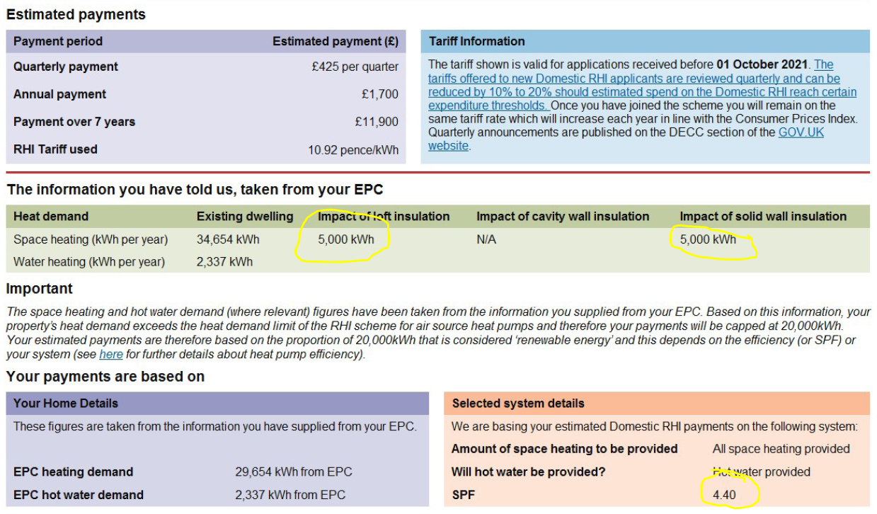

  1. Couldn't agree more. There's no need for the additional complication, standing charge, service costs. I personally wouldn't consider keeping the Gas Boiler, based on what you have said. Your Gas boiler didn't require a backup system in case of failure, so neither would an ASHP. That brings RHI back in to play, if you can get the property to an EPC C. Victorian or not, as long as not listed, there has to be options. ASHP generally range from 2.5 to 5.0 SCOP. To get towards the upper level you'll need a space heating flow temp of 35 degrees. I think having a huge thermal store works against the ASHP. Trying to fill it up in 9 hours at 15kW, rather than heat the house directly at 5.4kWh makes for an inefficient (higher temps and large standing losses) and an unnecessarily large system.
  2. What's the issue making you retain the Gas Boiler? What SCOP do you have estimated for the ASHP, that gives rise to issues with the anticipated electricity costs? 6m³ hot water tank, 6000l, really? Is this just for a domestic property or is there more to this install? Loose the Gas Boiler?
  3. With 16kW, you'll have no issue with heat-up time on the cylinder, so go larger if you can fit it in. The larger it is the lower you can drop the temperature and the more efficient the ASHP will run. You can work out your own RHI payments: https://renewable-heat-calculator.service.gov.uk/StartCalculation.aspx I've plugged your figures in below and have guessed the improvement expected from loft and wall insulation. When you do it, remember to change the SCOP from the default 2.6. It makes a big difference. I think the F2040-16 has a SCOP of 4.48 Edited to add: 4.4 SCOP relies on an emitter size that allows a 35°C Flow temp.
  4. Nibe are a very good heat pump manufacturer, and their prices tend to be a little higher than the direct competition. I have the 12kW F2040, so not sure how much more the 16kW is. (I remember it was an extra £400 ish from the 8kW -> 12kW). To my 2017 pricing (which shouldn't have gone up much for ASHPs) I'd say you're quote is around £2K - £2.5K more than I was charged. Edited to add: That's a small UVC for ASHP size. Is your space heating requirement driving the size rather than DHW requirement?
