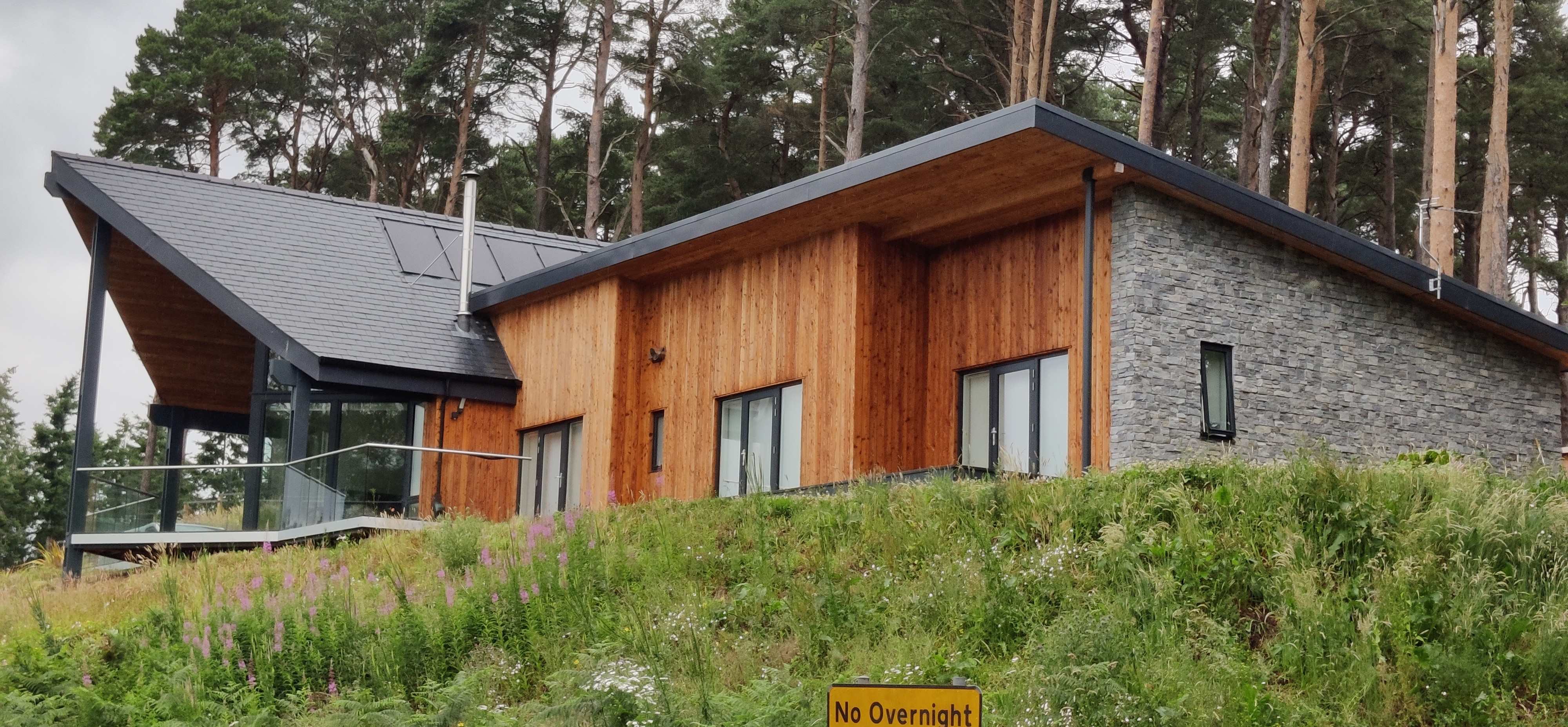

Seamed Roof - what to have Zinc/Aluminum/Greencoat
JohnMo replied to Caroline's topic in Roofing, Tiling & Slating
Just NE Scotland I believe. But there is a network of install companies nationwide. Sika only sell to approved installers I was told. -
Forgot to mention 220m² approx. -
Cost and ease of getting an installer. Cost was £14k for system chosen, that included all the correct underlay, all edge trims etc. Alternatives priced TATA standing seam, 2x quotes £18k (lots of detail not included) and £29k Zinc was about £30k, quote had no details of what was or wasn't included. -
I had the same dilemma, in the end went Sika Sarna S327 standing seam. A seam welded and mechanical fixed EPDM. -
