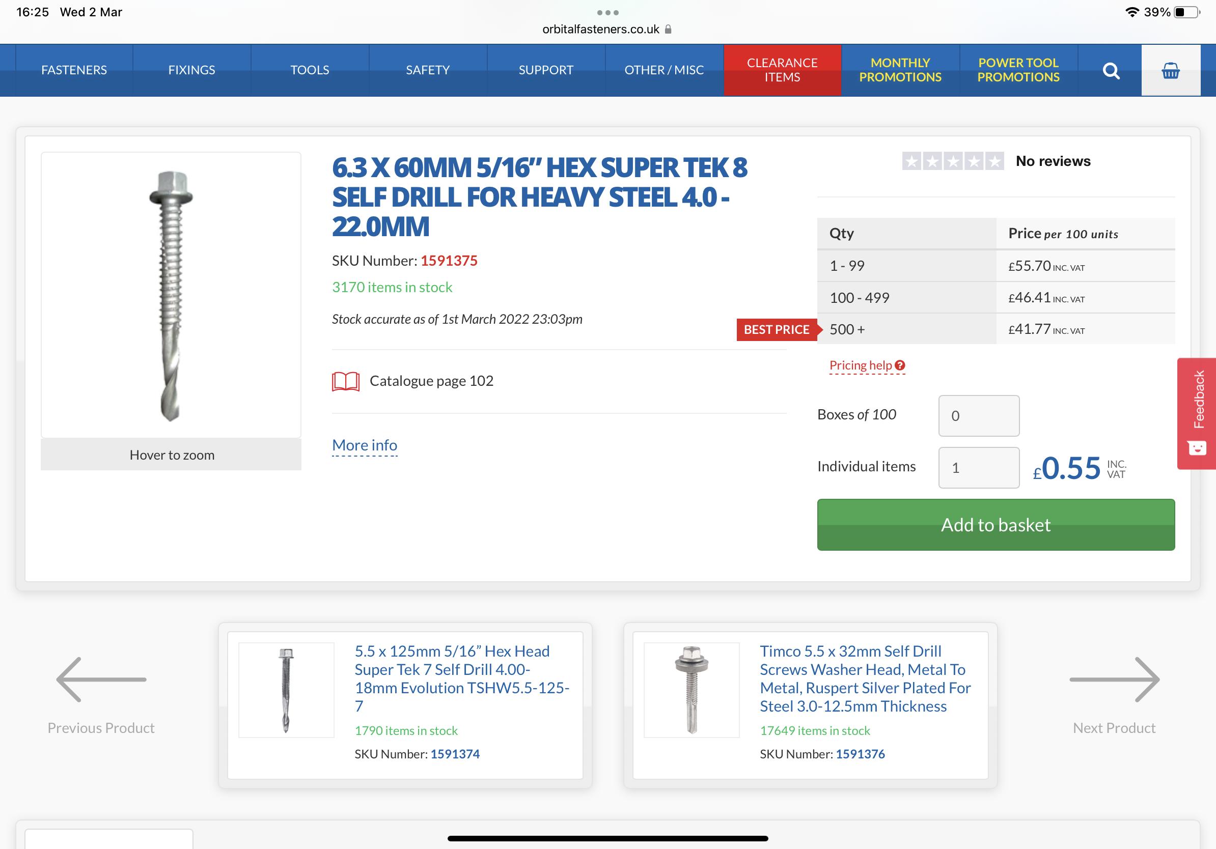

  13. Not an expert but is that the correct screws for steel that thick? As above a mag drill will be your friend here. Have seen fixings fired into steel beams through wood with Hilti or equivalent.
