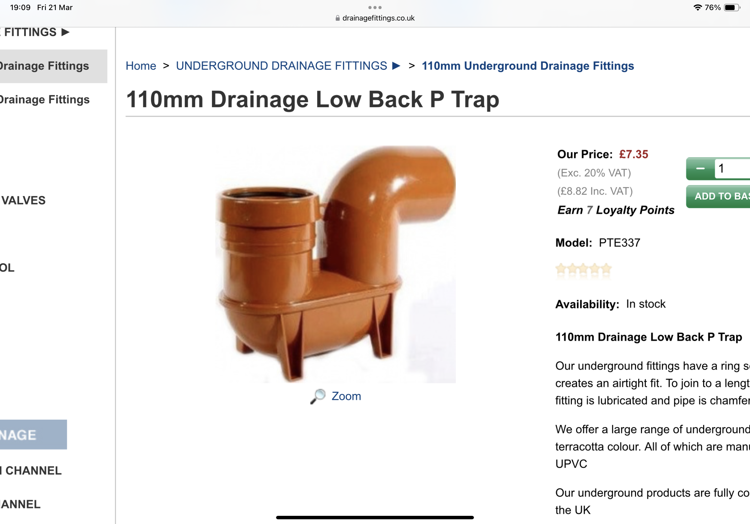

That is a grease trap / gully, meant for kitchen / utility. Just a rain head & elbow is all you need. -

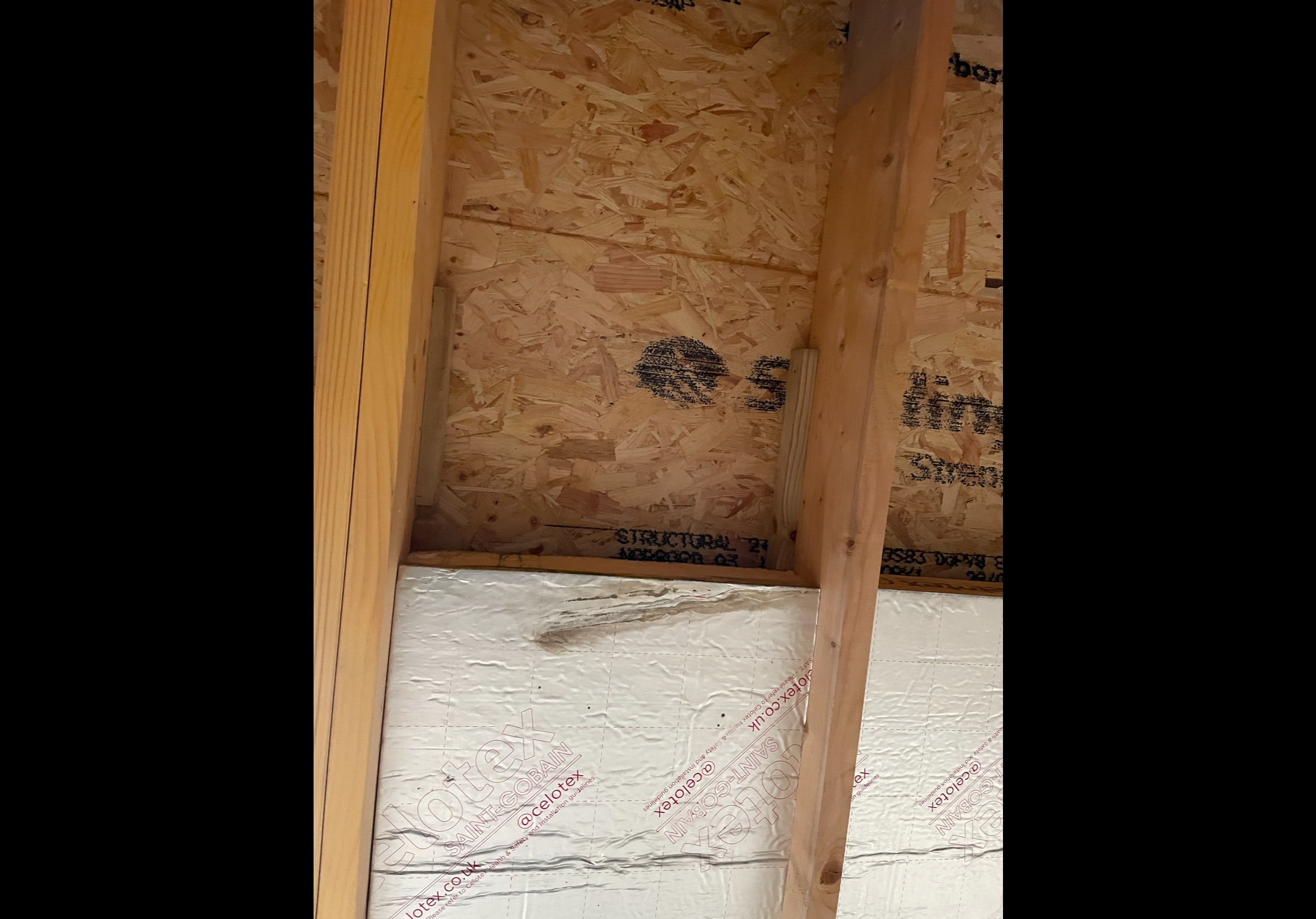

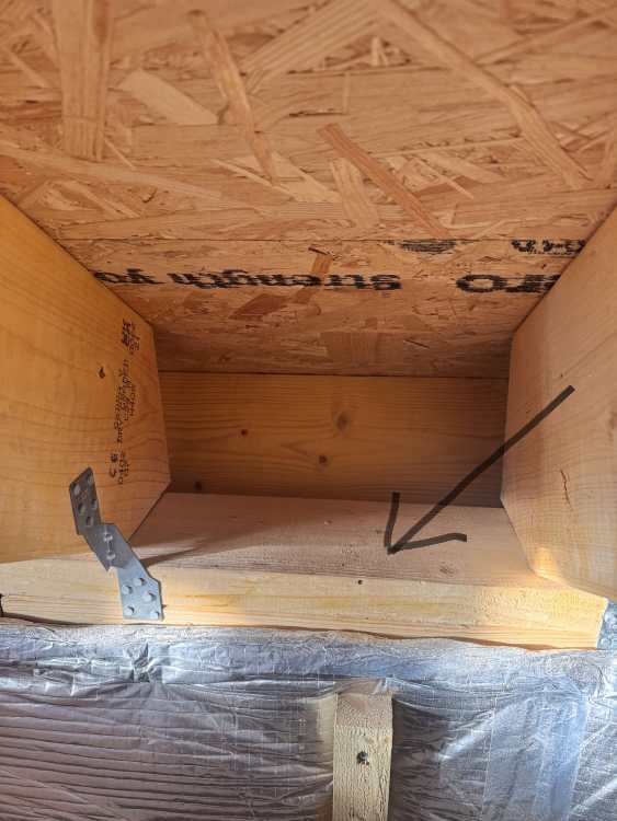

Overthinking it 😉 I used tiling battery to create the air gap but it also allows you to stick the insulation to the batten with silicone, make sure your insulation is good tight fit between the rafters, use airtight foam on the wall plate etc.
Cut the bottom of the sheet of insulation at 45 degrees so it sits on the wall plate, (eaves end) marked on your photo.
I used off cuts of tiling batten to create the air gap, 45 the bottom of the insulation so it sits on the wall head.

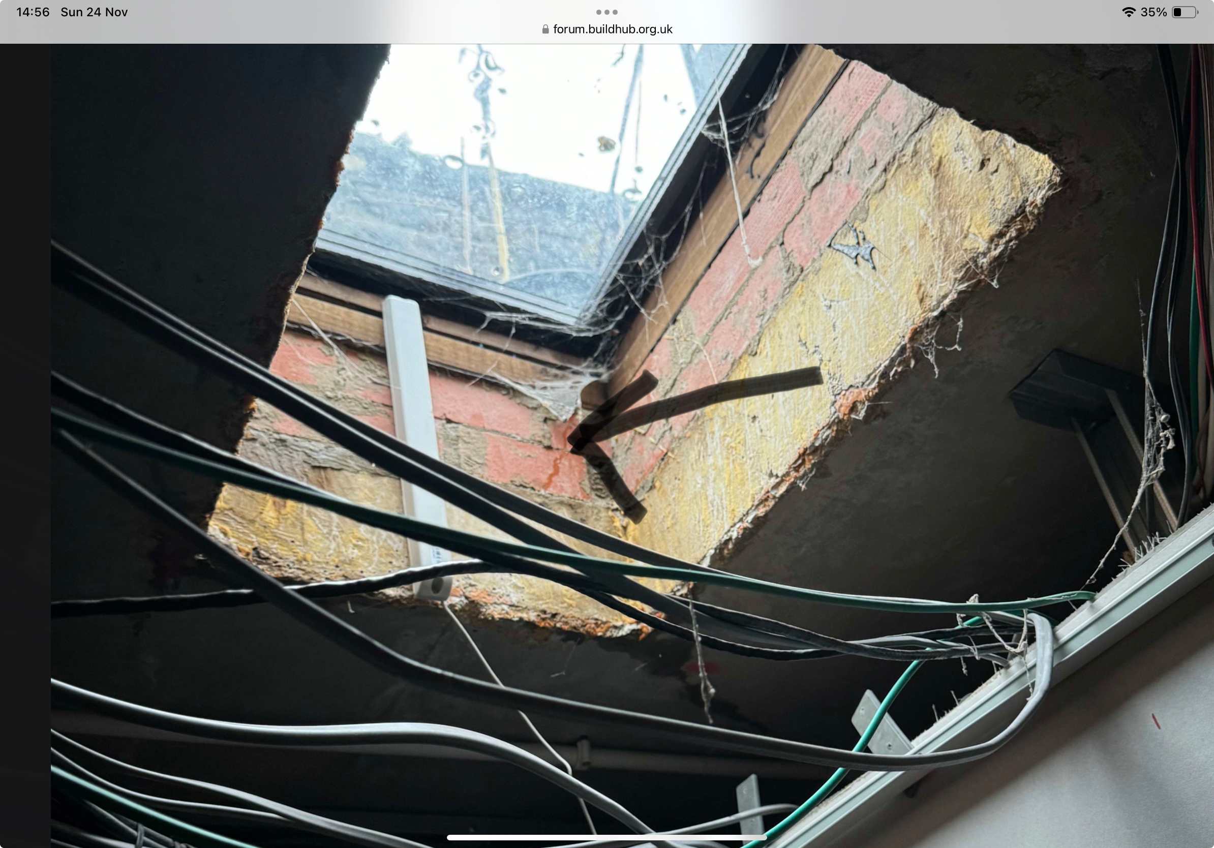

Walk on glazing - drip , drip ( yes I know ! )
Eric replied to Pocster's topic in Skylights & Roof Windows
Makita 😉
