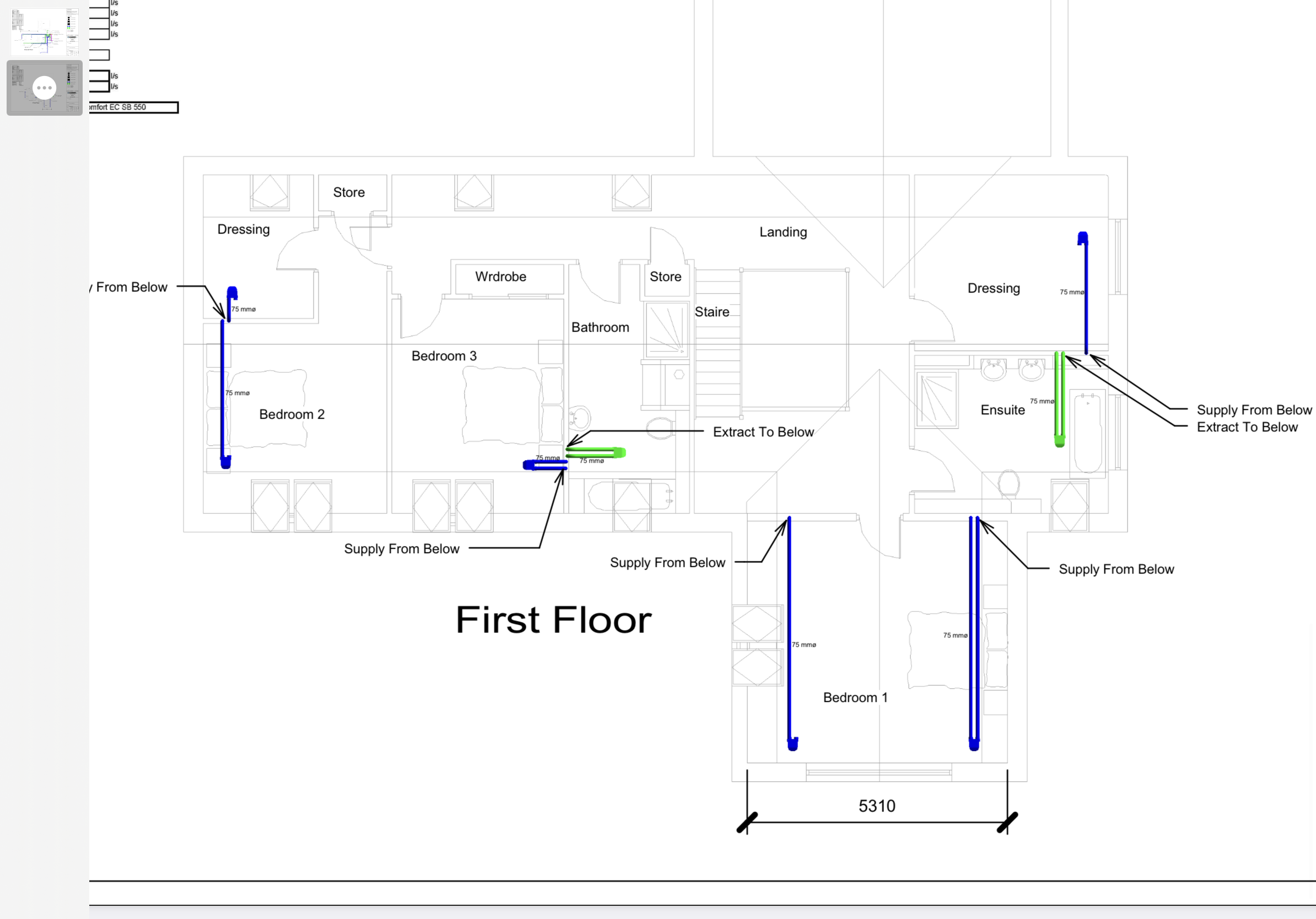

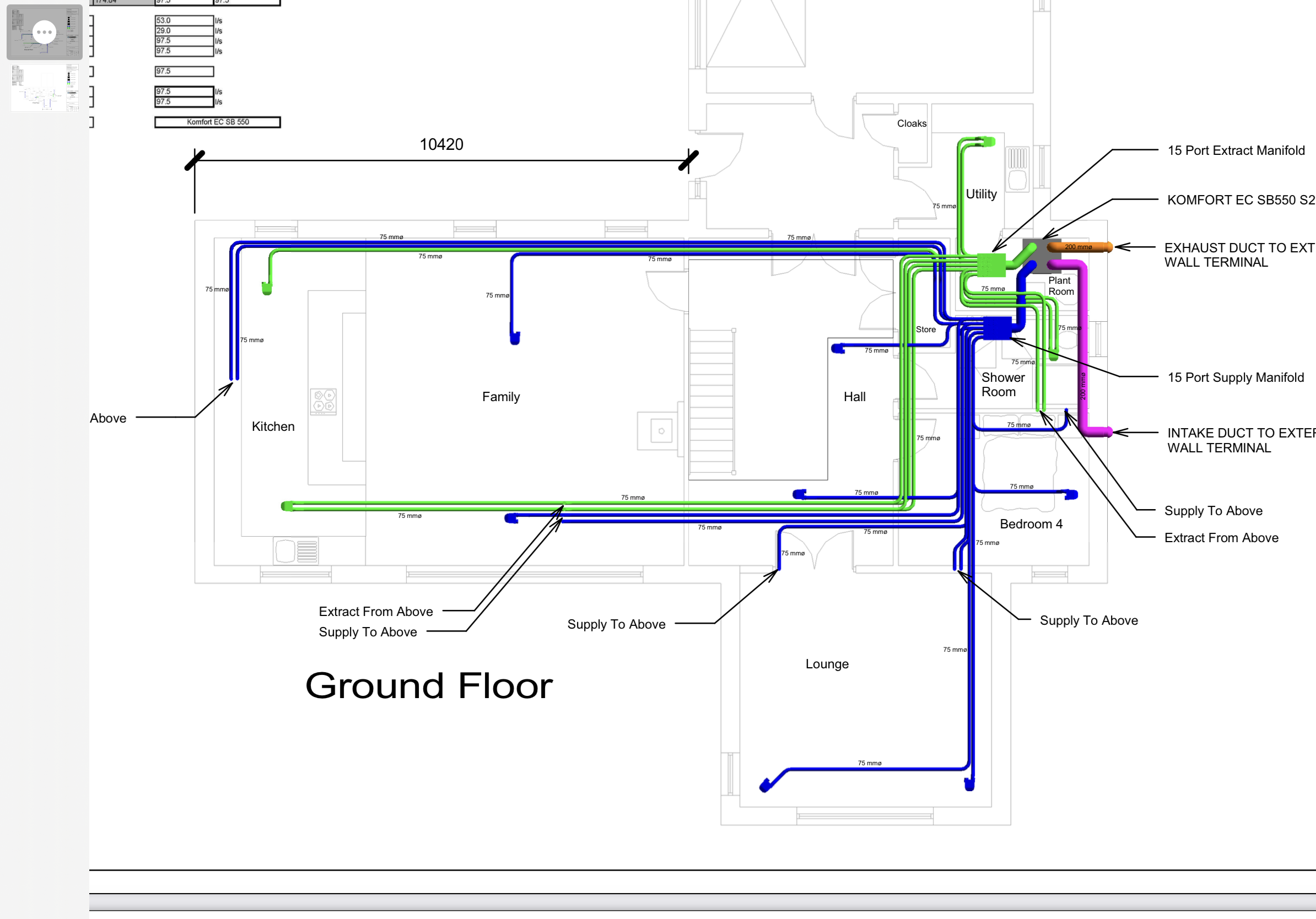

  22. Thanks @Nickfromwales For bedroom 1 if I was to have 2 terminals would you suggest single or double runs for these or as the drawing, 1 double & 1 single?
  23. Here is an MVHR layout that I have received, I would like any feedback if possible. New 1.75, 375m2 build. I think the lounge should just have 1 terminal with double pipe. No terminals in the hall. The extracts in the kitchen should both be double pipe. Bedroom 1 has a vaulted ceiling so would prefer just 1 terminal for this also. edit, all of the first floor are JJI joists, the kitchen/family room have had access hoses cut in them prior to installation as they are 400mm centres.
