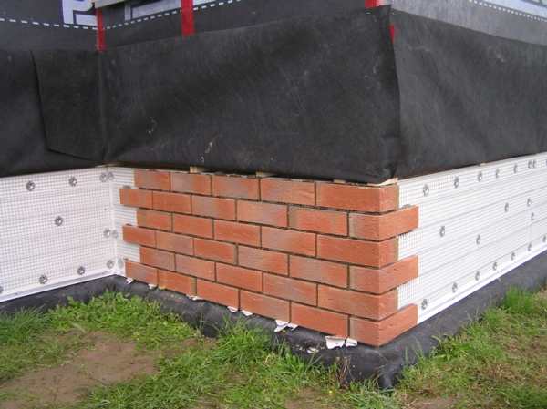

  11. I used Bluclad board for my brick slip clad plinth.
  12. Our frame was a 350mm timber I-beam portal frame which was fully clad with cedar with the exception of a brick slip plinth. The windows and doors were set halfway into the frame and were strapped onto OSB fillers fixed to the I-beam web.
