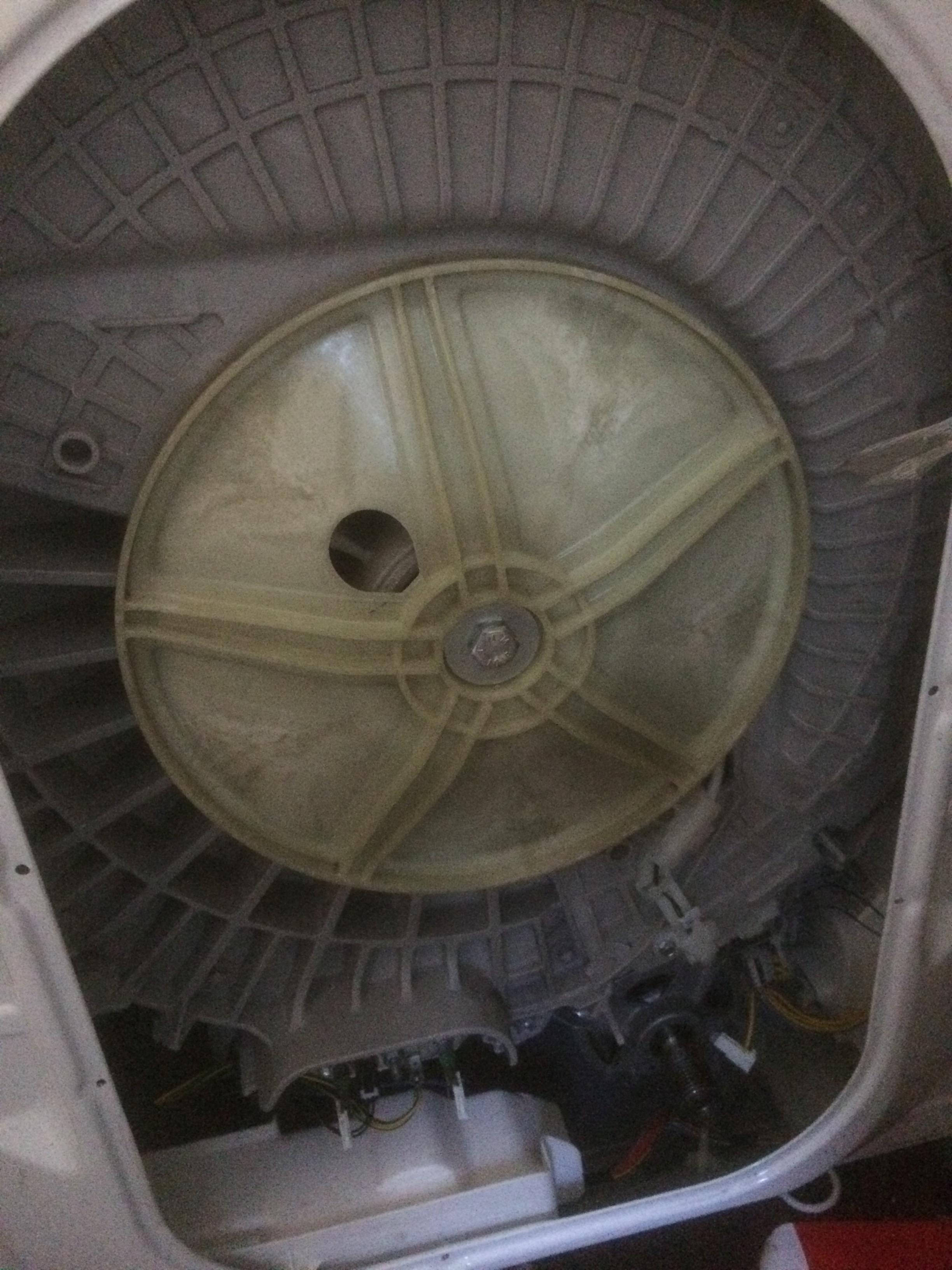

  10. Is that white cylinder the spider? Was thrown by it not looking like the parts I've come across in searching for bearings.
  11. 1/ it's a long time since I worked on timber frame but every single one I have had the cavity empty. Weep holes were built in at the bottom (on the cavity tray) & near the eaves to create a ventilated cavity. The 'norm' may well have changed since then so worth looking into. 3/ you need Dpc all the way round for it to be effective. As I mentioned above,it used to be the norm to fix a cavity tray at ffl,if not then 100mm damp all the way round,with additional stepped down (& lapped) to 150mm above dropped ground level. When the time comes we can go over exactly how to install a tray,also care need to be given to propping lintols & cutting blocks to go across them. By God,thermalises love to bow out over openings,esp on tf. We had to put bed joint reinforcement (brick tor or train track) for two courses below & above all openings,to minimise movement & prevent cracking. Again,worth researching if this practice has been superseded.
  12. Opened the back up and-there's no spider!! is that normal? No sign of it broken off or anything!
  13. Only just woke up at 8.50-living the dream! Had a look myself & also can't see it,nor anywhere else. Puzzling-could it be the design is such that the bearings alone can't be replaced? I'll have a look at the online manual when the two Fun Size People in my life will allow it.
  14. Is that the product number? if so,it's 91460560500. Cheers
  15. I hear you mate but it's a £600 machine (washer/drier) so I can't let it go without a fight :))
  16. L75480WD. Its an AEG. Jeremy-would a site like that also likely supply a seal for it or is that unlikely?
  17. Hi all, need to replace ours & our Aeg model is proving unbelievably hard to locate the part for-does anyone have a secret golden website they know of to order from? Cheers, Stinky Brickie (till it's fixed)
