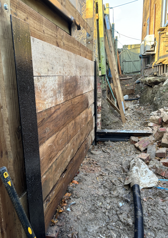

Powder coated RSJ’s for retaining wall
Onoff replied to Dan1983's topic in Landscaping, Decking & Patios
Someone on another forum asked a similar question. I said black bitumastic paint and they were happy: -
Powder coat cracks, water gets in. Galvanise and paint in black bitumen I would. Galvanise and powder coat if you must but no way would I powder coat over plain steel. Is it that you're wanting a particular colour? -
