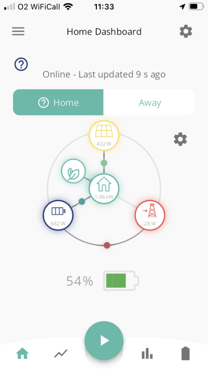

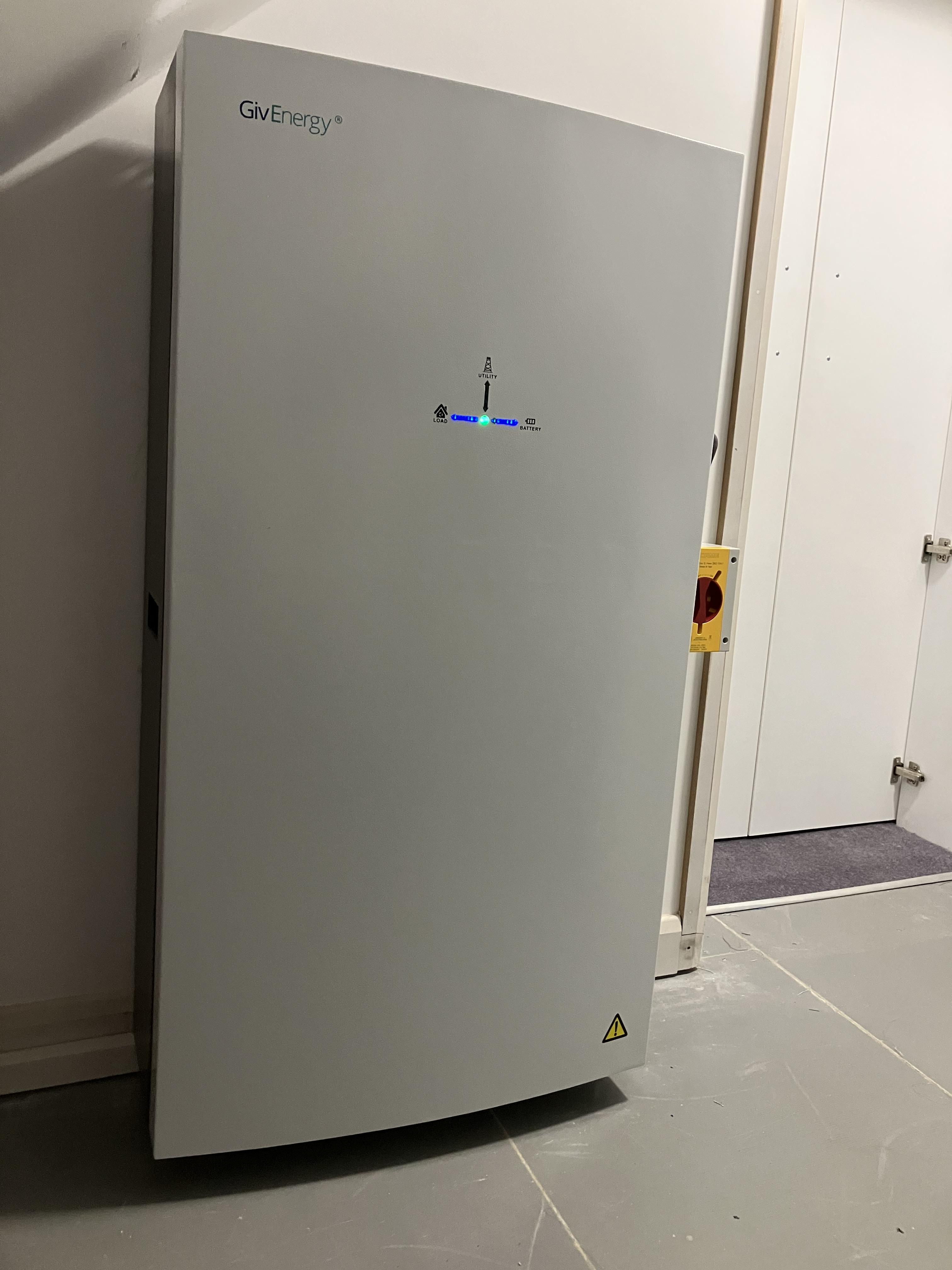

Our Givenergy All in One has been up and running for just over a month now and it’s my new obsession and it’s certainly changed the game for us. If there is no sun forecast for the next day we charge it up on Octopus ‘Go’ between 00:30 and 04:30 at 9p/kWh. If a bit of sun is in the forecast, we don’t. We moved the Sunamp charge period from the off peak time to mid morning where a good chunk of the electricity required to charge is coming from the sun, the remainder from the battery. If heating is required then the Willis heater does that in the off peak period, six nights so far this month. We’re pretty close to being ‘off grid’ now. I charged up last night because of the lousy forecast today but we’re producing 1.5kW at the moment so I probably didn’t need to bother. I’m very pleased with it and even more pleased with the invoice that arrived this morning. £6642.99 compared to the first quote I got of >£11,000 (that one did include VAT though). -

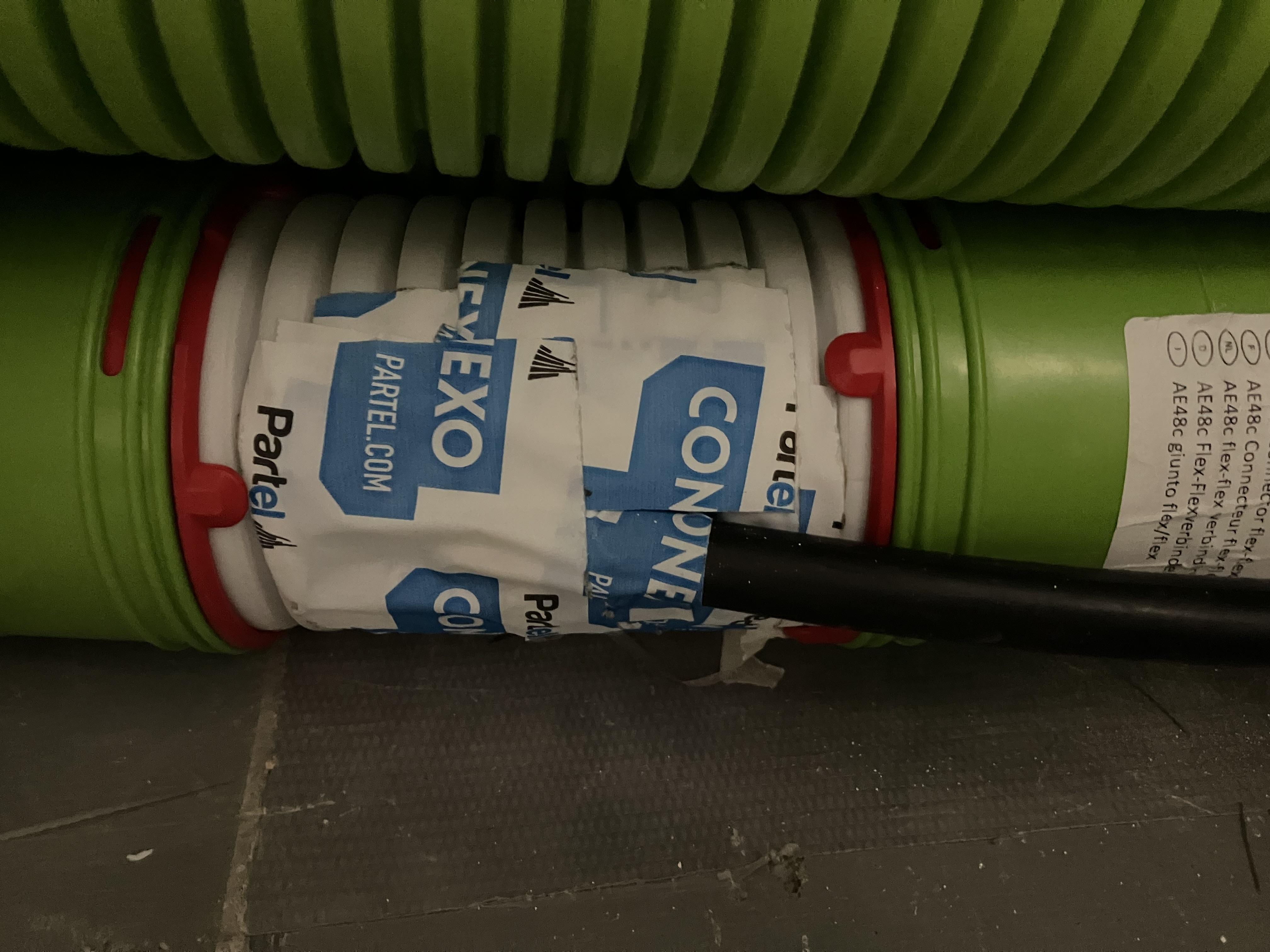

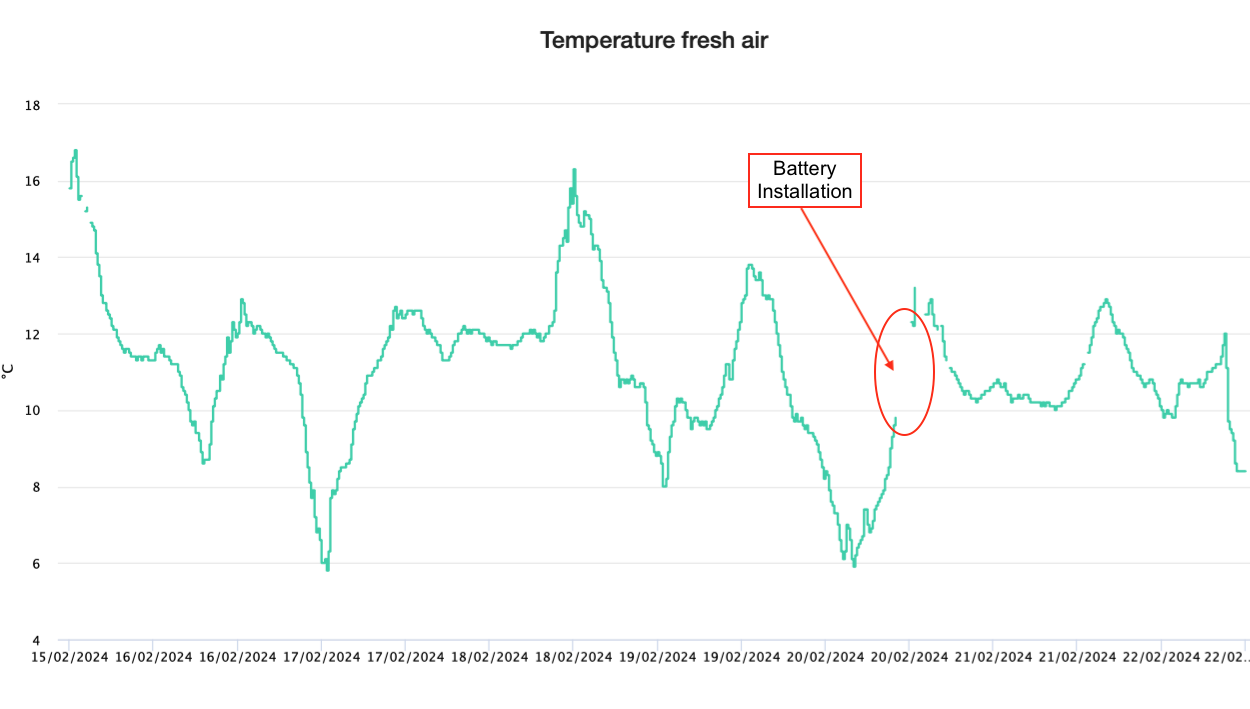

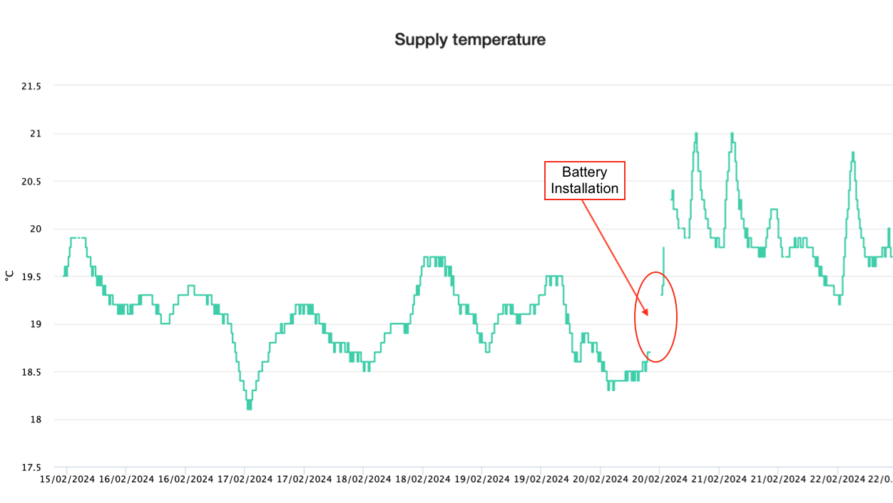

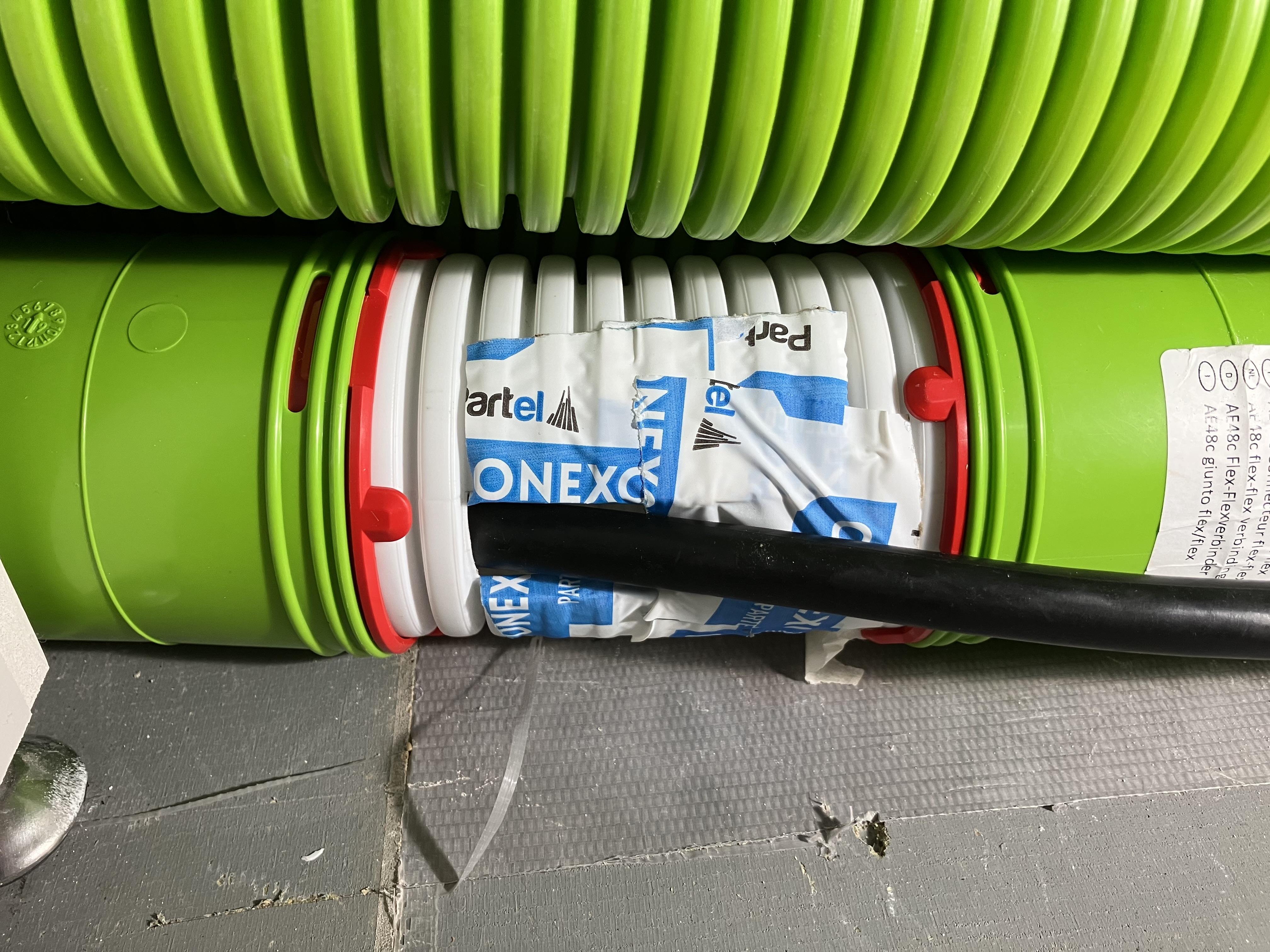

The ‘All In One’ was finally commissioned a couple of days ago and the butchered MVHR duct has been patched up. The batteries sit up in the loft in a small room that contains the MVHR unit, since installation that room has gone from being perhaps the coolest to what is now the warmest in the house as the battery slowly releases heat whilst charging/discharging. It’s very difficult to tear yourself away from the app, especially when it’s chucking down outside and as others have seen there is pretty much always a small flow to/from the grid even when there theoretically shouldn’t be. When I did manage to tear myself away from the app I had a look at the MVHR and spotted something interesting. Since the battery was commissioned, the airflow supply temperature has increased by about 1 degree despite the outside temperature trending downwards. I’m assuming this is because the MVHR is in a room that is 2-3 degrees warmer than it was. Could that be so??
