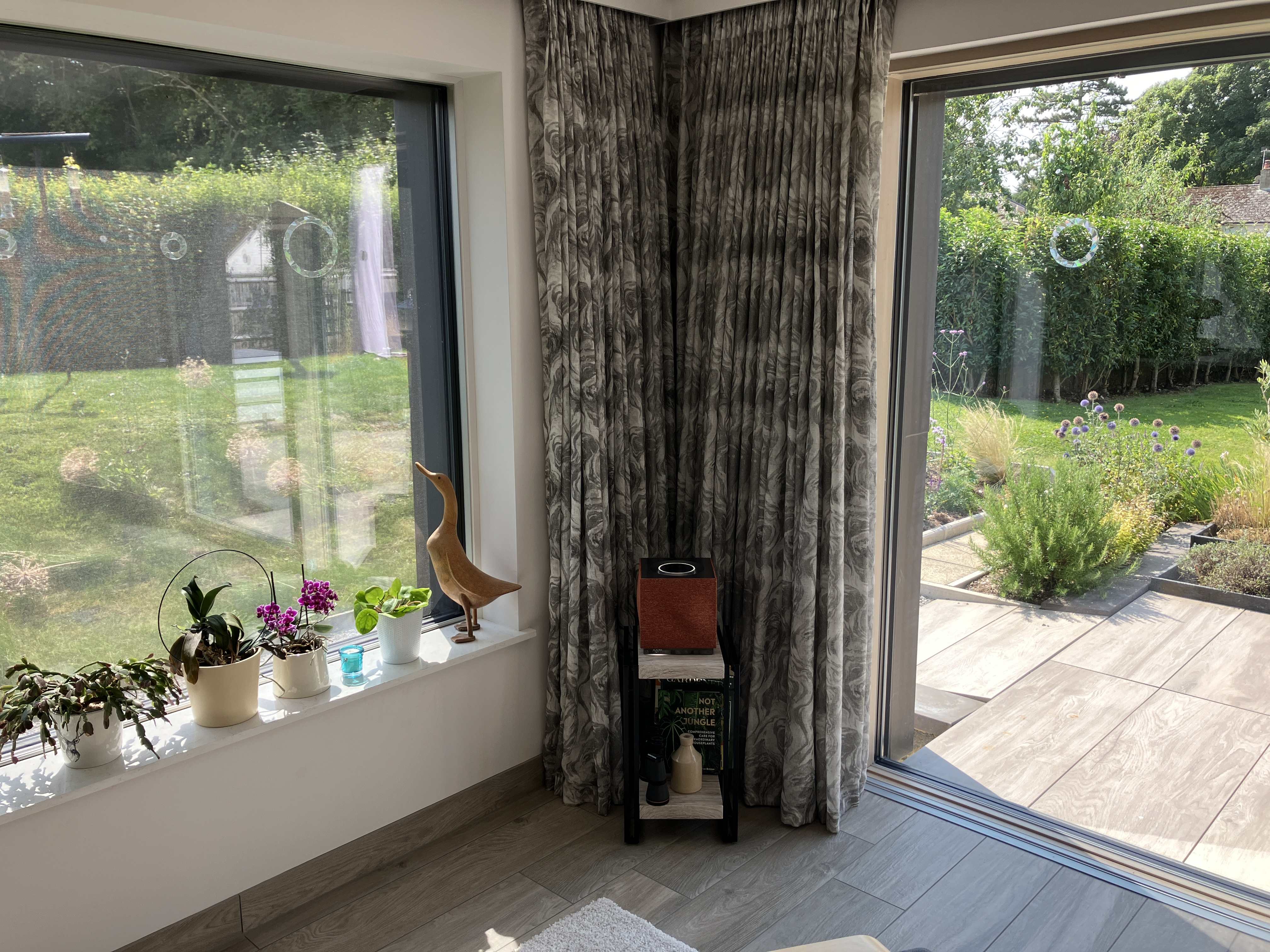

Keeping a passive house cool
Russdl replied to Russdl's topic in Energy Efficient & Sustainable Design Concepts
Just the external blinds and I took their word for it, largely due to a healthy dose of naivety, but it all seems to have panned out ok. We went for the ‘premium solar - 80% UV block’. In the picture below the window on the left has the blind down, the sliding door on the right has the blind up.- 30 replies
