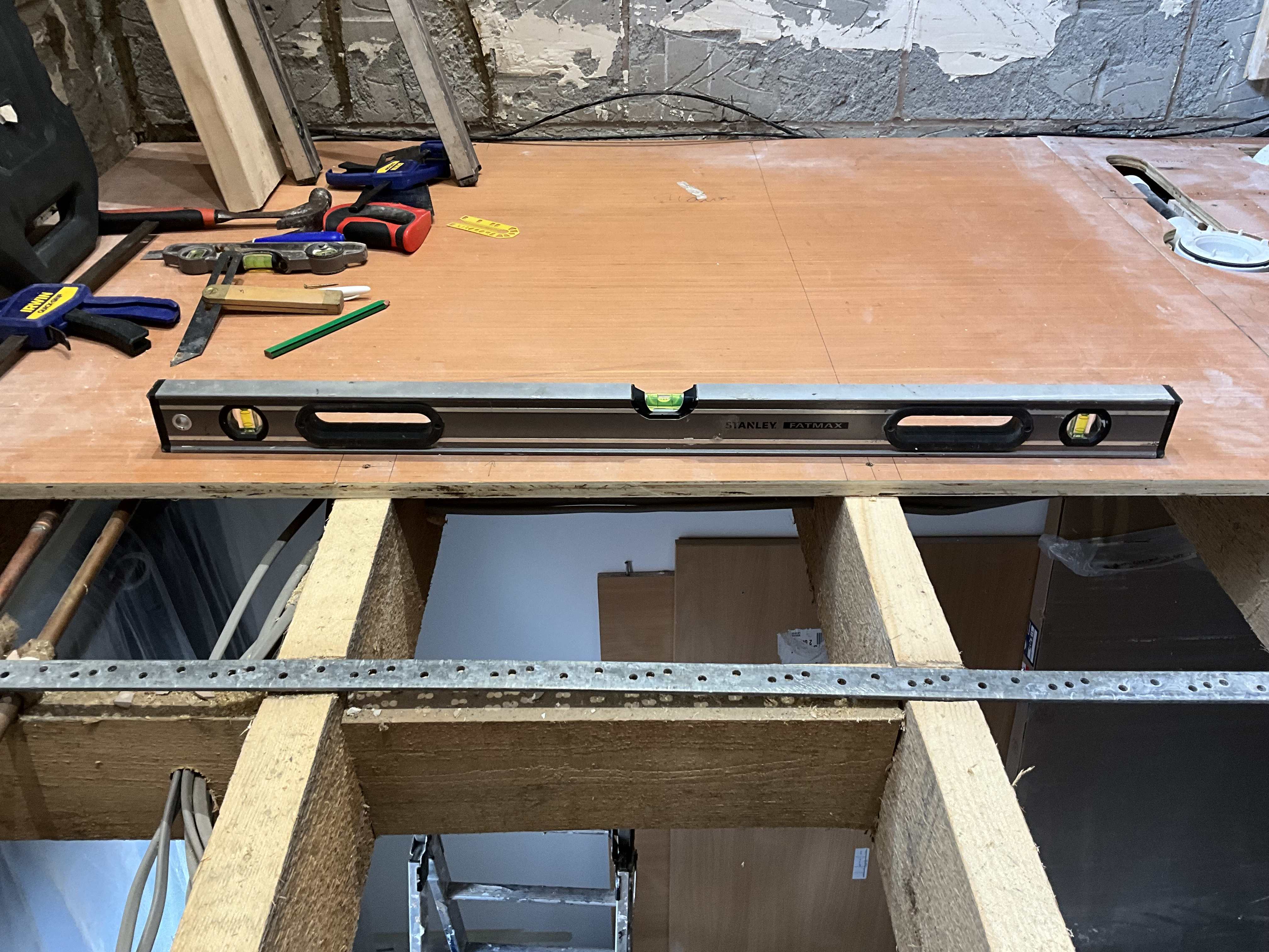

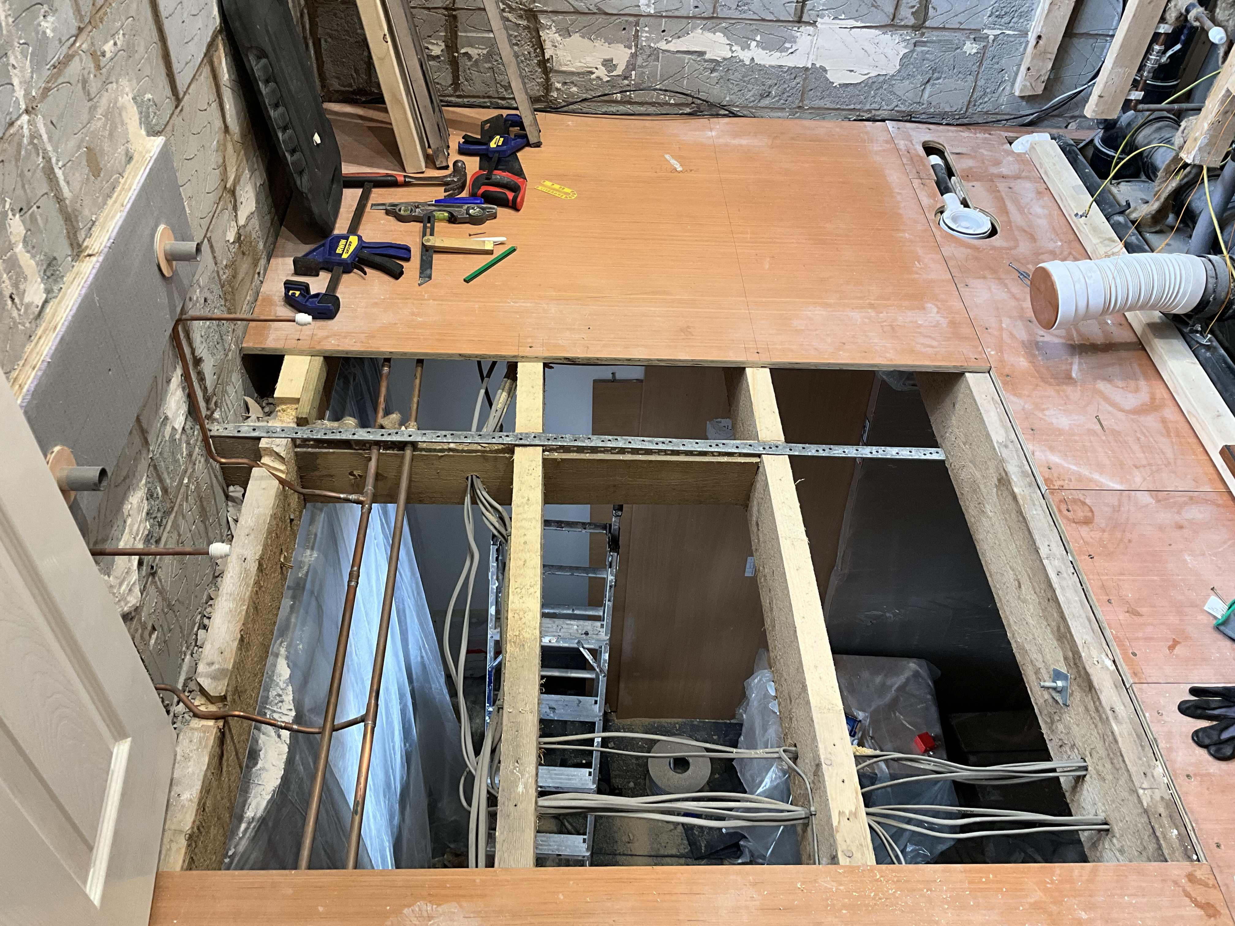

Hi members, couldn’t find my answer in previous topics so asking for some pro guidance. Bathroom refurb due to a flood. I’ve taken a big camber out of the floor so all boards now can sit flat but the area is not level. The bubble is just touching on the line. I don’t want to remove anymore from the timber beams so what’s the best way to achieve a suitable level? we have a low profile 1800 x 900 stone tray to go in which is flat underneath and the rest of the rm will be tiled with loose lay wire heating bedded into the tile adhesive for comfort and not rm heating. Should I use self level compound for the whole area and then continue or, level the tray in the adhesive of choice something like ct power grab and then tackle the remaining floor area I.e take out imperfections with adhesive > 6mm insulation boards> decoupling layer > tile adhesive with heating wire > floor tile. Tray manufacturer recommends a smooth flat surface to bed down on with a suitable silicone adhesive. The tray is very heavy so don’t want to be relifting once in place😀 Input appreciated as always ps could only upload two pics, size is inside allowance?

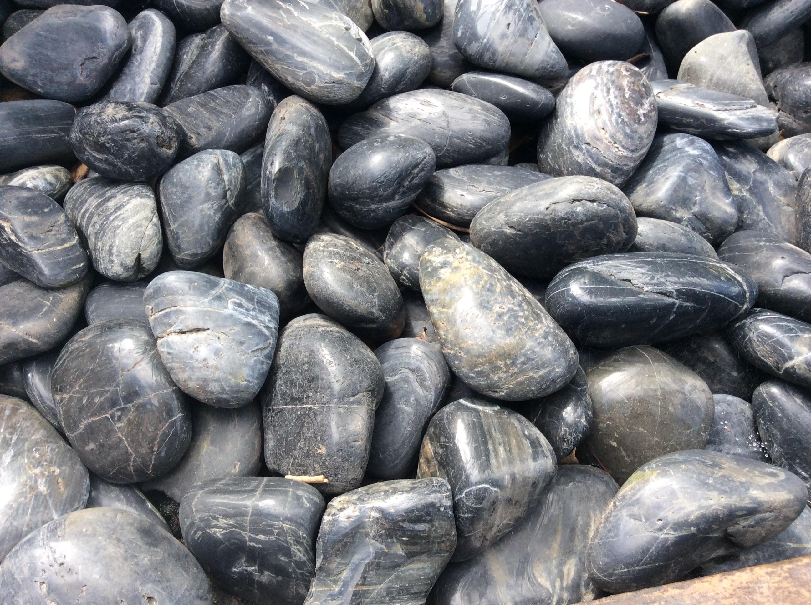

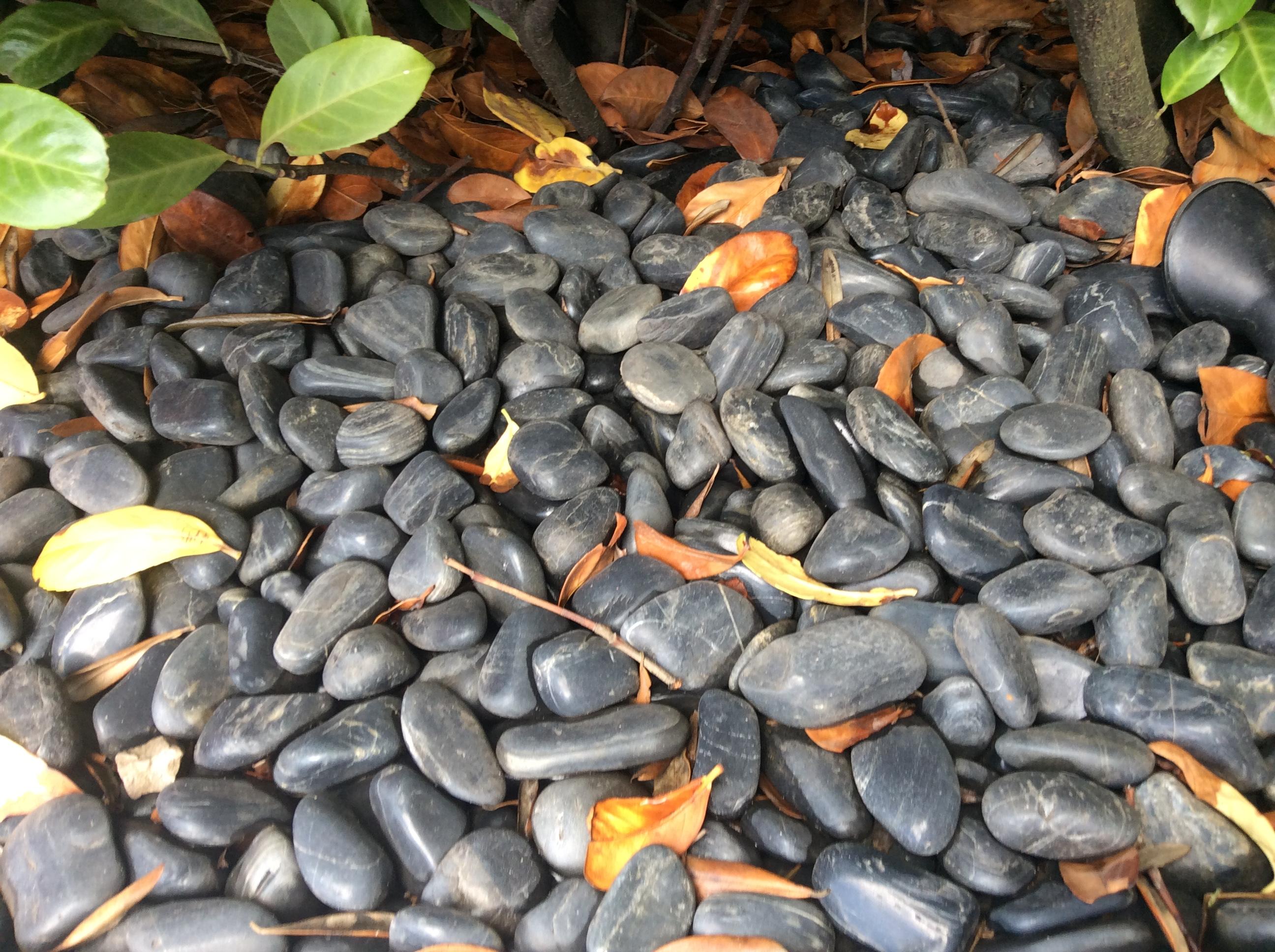

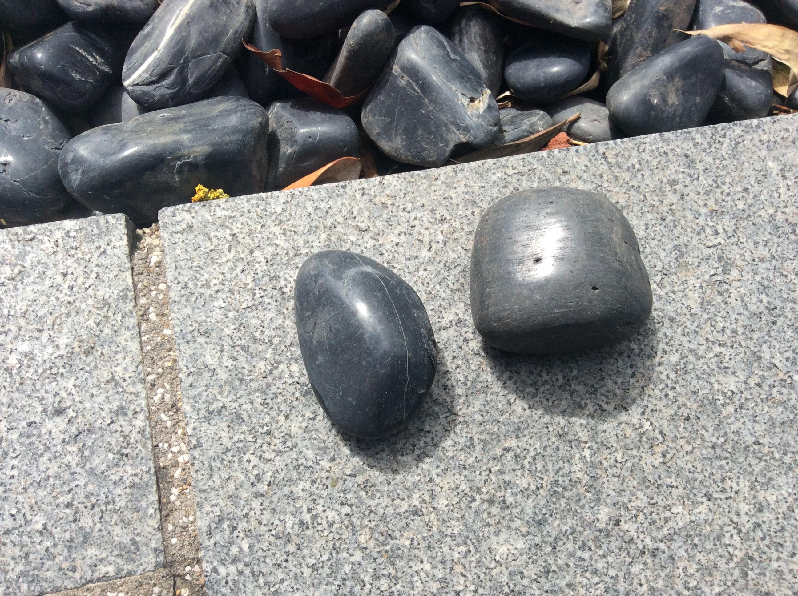

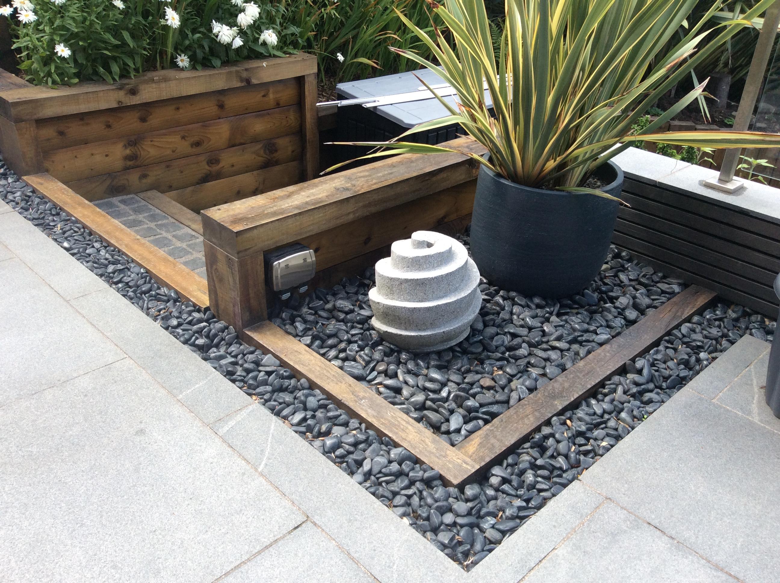

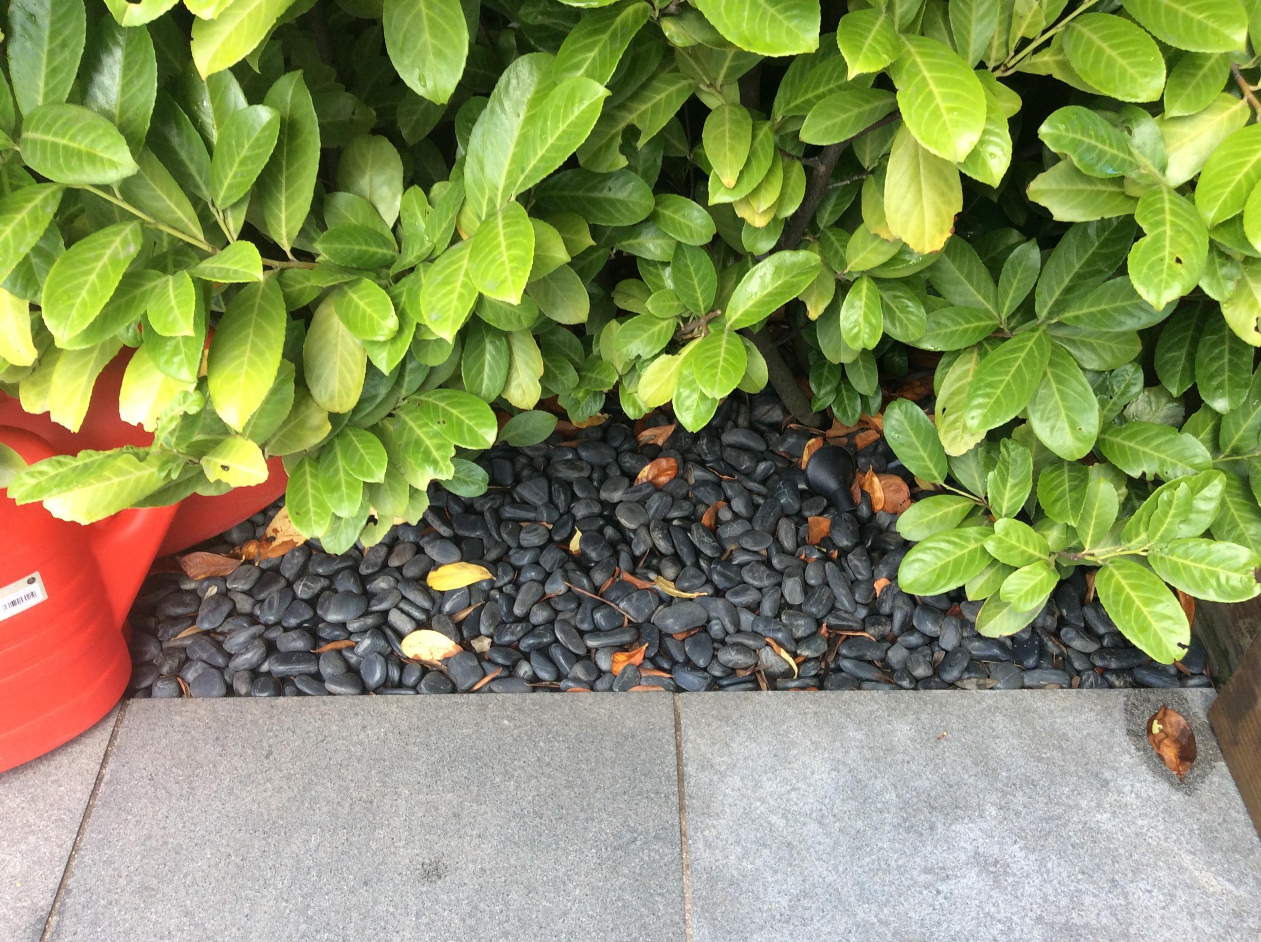

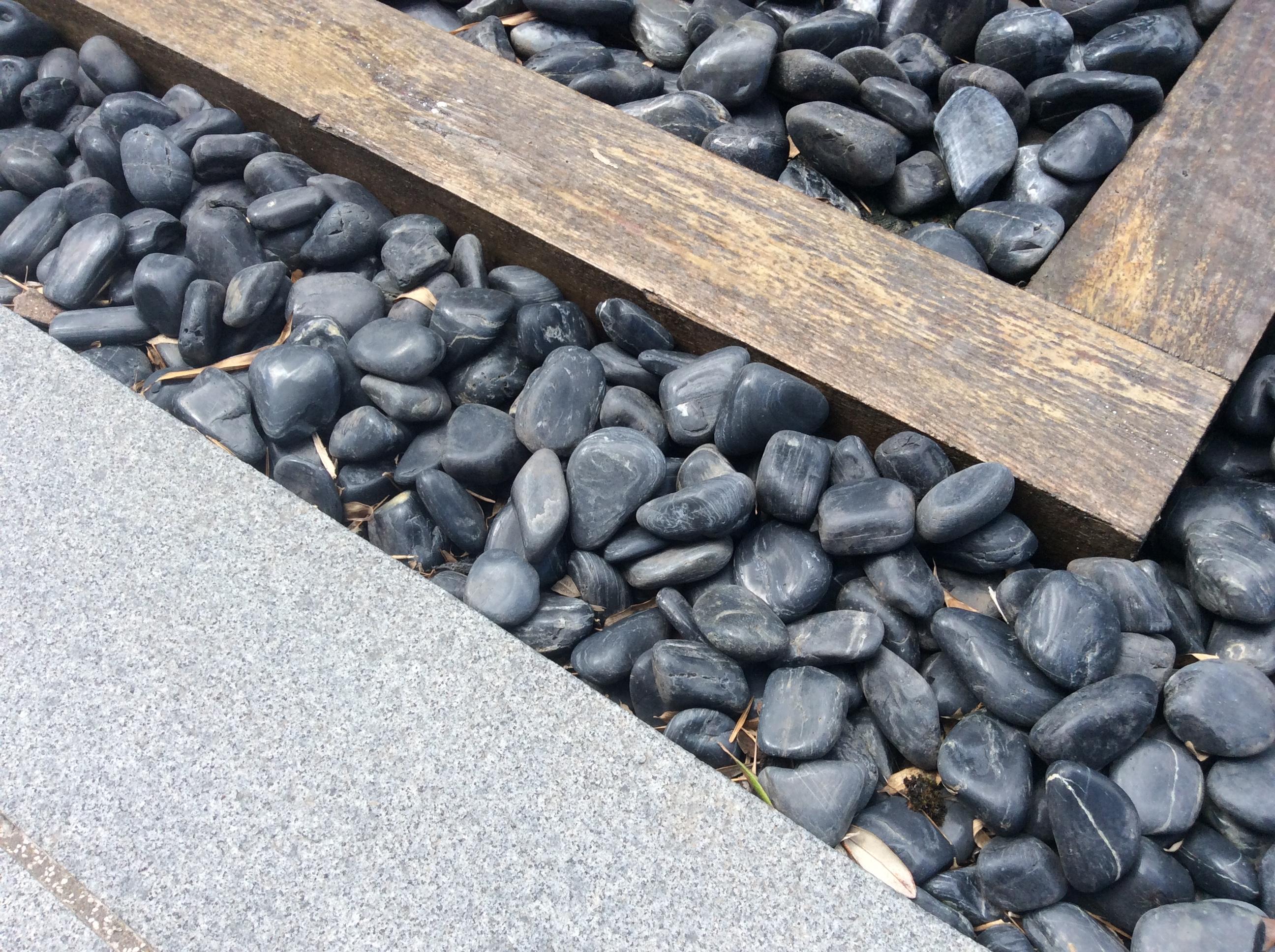

We did similar in 2017. black Chinese pebbles from a place called specialist aggregates. They still look polished today. Probably not as highly polished as originally supplied. Bernadette has been known to sit down and clean individual stones😁 Obviously, we are not building a house so have the luxury of spare time to waste.. i can attach a photo when it stops raining if you need? -
